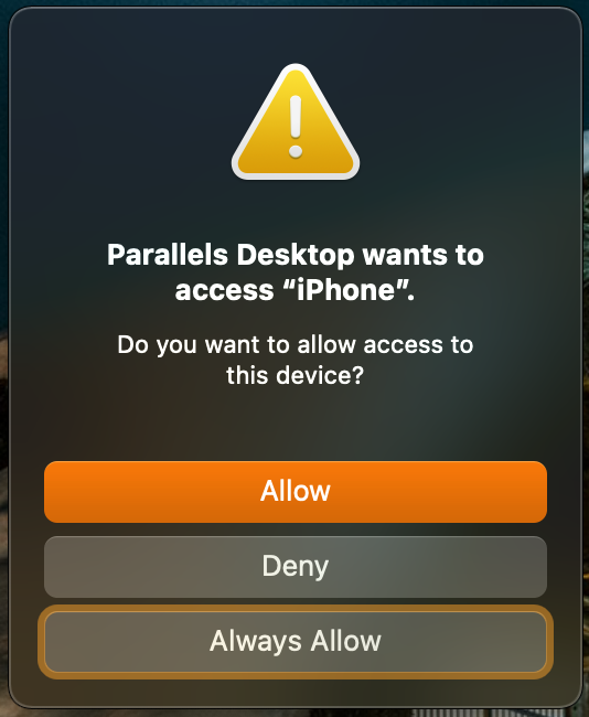

Also, do you get this pop-up when connecting the device to Parallels?

No I haven't seen anything like that

Yeah... but I'm assuming you didn't reinstall Parallels, right? Just updated the OS from Catalina to Big Sur? If so, that's why I would recommend a clean reinstall of the Parallels software. You can do a clean uninstall using softwares like App Cleaner. There are some other alternatives, if you prefer those. But the idea is to make sure you don't have any preferences or other stuff laying around after you removed Parallels. That pop-up I mentioned above is important. If you don't get that, the device won't be allowed to connect to the virtual machine.

I try all methods you said (reinstall official version in Big Sur).. SAME STORY! The machine recognized just the external hard disks, sd card but NOT my iPhone, only my iPhone is not recognized WHY?????? it doesn't even show the pop up you have mentioned before NOTHING!

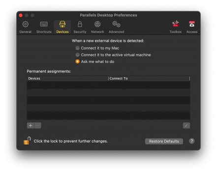

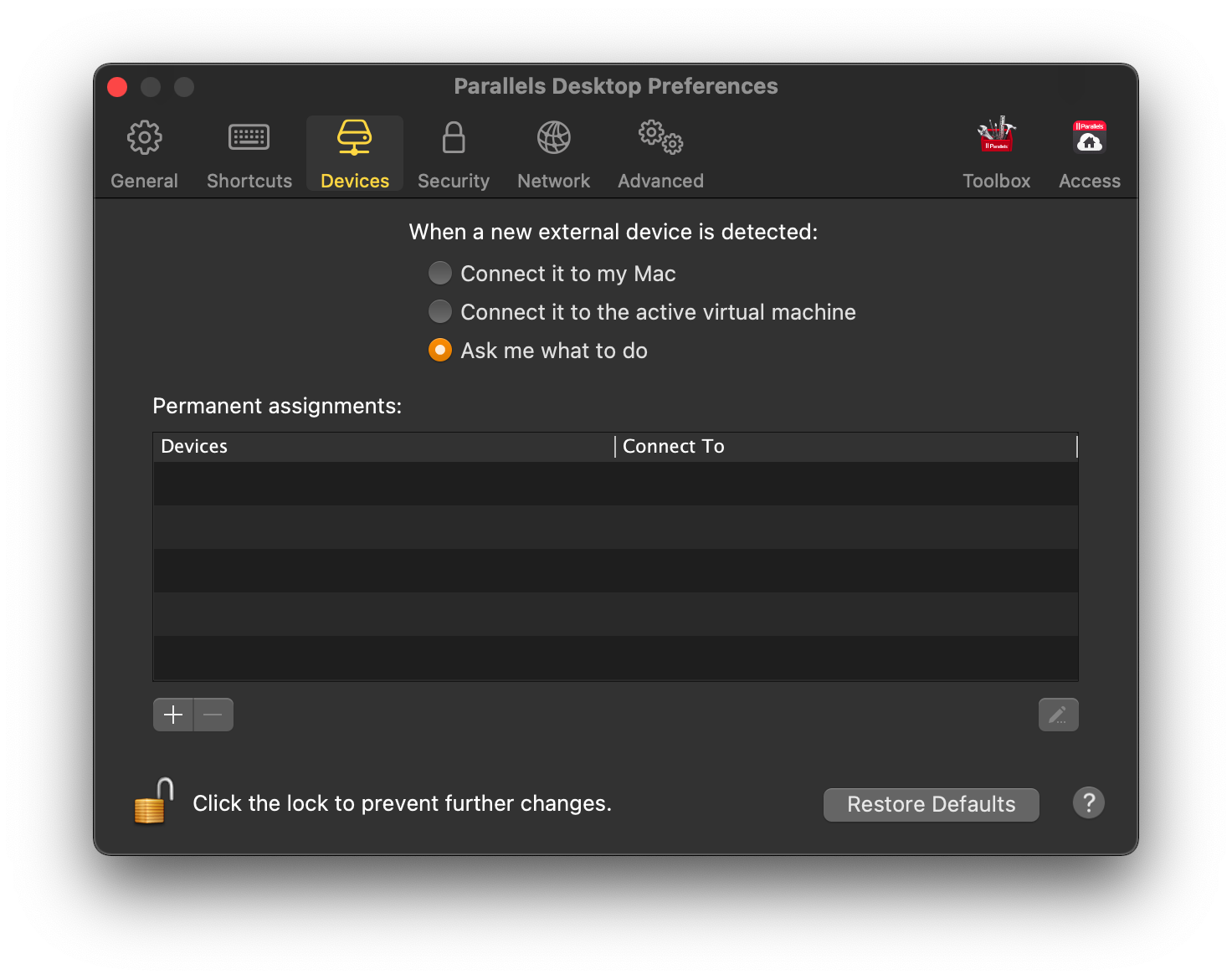

You could try uninstalling and reinstalling the driver on the virtual machine. But...as I said, if it doesn't connect to the guest machine, I don't see how it could load the driver. But maybe I'm wrong. So...you could try that, too. Do you have Parallels set to ask you every time a new device is connected? If not, you could try that too. Also, if you have the device added below, maybe try removing them so it can ask you what to do with it...? Just an idea, of course.

I already had this settings in the machine and tried to do everything you said... I don't really know. I will wait for parallels update or so....

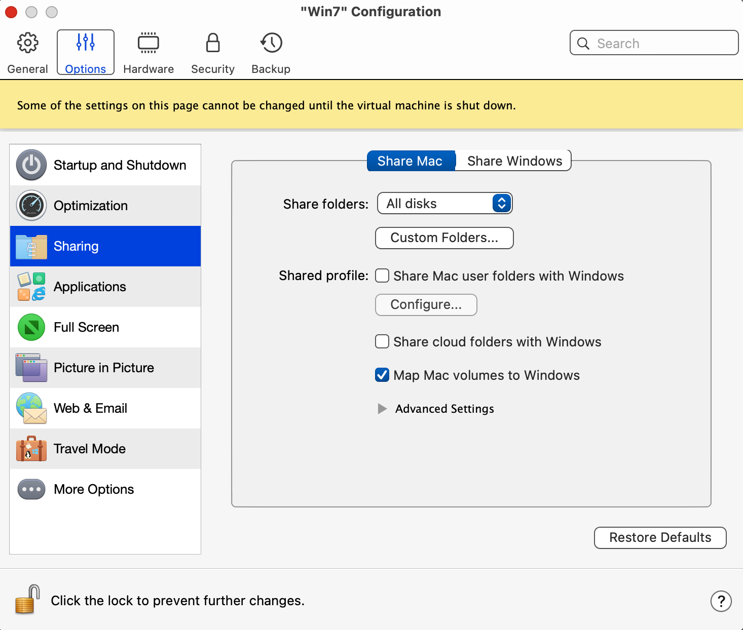

I have tried another trick for usb stick/disk. Go to guest OS settings in parallel desktop.
Options -> Sharing -> Map Mac volumes to Windows. Take the attached screenshot as reference.
Then you can see it as web shared folder in your guest OS.

Sadly it does not work, when I select an usb device in the list I can't access it. It is not important to me to access storage devices but yes to my keyboard special functions (not an Apple kb) and a few extra devices as a special sound device.
