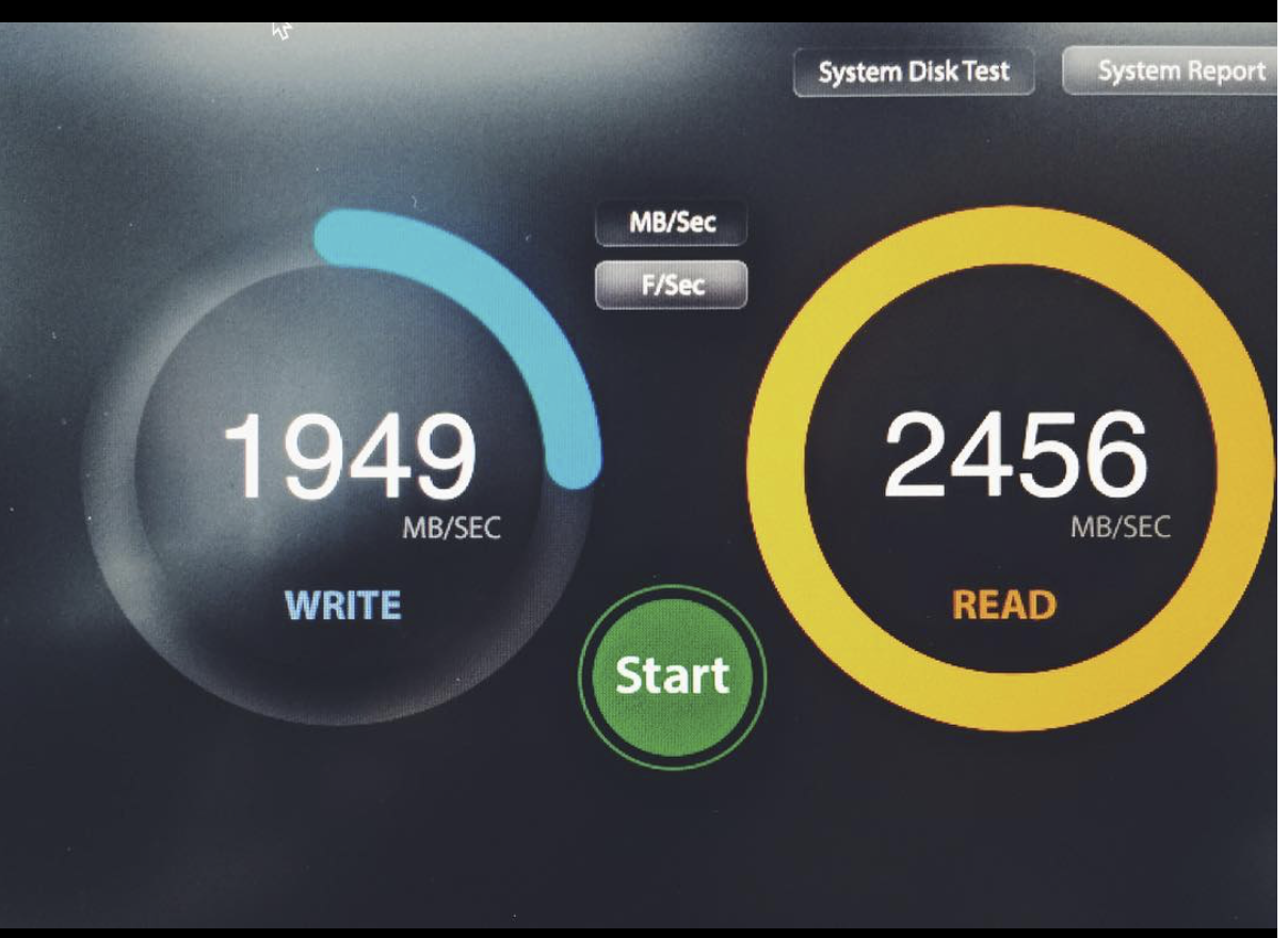

Here is a screenshot of a screenshot (haha) of a quick test from some time ago though:
A tad faster than i remembered actually
EDIT : Maybe I misunderstood what you wanted a screenshot of 🙂

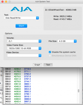

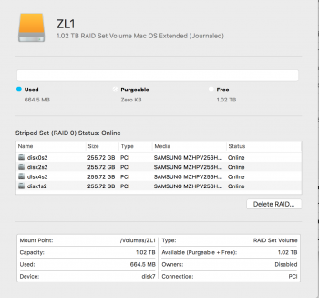

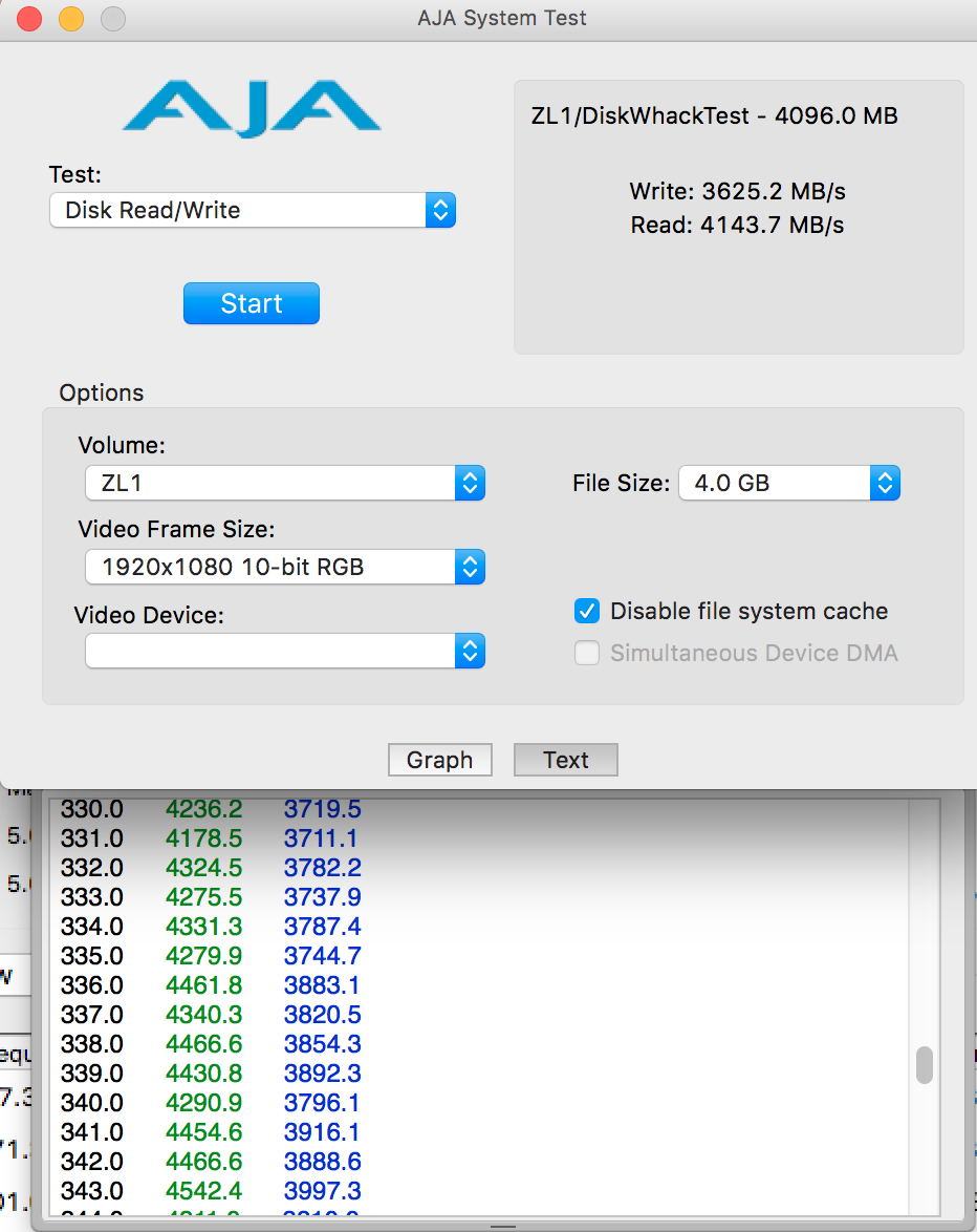

I am running a X16 Amfeltec with only 2 x 960 on
For customers we build often a x8 or x16 Amfeltech with 2 or 4 x HyperX and we did that a few times with some 960 EVO too

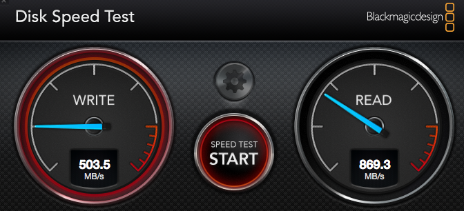

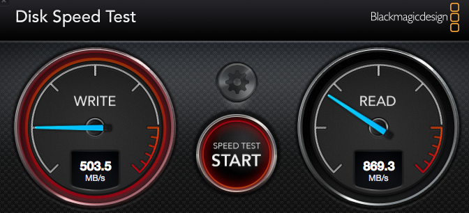

I'm using a TempoSSD Pro Adapter with two 256GB SSD in a RAID 0 right now.
For my work I've to use Bootcamp in the future, but when using the TempoSSD Pro you can't boot from another device (don't know why, but a lot of people reports that).

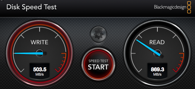

In this thread some people got around 1400 read/write
I get "just" speed around 500 write 900 read
