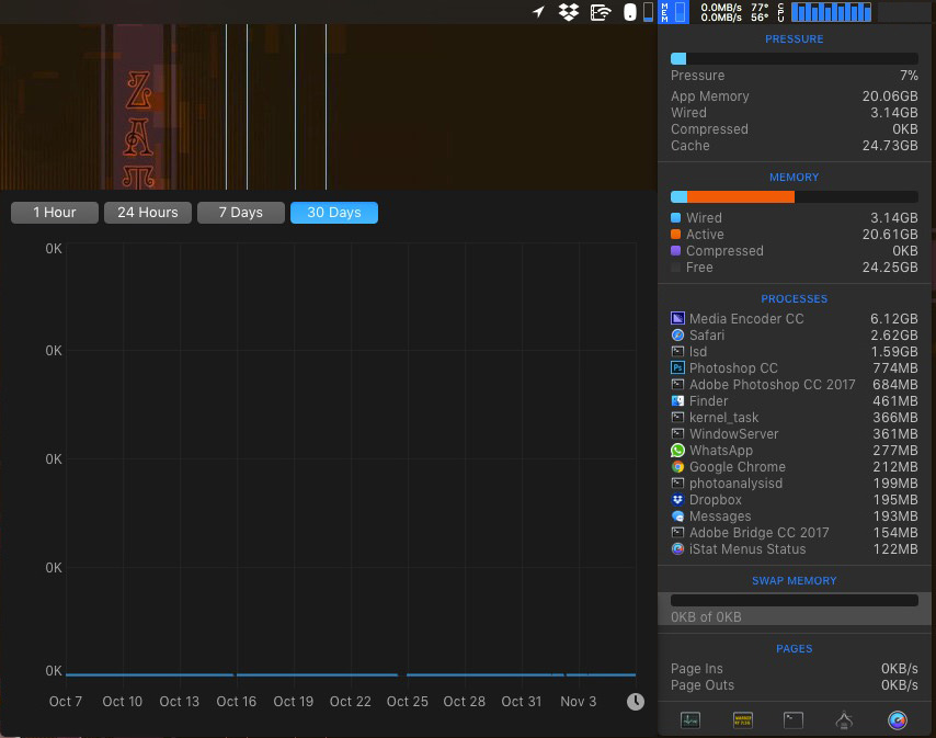

Since NVMe SSD is natively supported in HS. So, I personally highly recommended to run 10.13.1 if anyone want to install NVMe SSD on cMP.
And interestingly, since I upgrade to HS. My system never use any SWAP, not even 1MB.
In Sierra or before. When I encoding large video. The system, of course will use all free RAM as cache. But even the memory pressure is very low, the system will still use around 5GB SWAP as well. That looks a bit strange to me. The system use RAM as cache to speed up the process, however, also put some useful data into SWAP to decrease the system performance.
Now, in HS, it never happen again. So, unless you really running out of RAM. I don't think boot from NVMe will give you any real benefit.
For boot time, it's more or less the same as an SATA SSD.
For sequential speed, it's roughly the same as AHCI on cMP.
The system almost never use it as SWAP. (If it does, then you should put more RAM in, that's much cheaper and more effective to alleviate the problem)

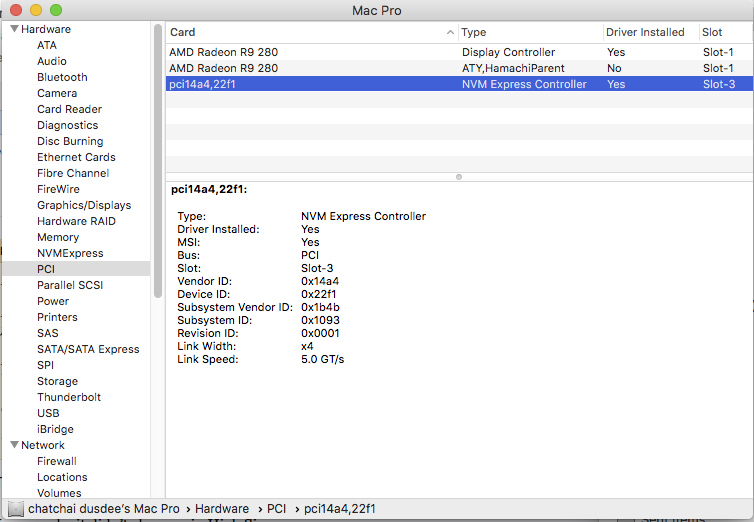

I did try to install Plextor M8Pe 512GB M2 MNMe SSD on Mac Pro 5.1 (2009) with HS 10.13.1 installed. It is invisible in Disk Utility but can see under NVMExpress for Apple xxxx and PCIE for pcie,xxx.
Please note for Win 10 pro installation it is workable and can see all NTFS partitions as normal.
The SSD disk speed test is about W-11xx and R-12xx mb/s.
Can anyone help to advise how to fix it visible and bootable on HS 10.13.1 in this case.
Thanks in advance.

NVMe is not bootable on 5,1. Unless you use another bootable drive and redirect the boot sequence to that NVMe drive.
No sure why it didn’t show up in High Sierra.

My Plextor M8Pe 512GB M2 MNMe SSD hardware information.

After few chat with pikeralpha about the NVMe being recognised as an external drive he told me about a patch to apply on the IONVMeFamily.kext
Disable the SIP
  1. Use a hex editor
  2. make the required changes in: /S*/L*/Extensions/IONVMeFamily.kext/C*/M*/IONVMeFamily
  3. Search for..: 0x48, 0x85, 0xC0, 0x74, 0x07, 0x80, 0x8B, 0x00, 0x01, 0x00, 0x00, 0x10
  4. Replace with: 0x90, 0x90, 0x90, 0x90, 0x90, 0x80, 0x8B, 0x00, 0x01, 0x00, 0x00, 0x10
  5. Save the file
I did it but my NVMe is still described as an external device on system info and Disk utility.
Any suggestion?
I guess until the SSD will be seen as an external device TRIM won't work.
