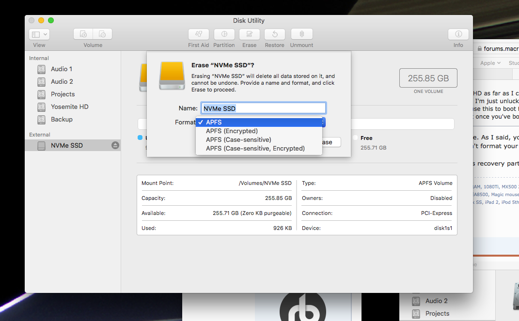

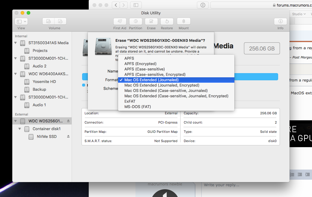

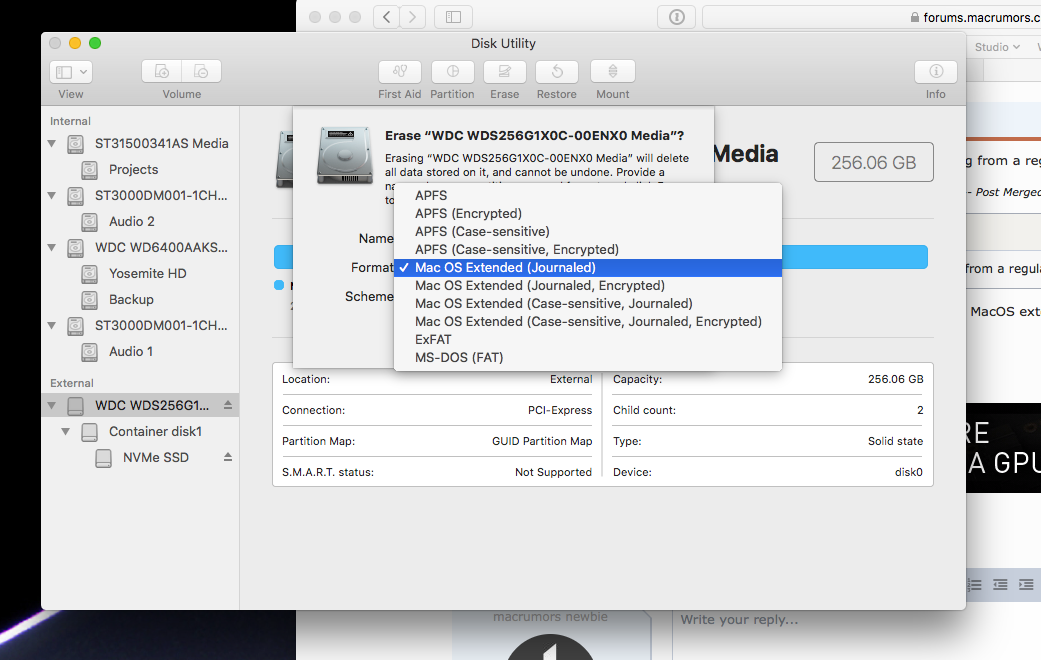

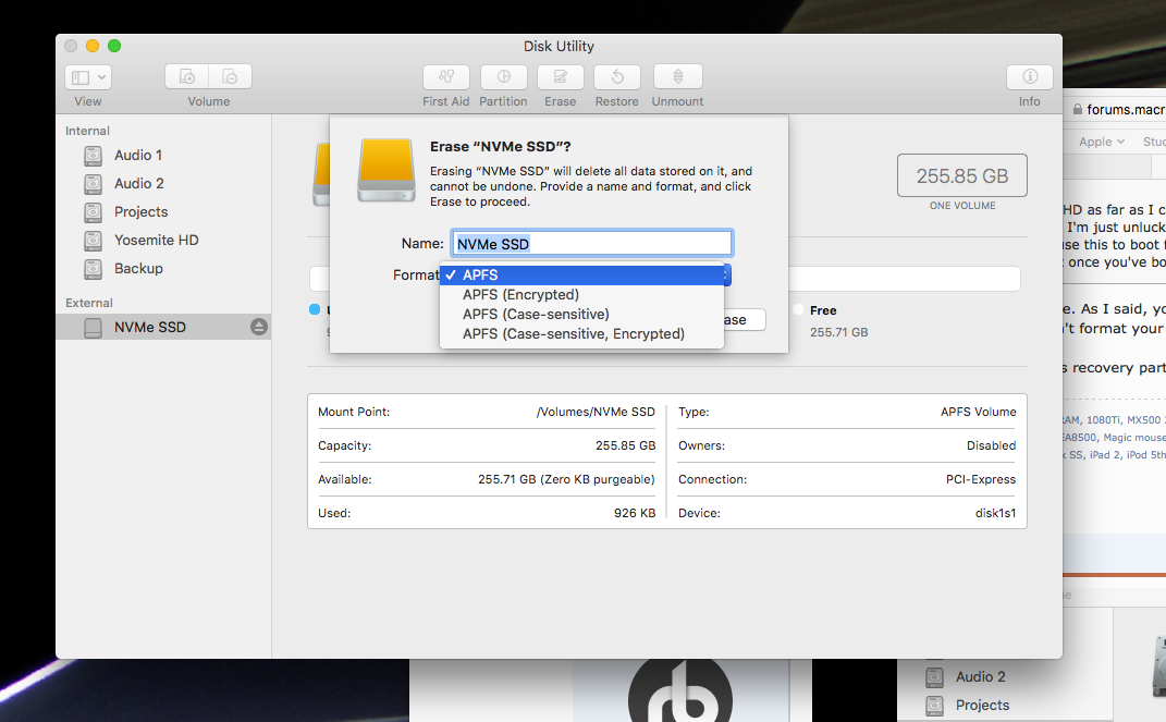

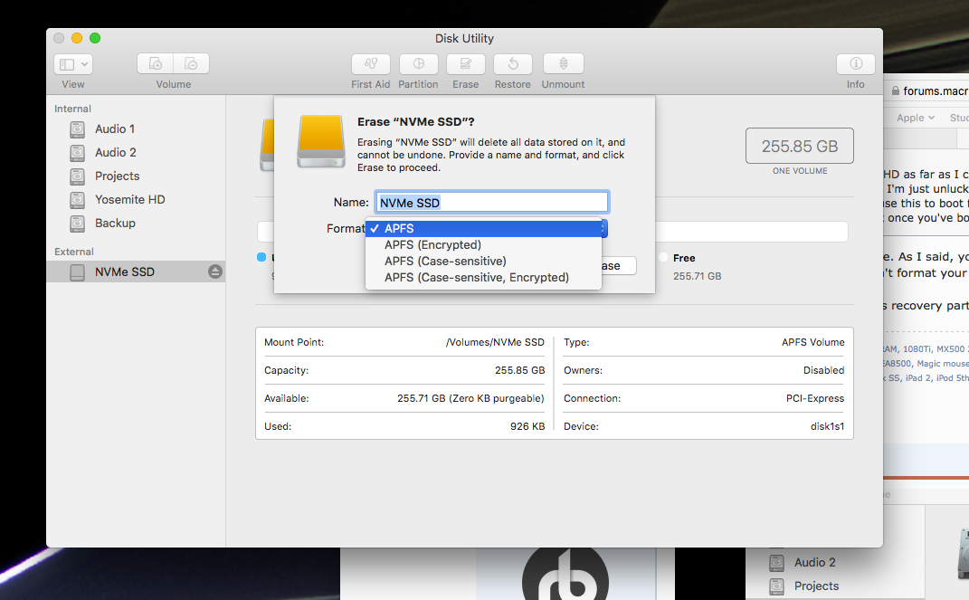

Tried to reformat to HFS+ but it no longer seems to be an option
Go for HFS+, APFS bring you more headache than happiness.
Doesn't seem to be possible once formatted to APFS unless I'm missing something

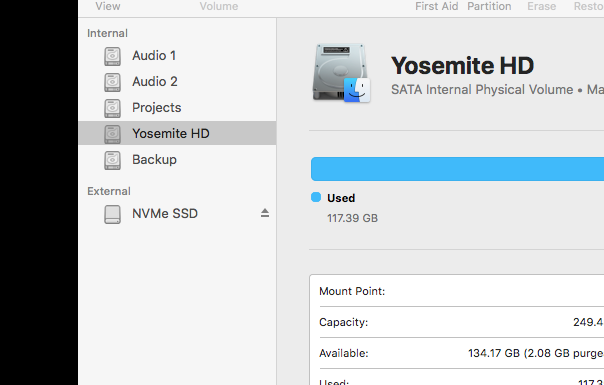

Make sure you select the drive, not the partition. You can't format a drive inside a partition.

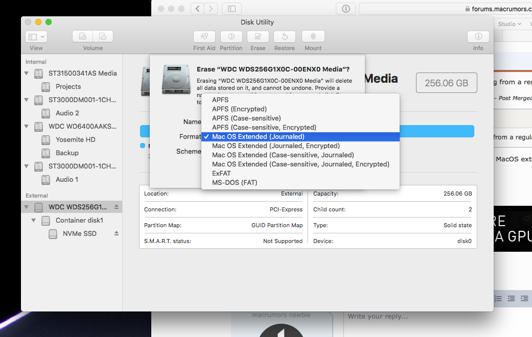

OK after a bit googling it seems that once you've booted in recovery mode HFS+ is no longer an option.

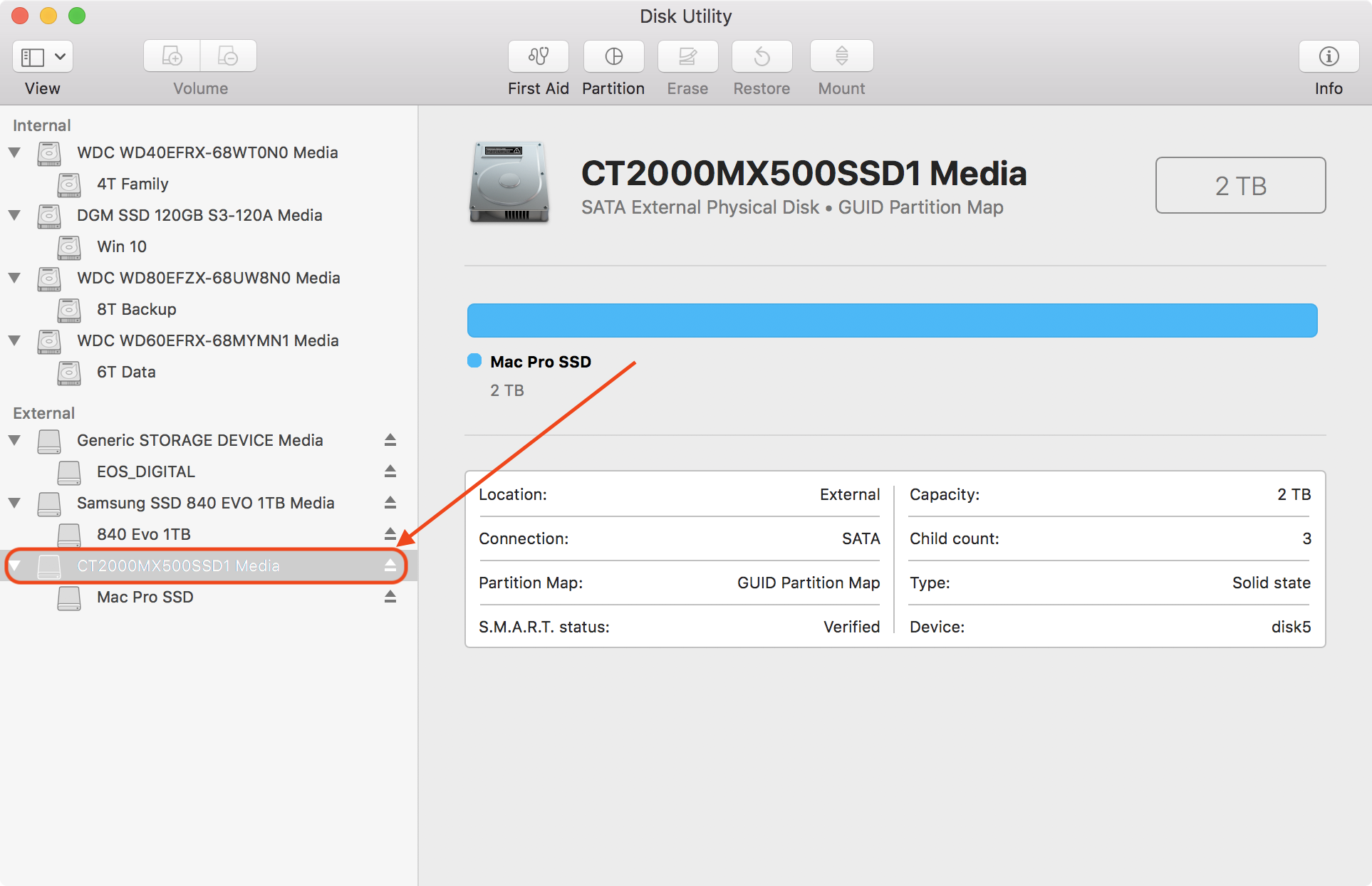

You have to boot from another drive. As I said, you cannot format a drive if you already inside a partition (you boot from a partition). And you can't format your boot drive.
But if you boot from another drive's recovery partition. You can format your APFS SSD back to HFS+.

Ok got you but I'm still not seeing HFS+ just MacOS extended and some FAT stuff

MacOS Extended is HFS+
[doublepost=1528898815][/doublepost]
And that's exactly why I made post #184 to ask you to choose the drive but not the partition.
OK it's just that when I first formatted a couple of days ago the option appeared as HFS+, anyway I went for macOS Extended (journaled) and its still showing 200 MB/sec write

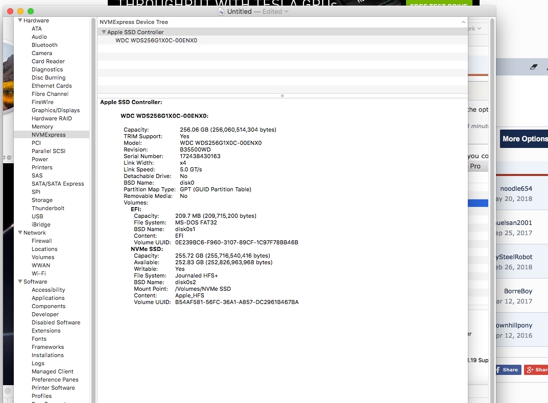

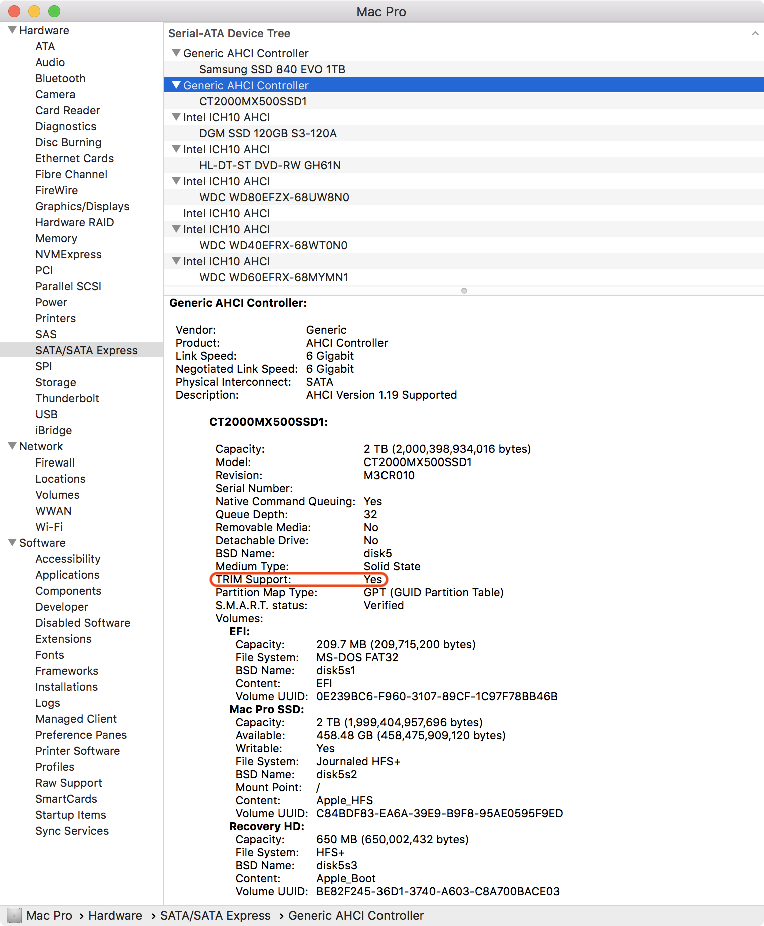

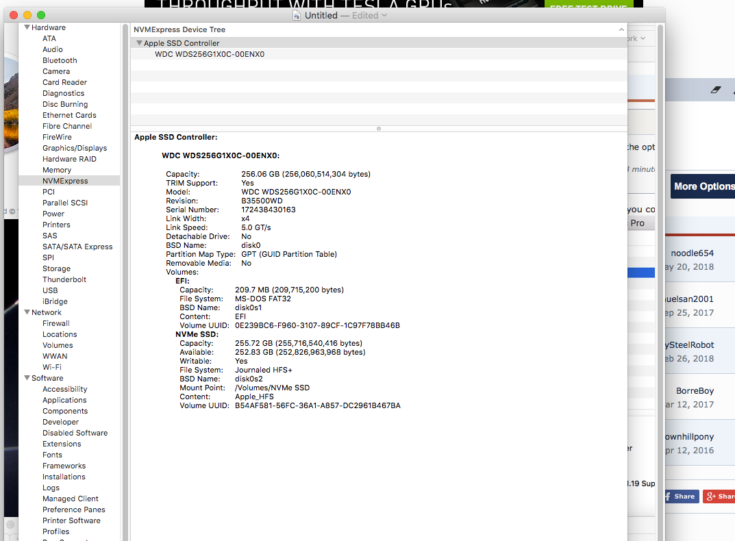

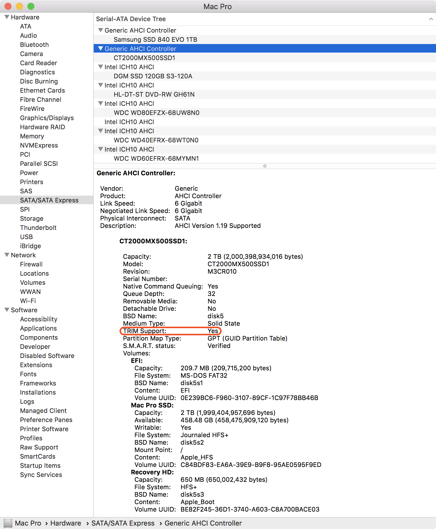

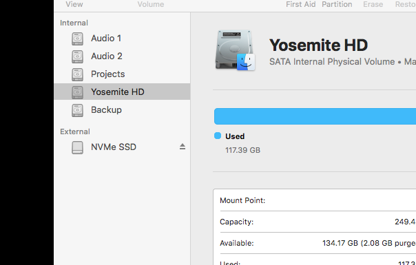

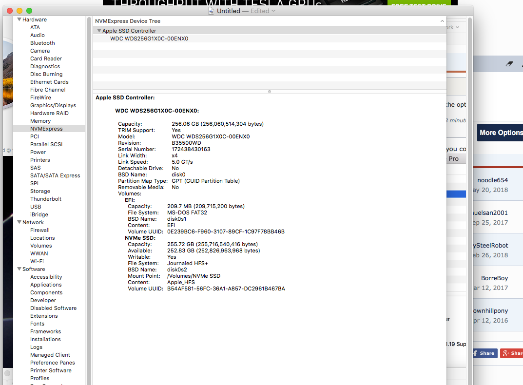

So, the NVMe SSD is now newly formatted to HFS+. And you confirmed TRIM is activated in system info?

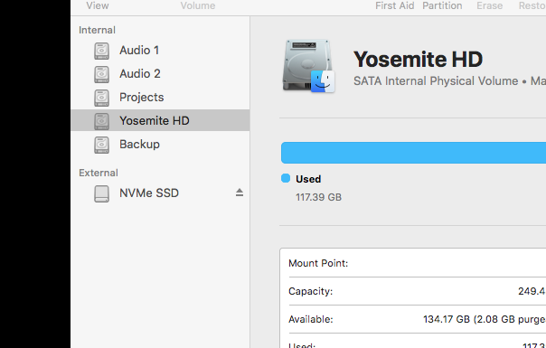

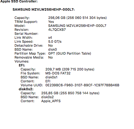

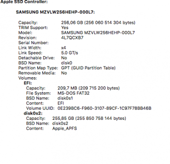

Ok well that's different... mine doesn't appear under the SATA/SATA Express heading, just NVMExpress

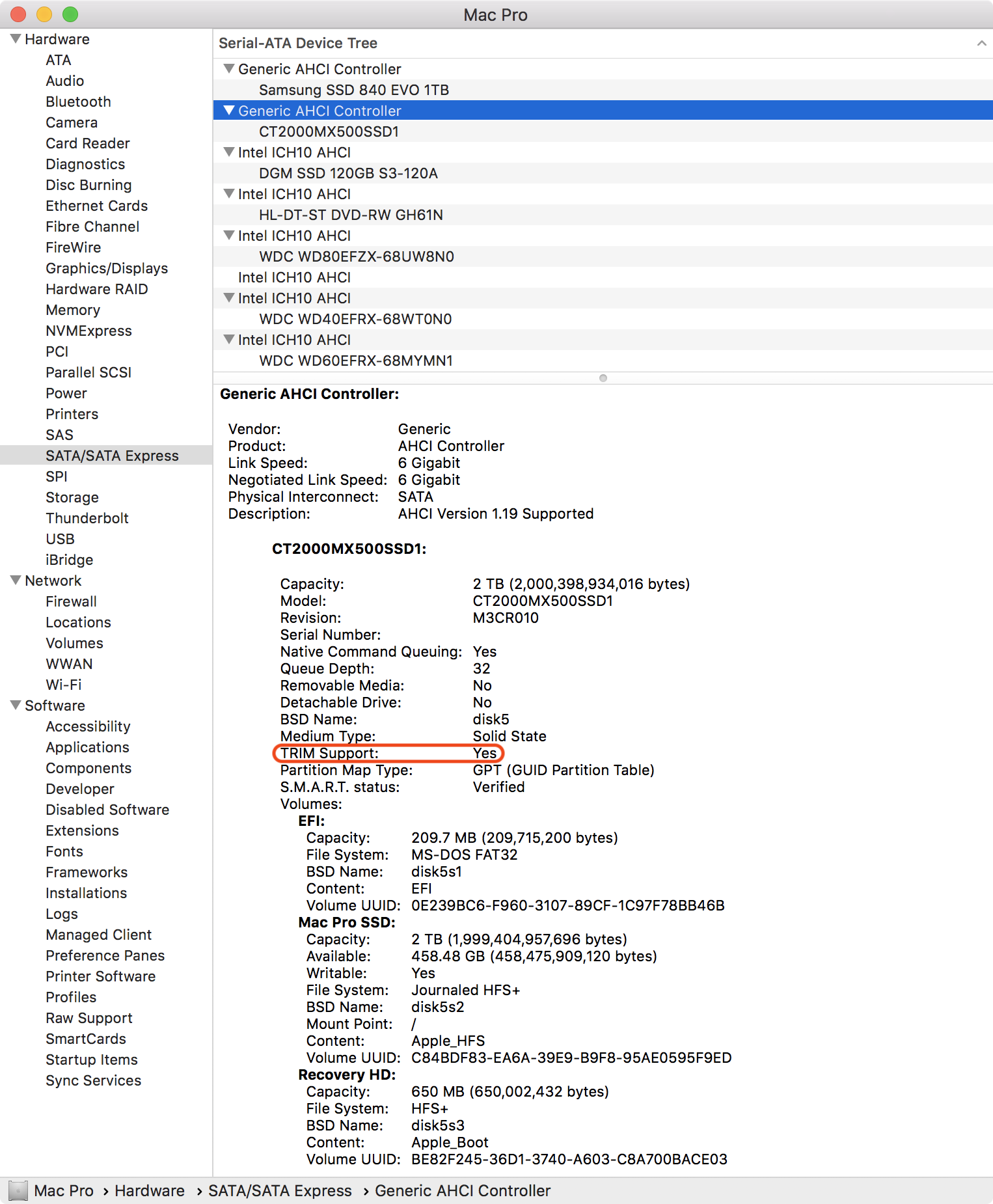

[doublepost=1528902893][/doublepost]This was the case after I first put the card in 2 days ago.
[doublepost=1528903062][/doublepost]Software? SSD? Card? Mac Pro? I haven't a clue
Is it worth installing a new copy of the OS on a fresh disk?

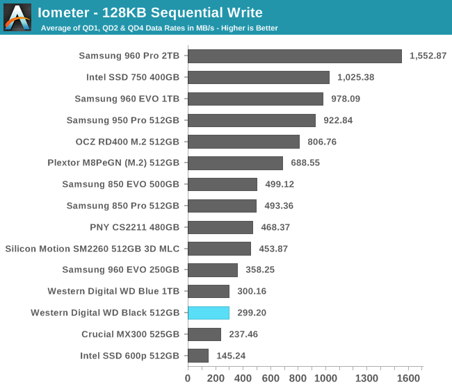

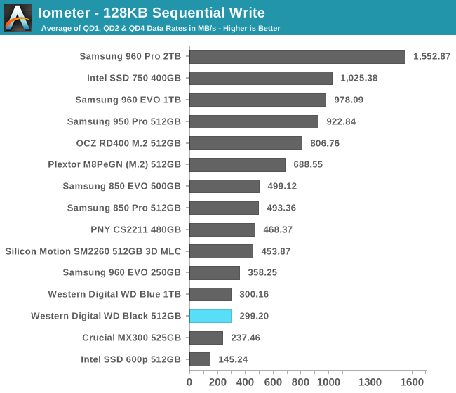

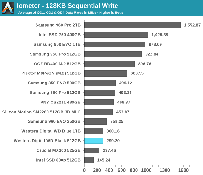

I just check your SSD's spec and review. 200MB/s sequential write may be normal indeed. Even the 512GB model can only do 300MB/s in real world test.
Jeez where was that chart when I needed it. Guys I've wasted your time and I'm really sorry about that. I can see why the 960 leads the pack.
[doublepost=1528904168][/doublepost]
On the Scan site it says 700MB/sec. I'm asking for money back.
May be you can only achieve that 700MB/s under very specific condition. I don't know. But so far, this doesn't looks like a good choice for NVMe SSD.
For me, the sole reason to go PCIe SSD is the sequential speed. And this model fail to deliver.
If I only want low latency, SATA SSD is good enough.
