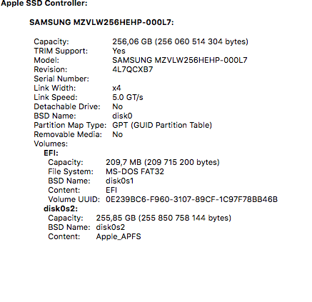

I install SSD View attachment 767702View attachment 767704
on Mac Pro 2009 5.1
and not boot from this ssd

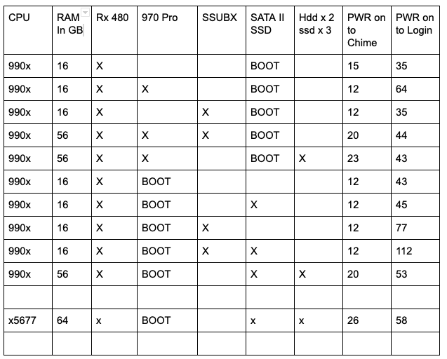

PRE-CHIME Boot times are MOSTLY effected by...
RAM. 16GB ~ 12 seconds pre-chime. 64GB ~ 26 seconds pre-chime
Adding storage volumes does not seem to effect pre-chime timings.
A secondary SATA III controller may delay pre-chime (not tested)
POST-CHIME boot times are MOSTLY effected by....
Booting from NVME with additional AHCI/SATA Express PCIe Storage.
The NUMBER of storage volumes
Video card in slot #2. A reproducible 3-5 second lag/beach ball happens in login process.
BOOT TO LOGIN SCREEN (with 16GBx1 RDIMM)
SATA II SSD is still the fastest to the login screen at 35 seconds from power button. After boot, OS behaves LAGGY compared to 970 pro..
NVMe 970 pro SSD comes in second at 43 seconds from power button.

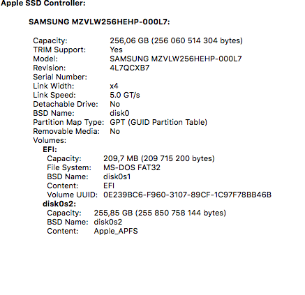

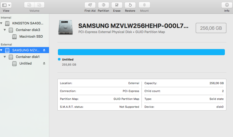

Why would you buy a PCIe crad with preinstalled OSX? And regarding the picture, it looks like an NVMe card. I have no experience regarding SM951 but some with Samsung EVO 960. And the first thing I needed to do was to change the Firmware on my cMP 5.1. And then I did a fresh install of OSX on in it. But maybe I´m wrong here. Can this SM951 boot without Firmware upgrade? The boot choice was made in bootdisk in preferences. Am I barking at the wrong tree?

The AHCI version of SM951 boots on Mac Pro without any modification, fully supported.
Any AHCI M2 PCIe SSD boots without firmware mod on a Mac Pro.
I see. I learn every day. Thanks tsialex! Then I fully support the buy.
