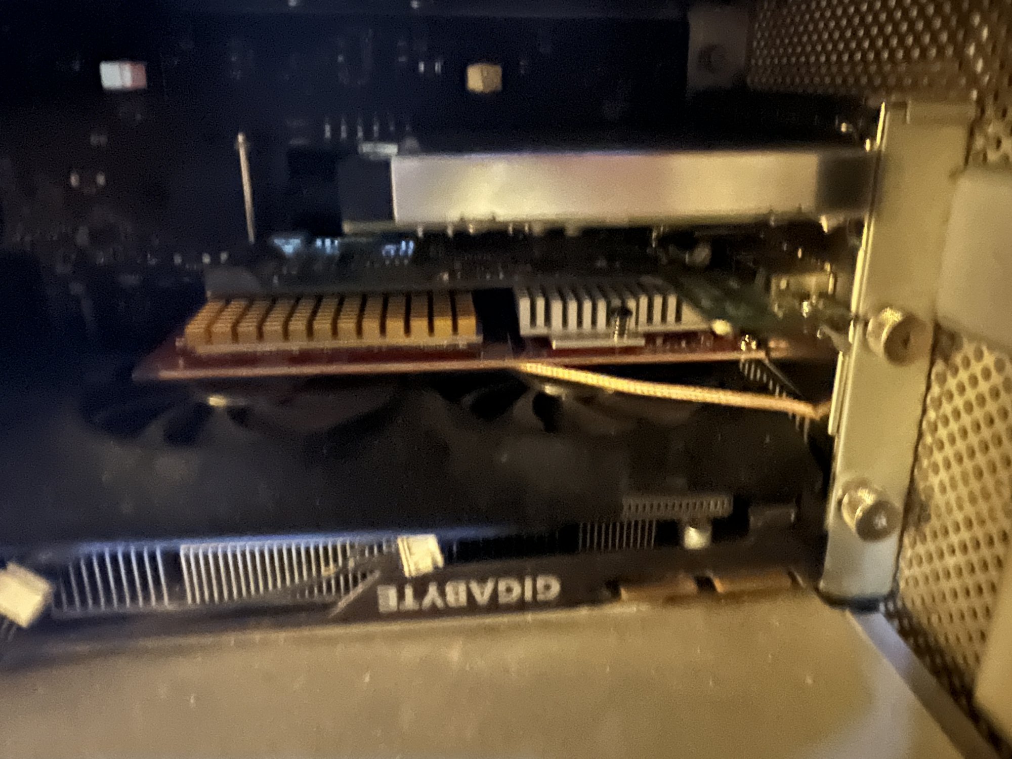

It has to be in PCIe slot ##2 in the 5,1 to get those speeds right? My RX700XT eats into slot two so I can't use it. Only slot 3 is available and its a 4X slot. I have a Titan Ridge in Slot 4.
Really I don´t know. Let me check it…
Slot 2. Titan in slot 4.

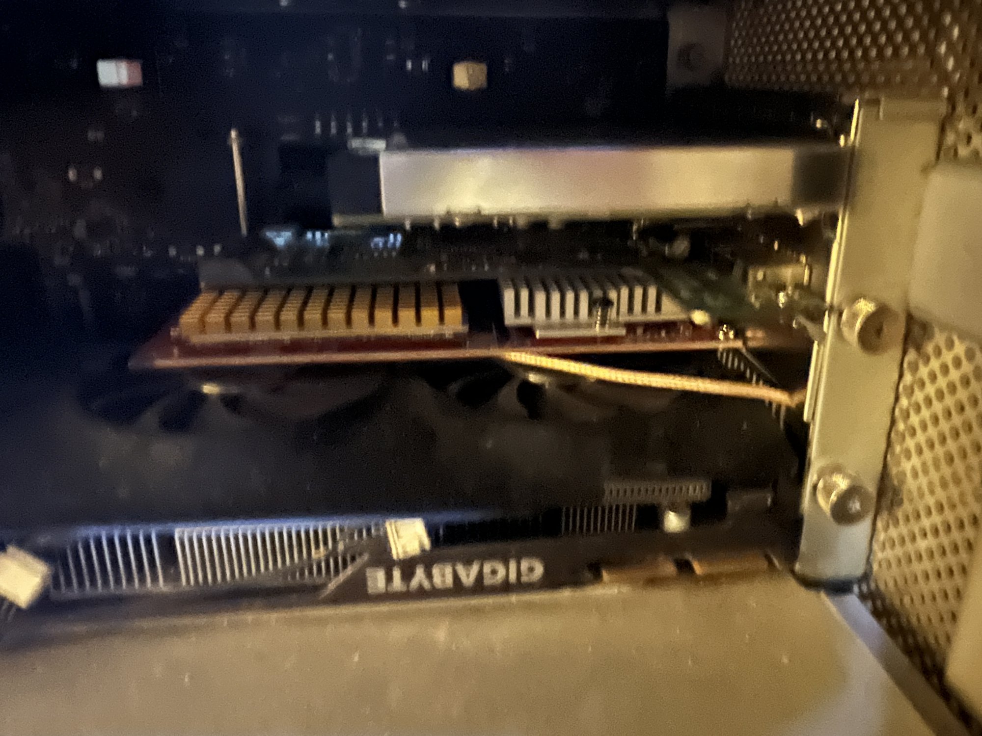

anyone using the Sonnet M.2 4x4 (fanless version) with an RX580 gpu? (on a 5,1)
If the full-length Sonnet is placed in slot 2, are there heat concerns in terms of blocking the fans on the RX580? can anyone share a pic of this arrangement?
Reactions: benny gsr
It would depend on what GPU you put in slot 2, if a RX580 or something like that then yes it would block slot 3, but to get the best speed out of your M2 sonnet it would need to go in slot 1 or you will block the fans on the RX-580 and will cause it to over heat. if you need all 4 slots then your going to have to change your gfx card to something slimmer with rear blower fan design.

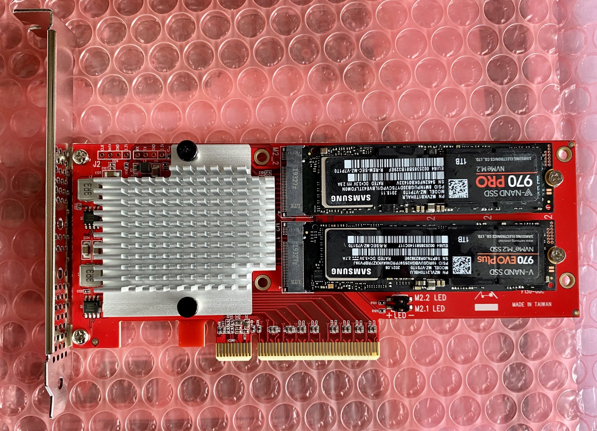

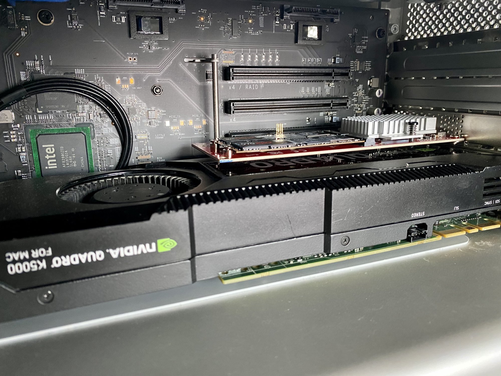

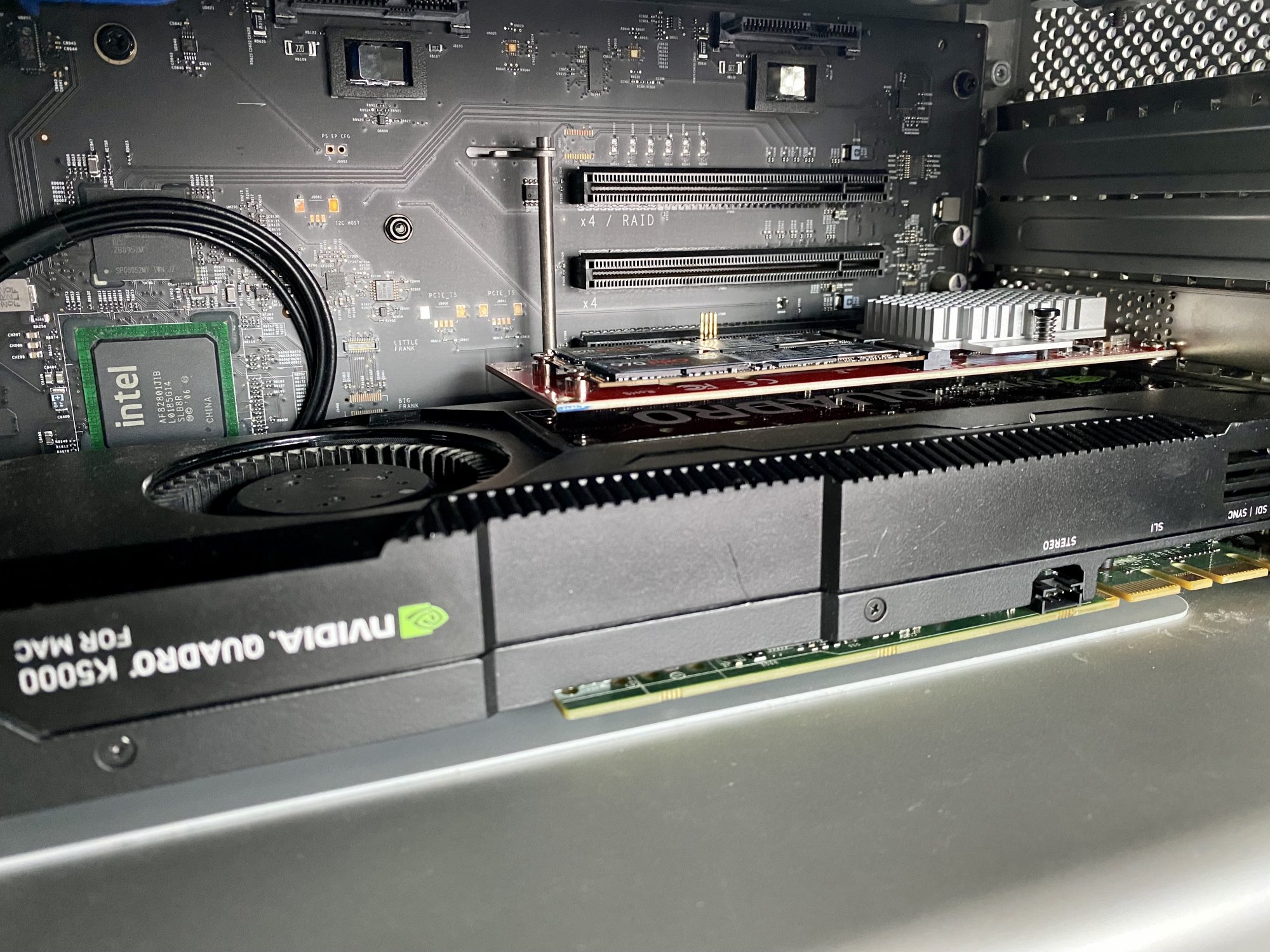

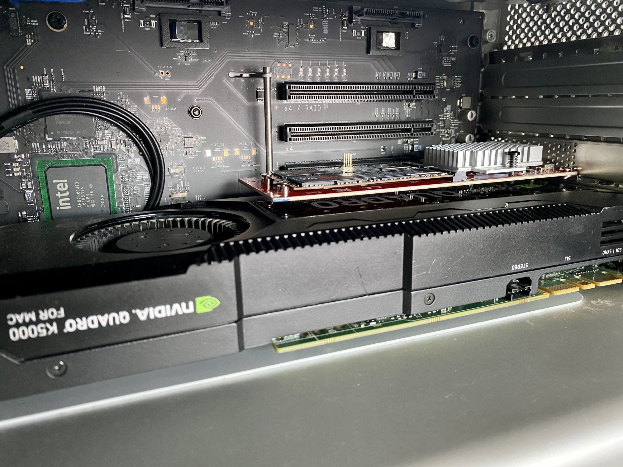

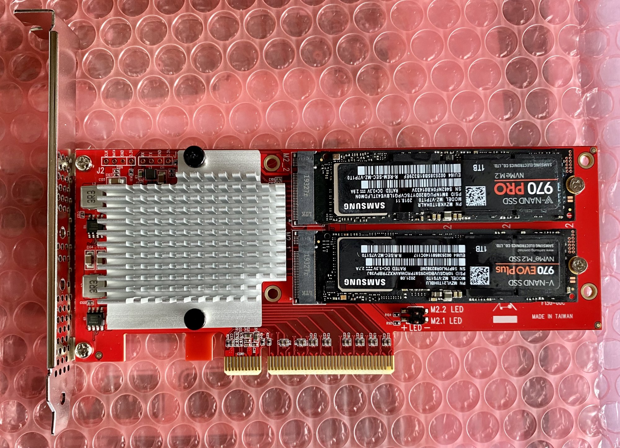

Well the StarTech PEX8M2E2 with two Samsung 970 blades is up & running.
Fits well in Slot 2 with the Quadro K5000 staying in Slot 1 and as I thought due to the StarTech being a short card it does not impact the single fan on the K5000 in any way and keeps things nice & tidy with Slots 3 & 4 free for future use.

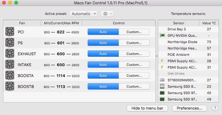

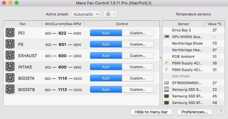

Temperatures have risen @10c compared to the Sabrents and I have ordered a couple of Gelid SubZero heatsinks from Amazon which should be here on Thursday so I'll be keeping my eye on it until then. It normally runs 24/7 but I might even shut it down overnight just to be on the safe side!

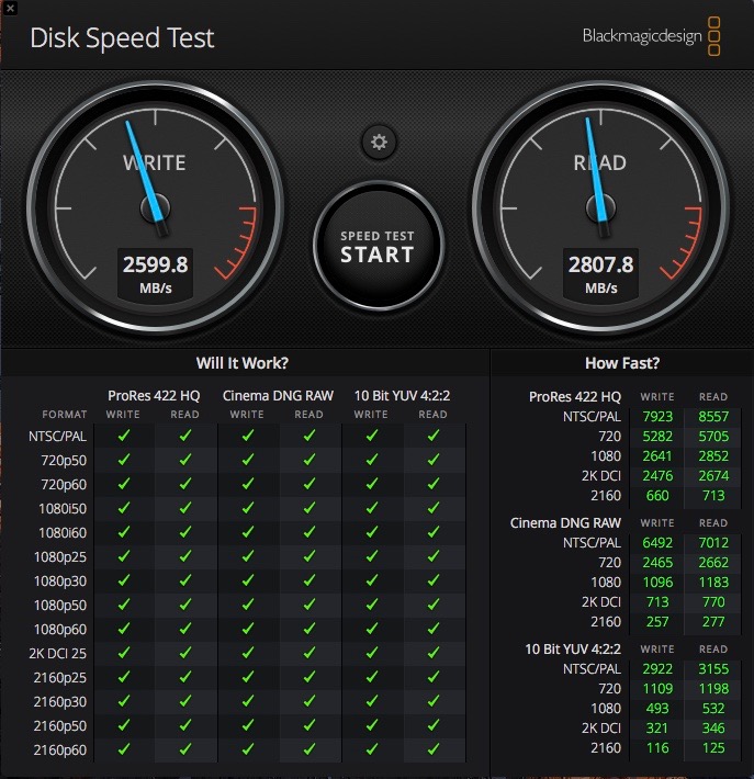

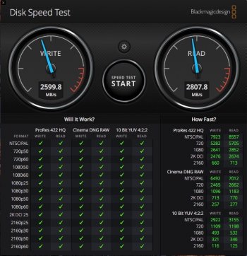

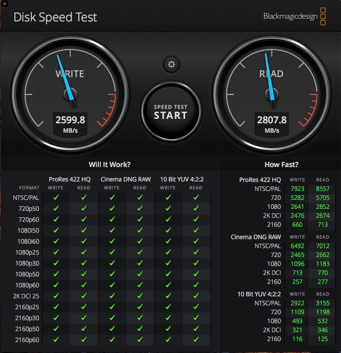

Not the fastest kid on the block but disk speed has just about doubled over the same blades in the Sabrents @1400MB/s which were themselves around 5 times faster than both the Samsung SSD and Seagate HDD @ 250MB/s in the drive bays so a good result with minimum outlay as far as I am concerned.
Early days yet so will have to see how reliability goes but if I even have one crash that will be one more than I have had since I got 'Big Mac' up & running in December!

Looking very good glyn, and for the speed increase and cost I think they are great value for the money the startech boards. I updated the firmware on my blade, it did make a small difference in speed but not much. but was a recommended update for the 980pro before Mac use.
And this board suits your GFX card and layout perfectly in slot 2.

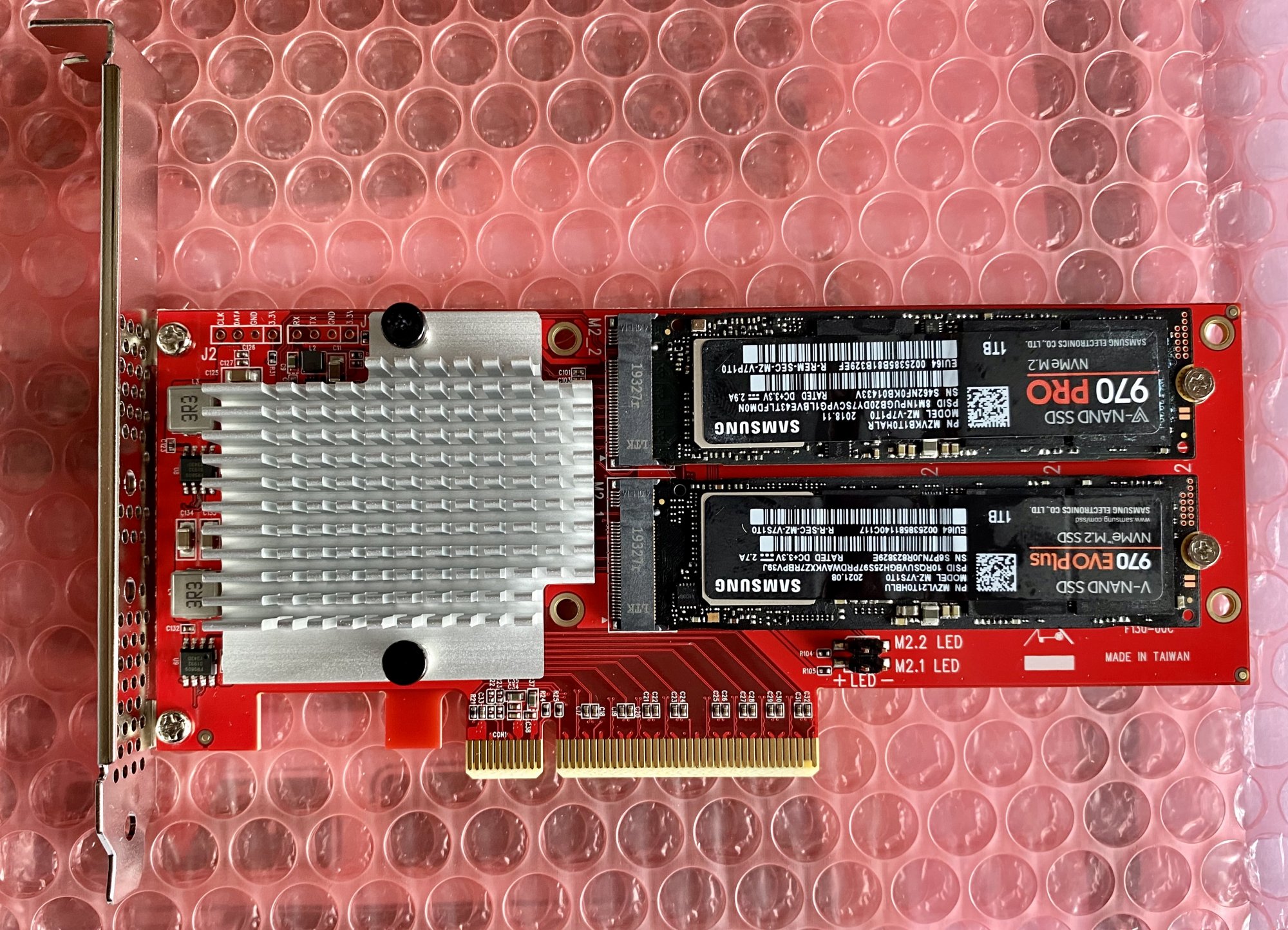

I've got a very similar Ableconn PEXM2-130 Dual for about 120$ on amazon (it's 150 now); same speeds little above 3000 in slot 2 and single 1T 970 Evo plus and no issues till now.
It´s the same card, in fact.
As is the Lycom DT-130 it would appear?

Can anyone with this Lycom DT-130 type of card take a look to the side? Is there a pad or paste between the ASmedia and the heatsink?
Yeah i just installed the ableconn pexm2-130 and it has a thermal pad on the pcie switch. it's not perfectly aligned, sadly. may have to disassemble & realign

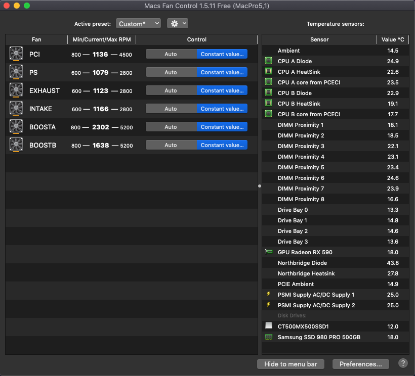

Just bought and installed the Startech card, with a 2Tb and 1Tb 970 Evo Plus blades - put it in slot 1 with my RX580 in Slot 2. Temps up a few degrees but upping the inlet and exhaust fan speeds a couple of hundred revs fixed that. Speeds are the same as @GlynH, a step up from my Kryo M2 card.
