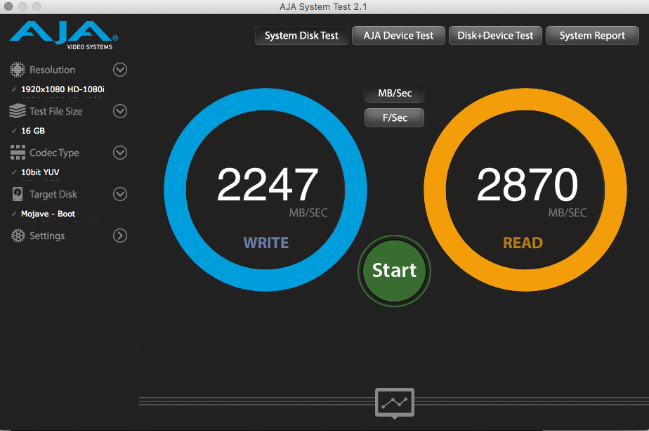

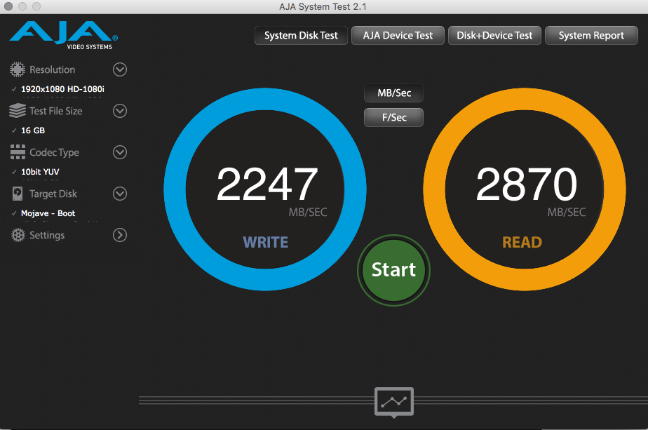

OnTrac delivered my package this morning. 11 days since ordering. I/O Crest card with two 970 Pros running as individual drives in slot 2. Formatted APFs. My speeds are:
I'm pleased. Now no more spinners, seven SSDs.
However, boot time has increased. The added time is before the appearance of the Apple. The white screen is longer, and there is more rolling text than with my SM951 AHCI1387914497.gif

OnTrac delivered my package this morning. 11 days since ordering. I/O Crest card with two 970 Pros running as individual drives. Formatted APFs. My speeds are:
However, boot time has increased. The added time is before the appearance of the Apple. The white screen is longer, and there is more rolling text than with my SM951 AHCIView attachment 812390

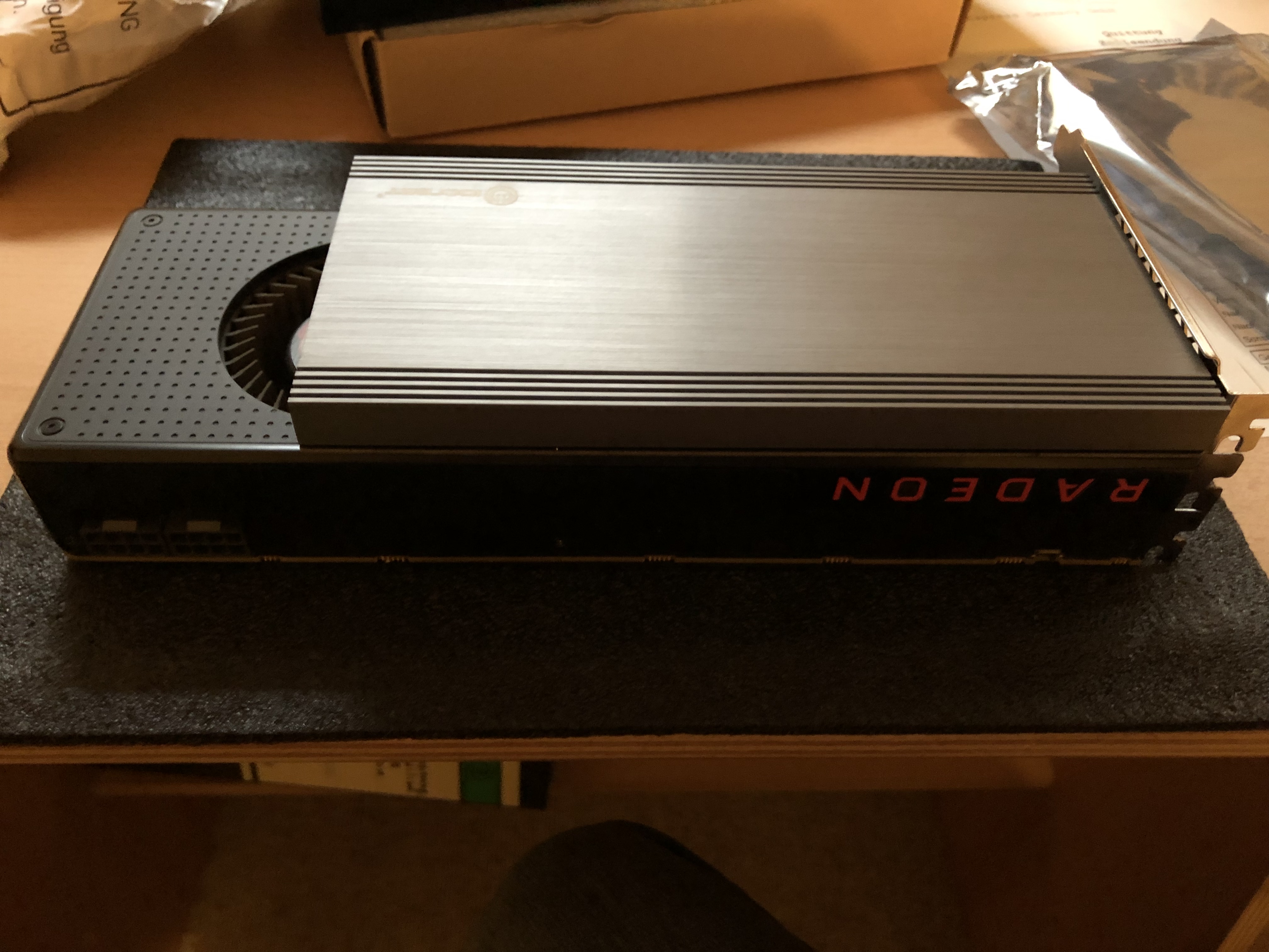

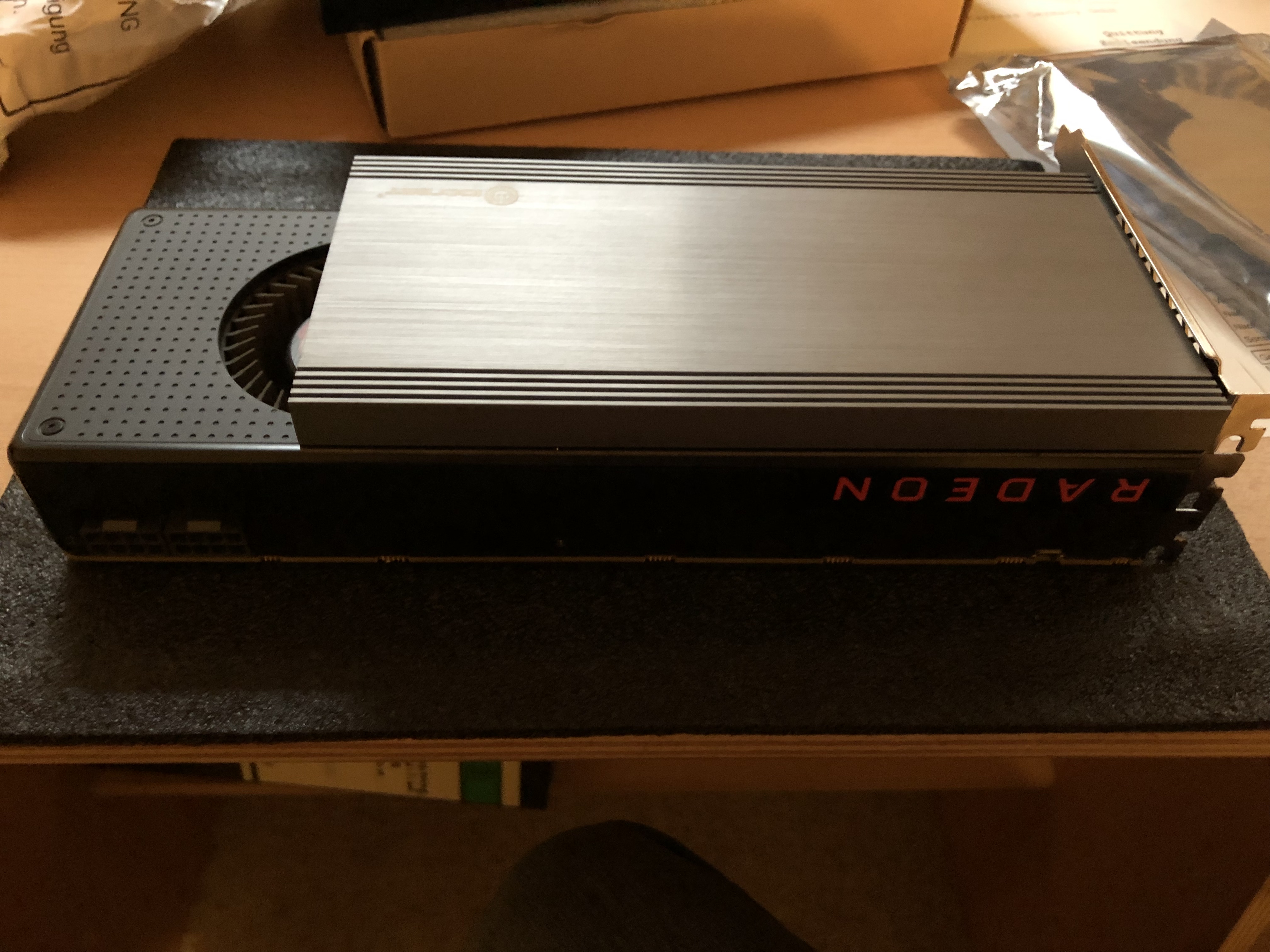

Double wide, I only lose Slot3. Since the USB3 is very short, I don’t have air starvation into the blower - this apply only to my blower type GPU plus SSD7101A, other types of GPU fan can have better solutions.
Mine also double wide. I tried to install the Iocrest in slot 1 and GPU in slot 2, but this way I also lost my Slot 4. No space for the ESATA/USB 3.0 card
Worked for me with eVGA GTX680 FTW+ 4GB, SSD7101A and Orico FL1100 USB3 card.
Some GPUs are really 2,2slots, like RX-580 Nitro+. Even Sapphire Pulse RX-580 fans are a little over 2 slots.
