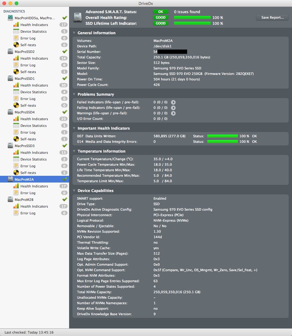

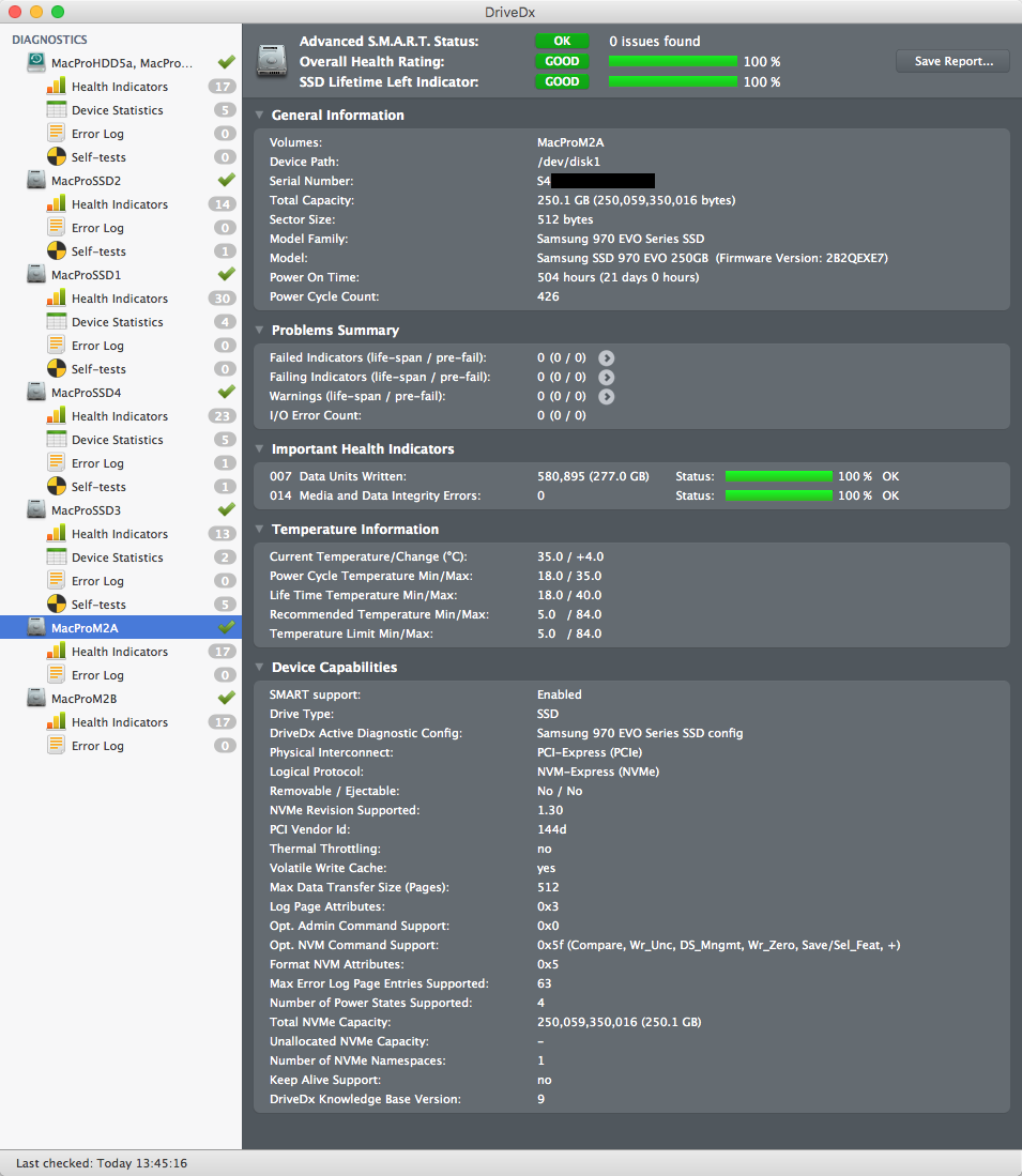

What tool are you using to measure the temps of the NVME drives? They don't show up within the usual fan / temp apps.
DriveDx has a Temperature Information section based on S.M.A.R.T. data.
