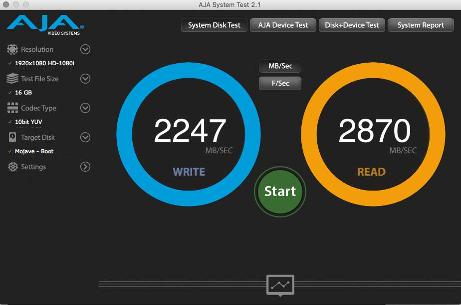

i think you can't use the extra speed in a cMP because of PCIe 2.0

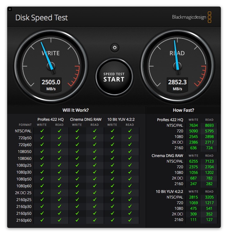

I'm buying an IOCrest PCIe x 16 adapter with a PCIe switch -goes in PCIe slot 1 or 2.
You can put two M.2 blades on the IOCrest.
. . . . . . then one gets the speed . .around 2,500 mb/s
