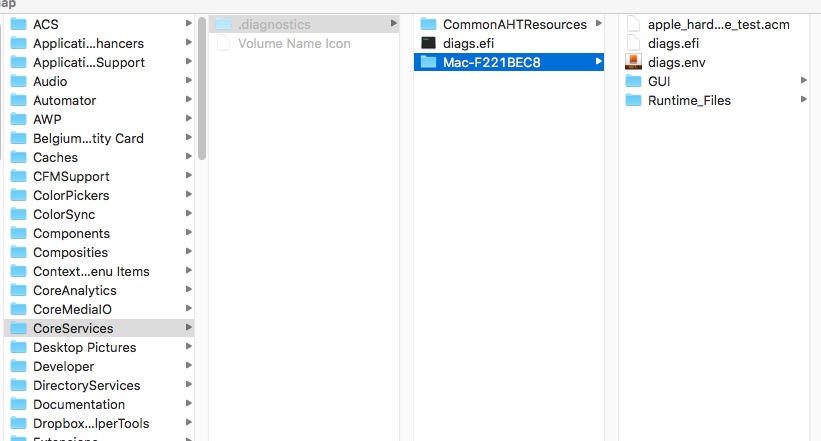

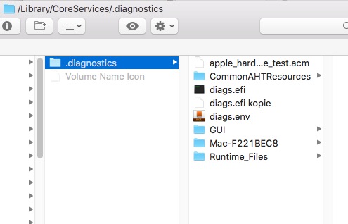

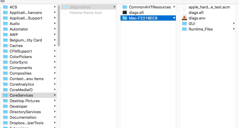

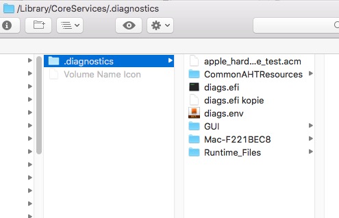

Is this hidden or not. Shortcut toggle does not seem to work.
Well this is unhidden .if it was hidden you would not be able to see it. Don't copy the whole folder just the contents . You see that file diags.efi together with the rest of them should go to the other diags.efi ( you don't need to override it) .
After you are done with copying hide the folder again .
Sorry, wich diags.efi ? The left one into the right folder (Mac-F221BEC8) or what? together with the rest of them?
