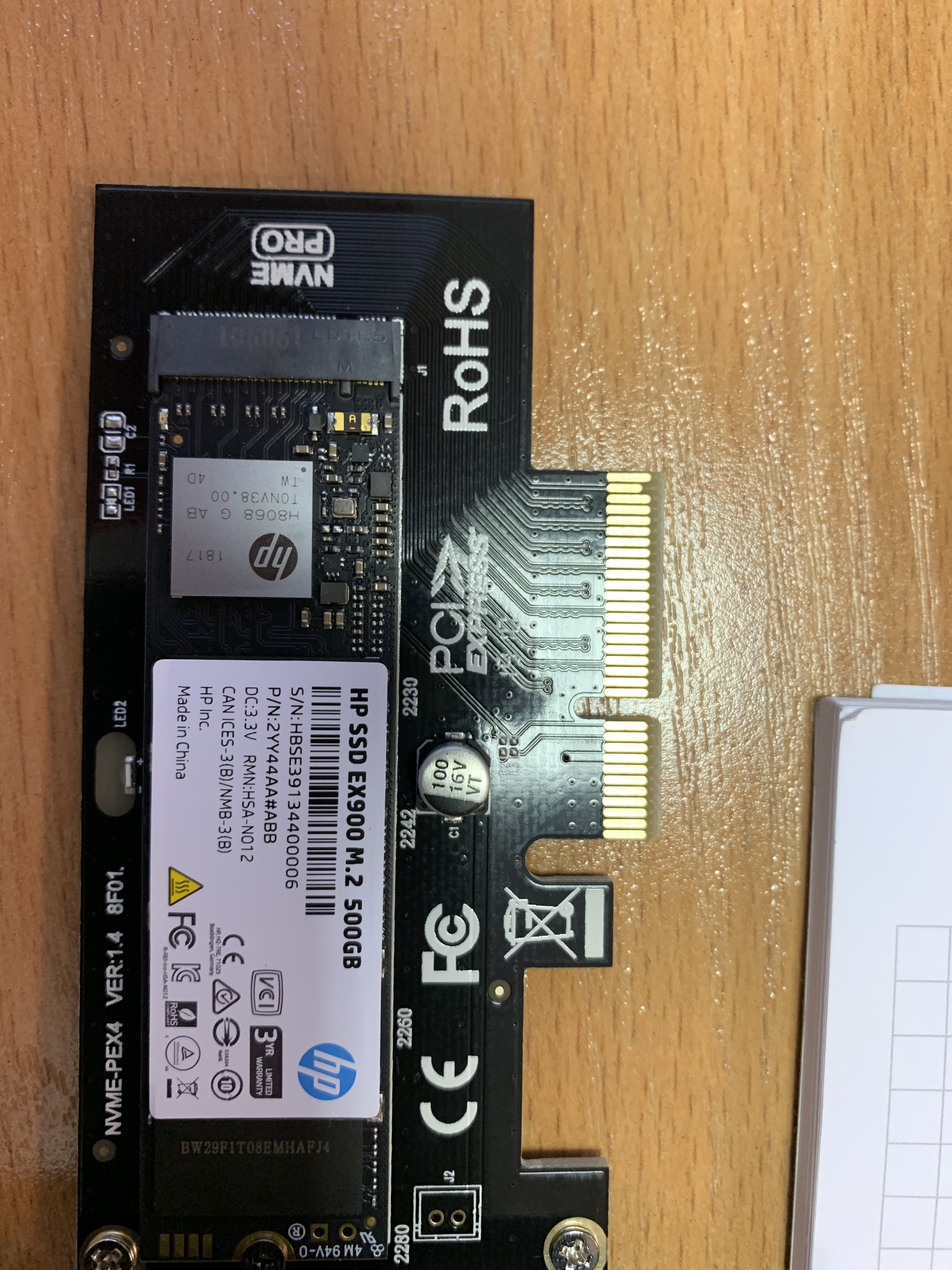

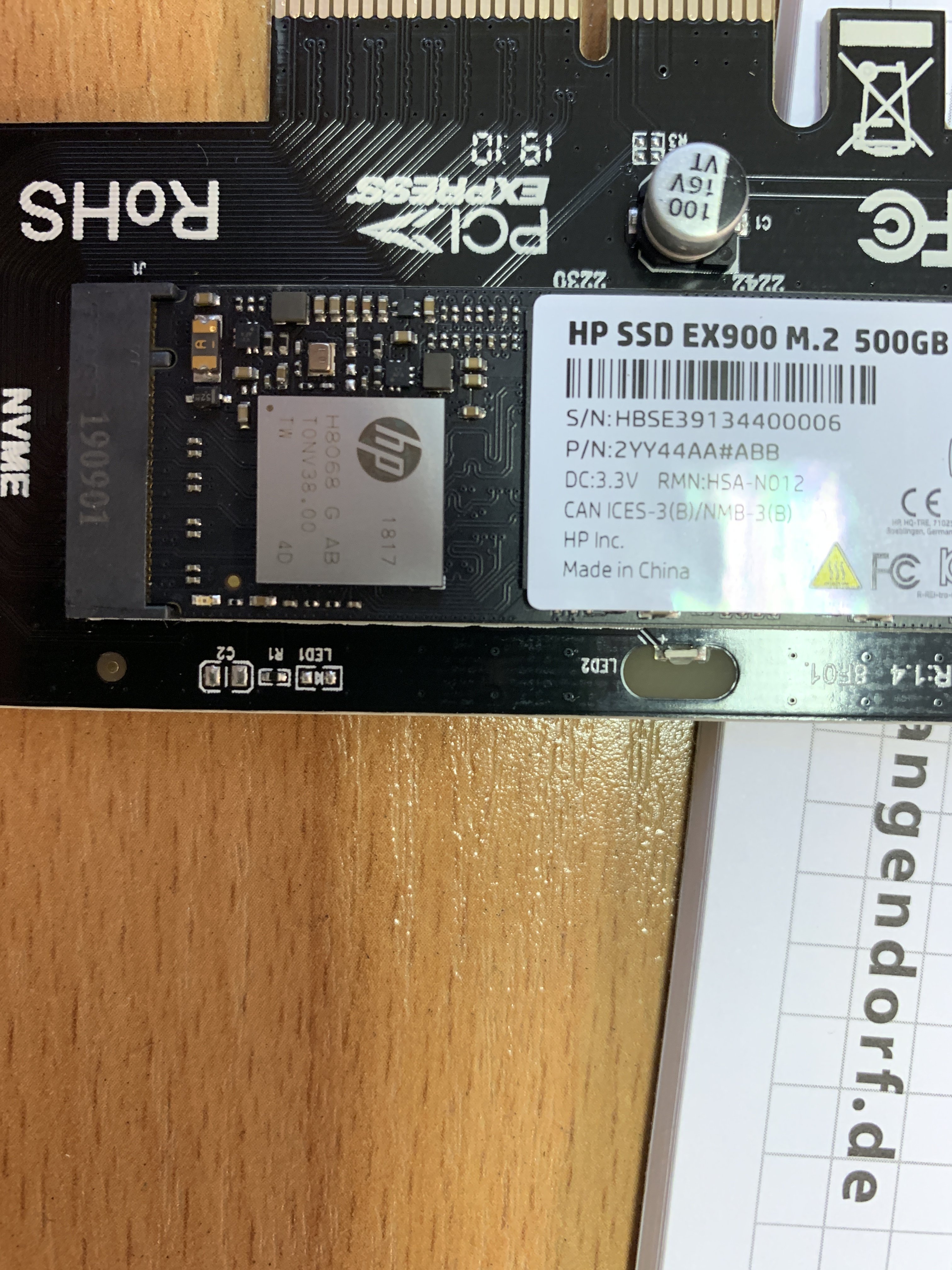

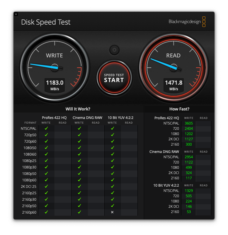

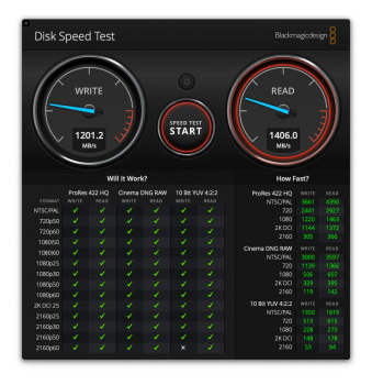

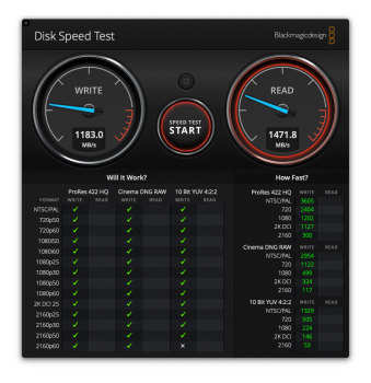

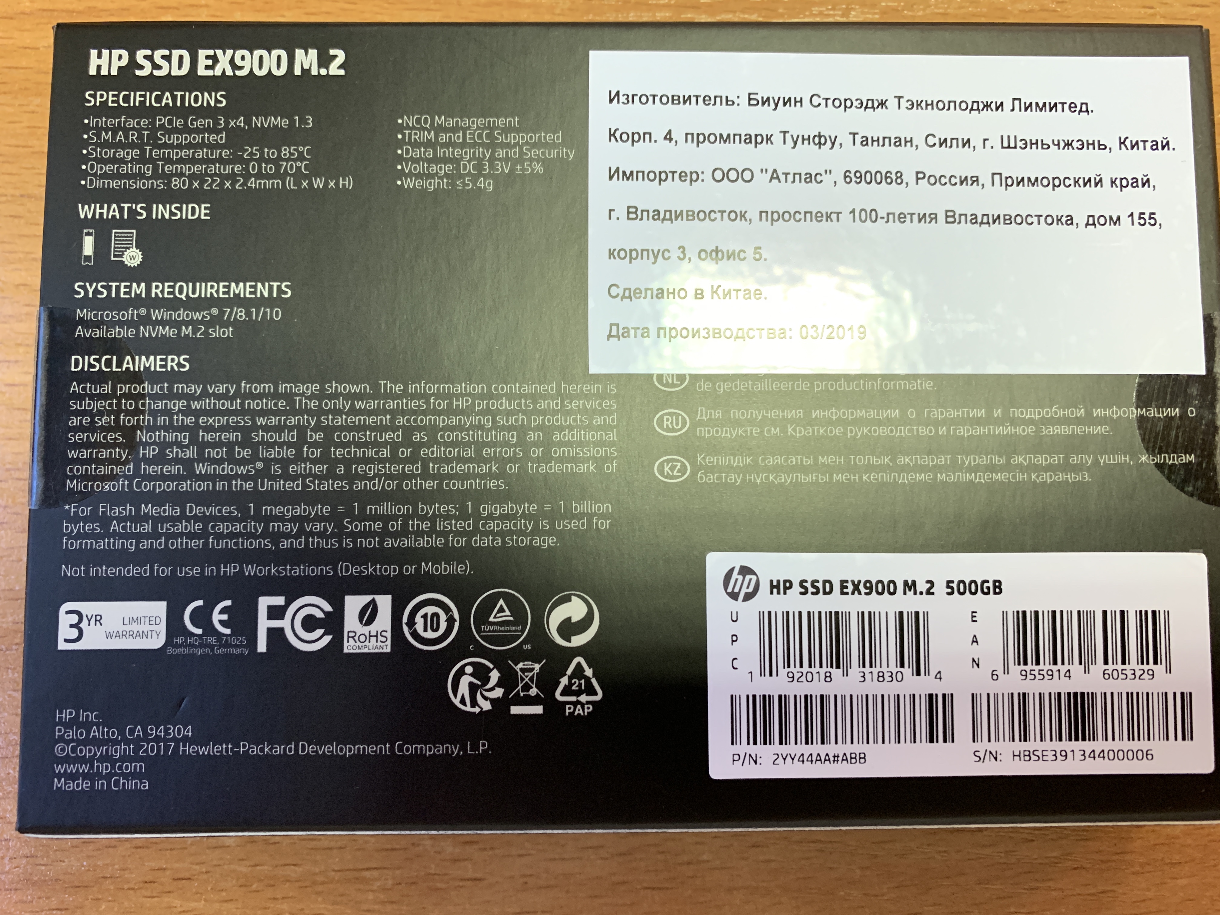

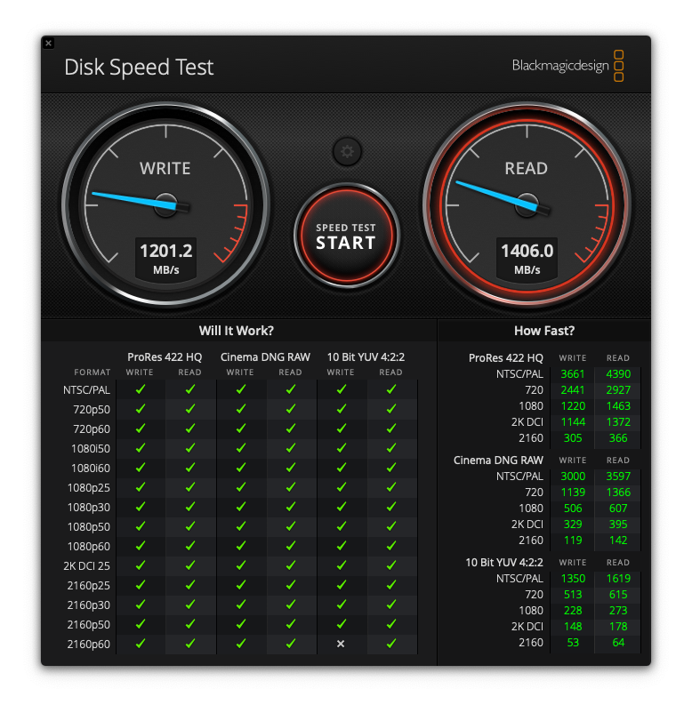

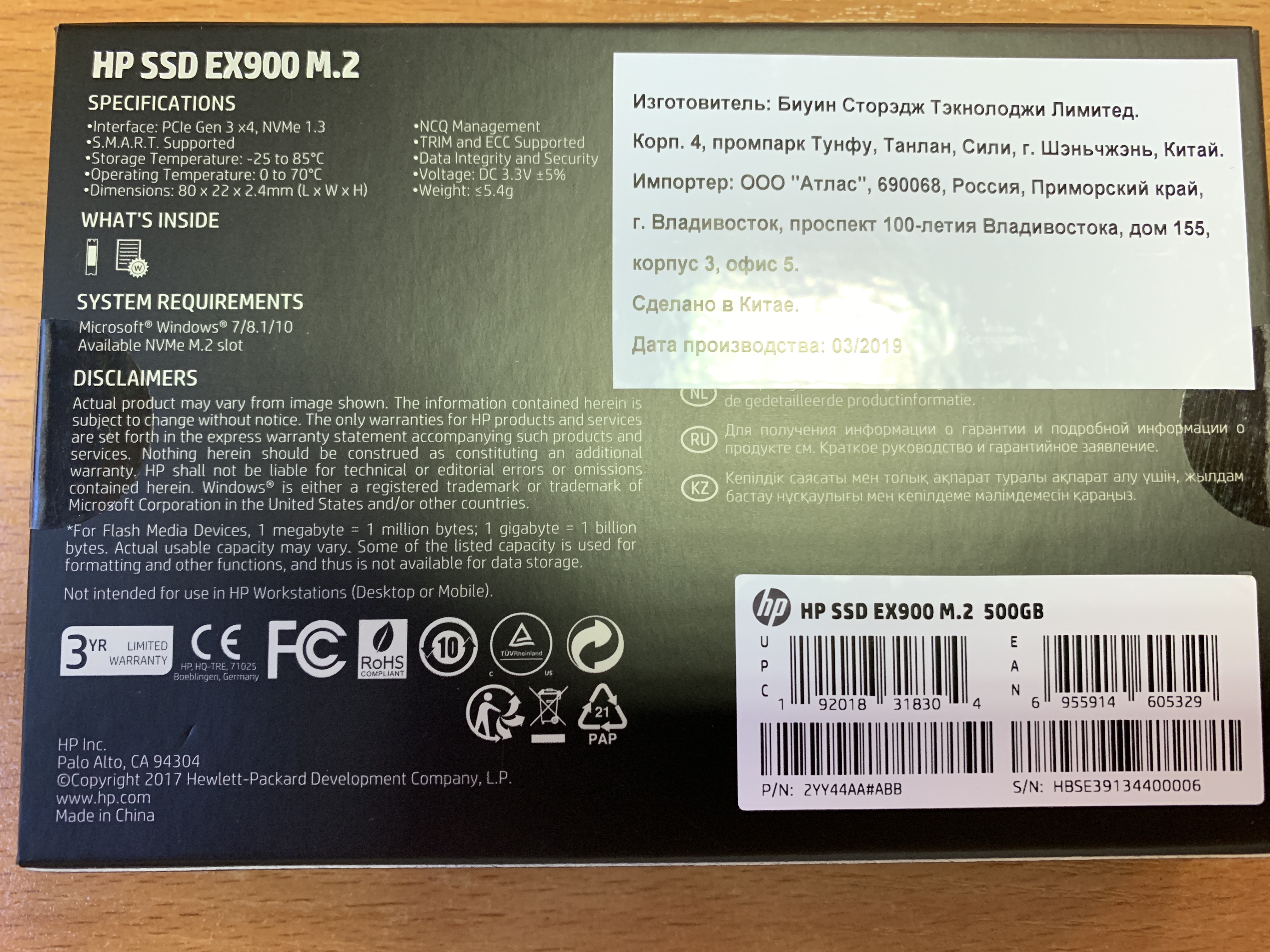

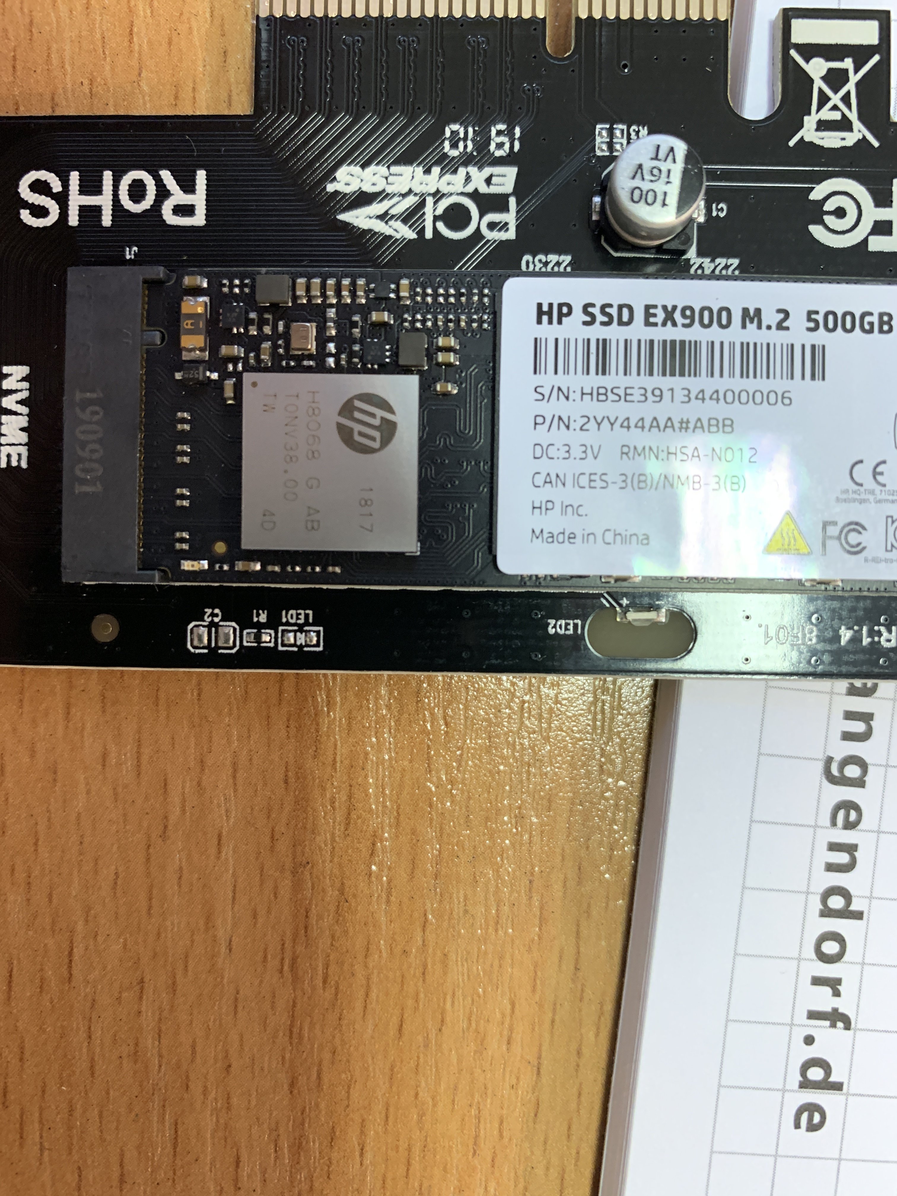

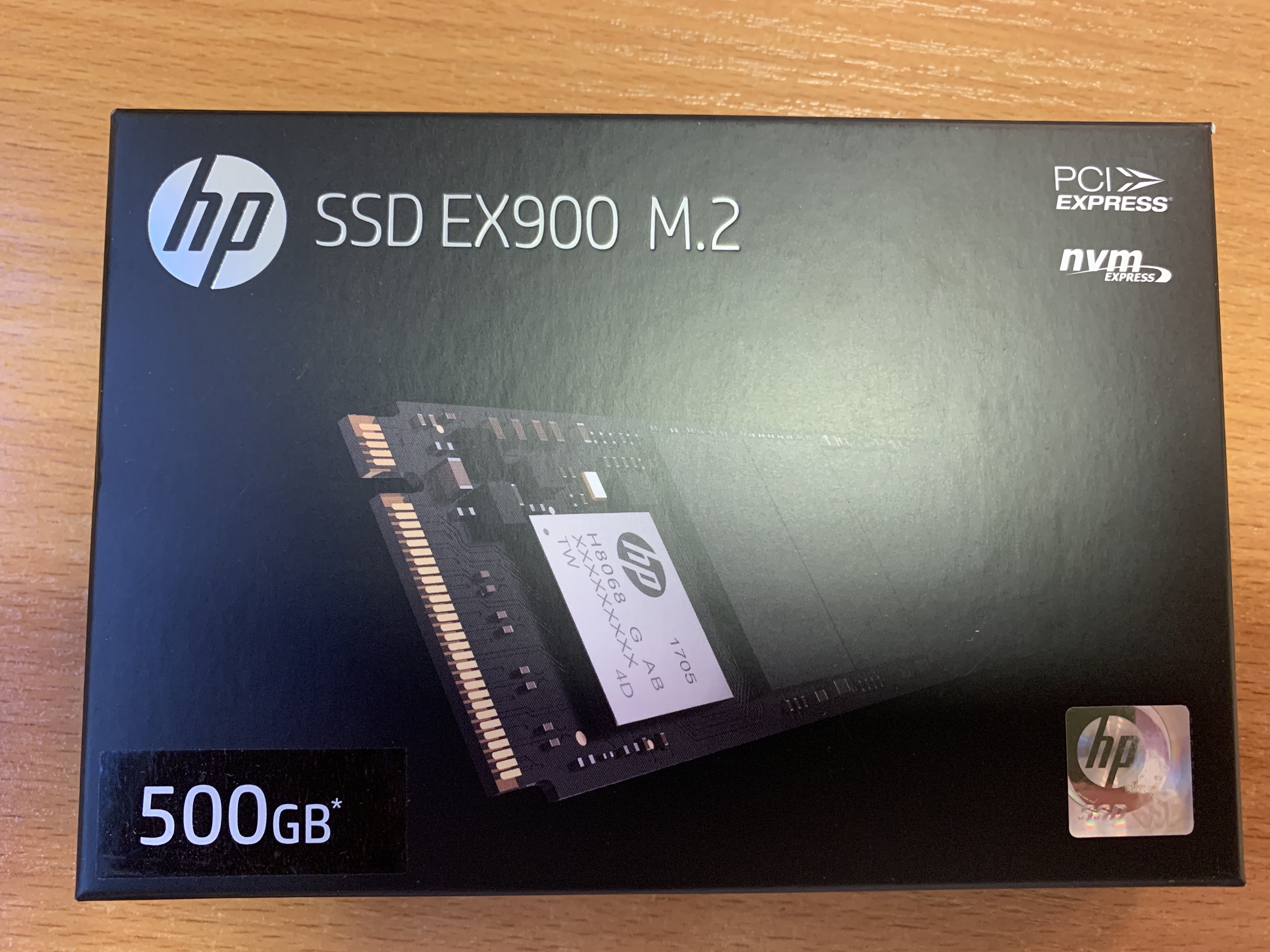

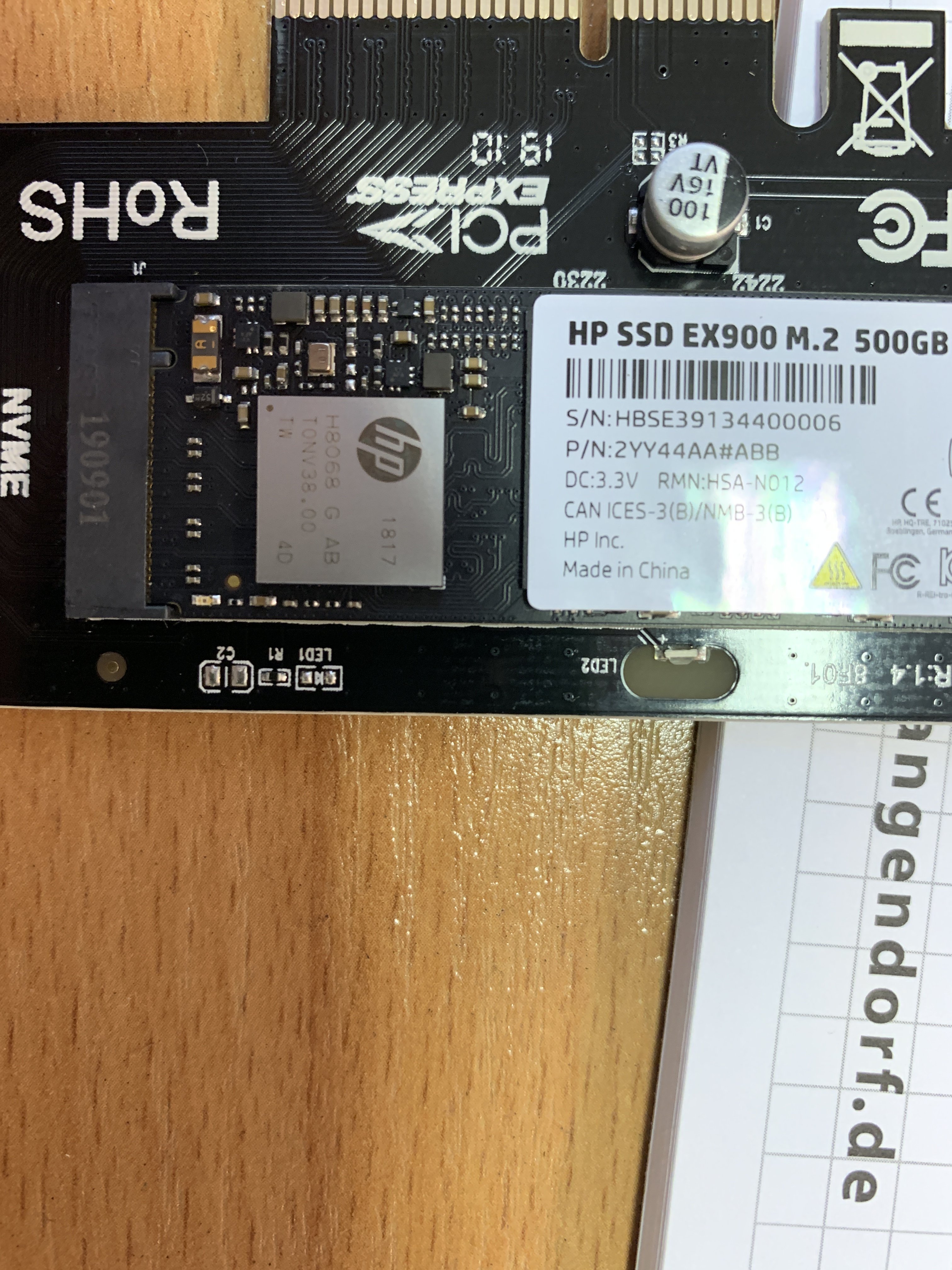

Thanx. super!!! Hooray!!! so I did everything right.
I will look for how to fix with Wi-Fi
