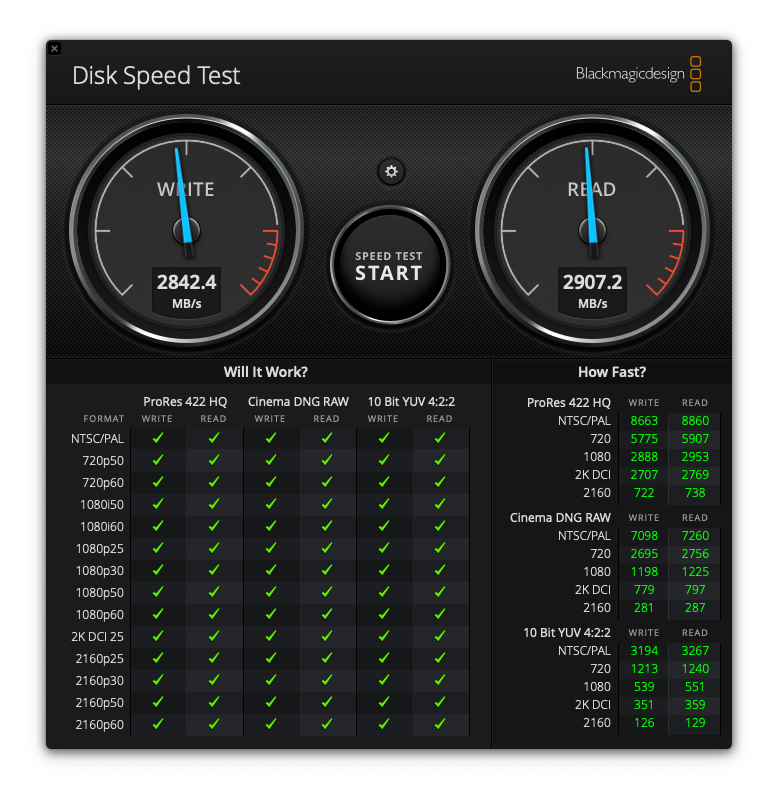

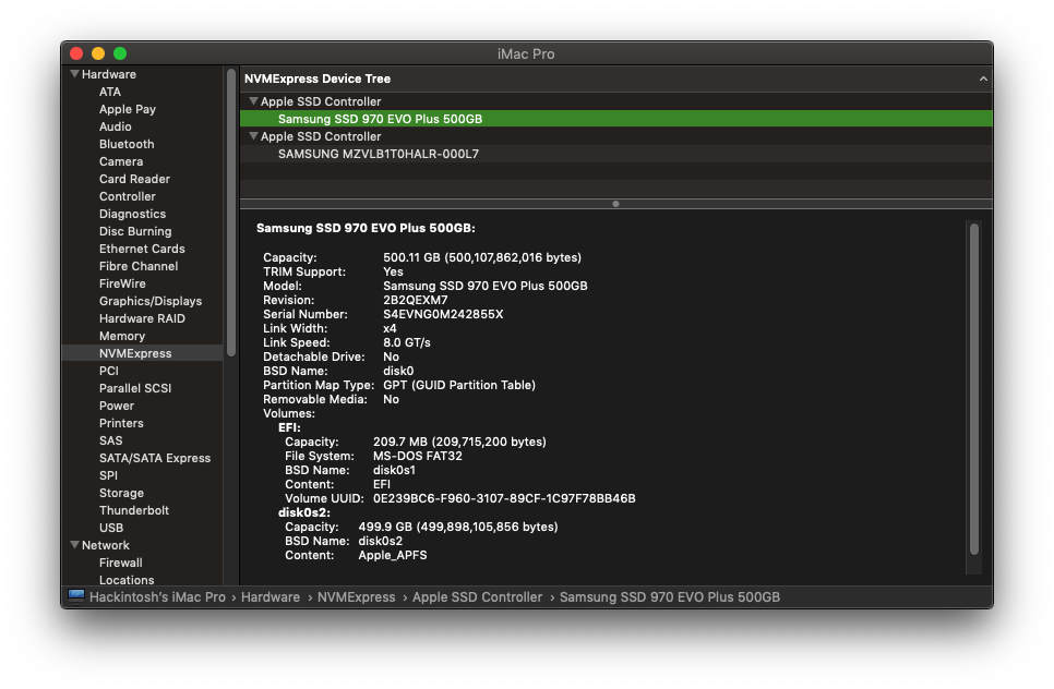

Here's the full potential of 970EVO Plus on H@ck|into5H
View attachment 839059 View attachment 839060
VERY SEXY

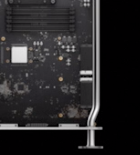

It appears the 7,1 uses blades similar to those in the iMac Pro, which are shorter and have a wider connector than the blades used in the 6,1 and MacBook Pro. Like shown here by user handheldgames. (They were also correct about the 2 ports.) So if you have an earlier blade it looks like you would need to install it in a PCIe slot adapter like in the 5,1.
Image: Apple
tsialex
Contributor
Jun 13, 2016
13,455
13,602
It appears the 7,1 uses blades similar to those in the iMac Pro, which are shorter and have a wider connector than the blades used in the 6,1 and MacBook Pro. So if you have an earlier blade like the SSUBX it looks like you would need to install it in a PCIe slot adapter like in the 5,1.
Image: Apple
iMac Pro and 2019 Mac Pro use NAND blades, totally controller less. It's almost like a DIMM but with NAND. All the logic and control is in the T2.
