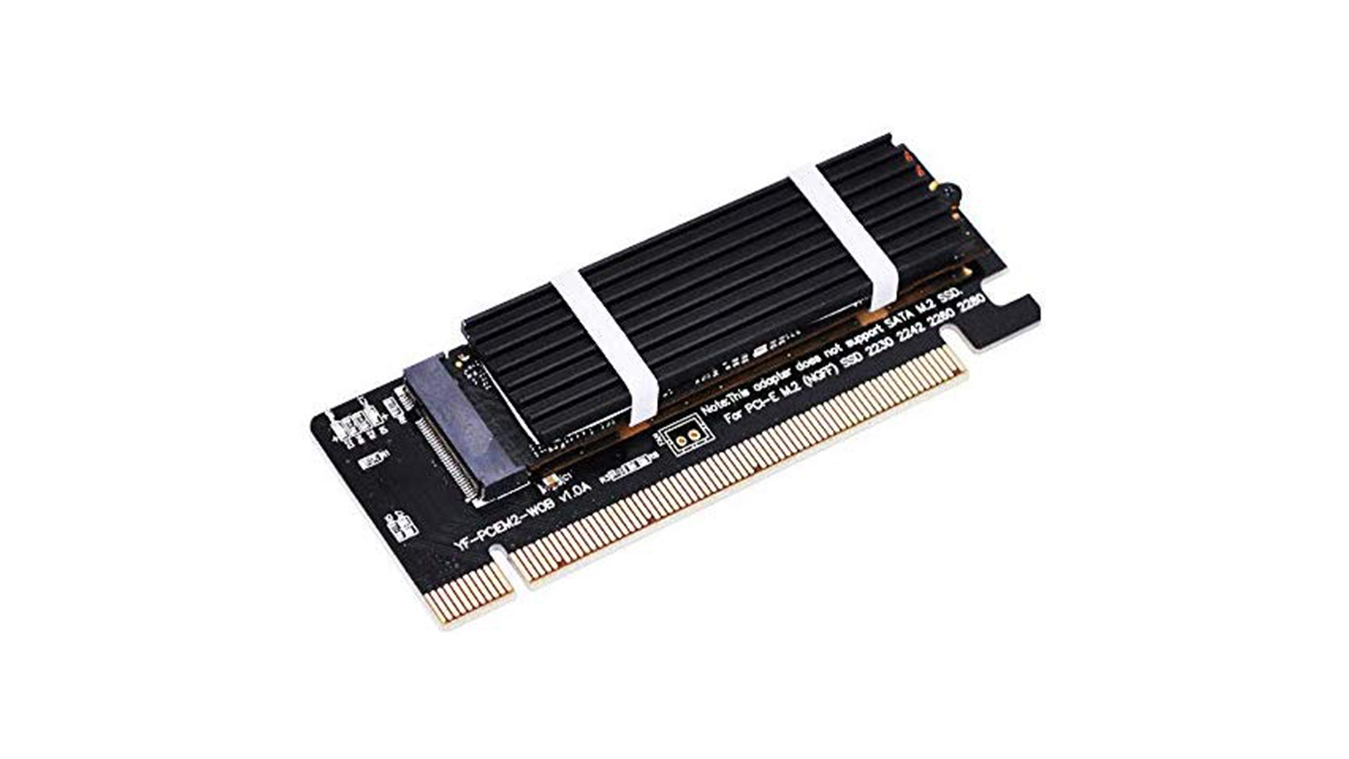

Cheap cards supporting only one device are cheap because they only wire the PCIe from the PCIe slot to the PCIe of the M.2 or U.2 slot.
The Asus is also cheap because it only wires the PCIe from the PCIe slot to the PCIe of the M.2 slots. But that only works with PCIe slots that support bifurcation. Macs don't have slots that support bifurcation. Feel free to be the first to test this card in a MacPro7,1 with more than one NVMe drive.
Expensive cards work by including a PCIe switch. The PCIe switch is like a network switch. The upstream connection of the PCIe switch is PCIe x8 or x16 lanes to the PCIe slot. The switch has 2, 4, or 6 downstream connections to the M.2 slots (each M.2 slot is x4 lanes).
Don't confuse PCIe lanes x4, x8, or x16 with how many devices a PCIe card supports.

I went for an EZDIY-FAB NVME PCIe Adapter for my 960 EVO and planning to add another 970 EVO Plus in a separate PCIe adapter.
What I like about the EZDIY is that it stays hidden inside the Mac Pro, without the need to remove any of the back plates. However... that heatsink feels extra. So far, peak temperatures for the 960 EVO under Windows have reached 55C max and hover at ~40C when idle. Under macOS, temperatures stay put at 38C or lower while Apple's SSDs hover at 27C. I don't have any other clear references on what real-world temperatures are expected for any other common blades.
Advice on whether I should keep the heatsink on top or remove it entirely when used in the Mac Pro?

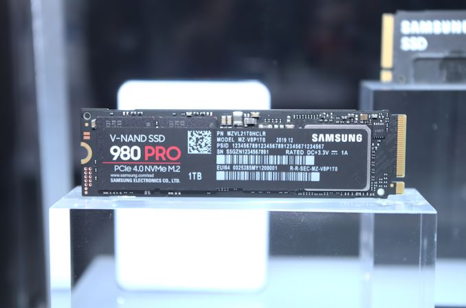

Samsungs new SSD 980 Pro was launched.
I wonder what it could perform in a HP card in a cMP 5.1 running High Sierra.
Still a x4 device, just PCIe 4.0.
Installed in a switched adaptor like HighPoint SSD71xx or Sonnet M.2 4x4, a M.2 PCIe 4.0 blade will be limited by the PCIe 3.0 x4 connection. So, will be less than the theoretical 3940MB/s that a PCIe 3.0 x4 connection can provide (985MB/s * 4), in real world, maybe around 3400MB/s or less.
The most interesting fact is that Samsung still uses 2-bit MLC, like 970 PRO, and the capacities are limited to 1TB. It will be the best erase/write endurance on the consumer market.
We'll probably eventually see cards with PCIe 4.0 switches (unless there's an issue with the extra heat?). Before that happens, you can probably add PCIe 4.0 slots with a PCIe gen 4 backplane in a PCIe expansion box (I've only tried a gen 3 backplane). Otherwise only AMD motherboards have PCIe 4.0 slots.
