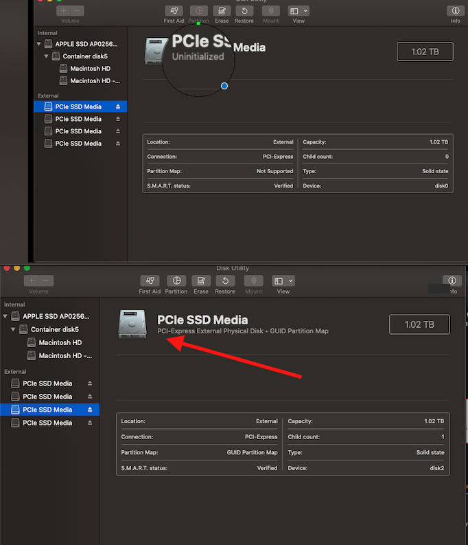

Did you use it before? If so, install it the same way, with HPT drivers or without.Afternoon all. The new Mac Pro arrived, but the HighPoint won't mount to the system, unless I erase it.
Any guidance? Thanks!
Can i do something?

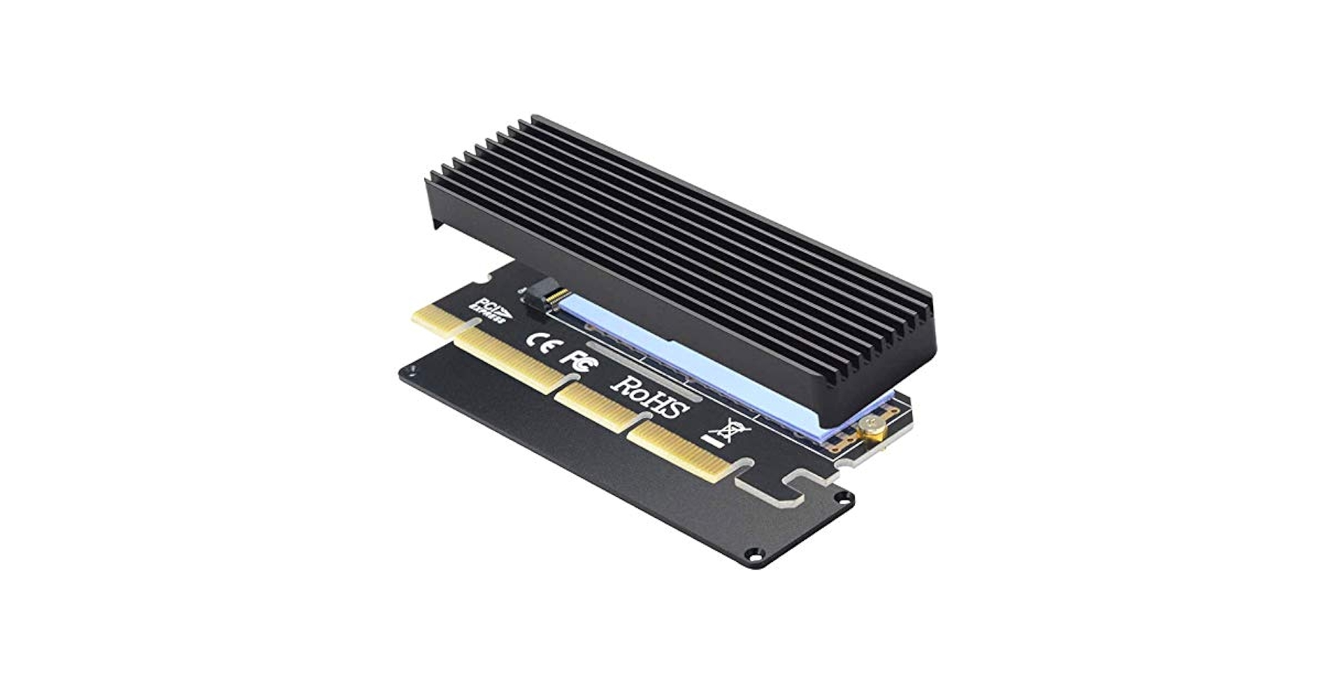

Step 1: Get a better adapter. Don't use cheap garbage adapters that do not ship with heatsink(s).
I like this one (I bought 3 of them!) - it's black and fits into any of the MP7,1 free slots with a lip at the end so you can anchor it using the latch without needing a mounting bracket. Comes with a heatsink if you need one.Can someone recommend a x4 (single) PCIe-Adapter with in black (to match MP7,1) that doesn’t have a LED?

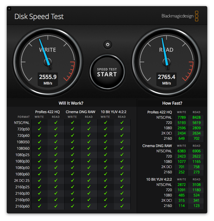

Did you get the ones with the heatsink or without. The ones with the heatsink are £62 ($81) cheeper in the UK.I bought 4 WD Black SN750 2TB since the 970 EVO Plus was out of stock.
Installed the drives inside two Syba I/O Crest SI-PEX40129 (slot 1 and 2) and so far everythings looks quite promising.
These are the first non-Samsung SSDs I ever bought and didn't return. (As of yet)
Single drive, HFS+, no RAID
GODSHARK NVME Adapter with Heat Sink, M.2 SSD Key M to PCI Express x4/x8/x16 Converter Expansion Card, Support 2230 2242 2260 2280, Compatible for Windows XP 7 8 10
GODSHARK NVME Adapter with Heat Sink, M.2 SSD Key M to PCI Express x4/x8/x16 Converter Expansion Card, Support 2230 2242 2260 2280, Compatible for Windows XP 7 8 10www.amazon.com
