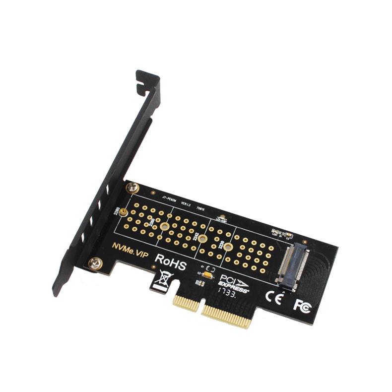

The one I've mentioned in a thread or two is by Micro Connectors. It can be bought for about $20 (at Fry's for example). I deliberately bought that one because it has a PCIe slot cover attached to it. The GODSHARK and QNINE are designed for 1U servers, where the motherboard is horizontal and the PCIe cards are vertical. I suspect putting one of those in a standard tower where the motherboard is vertical and the PCIe cards are horizontal would put some strain on the PCIe connector and motherboard. Thus I wanted one I could screw into (or attach to) the slot opening. That'd provide additional support for the card.
On the other hand, I do like the GODSHARK and QNINE models because the heatsink is screwed to the PCB board instead of just stuck on the NVMe blade as with other cheap adapters. (The one by Micro Connectors also is screwed down.) So that's a plus in my opinion. However, for the reason mentioned I personally prefer a card with an attached PCIe slot cover.
As a final comment, the Micro Connector card does have a little bit of LED lighting -- the manufacturer name is presumably illuminated. I don't care if it is since I can't see it, and it'd be very minor even if I could.

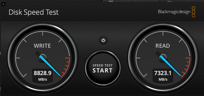

Just wanted to leave this here, now that I got everything working.
Mac Pro (2019)
-macOS version 10.15.2
-3.2 GHz 16-Core Intel Xeon W
-96 GB 2933 MHz DDR4
HighPoint NVMe RAID Controller SSD7101A-1
-Kext Version 1.1.9
-4x Sabrent 2TB ROCKET NVMe PCIe M.2 2280
-RAID 0, Stripe size 64KB (Sector size 4KB), Apple_HFS
