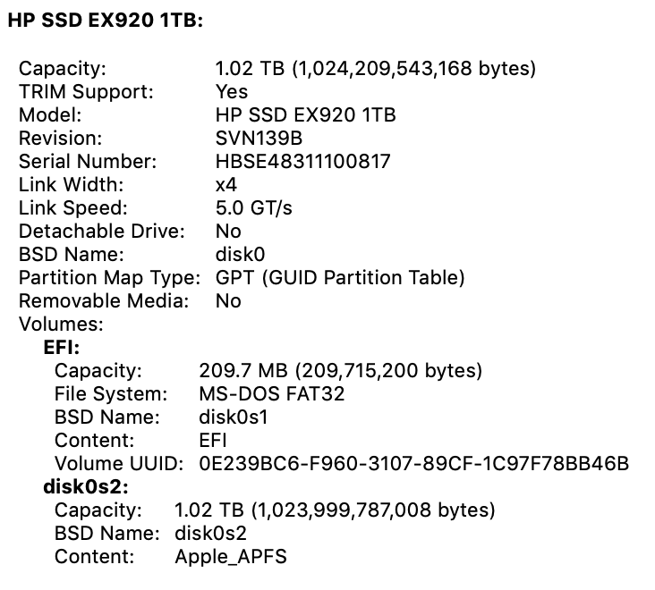

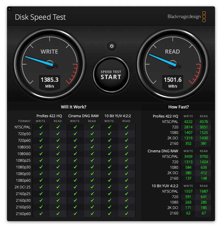

HP EX920 installed and is fully compatible. Just installed 10.14.1 on it and migrated from off a Sandisk Extreme SSD onto it. TRIM seems to work out of the box.
If you cloned, the trim force setting keeps between disks. You have to do a totally clean install to check if the SSD has native Apple TRIM support.
Btw, thx for the report, please add into the first post.
I did a clean install and then used Migration Assistant to migrate my user account over. That screenshot is from before I did the install on it and just wanted to check it out real quick before doing anything with it.

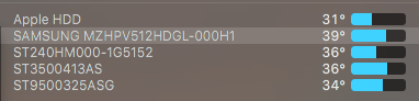

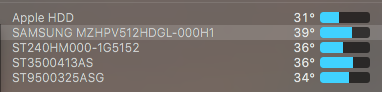

I don't see a temperature sensor from it in Macs Fan Control, so I can't report on heat or how well the Angelbird Wings PX1 is working with it, unless there's some other way to get temperature?

Some SSDs don't show temperature in a way that the usual Mac apps can read. My SM951-AHCI + Wings PX1 shows into iStat:
Try DriveDX, usually it gets temp from anything.

iStat's "Monitor SMART drives" may disable all other software (including the OS) to access SMART status.
If that SSD temperature didn't show on iStat, and can't be accessed by any other software, try disable iStat's SMART monitoring.

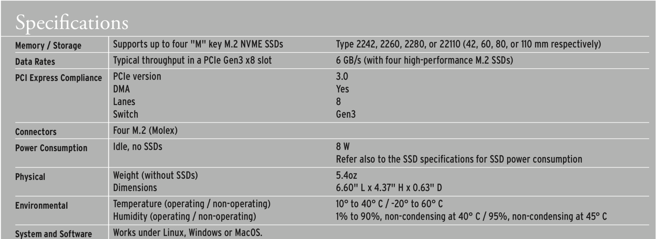

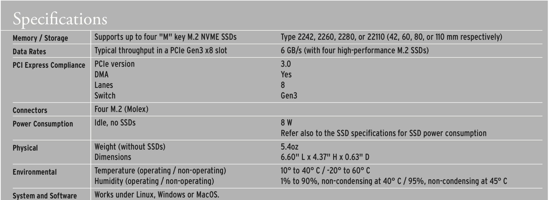

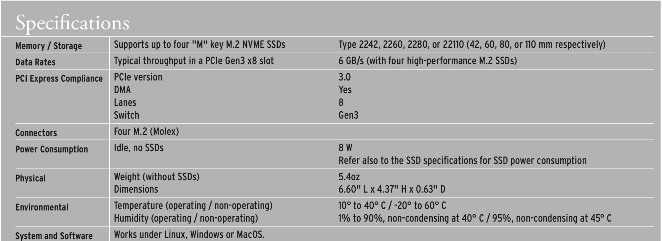

Looks like it has a switch so it could be OK they want a lot of personal information to get a quote. . maybe expensive.
It is...almost a $600 device. It’s only an 8x card as it was what their customer requested.

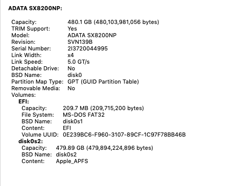

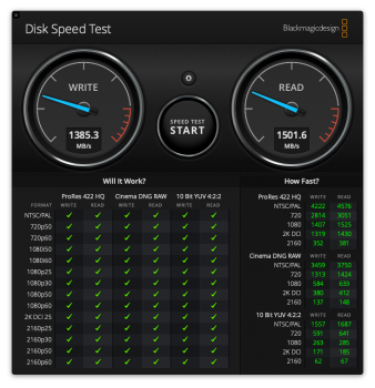

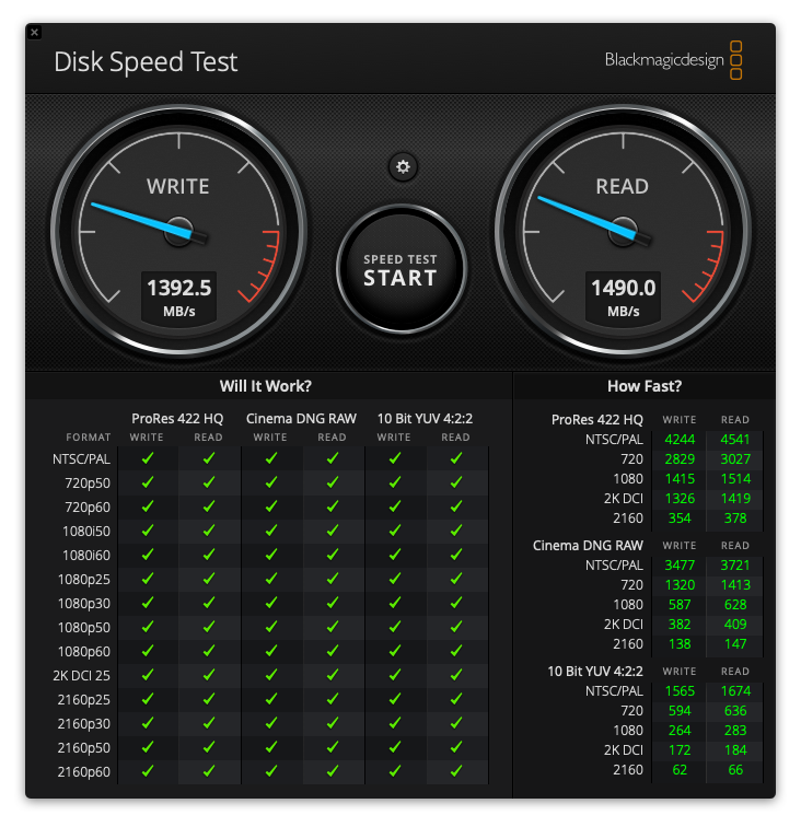

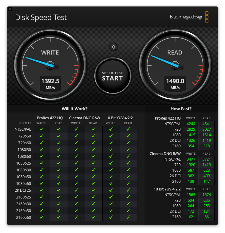

Clean install of 10.14.1 with a 480GB ADATA XPG SX8200 with a super-generic $4 adapter from Aliexpress in slot 4. Don't think I have the ability to add to the first post.

To go past 1500MB/s the card needs a PCIe switch to convert PCIe 2.0 x16 into PCIe 3.0 x4.
This card that you linked is just a adapter, so tops at 1500MB/s.
