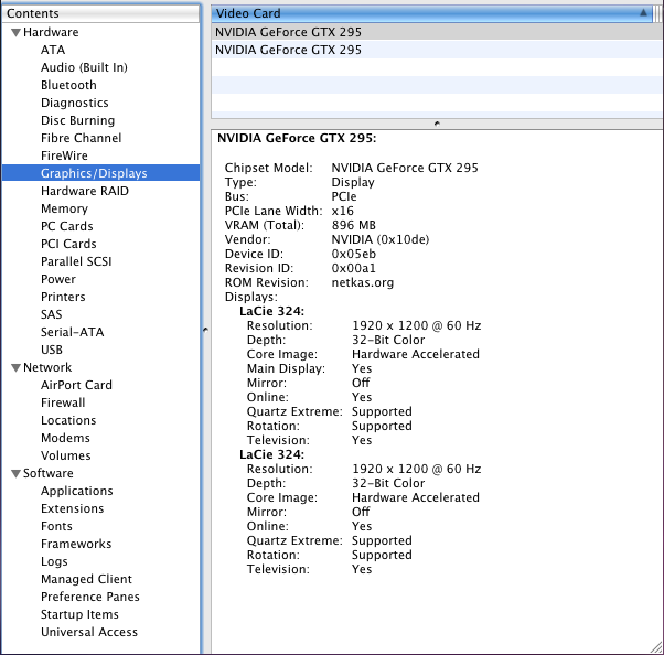

This is what I did. This is great news as the EVGA 295 Co op Single PCB edition works with Leopard.
EVGA GTX 295 Co op Edition works
Added System_Profiler.png attachment.

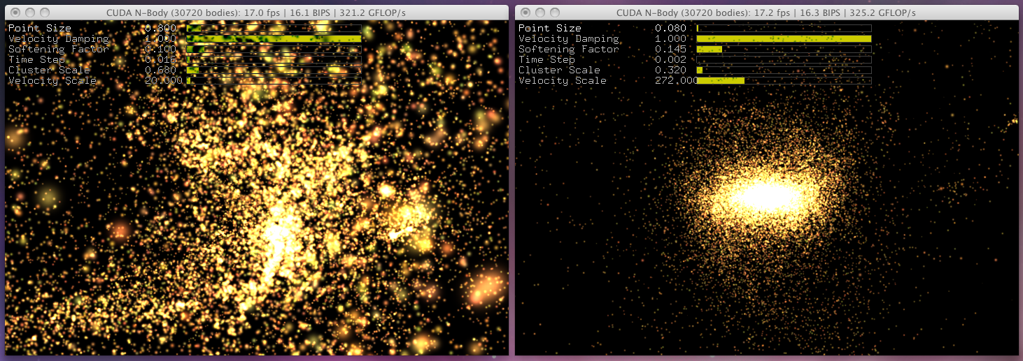

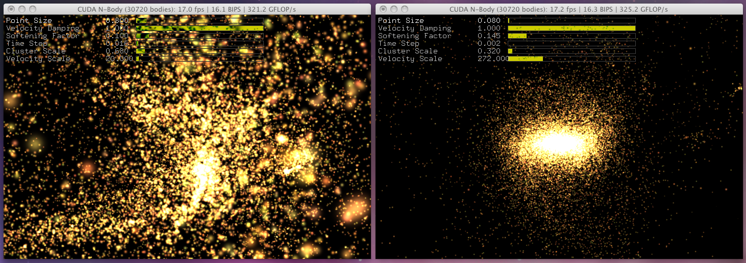

What about CUDA GPU computing utilizing both GPUs. You bet. The EVGA GTX 295 Co op Edition is seen processing 646.4 GFLOP/s with both GPUs combined. Attaching an image to show you.

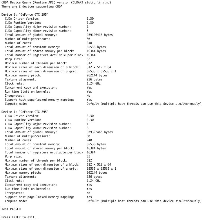

CUDA is able to utilize both GPUs on this single PCB card. The following is the output from running the CUDA deviceQuery command.

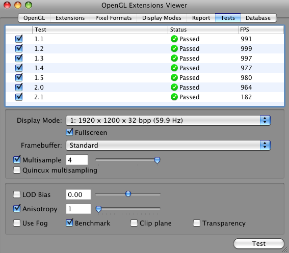

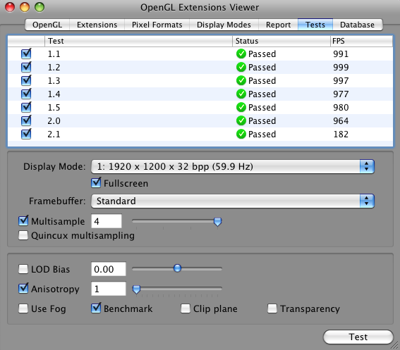

The results from OpenGL Extensions Viewer. I believe only one GPU is utilized for this unlike with CUDA both can be utilized simultaneously.
