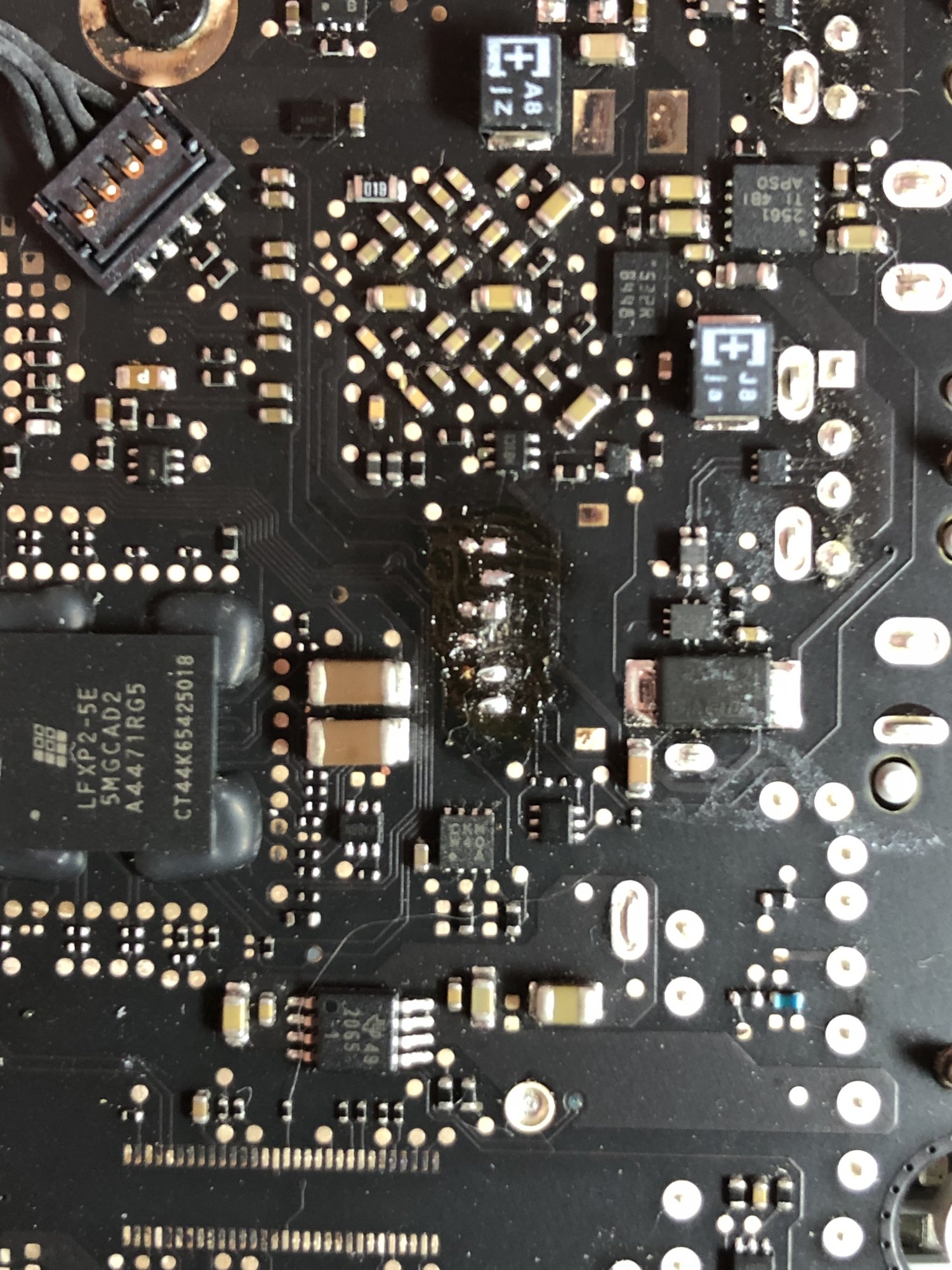

Hi all. I tried this method repeatedly, saw the green light but kept getting the same error message while trying to flash. I re-soldered a handful of times and finally I think I messed up one of the pads (third from the bottom). The laptop also has a black screen - no longer draws anything at all.
I've attached a screenshot. Is there anything I can do at this point? Or is it over :-(

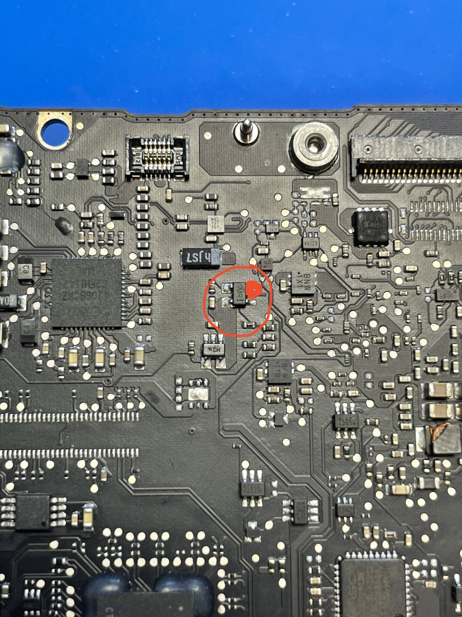

Not sure if it was mentioned here but in case the flash fails - instead of removing L2406 You can ground PLT_RESET_L line (the easiest place is U2890), just don't forget to remove jumper after successful flash. It's easier
Reactions: petttu and 0134168
I'm not able to flash the firmware sadly. I checked my wiring multiple times and also added the capacitor between TCK and GND line but it still fails every time... What can I do?
Connected to Lattice Cable Server. USB V2.0 detected. Check configuration setup: Start. File C:\Users\user\AppData\Local\Temp\28716\program\data\vmdata\database\xpga\xpld\XPLD.jed has been modified since last check.Default using the modified file. Device#1 LFXP2-5E: Failed to verify the ID (Expected: 0x01299043 Read: 0x00000000). Check configuration setup: Unsuccessful.

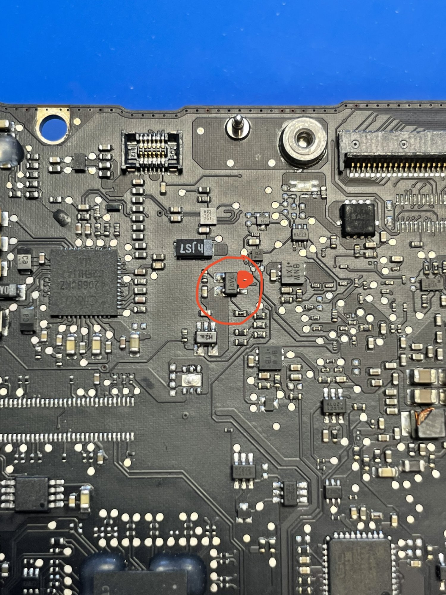

Where can I find the U2890? Can you send me a picture of the exact location or how you bridged it?
I grounded PLT_RESET_L but used R2881 instead of U2890.
Luckily, the flash worked first try after i did that (I was short before pulling the TCK pad but fortunately it survived ;))
