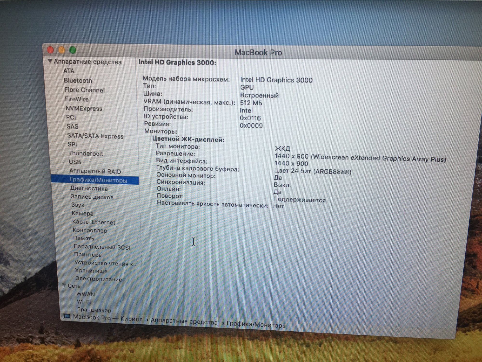

I know brightness doesn’t work but it was better the other option. I was running sierra for a long time but the accessing smb shares took to long. High Sierra fixes those problem.
I was using the nvram fix for a while but since that doesn’t work well with high sierra because of sleep. I didn’t want to solder anymore wires.

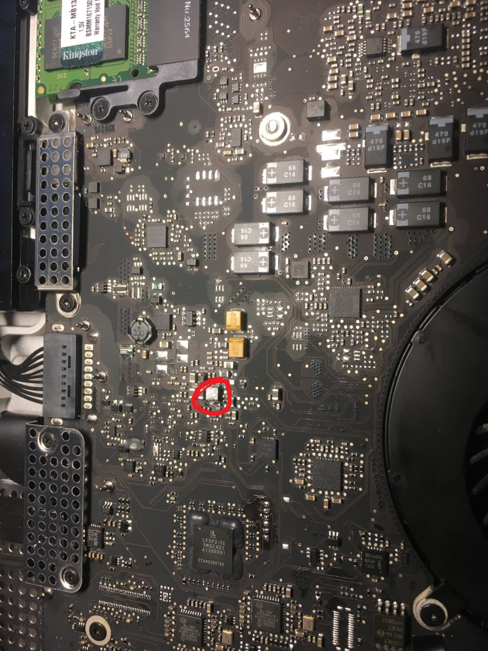

I see you mentioned removing L2406, where is this exactly and I'll give that a go instead.
Also @dosdude1 whats the current situation with your dying light mod, are you guys still making those ?
Right above the fan, same 17" 2011 model (A1297). Did not work with or without of the 100pf capacitor, but worked first try with L2406 removed. No pictures any where, but luckily found a boardview for it, and a hint maybe use an hot air, almost broke it when removing it with regular iron.
Because the programming fails if it was not removed. I tried 20 times, just thinking it was an wiring issue (and added the capacitor). After removing the coil, it worked at first try.

Hi at all, can you show where is located the l2406 in a 15" macbook pro 2011? should be removed and reinserted with an hot air?Thank you

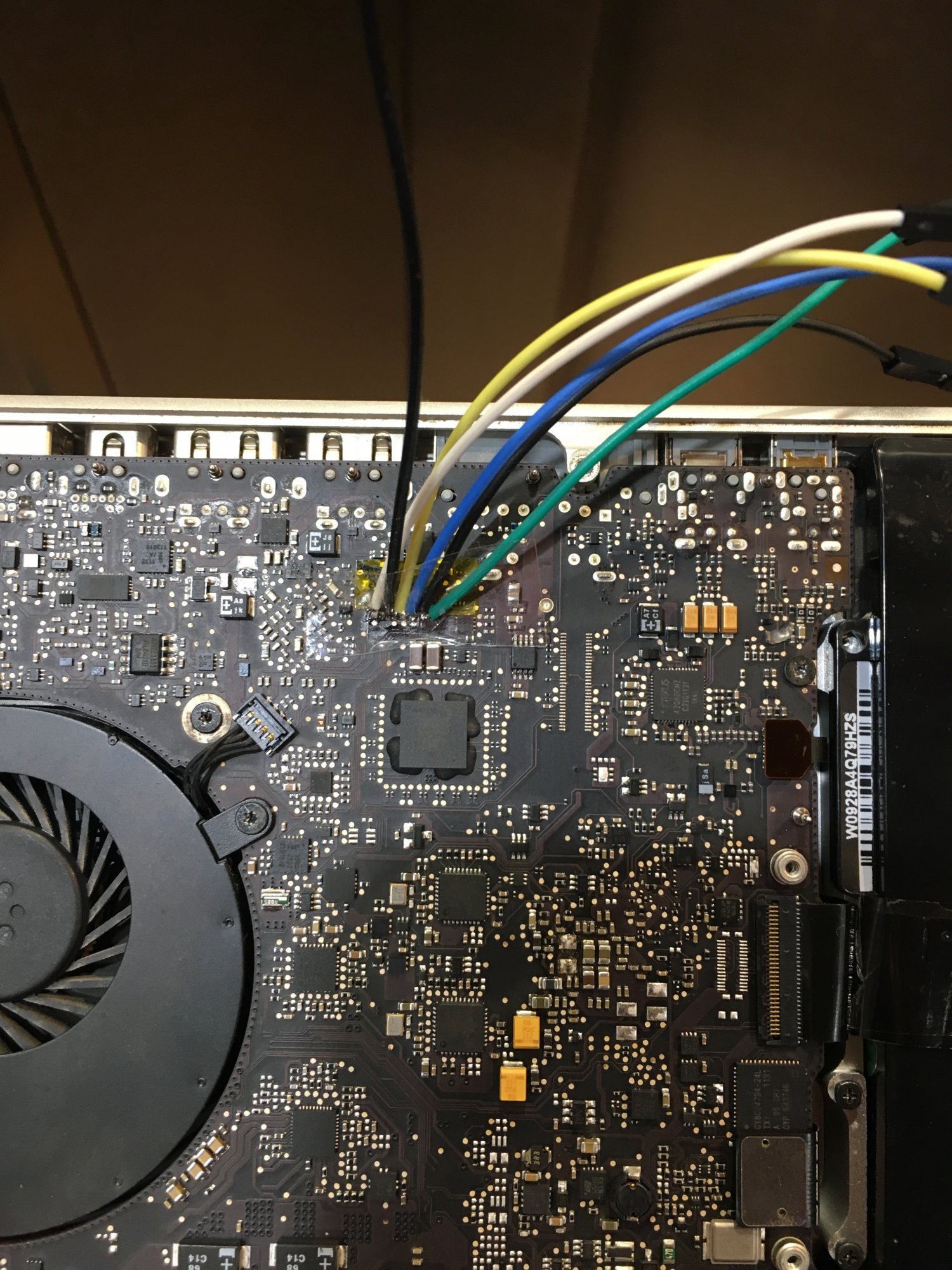

I finally got the programmer to see the FPGA! I found a thread here that solved my TCK problem. @fastlogon , it looks like you were having a similar issue to me. Give the instructions in that thread a go. Perhaps it will help you.
Yeh worked perfectly first time once I removed this.

As for why to remove it, if you read further back in the thread i think it was mentioned about line voltages being pulled down by other components, removing this component stops the voltages being pulled down and effectively blocking the patch/programming from working.

Is it easy removing with hot air? I have one but haven't really used it and I don't wanna burn out the inductor. Can you give some pointers? I do t have hot tweezers

As far as I know, @dosdude1 highly recommends using a real machine running windows instead of a virtual machine. Initially, I thought of using Parallels but when reading this forum I just gave up and borrow my friend's laptop and did the process. I tried several times and was getting error messages one after another. I replaced the wires, lose some pads, soldered 100pF capacitor removed the coil and I only got success after installing new drivers for Lattice. I used the diamond drivers.
