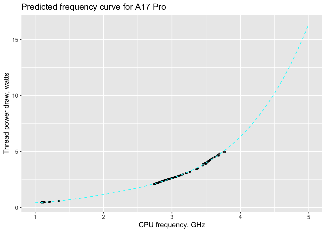

And here is a fitted prediction curve (using fourth degree polynomial, going higher doesn't improv the fit) for A17
Take this with a grain of salt obviously, but given how good the fit is, I'd say we have even more evidence that A17 is designed with desktop use in mind. I think 4.5 Ghz at 10 watts should at least be achievable, and that would give desktop M3 GB6 single of > 3600
P.S. Looking at this graph I can't wonder whether there is some intent behind some crucial points. It it a coincidence that A17 Pro is clocked to peak exactly at 5Ghz, or that the curve hits 4.5 Ghx exacly at 10 watts and 5Ghx at approx 15 watts? These are all important psychological points.
Nice work! Did you choose a degree-four polynomial by doing a log-log plot and finding you got a good fit to a straight line with a slope of four? Would you be willing to share this data? I'd like to play with some curve fitting myself.
I simply fit a regression model, fourth degree polynomial was the best at minimizing the residuals and going higher didn’t improve the fit. But the model is likely over-fitted, it can certainly be done better (the very small amount of data doesn’t help either). A more informed model (e.g. one uses known electrical engineering facts) would be a better idea.
I’ll publish the data shortly, just want to clean up the scripts…
Based on @leman's curves.
Which was my point. If Apple didn't clock the M2 higher, maybe it's because the curves are not what we think they are.
The curve just shows a trend. It tells nothing about actual physical limitations of the chip. If you start getting leakage above certain threshold because your circuits are not designed to handle the voltage, or synchronization issues because the logical blocks require certain timing range, that’s your limit, even if the trend suggests you still have a lot of headroom.
The only reason why I think the fitted curve might be suggestive of a wider power range for this core is because it appears flatter than that of previous products. But even that might be wishful thinking, with overfitting and all.

I added a few more data points to the git repository and can add more SoC generations later if there is any interest in going further back in time. I know I'm interested in that too.

The highest point might not matter much in real life on a portable device for the reasons you mention. But the curve definitely does. It's where you end up for a given power draw, the lower the better, and the newer chips are lower for all power draws as one would hope.
