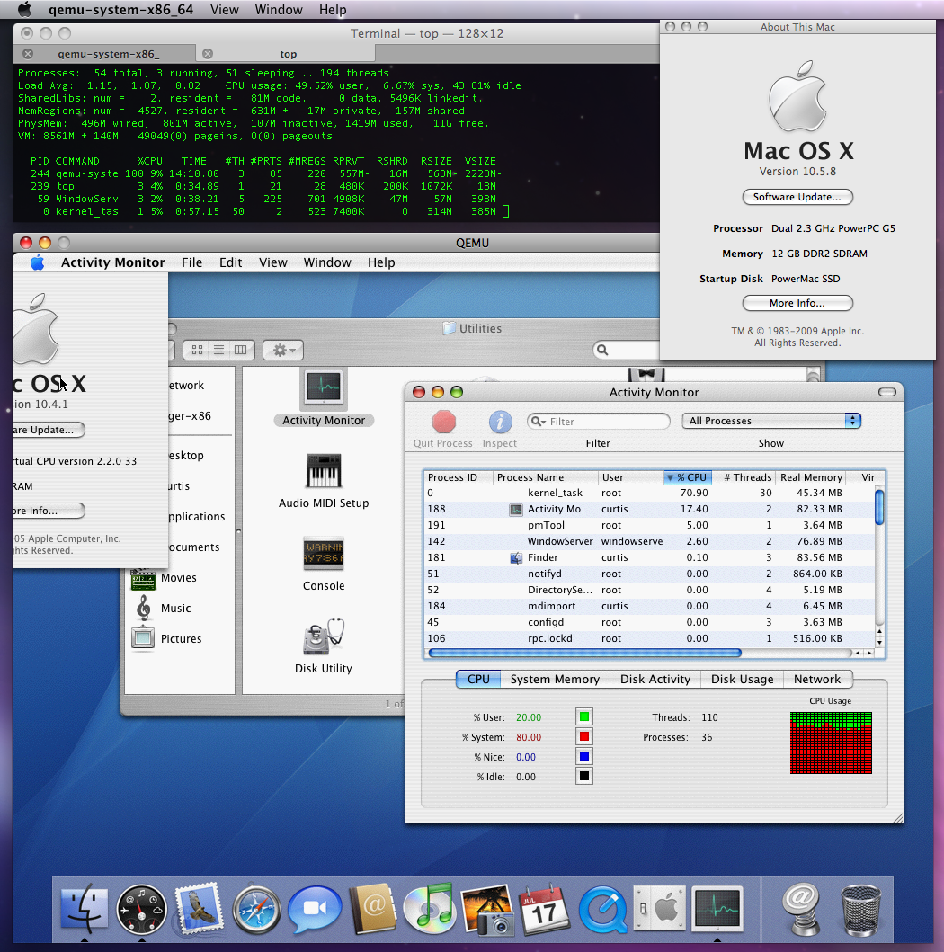

I'm meanwhile downloading SnowLeopard to try to run it via QEMU instead of Mavericks , probably on Friday because I've taken a day off from work.
Oh thats awesome! :D Please report back after your tests

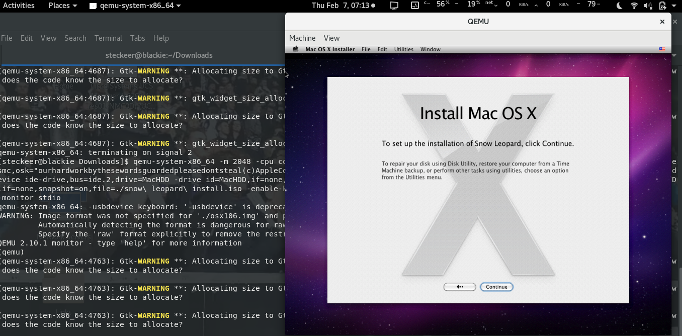

Day 6
Since I technically was on way to work , I have to use my work (own Thinkpad) laptop with Fedora and decided to try
and install the QEMU Snow Leopard install there whilst on my train ride this morning.
Just a quick peek , I had to cancel it since I arrived at work.
To be continued tomorrow on my day off.

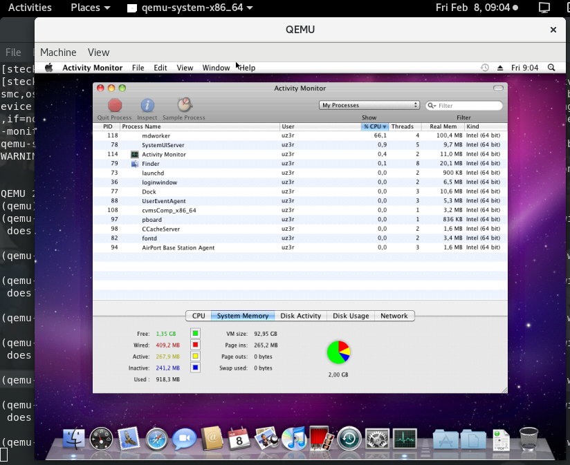

Day 6 continued
So during my train commute home I was able to install Snow Leopard on my Fedora Thinkpad using qemu with kvm.
And here it is booted in 1 second ( this is not on PPC but on x86 )
qemu-system-x86_64 -m 2048 -cpu core2duo -machine q35,accel=kvm -smp 2 -usbdevice keyboard -vga cirrus -device isa-applesmc,osk="ourhardworkbythesewordsguardedpleasedontsteal(c)AppleComputerInc" -smbios type=2 -bios bios-mac.bin -kernel osx-kvm/chameleon_svn2360_boot -device ide-drive,bus=ide.2,drive=MacHDD -drive id=MacHDD,if=none,cache=none,file=./osx106.img -device ide-drive,bus=ide.0,drive=MacDVD -drive id=MacDVD,if=none,snapshot=on,file=./snow\ leopard\ install.iso -enable-kvm -device usb-tablet -netdev user,id=usr0 -device e1000-82545em,netdev=usr0,id=vnet0 -monitor stdio

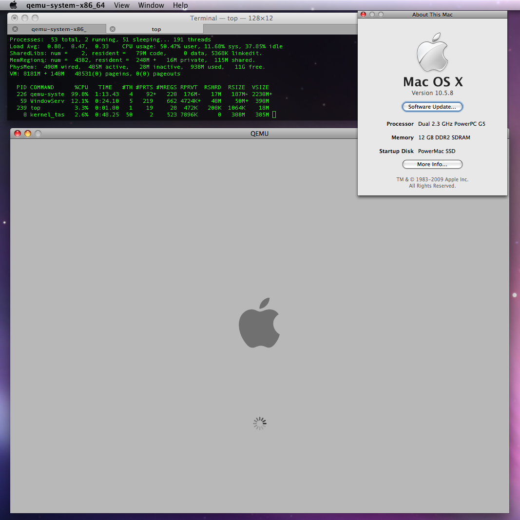

So when I arrived home I transferred the HD image to my G5 and tried to boot it there but no luck, I get to the grey apple screen and then
it reboots continuesly so no Snow Leopard booting on PPC.
Since there are no messages nor any debugging option that I didn't use that indicates an error, I'm guessing it's either the definition of
q35 in QEMU or just my old QEMU 2.2.0 version.
Also for the install the Harddisk needs to be 16GB , after installation approx 6G has been used but when I shrink the disk, the EFI bios gets confused and fails to find the Harddisk. Will try to get it shrinked down to 6G or 8G afterwards.
I'm in the progress of uploading the QEMU 16G GZipped IMG file for those on Linux PPC who want to try it.
I will delete it on Sunday since my 15G free storage on Google Drive is full with this image.

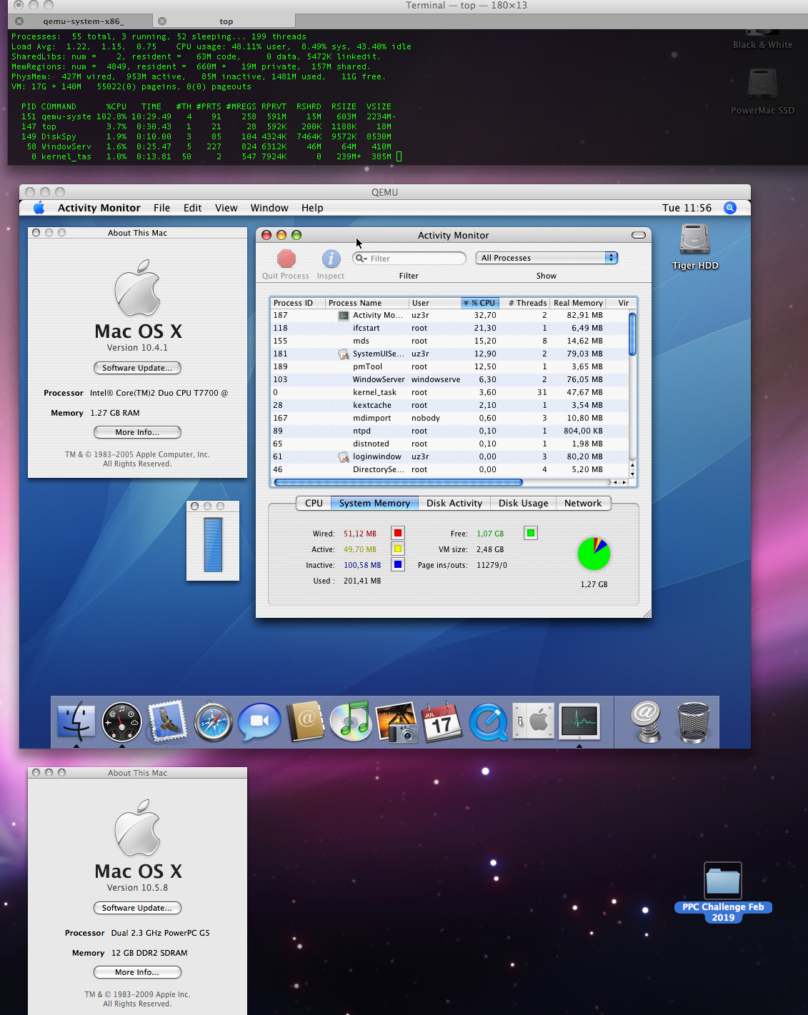

Tried running some of my Windows QEMU images on Ubuntu Mate PPC with qemu 2.5 but gave up after 15 minutes when they were still booting .

Since I'm sick and thus bored , I'm continuing my virtualisation extravaganza.
Inspired by @AphoticD Tiger Server Universal on VirtualBox thread , I tried to boot it using Chameleon to perform an install using Qemu but no luck, just keeps rebooting.
Then only to resort to the last OS standing , Intel OS X 10.4 Tiger.
I learned about Deadmoo, found the image , tried on my G4 but that was painfully slow so I tried on my G5 with -m 1300Mb and after 9 minutes I got a slow Deadmoo Tiger purring ( more like a cat purring when it's sleeping )
9 minutes to a desktop and another 2 minutes later to open Activity Monitor

Since I'm still at home sick and thus must entertain myself, a few images of what I've done yesterday.
On a G5 with cpu core2duo ( no smp 2 or machine q35 since the image appears to be stuck then ) , 1300MB RAM,
desktop boots around 3 minutes after start , usable around 4-5 minutes and completing all my actions, Open 'About this Mac', Open Utilities, Select Activity Monitor, Sort by CPU usage, Click on System Memory, Show CPU , around 10 minutes.
Is it usable, it reacts and is snappy but for real processing tasks (browsing) I'm guessing it's a No Go.
Day 10 into Day 11
Likes cannot express how insanely great that screenshot is :D Three notes:
1. You're emulating a CPU that, strictly speaking, is too new for 10.4.1 – it was designed for a Pentium 4 (but that shouldn't cause problems as I've found that build to be totally CPU-agnostic; it even works on Broadwell CPUs) :)
2. If /System/Library/Extensions/AppleTPMACPI.kext is present in that 10.4.1 image, deleting it should provide a nice speed boost.
3. Since you're emulating an SSE3-capable CPU, the SSE3 emulator the 10.4.1 installation ISO includes should obviously not be used. I don't know if the preinstalled Deadmoo image has it or not.
Great stuff :D
I know but I was too lazy to find the cpu model of a Pentium 4 in Qemu :)
I tried just now
  • but using cpu core2duo it actually makes the boot time longer and sometimes the mouse is stuck now :S
  • no cpu defined it does indeed seem faster , hmm
I'm uploading the ISO i used to build this image to my Google Drive, watch this space ...
Great stuff :D
And here is the link to the ISO i used to build the image
https://drive.google.com/open?id=1nCQPFyoNGSEWkQsj7dfJxGD3sZ4MwqOZ
