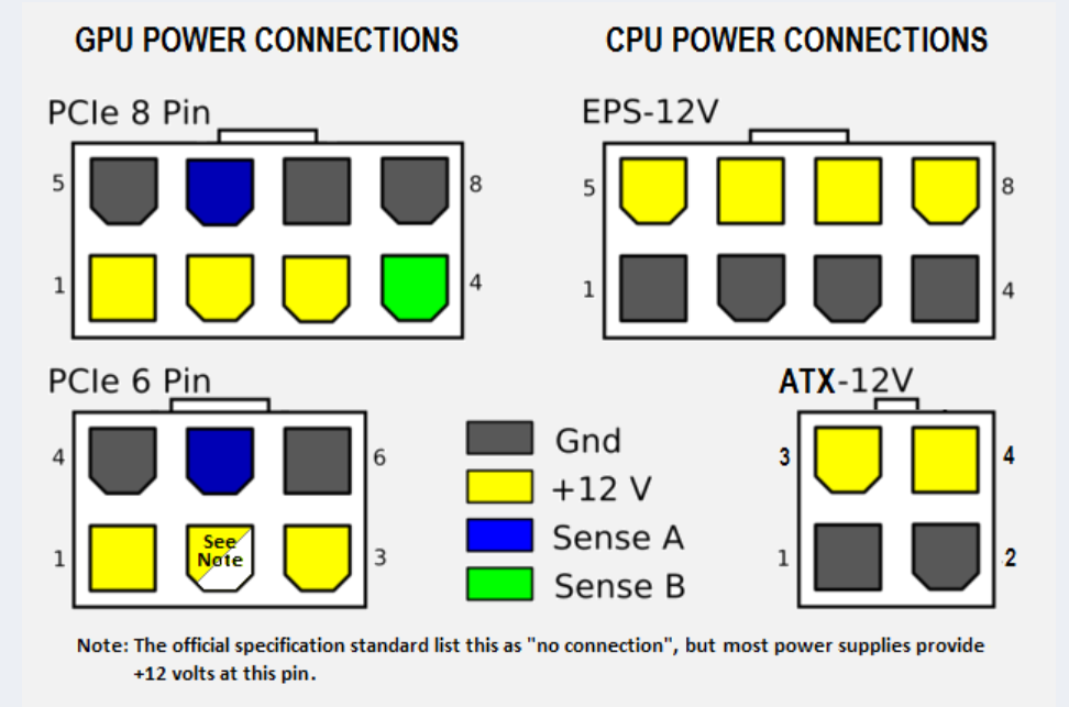

Ordered the cables and also got a 8-to-6pin converter described as
MSI PCI-Express 6-pin female to 8-pin male cable adapter K1G-3006010-E06
Item arrived first, and i noticed that one of the 8-pin holes is empty (no cable inside)/ see through !

the 6=to=6pin mini cable for mac is ok.

I believe it just lacks the signal it can not provide anyway (sense B):
No need to worry, though.
Reactions: Synchro3
I believe it just lacks the signal it can not provide anyway (sense B): No need to worry, though.
thanks again for the very useful chart -reply !
I observed the cable today, and one end is ok (8pins) but the other end does not fit the 6-pin mac cable.
In the mean time, another cable 8->6 pin arrived and is ok, so i will return the msi one...

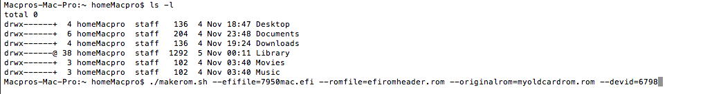

H: i reply back to you again. i do something wrong...
Please switch the cards so the ATI sits in the bottom (#1) slot and the GT7300 in the top (right below the hard disks).
** I did and noise is gone, although i broke one plastic safety plastic notch. I will see what causes this noise again.
You are quite surely not in the right folder. You need to navigate towards it (assuming it is a folder called "Flash" that sits on your Desktop) using "cd". Once you open the Terminal, it should open in your home folder, so you need to go a bit deeper, issue:
** Ok, i tried again, no success. Can you guide me in this example with CD cmd ?
1. My folder is on desktop callec '2kng-dtp'
2. Inside i have copied all files, driver ati etc.
3. The 7950mac.efi and mac7970.rom file is inside a subfolder (of 2kng-dtp) folder named 'bundle'
with other files, as downloaded from your link.
4. found my id is 6798
so, from root at terminal i go and type
1. cd /desktop/2kng-dtp/bundle
2. i run the ./makerom command as below
3. (i am inside bundle folder, i use capitals for any file i see has capitals as well)
./makerom.sh --efifile=7950mac.efi --romfile=mac7970.ROM --originalrom=myold-macpro-rom.rom --devid=6798
4. correct ?

I'm not the expert here, and have never flashed a card myself, so for full on confirmation, wait for someone else. What I can say though is you did the cd command right, haha. It looks like everything else has been done correctly too.

OK, just a quick thought... where do you have the myold-macpro-rom.rom file from?
I think i screw it up with this command....
i paid attention to the files inside 'bundle' subfolder. Using your syntax,
the 7950mac.efi, and the efiromheader.rom and the makerom.sh, exist in this subfolder.
Q: Why i copied the MAC7970.ROM file in this subfolder if it has no usage in the command line ?
From what you wrote, i supposed that the 'cardname.rom' is a generic example for a filename, to be saved after running the ATI program to dump it. and this is the reason i substituted it with 'myold-macpro.....rom' filename
BUT the usb did not boot, i realise now, so the ati was not run, therefore, i have NO dump rom !
Gee, that sucks !
I downloaded UNebootin app, and run it to create a freedos USB, i will test tommorrow and see if it boots, or hell will take over this planet....
Furthermore, the romfile=efiromheader.rom parameter, is being replaced with the rom filename i downloaded from your link. Is it correct ? i.e. the --romfile=efiromheader.rom
to be replaced with --romfile=MAC7970.rom ???

I have no idea why you did this, but the one and ONLY file that needs to be added to this folder is the ORIGINAL ROM dumped in FreeDOS.
OK, it's like that: Mac OS X currently can not dump the contains of the ROM and can not write new firware to the card. This is why we need to use FreeDOS and atiflash that runs within FreeDOS.
1 - we boot in FreeDOS, use atiflash to save the data from the card (using: atiflash -s 0 original.rom) - which means save from adapter 0 to a file called original.rom. If you have only one ATI/AMD adapter in the computer, it will always be "0".
2 - now that the file original.rom sits on your usb stick right beside atiflash.exe, you boot to OS X.
3 - put the USB stick into the computer, copy the original.rom to your script directory (in your current case: /Desktop/2kng-dtp/bundle)
4 - remember: we need ALL the files that were originally in the script directory. That's crucial.
5 - Open up About this Mac → System report → Graphics/Displays → on the right you'll see the ATI 7xxx card. Look up the
Device ID of this card.
6 - now run the script with the command. Remember, there is ONLY ONE thing that needs to be changed in the script command line, the Device ID you have looked up in 5. Checklist: [ ] your ROM from FreeDOS sits in the script folder? [ ] is it named "original.rom"? So no need to change anything else. Go ahead with:
./makerom.sh --efifile=7950mac.efi --romfile=efiromheader.rom --originalrom=original.rom --devid=6???
And after a few seconds a new file called original.efirom.rom (or VERY similar) will be created in the script folder.
7 - copy this file to the exactly same location on your USB stick where you took the original.rom from
8 - RENAME the file to new.rom
9 - shut down the computer, reboot to FreeDOS (as in 1)
10 - atiflash -p 0 new.rom
11 - Done. Reboot to OS X, if everything went fine, you can see your bootscreens on ATI alone.

Or maybe if anyone can make an image of a working bootable usb and pass it to me to burn it with disk utility
or win32image writer free program or whatever other alternative ?
OR is it time to install i.e bootcamp and boot from there and how to do it ?
does not work with blessing, dont know the command does not execute properly... anyway thanks for help.
