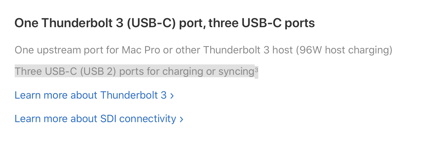

Hi there! I just found out that Apple shows in the XDR tech specs that USB-C ports are USB 2.0
I was sure they are USB 3 (5 or 10 gbps) and work as USB 2.0 only when XDR connected using USB-C cable instead of TB3 (so DSC is activated). But according to Apple spec there's no difference - they always work at USB 2.0 speed.
It says:
Three USB-C (USB 2) ports for charging or syncing3
The 3 is a link to a footnote which says:
For the 16-inch MacBook Pro, USB-C ports have USB 3.1 Gen 1 data transfer speeds.
Basically, any Mac that connects to the XDR with Thunderbolt 3 and DSC from the GPU should be able to use USB 3 speed.
Okay, I use USB-C cable (10 gbps) with XDR, so it uses DSC. As we discussed here, in this case only USB 2.0 speed is available because there's no bandwidth for 5 gbps, right?
Correct. If it's not Thunderbolt, then you can only get USB 2.0.
A USB-C cable can be connected to a Thunderbolt port to get 20 Gbps (like Thunderbolt 2 speed). That should still be enough for USB 3.0. If there's no Thunderbolt at the source then it's just USB-C DisplayPort Alt Mode.
So, if I understand correctly, 20 gbps is available only because it still works as TB device even when we use USB-C cable?

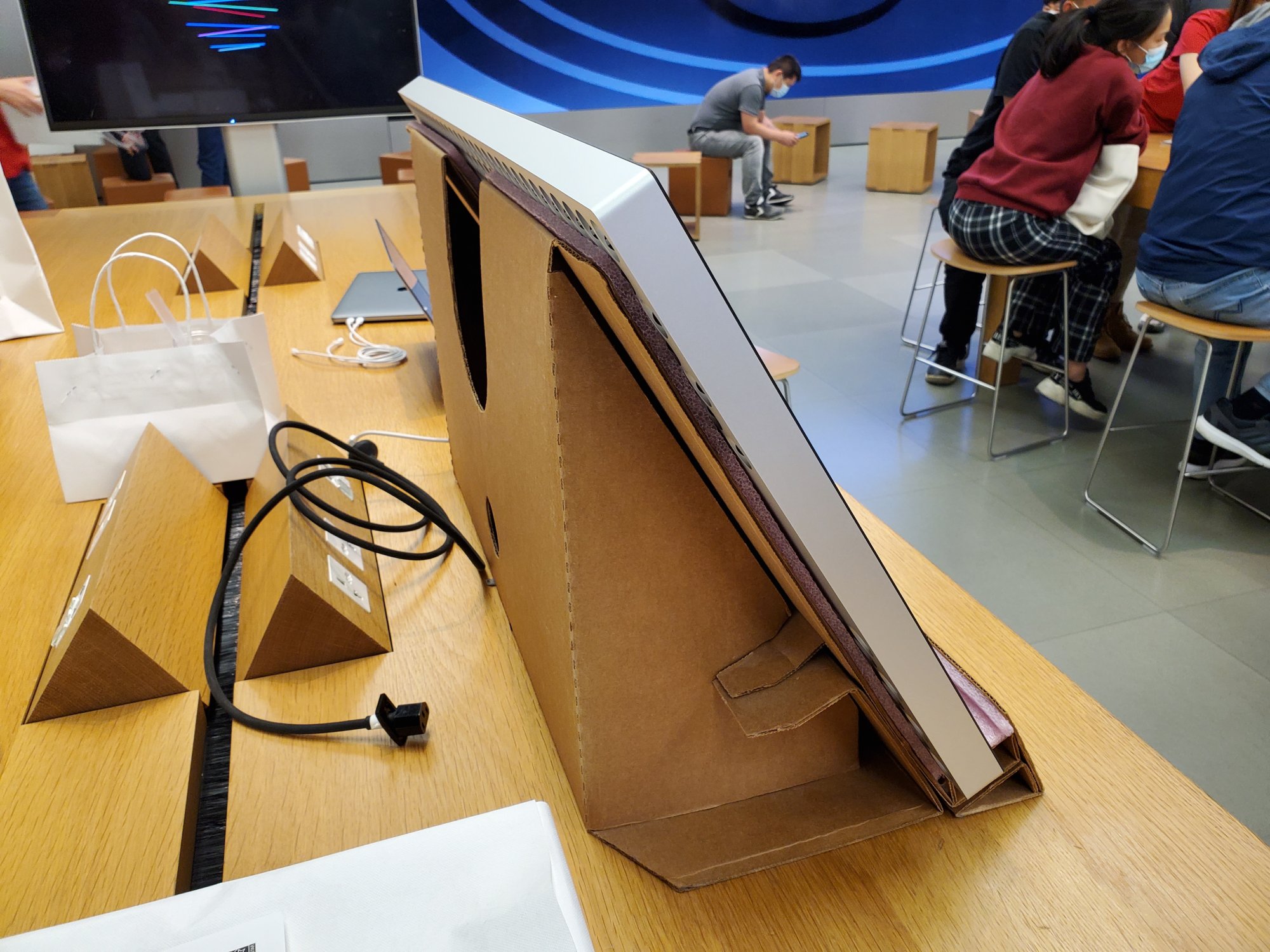

Actually I have experienced exact the same about two years ago. Difference is it only took about 7 days for the new XDR to arrive at my local Apple Store. I'm attaching a picture of a very interesting temporary cardboard rack provided by the store for the on-site screen test as a proof.
BTW, remember to bring the Mickey Mouse face shaped power cable together with the XDR, because they don't have such cable for any other machine.
Points for calling it a Mickey Mouse cable, and picture of the cardboard stand.
You see, they do have a cheaper alternative to the Pro display stand!
