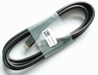

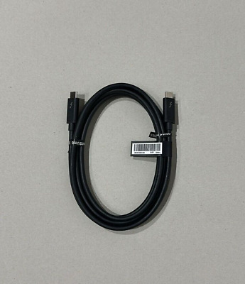

Yes, you will need a USB-C 10 or 20 gbps, the best option is a cable from Dell/HP/LG/Samsung which comes with their displays.
Yep, you ordered the right thing. It also needs a short DP to DP cable if it doesn't come in the box.
Thank you.
I also found these cables, which one is better? Or if i buy a regular usb c on amazon, how will it be worse from samsung?
