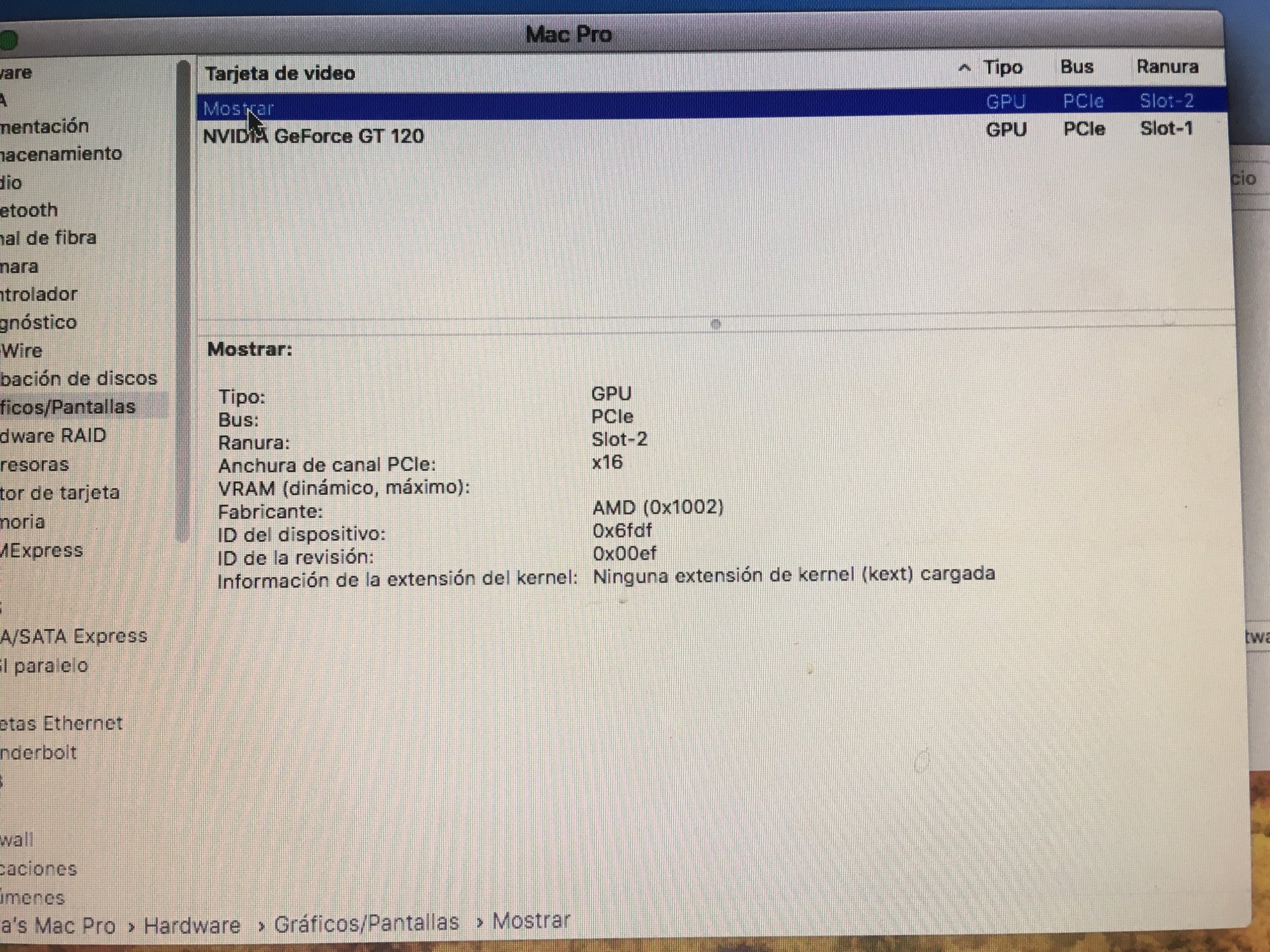

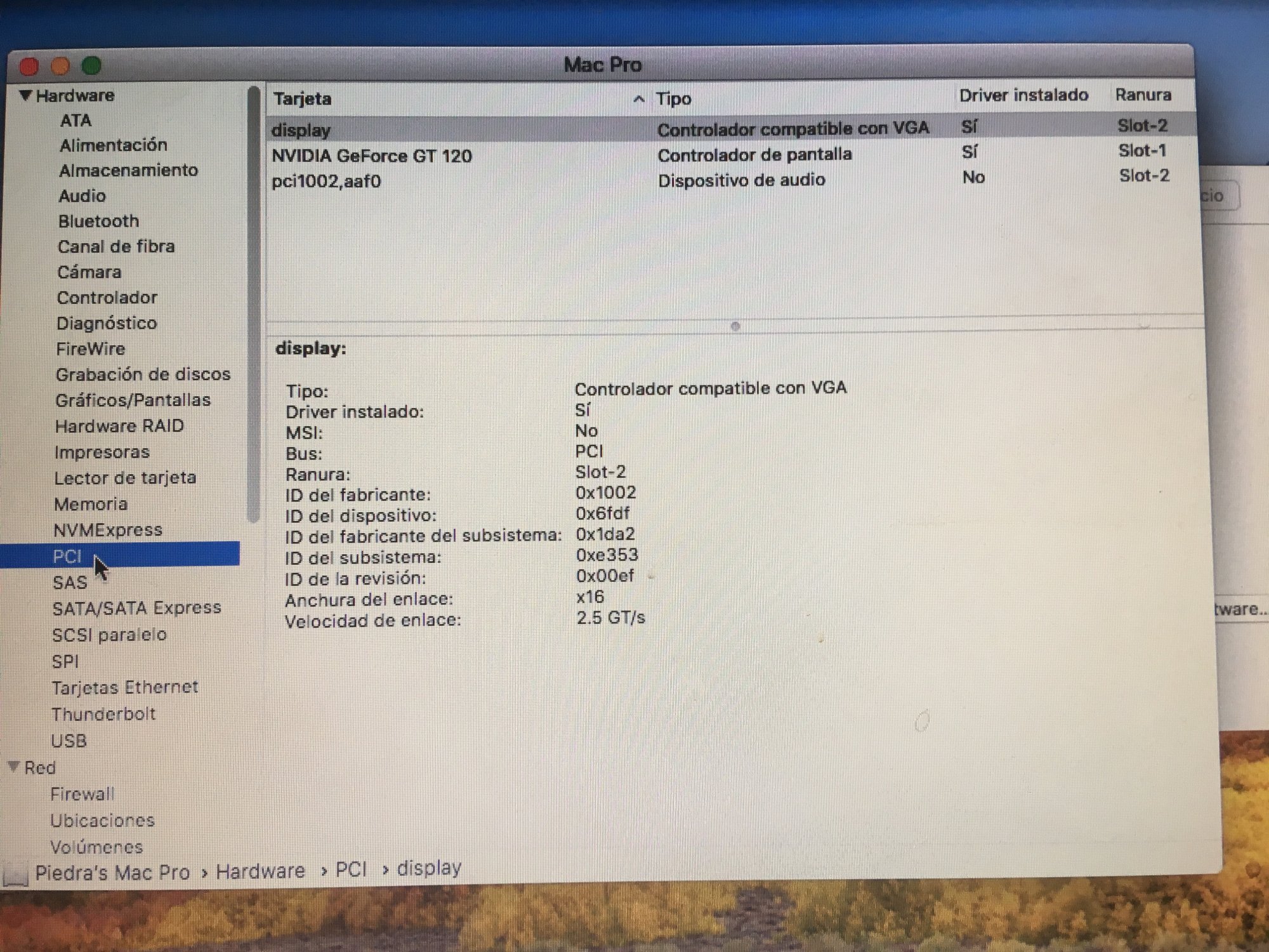

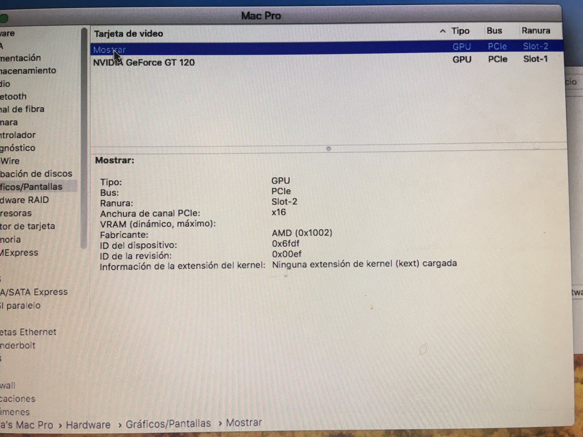

it didn’t work... the gpu and the mac starts fine, but no display. any other ideas what to do?
when I put both gpu’s, I only get display on the gtx 120 but the rx 580 appers like this in sistem information
Hi!, wel, there's been a While, but, as aan update, I boot into Ubuntu from a USB Drive and the card work with no issues... any ideas on how to solve this?
I understand some of the Sapphire RX 580s there is a switch that allows you to switch the bios to different styles. One might be a "mining" setting, you could try switching that switch and rebooting. I also heard that that has no effect on a Mac, but it might be worth a try.
It’s strange how your system report doesn’t show the gpu ram....!
Just a long shot, but what firmware version are you on?
the mac pro is 4,1 flashed to 5,1, then I upgraded the cpu's... I try the Clean install of High Sierra but it didn't work either... I'm still stuck...I'm thinking now on flashing the bios on the gpu, reset back to factory default if somebody upgraded in some point... any thoughts on that?
But what is your mac firmware (boot rom version)......?
Look in system report, select top line ‘hardware’.
