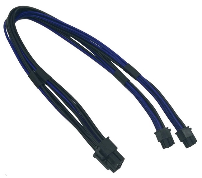

Install ONLY the RX 580
This is the correct cable for your RX 580 from amazon.com
This may or may not work . . . read the small black text.

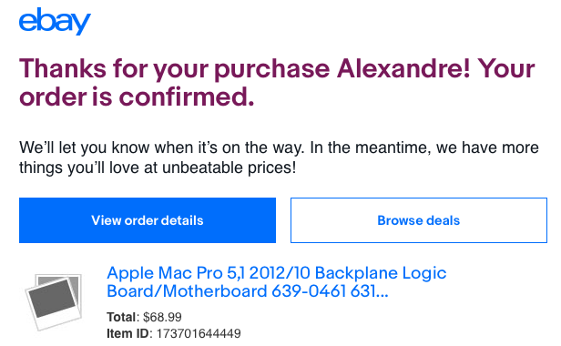

The best way to diagnose a Mac Pro is to test the parts with another one that works. You can easily find what is causing your problem changing the parts between the two. Look at Mac Pro prices, maybe you can find a bargain on Craigslist. Any early-2009 to mid-2012 can be used for diagnostics purposes. You can't use a 2009 backplane with a mid-2010/mid-2012 CPU tray - incompatible SMC version and fans will work full time at full RPM - but for sure you can use a early-2009 Mac Pro to find what is defective with a mid-2010/mid-2012.
You can get an used backplane for around $75 + shipping on eBay with some searching, sometimes even less - I got a mid-2010 last year for $68,99 with free shipping.

It appears so. When I bought it I went with a 16gauge, I was reading the heavy gauge would be better?
I noticed on this one I bought (initial cable), the end has all black wires on the end top row where the rest of the top row is blue (left photo). Man I hope that the wiring wasn't incorrect ?
I now bought another cable, but made sure the listing is for Mac Pro video cards, pic on the right.
