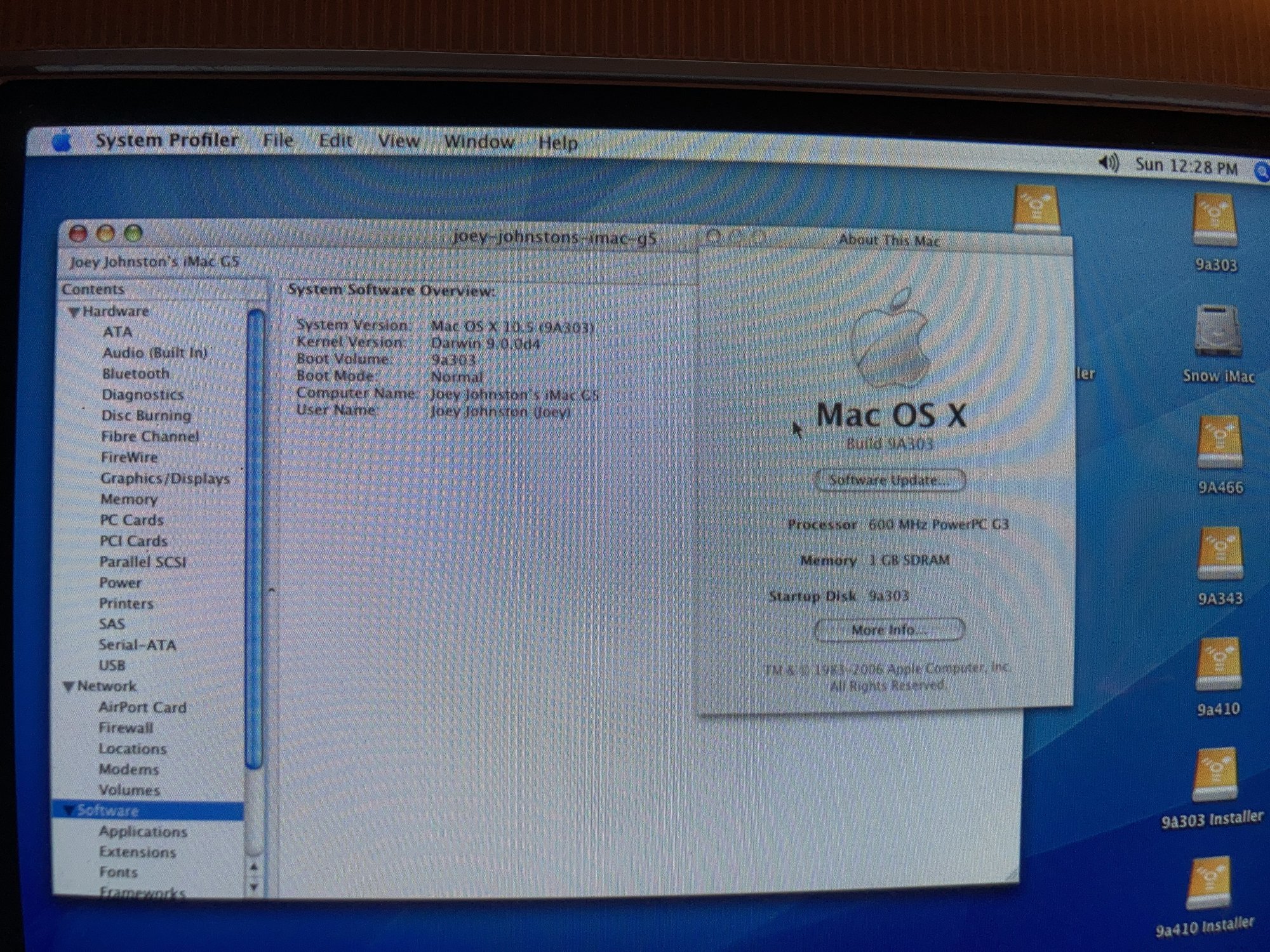

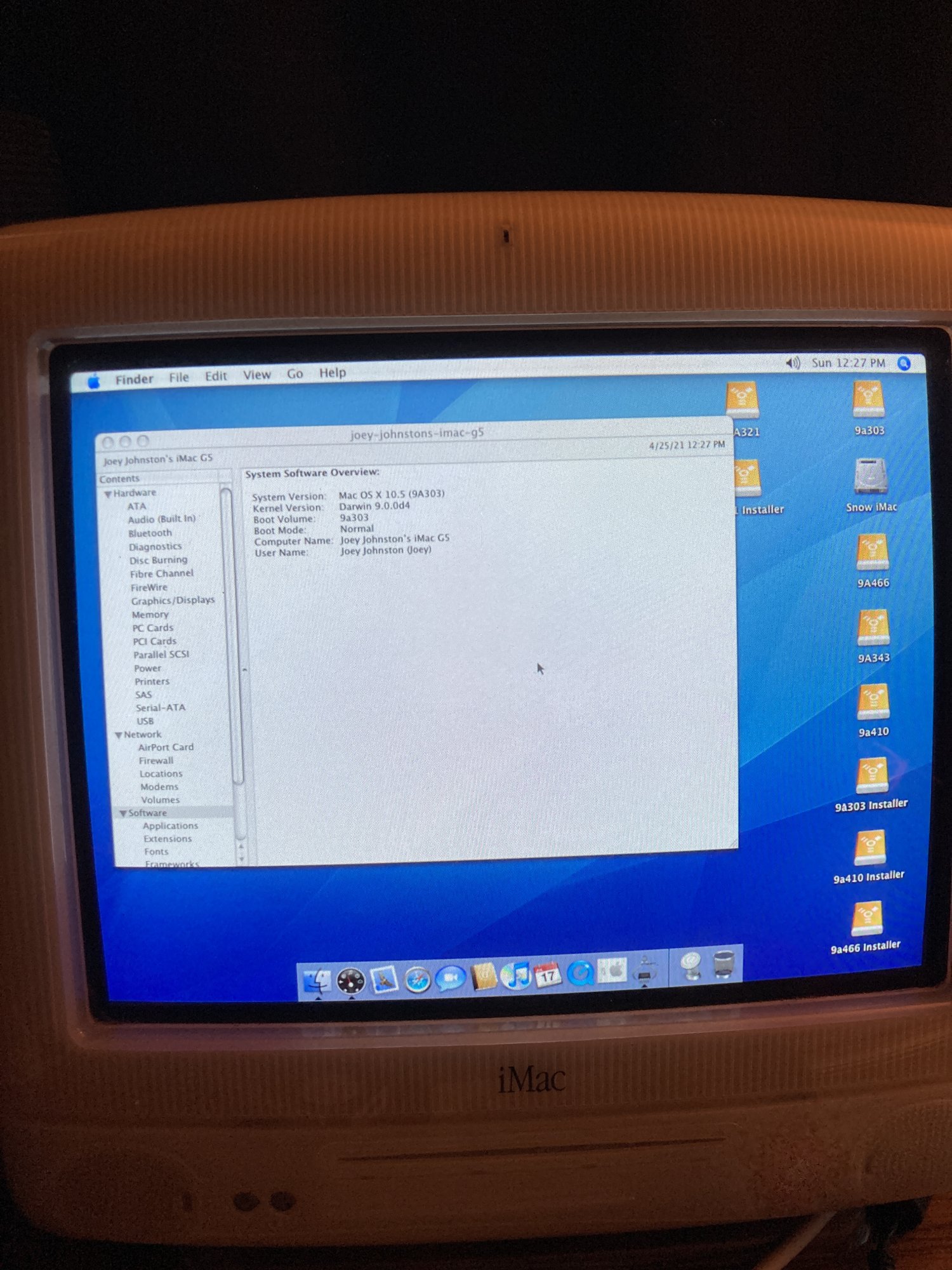

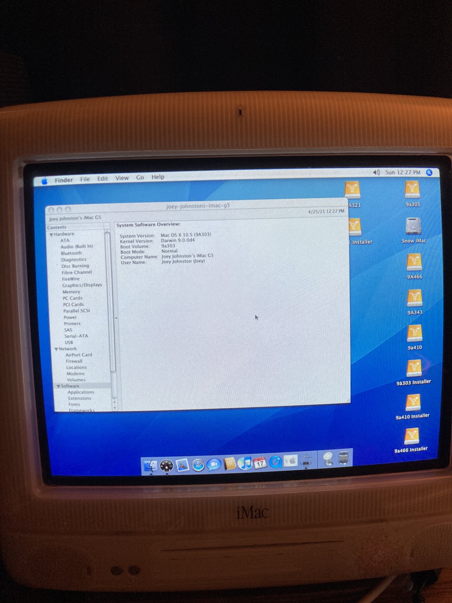

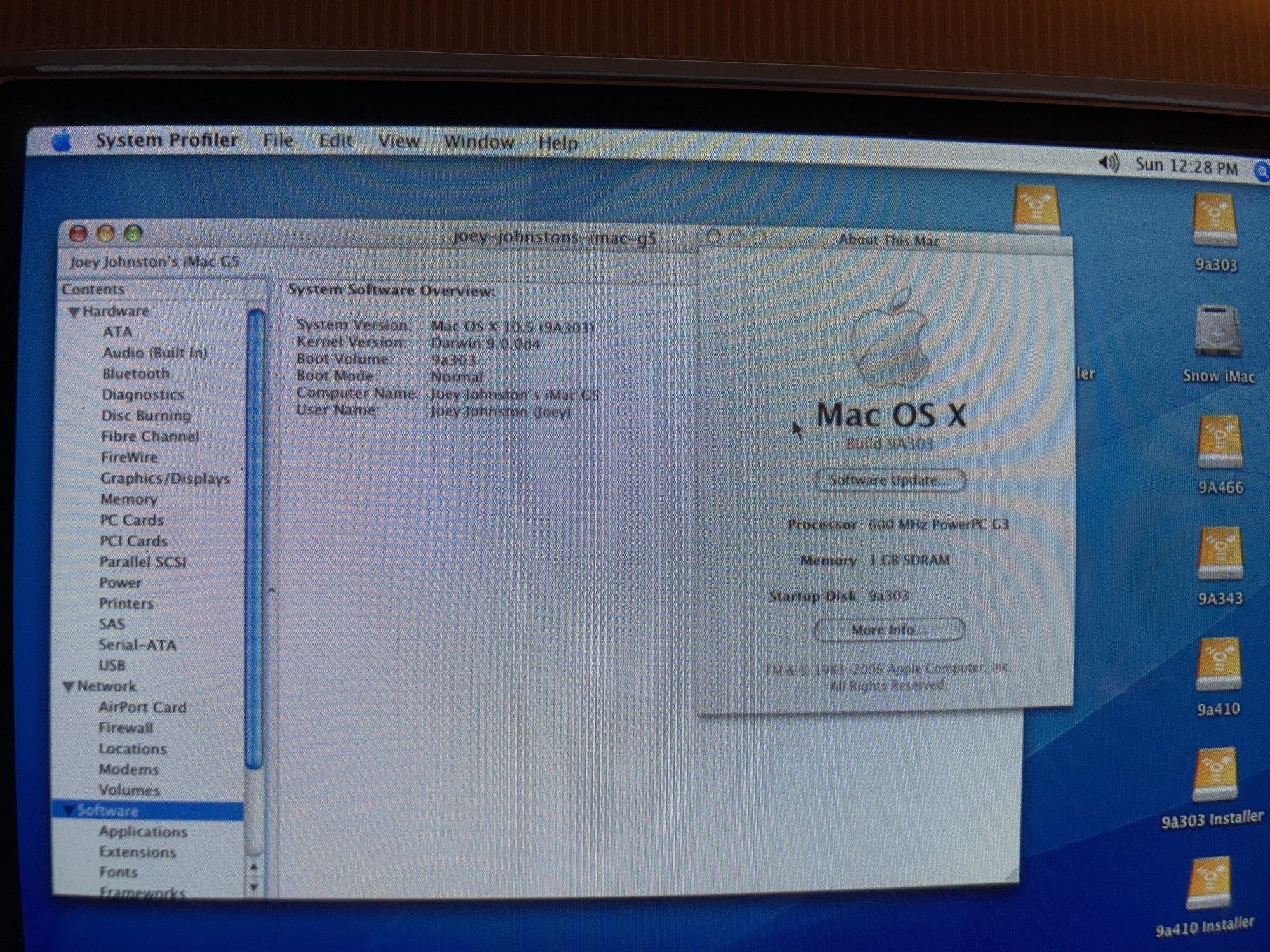

9A303 while it boots the copy of the Finder it has crashes.... has to do with Carbon.framework.
I was able to use the same method as I did for 241. 303 has a broken Carbon framework.
Reinstallation of 9A303 is in progress. Will try taking the carbon framework from 9A241 to see if that fixes anything.

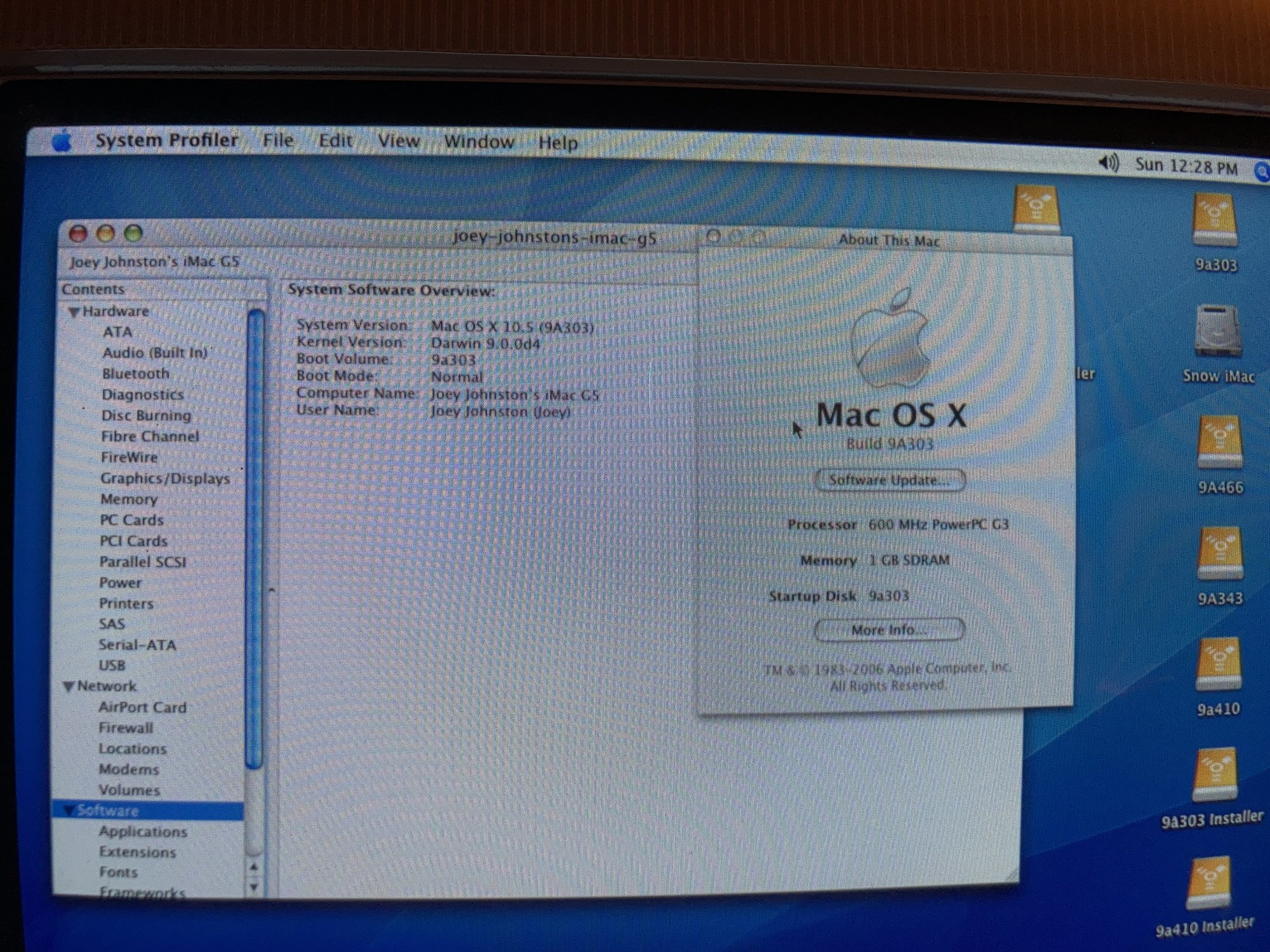

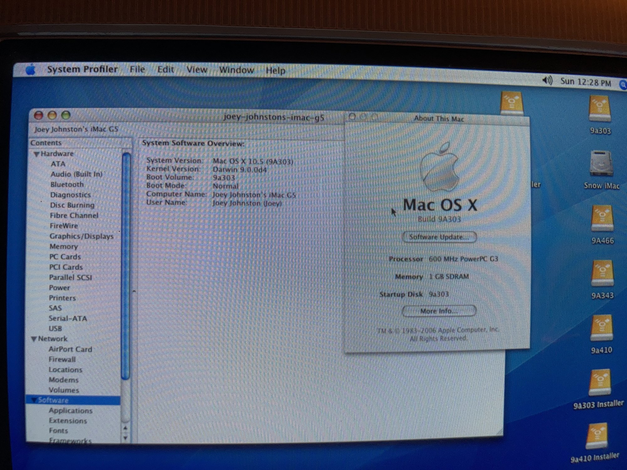

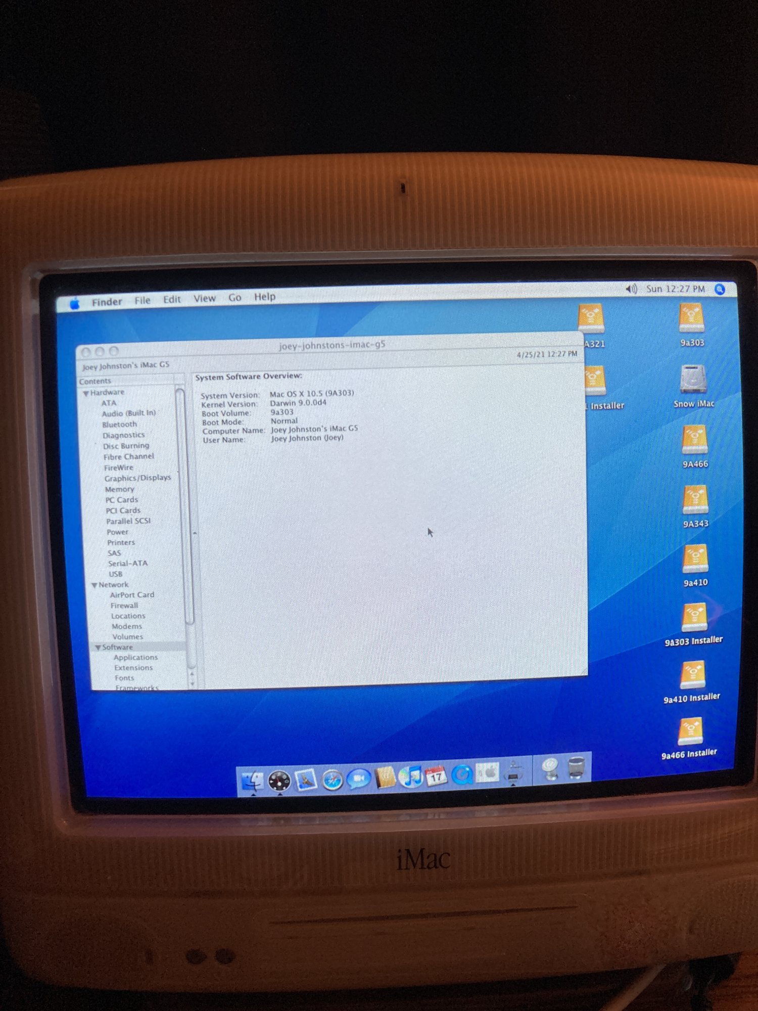

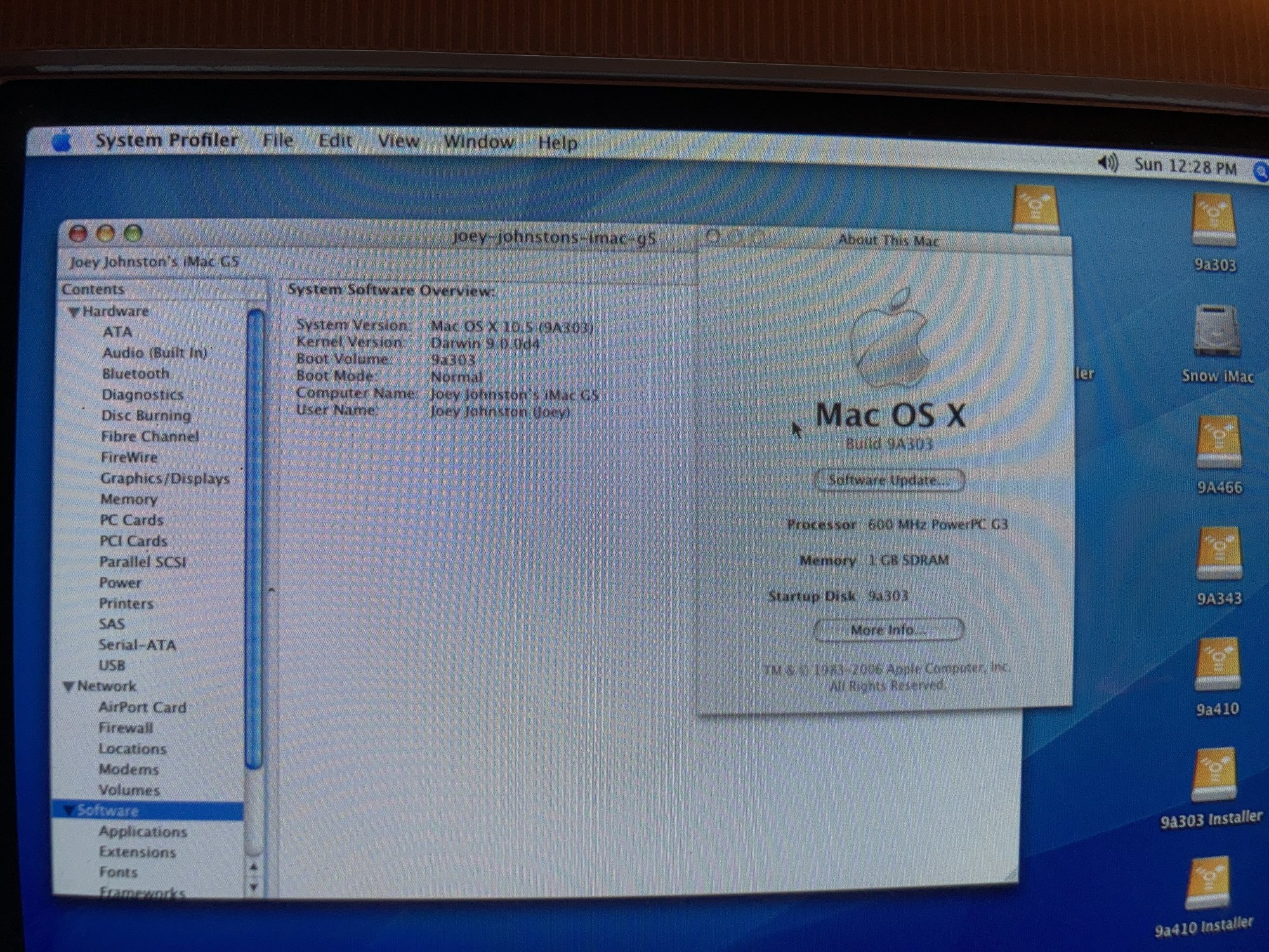

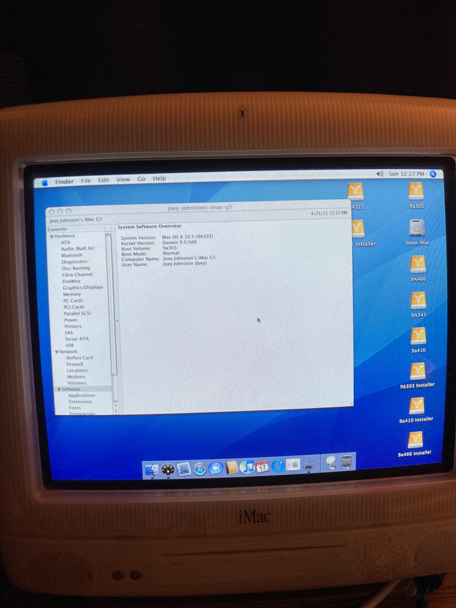

I'm not sure why you can't boot 9A303. I've had no problem booting it.
Once booted however, it's basically useless. Finder hangs and relaunches when opening any finder window. This is why I have actual photos instead of screenshots.
It only does it on G3s, not G4s. Not sure why.
View attachment 1763803 View attachment 1763804
It’ll boot fine but I’m faced with the same issue as you. Replacing the Carbon framework with the one found in 9A241, results in inability to login. It’ll kick me back to the login screen. Likewise, replacing it with the one found in Tiger results in the system not booting the whole way, sitting there spinning at the boot screen.
