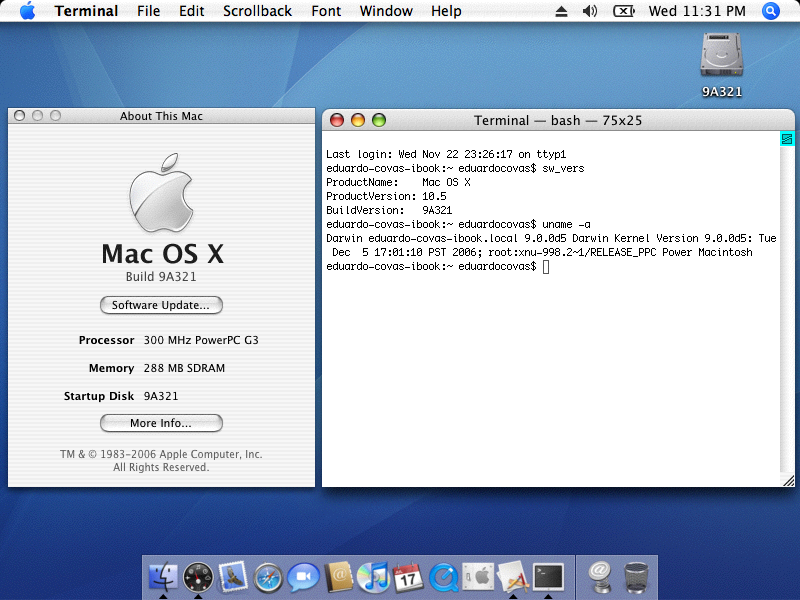

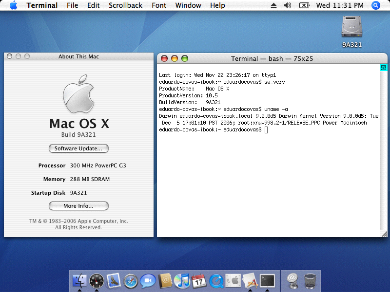

Build 9A321 runs ok on my Clamshell, I've installed it on my G5 then imaged to the G3 because it doesn't have a DVD drive. On first boot everything was crashing on dyld but running update_dyld_shared_cache in single user fixed that.
For some reason Finder was crashing, replaced it with the one from 9Z1554 and it now seems to be working.

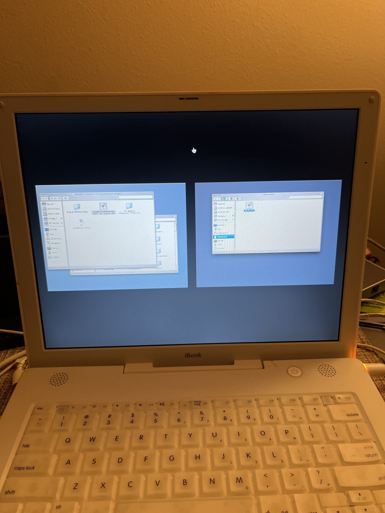

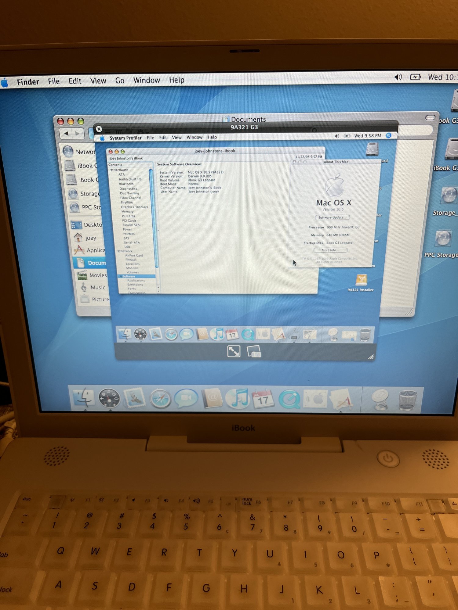

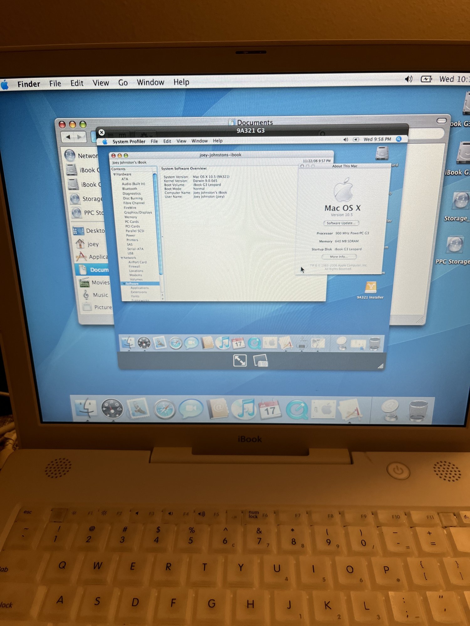

I just successfully installed 9A321 on a 900MHz 14” iBook G3. I installed normally using a PowerBook G4, I then replaced Finder with the one from 9Z1554. I didn’t boot into it all before doing that.
After that, I cloned it over to the G3 and started it up. It worked without having to go into single user mode and running update_dyld_shared_cache.

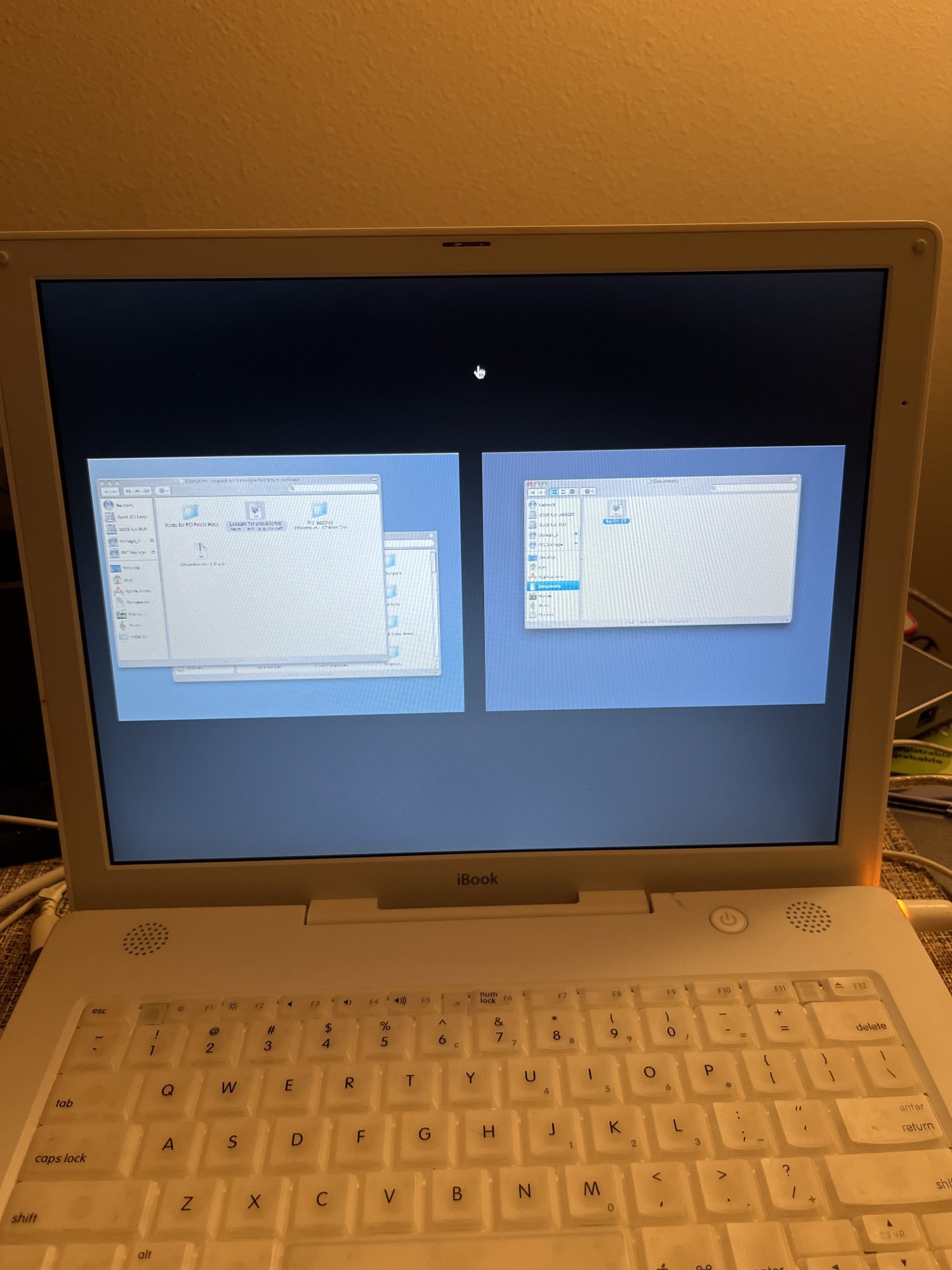

This build has quick look, and spaces. Quick Look is only available from the menu or the CMD+Y shortcut. I found that by pressing it out of habit.
Spaces works if enabled, but if you go into the spaces prefpane, system preferences crashes.
(Excuse the phone pictures, I didn’t feel like taking more screenshots with grab just to move them to a device that I can easily post with)

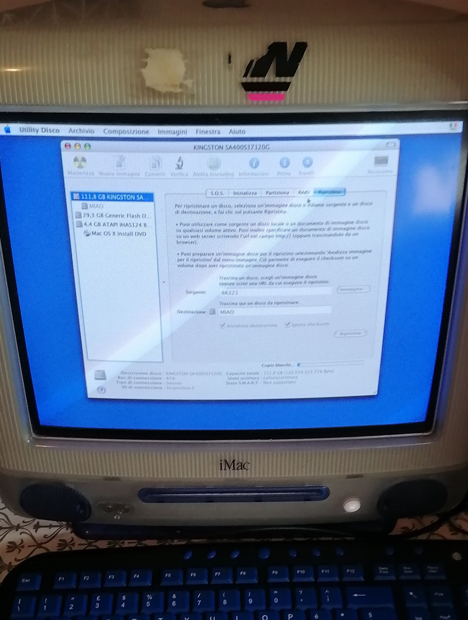

Actually, how I can use this on imac g3 with a usb stick? for installation!
What I've done was booting into a Panther install disc and restored the image from USB to an HDD partition using disk utility since I can't boot anything from USB.
For now I'm trying to do this, thanks!
