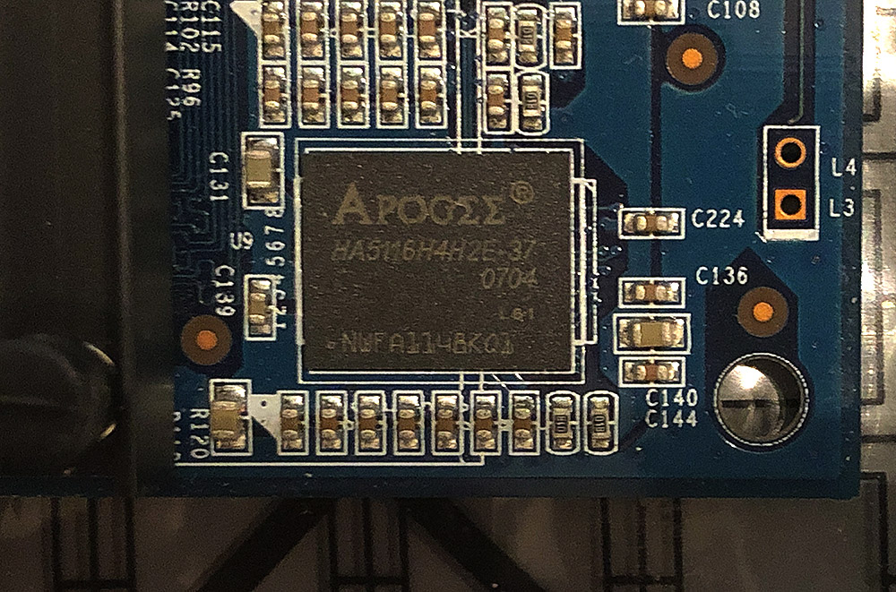

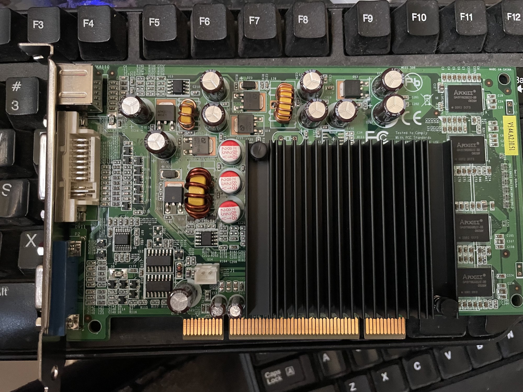

Is the card's PC-ROM the same that i have? (attached)
Is the memory of the card BGA or TSOP?
Not quit the same PC ROM, tho the FCODE ROM you linked for your card and the one I made for mine with the ROM maker are nearly identical.
It's BGA RAM.

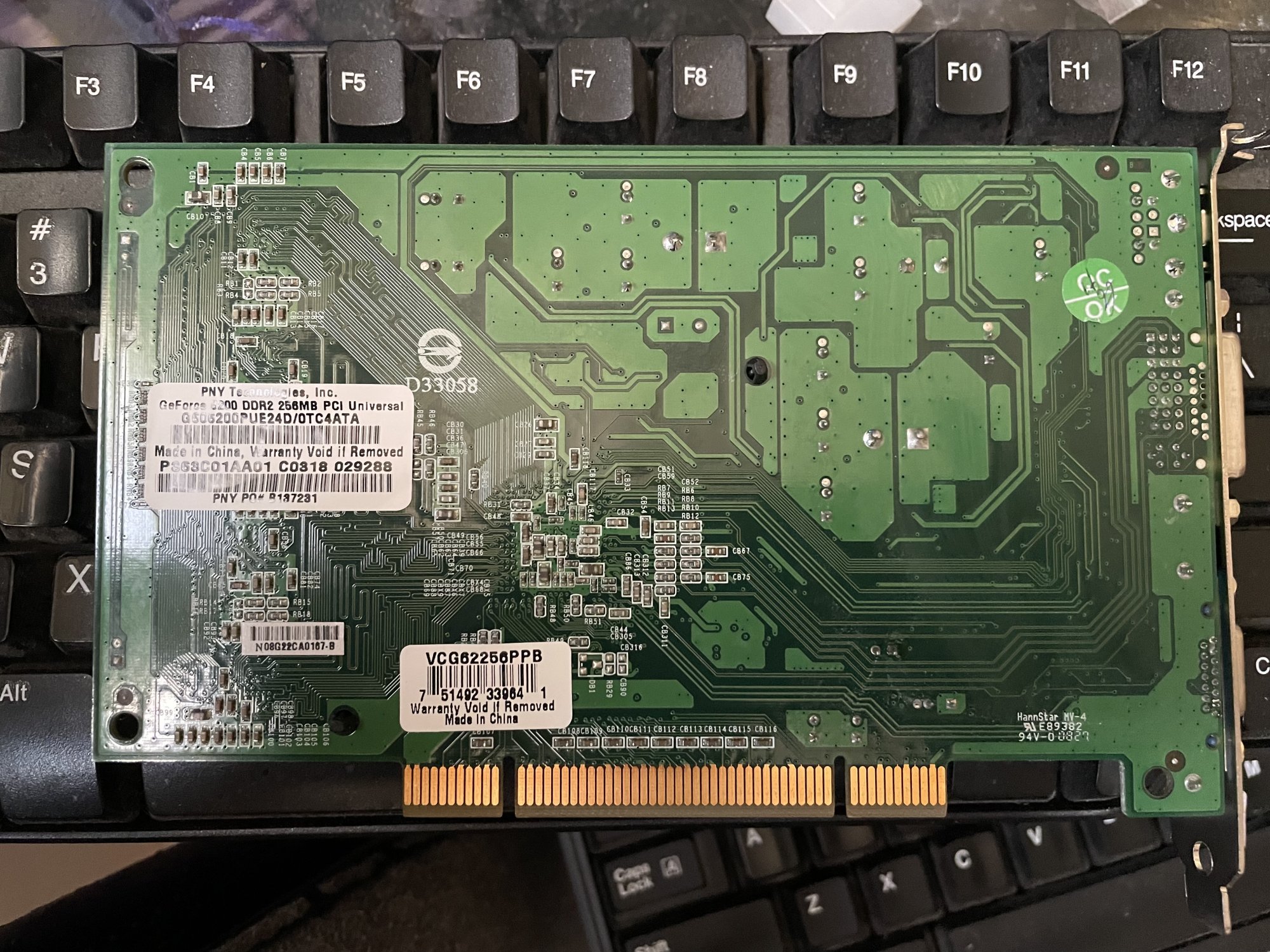

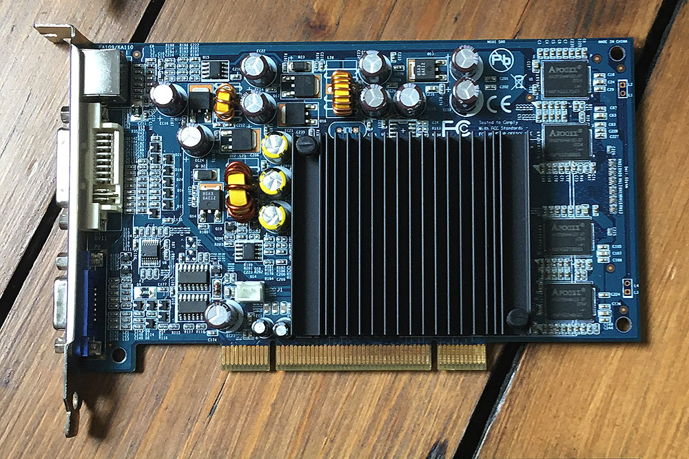

Would be interesting to know, if we have the exact same cards. So i posted a pic before, but here is mine again.
...and also a detailed view of one of the memory chips.
Yes. I made a quick compare with Hex Fiend and only found 17 differences.
PC-ROMs hav a few more but also look very similar.

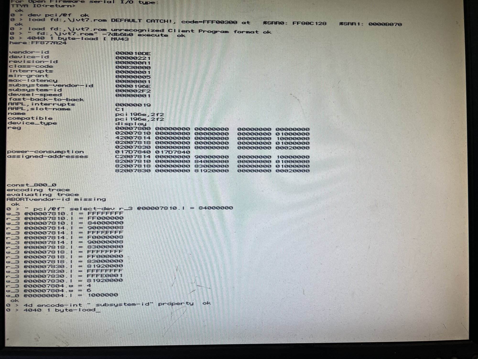

When I ran V5 of JoeVT's debug ROM on the G5 it did produce a display on the card, but it was all garbled do to the differences, but that gives me hope I can fix the 512MB cards ROM as it also has BGA RAM.
seems to work perfectly with Tiger.
I noted the CI says it is supported, but I don't get the ripple effect in the Dashboard, does that work on your PCI 6200?
QE seems to work fine tho.
Still waiting on the serial device, but none of the test roms seem to work with this card in my Beige. V7 had a long output of .words that a had to scroll through on the screen, but didn't build any .properties for the card other than the subsystem-id(0x10).

And thanks for posting the Pics. Aside from the green PCB, i could not find any differences, but only the three caps in front of the heatsink look like better quality than what i have. Even the memory seems the same brand.
Strange that the card doesn't seem to offer complete CI-support and does not really work in a G5 with Joe's V5. Did you try my Mac ROM on it?

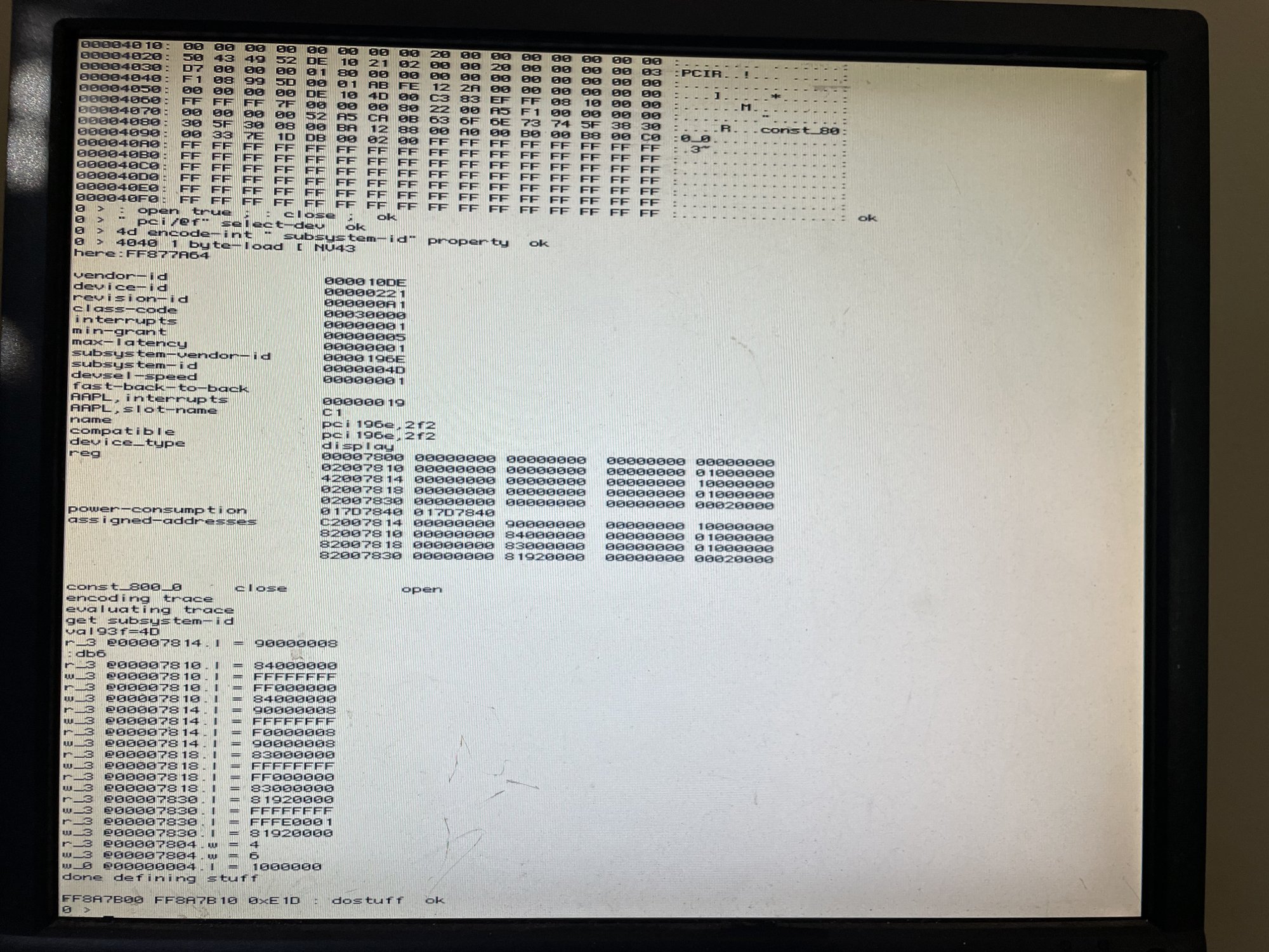

This is what i get in the Sawtooth>
Code:
0 > dev pci/@3  ok
0 > load cd:,\TEST8A.ROM load-size=1ffc0 adler32=240d0a18
 ok
0 > : open true ; : close ;  ok
0 > " pci/@3" select-dev  ok
0 > 800000 1 byte-load [ NV43
here:ff97e38c
vendor-id               000010de
device-id               00000221
revision-id             000000a1
class-code              00030000
interrupts              00000001
min-grant               00000005
max-latency             00000001
devsel-speed            00000001
fast-back-to-back
name                    pci10de,221
compatible              pci10de,221
                        pciclass,030000
reg                     00011800 00000000 00000000  00000000 00000000
                        02011810 00000000 00000000  00000000 01000000
                        42011814 00000000 00000000  00000000 10000000
                        02011818 00000000 00000000  00000000 01000000
                        02011830 00000000 00000000  00000000 00020000
assigned-addresses      c2011814 00000000 90000000  00000000 10000000
                        82011810 00000000 82000000  00000000 01000000
                        82011818 00000000 81000000  00000000 01000000
                        82011830 00000000 800a0000  00000000 00020000
R2AD                    5c3e8200 90ff002b 00000000 00000000 2e7c0690 07300030 0020041a 04380003
                        0006041a 06900001 00000000 00000000 00000000 00000000 00000000 00000000
close           open
encoding trace
evaluating trace
stacks: ff800000 ff800400 ff8007ac ff800c00 ff801000 ff801760
:e0c
:dd6
get subsystem-id
set subsystem-id
get subsystem-id
val93f=4d
:db6
done defining stuff
patching words...
 ok
0 >

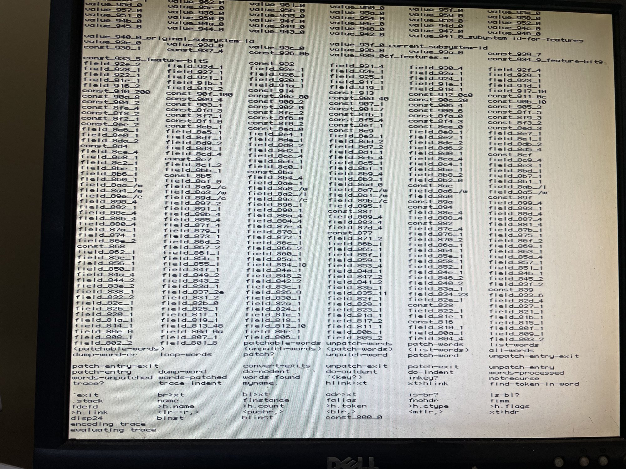

I don|t know, if the three dots are alerting, that it does something in the background. Did the load some 15 minutes ago. But up to now nothing else happened.
Just out of curiosity, i also loaded the ROM to the beige. Started similar, but then startet outputting some DEFAULT CATCH!-errors and kept doing this for over an hour and 5 MB of output until i stopped it.
Weird. I don't get that. Anything in the output before default catch that was different?
See attached file. As mentioned above, this is not complete. Went like that for over 5MB and didn't even stop then.

Ill try v. 9 as soon as possible.
  • output_test8_beige.zip
6200 #9 only patches words of the device. If this doesn't work on Sawtooth, then I'll remove patches.
9 seems to work nice for the Sawtooth. Here is the result:

I loaded v. 9 to the G3 and here is, what i get:
Code:
0 > dev pci/@f  ok
0 > " ide0/@0:1,\TEST9.ROM" (load)  ok
0 > " pci/@f" select-dev  ok
0 > 600040 1 byte-load [ NV43
here:ff85886c
vendor-id               000010de
device-id               00000221
class-code              00030000
interrupts              00000001
min-grant               00000005
fast-back-to-back
AAPL,interrupts         00000019
AAPL,slot-name          C1
name                    pci10de,221
device_type             display
reg                     00007800 00000000 00000000  00000000 00000000
                        02007810 00000000 00000000  00000000 01000000
                        42007814 00000000 00000000  00000000 10000000
                        02007818 00000000 00000000  00000000 01000000
                        02007830 00000000 00000000  00000000 00020000
power-consumption       00e4e1c0 00e4e1c0
assigned-addresses      c2007814 00000000 90000000  00000000 10000000
                        82007810 00000000 82000000  00000000 01000000
                        82007818 00000000 81000000  00000000 01000000
                        82007830 00000000 80820000  00000000 00020000
close           open
encoding trace
evaluating trace
stacks: ff800000 ff800400 ff8007bc ff800c00 ff801000 ff8017a0
:e0c
:dd6
get subsystem-id
set subsystem-id
get subsystem-id
val93f=4d
:db6
done defining stuff
patching words...
found:1693 processed:1573 patched:1573
ff810568 ff810578 0x8a ff81ba38 defer expect (UNKNOWN FORMAT! not br)
ff810678 ff810688 0x8d ff814330 defer key? (UNKNOWN FORMAT! not br)
ff810658 ff810668 0x8e ff814360 defer key (UNKNOWN FORMAT! not br)
ff812cd8 ff812ce8 0x92 : cr (UNKNOWN FORMAT! not br)
ff810638 ff810648 0x90 ff814640 defer type (UNKNOWN FORMAT! not br)
ff817378 ff817388 0x6cf ff8173b0 defer status (UNKNOWN FORMAT! not br)
ff812d18 ff812d28 0xfe0 : space (UNKNOWN FORMAT! not br)
done patch-words
ff8628f0 ff8628f8 0xf03 : ^-79d708
ff8629e0 ff8629e8 0xf06 : ^-79d618
ff862a10 ff862a18 0xf07 : ^-79d5e8
ff862b00 ff862b08 0xf0c : ^-79d4f8
ff862b38 ff862b40 0xf0d : ^-79d4c0
ff862410 ff862418 0x9e0 : ^-79dbe8
ff862dc0 ff862dc8 0xa0a : ^-79d238
ff862e00 ff862e08 0xa0b : ^-79d1f8
ff862f60 ff862f68 0xa12 : ^-79d098
ff862e60 ff862e68 0xa0d : ^-79d198
ff862ee0 ff862ee8 0xa0f : ^-79d118
ff862f20 ff862f28 0xa10 : ^-79d0d8
ff862f40 ff862f48 0xa11 : ^-79d0b8
ff862f80 ff862f88 0xa13 : ^-79d078
ff863418 ff863420 0xa2a : ^-79cbe0
ff863440 ff863448 0xa2b : ^-79cbb8
ff863460 ff863468 0xa2c : ^-79cb98
ff863538 ff863540 0xa32 : ^-79cac0
ff8635b8 ff8635c0 0xa36 : ^-79ca40
ff865848 ff865850 0xb03 : ^-79a7b0
ff865868 ff865870 0xb04 : ^-79a790
ff865888 ff865890 0xb05 : ^-79a770
ff8658a8 ff8658b0 0xb06 : ^-79a750
ff8658f8 ff865900 0xb07 : ^-79a700
ff865990 ff865998 0xb08 : ^-79a668
ff8659b0 ff8659b8 0xb09 : ^-79a648
ff8659d0 ff8659d8 0xb0a : ^-79a628
ff8659f0 ff8659f8 0xb0b : ^-79a608
ff865a10 ff865a18 0xb0c : ^-79a5e8
ff865a50 ff865a58 0xb0e : ^-79a5a8
ff865a90 ff865a98 0xb10 : ^-79a568
ff865ab0 ff865ab8 0xb11 : ^-79a548
ff865ad0 ff865ad8 0xb12 : ^-79a528
ff865af0 ff865af8 0xb13 : ^-79a508
ff8673b8 ff8673c0 0xb7a : ^-798c40
ff868280 ff868288 0xbbe : ^-797d78
ff8683b0 ff8683b8 0xbc7 : ^-797c48
ff8685b0 ff8685b8 0xbd1 : ^-797a48
ff868648 ff868650 0xbd4 : ^-7979b0
ff868718 ff868720 0xbd8 : ^-7978e0
ff868810 ff868818 0xbdc : ^-7977e8
ff868840 ff868848 0xbde : ^-7977b8
ff8688a0 ff8688a8 0xbe0 : ^-797758
ff868ef0 ff868ef8 0xbea : ^-797108
ff8690b8 ff8690c0 0xbed : ^-796f40
ff86a928 ff86a930 0xc2d : ^-7956d0
ff86a990 ff86a998 0xc2e : ^-795668
ff863290 ff863298 0xa24 : ^-79cd68
ff863310 ff863318 0xa25 : ^-79cce8
ff866410 ff866418 0xb28 : ^-799be8
ff861bb8 ff861bc0 0x9a7 ff812b78 defer ^-79e440
ff8611c8 ff8611d0 0x93d 44 value ^-79ee30
ff865818 ff865820 0xb01 0 value ^-79a7e0
ff866f80 ff866f88 0xb4d 0 value ^-799078
ff867070 ff867078 0xb57 0 value ^-798f88
ff8670b8 ff8670c0 0xb5a 0 value ^-798f40
ff8670d0 ff8670d8 0xb5b 0 value ^-798f28
ff86a050 ff86a058 0xc0b 0 value ^-795fa8
ff86a068 ff86a070 0xc0c 0 value ^-795f90
ff86a080 ff86a088 0xc0d 0 value ^-795f78
ff86a098 ff86a0a0 0xc0e 0 value ^-795f60
ff86a0c8 ff86a0d0 0xc10 0 value ^-795f30
ff86a0f8 ff86a100 0xc12 0 value ^-795f00
ff86a140 ff86a148 0xc15 0 value ^-795eb8
ff86a158 ff86a160 0xc16 0 value ^-795ea0
ff86a1a0 ff86a1a8 0xc19 0 value ^-795e58
ff86a1b8 ff86a1c0 0xc1a 0 value ^-795e40
ff86a660 ff86a668 0xc21 0 value ^-795998
ff86a678 ff86a680 0xc22 0 value ^-795980
ff86a690 ff86a698 0xc23 0 value ^-795968
ff86a6a8 ff86a6b0 0xc24 0 value ^-795950
ff86a6c0 ff86a6c8 0xc25 0 value ^-795938
ff86a6d8 ff86a6e0 0xc26 0 value ^-795920
ff86a6f0 ff86a6f8 0xc27 0 value ^-795908
ff86a708 ff86a710 0xc28 0 value ^-7958f0
ff86a720 ff86a728 0xc29 0 value ^-7958d8
ff86e830 ff86e838 0xca1 0 value ^-7917c8
ff86e818 ff86e820 0xca0 0 value ^-7917e0
ff865ec0 ff865ec8 0xb1b 0 value ^-79a138
ff866e48 ff866e50 0xb40 0 value ^-7991b0
ff866e78 ff866e80 0xb42 0 value ^-799180
ff861948 ff861950 0x98d 0 value ^-79e6b0
ff863ca8 ff863cb0 0xa5b ffffffff value ^-79c350
ff813578 ff813588 0x9b : u. (UNKNOWN FORMAT! not br)
ff810588 ff810598 0x9d ff813560 defer . (UNKNOWN FORMAT! not br)
ff812ba8 ff812bb8 0x126 : ms (UNKNOWN FORMAT! not br)
ff80d0c8 ff80d0e0 0x8b ff810488 defer alloc-mem (UNKNOWN FORMAT! not br)
ff813c18 ff813c28 0xcb : $find (UNKNOWN FORMAT! not br)
ff81ec88 ff81eca0 0x11a : device-type (UNKNOWN FORMAT! not br)
ff81e718 ff81e730 0x110 : property (UNKNOWN FORMAT! not br)
ff81f0f0 ff81f108 0x21a : get-my-property (UNKNOWN FORMAT! not br)
[ :dostuff
:ddb
:e10
here:ff89872c -769ca0 23cc -769ca0
got exception fff00300
done dostuff
:9c7
set reg
set #size-cells
evaluate : decode-unit ." decode-unit" parse-1hex ; ['] decode-unit 18 - 28 dump
ff8989a0: ff fe 9f 78 80 b7 08 7a 0b 64 65 63 6f 64 65 2d :...x...z.decode-:
ff8989b0: 75 6e 69 74 00 00 00 00 96 7e ff fc 7e 68 02 a6 :unit.....~..~h..:
ff8989c0: 4b f7 17 41 0b 64 65 63 :K..A.dec:set VRAM,memsize
[ displays
] displays
[ :db7
] :db7
] NV43
here:ff899470
 ok
0 > .properties words
vendor-id               000010de
device-id               00000221
class-code              00030000
interrupts              00000001
min-grant               00000005
fast-back-to-back
AAPL,slot-name          C1
name                    NVDA,Parent
device_type             display
subsystem-id            00000010
model                   Geforce 6200
#address-cells          00000001
#size-cells             00000000
rom-revision            32313439 6100
NVDA,Features           004d00ef
NVDA,Level              00000001
VRAM,memsize            00000000 00000000
decode-unit     close           open            patch?          patchable-words unpatch-words
patch-words     list-words      defer-patch?    dump-return-stack               addr>xt
closest-word    closest-offset  closest-xt      instruction-addr                words-iterator
loop-words-global               loop-words-siblings             loop-words-local
loop-words      all-words       dump-word-cr    unpatch-word    patch-word      patch-word-behavior
unpatch-colon   patch-colon     patch-colon-behavior            convert-exits   unpatch-field
patch-field     patch-field-behavior            unpatch-exit    patch-exit      patch-exit-behavior
unpatch-defer   patch-defer     patch-defer-behavior            unpatch-entry   patch-entry
patch-entry-behavior            dump-word       do-nodent       do-outdent      do-indent
trace-off       trace-on        words-processed words-unpatched words-patched   words-found
pause-level     recurse-level   indent-level    notdenting?     trace?          myname.
hlink>xt        xt>hlink        find-token-in-word              'exit           br>xt
bl>xt           adr>xt          is-br?          is-bl?          .stack          log-patches
name.           <pushd,>        <pushr,>        <lr->r,>        <mflr,>         <blr,>
xt>hdr          <b,>            disp24          binst           blinst          d24mask
finstance       falias          fnohdr          fimm            fdefd           >h.name
>h.count        >h.token        >h.ctype        >h.flags        >h.link         >dn.probe-addr
>dn.assd-addrs  >dn.#scells     >dn.#acells     >dn.instance-bfr-ptr            >dn.instance-offset
>dn.methods     >dn.properties-tl               >dn.properties-hd               >dn.peer-bak
>dn.peer-nxt    >dn.child       >dn.parent      >dn.check       check-stacks    ep
fp              lp              rp              sp              'e              'f
'l              'r              's              blr             mflr            lr->r
pushr           pushd           trace-end       trace-begin     close           open
 ok
0 > dev @0 decode-unit ok
name                    no-A
power-switch-disable            power-switch-enable             ddc2-send-byte  ddc2-set-stop
ddc2-set-start  dimensions      get-colors      set-colors      color@          color!
read-rectangle  fill-rectangle  draw-rectangle  set-mode        show-modes      get-mode
 ok
0 >
Very similar to what the Sawtooth outputs. Card seems to be recognized ok. Only the display attached to the VGA is not "seen". But to me it looks like just one step away.

Reactions: LightBulbFun
Bit strange to me looks, that for the Beige all the child devices of the 6200 have the same adress "@0", while in Sawtooth the displays appear as @0, @1 and the temp sensor is @2.
Edit: Some more differences.
"compatible"-property also has "pciclass,030000" in Sawtooth, which is missing in Beige. "device_type" for Sawtooth is "NVDA,GeForce", for the Beige it's "display".
Also booted to the OS without problems.
Glad it still works.
Looks to me, you are very close to success now!
Code:
[ :dostuff
:ddb
:e10
done dostuff
Looks like it was able to catch an exception which means some stuff was not completed. I need to figure out a method to get a stack trace when the exception is thrown. In the mean time, I can enable trace for just the part that is failing (between the here in :e10 and the call to :ddd). The trace only includes words from the fcode rom for now.
Wait one sec - I made a change to decode-unit but it's not working. I'll revert. ... no need to revert, just forgot to make it external. Try 6200 #11.
  • 6200 #11.zip
Reactions: flyproductions
Hmmm, sadly still no display-child-devices found.
Code:
ff858370:   /NVDA,Parent@f             [pci10de,221]
ff898b48:     /no-A@0
ff898ef0:     /no-B@0
ff899298:     /sensor-parent@0         [NVDA,sensor-parent]
ff899408:       /gpu-diode-temperature@0
ff856f30: /perch@0                     [Whisper]
 ok
0 >
Some output from the end of the byte-load in Beige with v. 11...

Also note that most of the properties the FCode ROM should create are missing from the Parent and no VRAM,size is found.
Yes, didn't notice that memsize was zero yesterday.
And further missing, compared to Sawtooth, are...
Code:
Code:
NVPM                    01000000 00000000 00000000 00000000 00000000 00000000 00000000
Code:
NVCAP                   04000000 00000001 000e0000 00000007 000000
...compared to what the Sawtooth with v. 9, which was allready working, showed for this part.
Same here with OF 2.01f
Please provide the entire output from [ NV43 to ] NV43 I don't care about properties. I am looking for the part that occurs before "got exception" is output. I understand that since an exception occurred, the trace was not finished where I intended it to. If you did not save the entire output and there was a lot of trace stuff that took a long time to finish, longer than you want to do again, then you can try #12.
  • 6200 #12.zip
Loading with this ROMs does not take much time anymore. It finishes almost instantly. But i used #12 to repeat the process. So here is the complete output:
