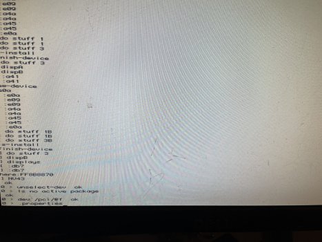

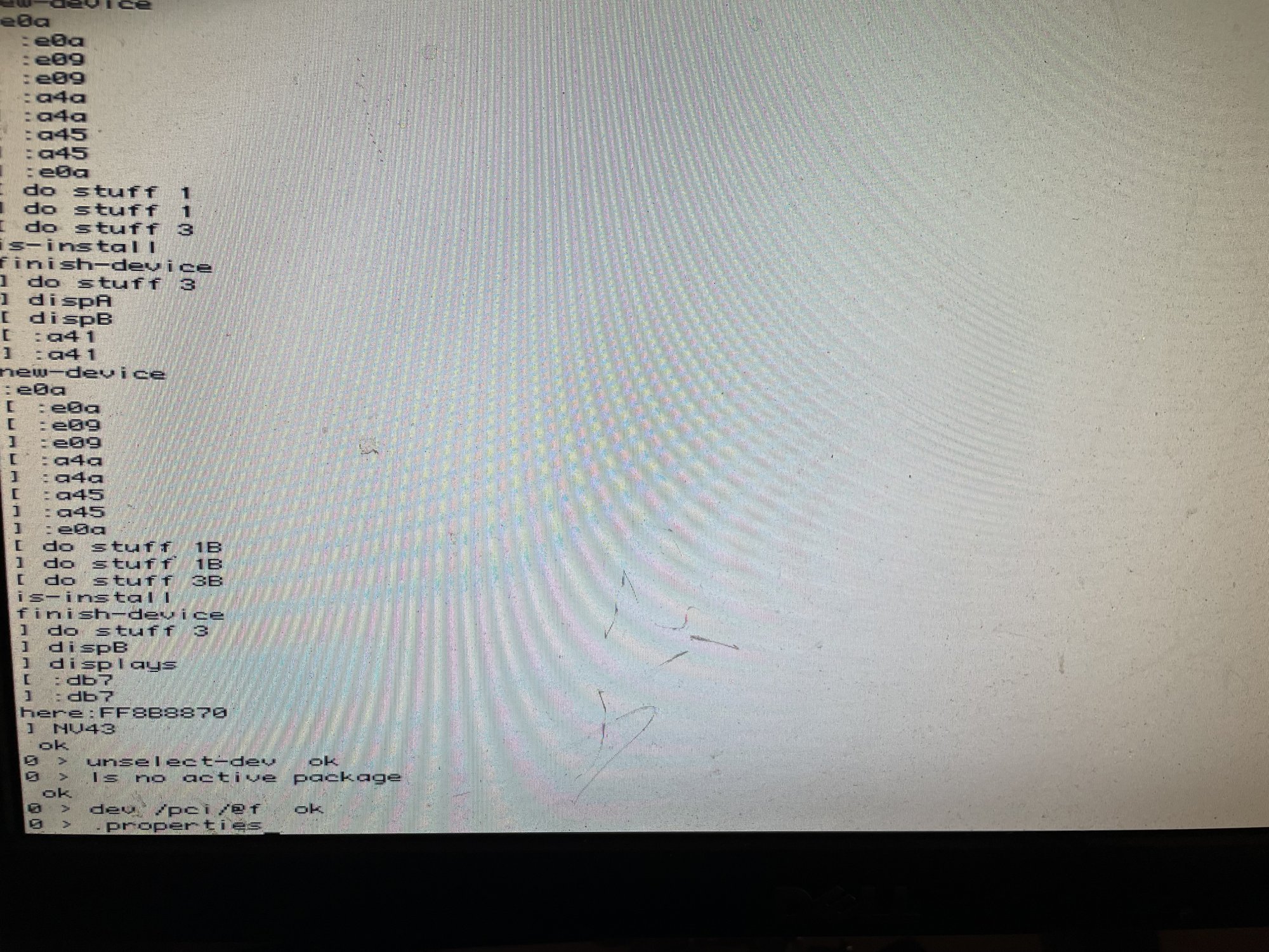

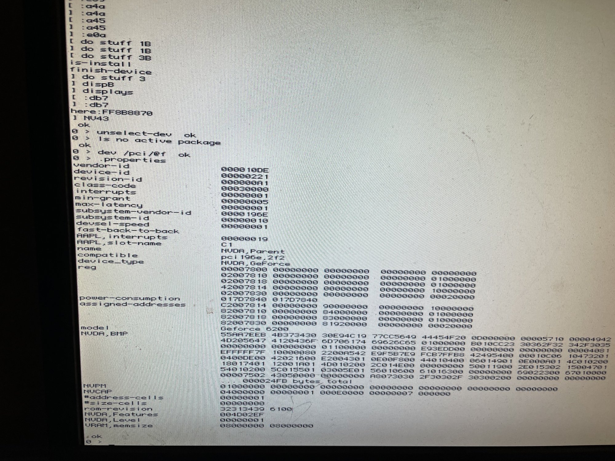

here:ff9bf3cb [ .mystack ff9bced0 24fb
ff9bced0 24fb
] .mystack ff9bced0 24fb
[ 0xc7d ff9bced0 24fb
] 0xc7d ff9bced0 24fb ff9937f5 8
[ mytraceoff Empty
:ddd
:ce7
:d87
:dde
:df1
:c5d
:e00
val946=2
no rnin
:df7
:dd1
:e0f
:e04
:e05
] :dostuff
done dostuff
:9c7
set reg
set #size-cells
: decode-unitset VRAM,memsize
val952=1
[ displays
[ dispA
[ :a41
] :a41
new-device
:e0a
[ :e0a
[ :e09
] :e09
[ :a4a
] :a4a
[ :a45
] :a45
] :e0a
[ do stuff 1
] do stuff 1
[ do stuff 3
is-install
finish-device
] do stuff 3
] dispA
[ dispB
[ :a41
] :a41
new-device
:e0a
[ :e0a
[ :e09
] :e09
[ :a4a
] :a4a
[ :a45
] :a45
] :e0a
[ do stuff 1B
] do stuff 1B
[ do stuff 3B
is-install
finish-device
] do stuff 3
] dispB
] displays
[ :db7
] :db7
here:ff9c0860
] NV43
 ok
0 > .properties words
vendor-id               000010de
device-id               00000221
revision-id             000000a1
class-code              00030000
interrupts              00000001
min-grant               00000005
max-latency             00000001
devsel-speed            00000001
fast-back-to-back
name                    NVDA,Parent
compatible              pci10de,221
                        pciclass,030000
reg                     00011800 00000000 00000000  00000000 00000000
                        02011810 00000000 00000000  00000000 01000000
                        02011818 00000000 00000000  00000000 01000000
                        42011814 00000000 00000000  00000000 10000000
                        02011830 00000000 00000000  00000000 00020000
assigned-addresses      c2011814 00000000 90000000  00000000 10000000
                        82011810 00000000 82000000  00000000 01000000
                        82011818 00000000 81000000  00000000 01000000
                        82011830 00000000 800a0000  00000000 00020000
R2AD                    5c3e8200 90ff002b 00000000 00000000 2e7c0690 07300030 0020041a 04380003
                        0006041a 06900001 00000000 00000000 00000000 00000000 00000000 00000000
subsystem-id            00000010
model                   Geforce 6200
NVDA,BMP                55aa7eeb 4b373430 30e94c19 77cc5649 44454f20 0d000000 00005710 00004942
                        4d205647 4120436f 6d706174 69626c65 01000000 b010cc23 30362f32 342f3035
                        00000000 00000000 01100000 00000000 e93edd00 00000000 00000000 00004081
                        efffff7f 10000080 2200a542 e9f5b7e9 fcb7ffb8 42495400 00010c06 10473201
                        0400de00 42021600 e2004301 0e00f800 44010400 06014901 0e000a01 4c010200
                        18017401 12001a01 4d010200 2c014e00 00000000 50011900 2e015302 15004701
                        54010200 5c015501 03005e01 56010600 61016300 00000000 69022300 67010000
                        00007502 43050000 00000000 a8073030 2f30302f 30300200 00000000 00000000
                        ... 000024fb bytes total
device_type             NVDA,GeForce
NVPM                    01000000 00000000 00000000 00000000 00000000 00000000 00000000
NVCAP                   04000000 00000001 000e0000 00000007 000000
#address-cells          00000001
#size-cells             00000000
rom-revision            32313439 6100
NVDA,Features           004d02ef
NVDA,Level              00000001
VRAM,memsize            10000000 10000000
decode-unit     close           open            .ss             mytraceoff      mytraceon
.mystack        myabort         valoutswap      valout          laddrout3       waddrout3
laddrout1       waddrout1       laddrout0       baddrout0       addrout3        addrout1
addrout0        goterror        dotrace         dopatch         logreg          patch?
patchable-words unpatch-words   patch-words     list-words      defer-patch?    dump-return-stack
addr>xt         closest-word    closest-offset  closest-xt      instruction-addr
words-iterator  loop-words-global               loop-words-siblings             loop-words-local
loop-words      all-words       dump-word-cr    unpatch-word    patch-word      patch-word-behavior
unpatch-colon   patch-colon     patch-colon-behavior            convert-exits   unpatch-field
patch-field     patch-field-behavior            unpatch-exit    patch-exit      patch-exit-behavior
unpatch-defer   patch-defer     patch-defer-behavior            unpatch-entry   patch-entry
patch-entry-behavior            dump-word       do-nodent       do-outdent      do-indent
trace-off       trace-on        words-processed words-unpatched words-patched   words-found
pause-level     recurse-level   indent-level    notdenting?     trace?          myname.
hlink>xt        xt>hlink        find-token-in-word              'exit           br>xt
bl>xt           adr>xt          is-br?          is-bl?          .stack          log-patches
name.           <pushd,>        <pushr,>        <lr->r,>        <mflr,>         <blr,>
xt>hdr          <b,>            disp24          binst           blinst          d24mask
finstance       falias          fnohdr          fimm            fdefd           >h.name
>h.count        >h.token        >h.ctype        >h.flags        >h.link         >dn.probe-addr
>dn.assd-addrs  >dn.#scells     >dn.#acells     >dn.instance-bfr-ptr            >dn.instance-offset
>dn.methods     >dn.properties-tl               >dn.properties-hd               >dn.peer-bak
>dn.peer-nxt    >dn.child       >dn.parent      >dn.check       check-stacks    ep
fp              lp              rp              sp              'e              'f
'l              'r              's              blr             mflr            lr->r
pushr           pushd           trace-end       trace-begin     close           open
 ok
0 > dev @1 decode-unit ok
name                    NVDA,Display-B
device_type             display
reg                     00000001
compatible              NVDA,NVMac
                        NVDA,MultiDisplay
connector-type          00000004
character-set           ISO8859-1
width                   00000280
height                  000001e0
depth                   00000008
linebytes               00000280
refresh                 0000003c
EDID                    00ffffff ffffff00 06101b92 ab6a0002 12110103 802b1b78 2ec601a3 574a9d25
                        12505400 0000b300 01010101 01010101 01010101 01017c2e 90a0601a 1e403020
                        3600b10e 1100001a 000000ff 00324137 31383241 53584d4d 0a200000 00fc0043
                        696e656d 610a2020 20202020 00000000 00000000 00000000 00000000 0000012b
                        40010200 0000007e 2401a500 ffff031a 1aa80100 00000000 40000000 00000000
                        00000000 00000000 00000000 00000000 00000000 00000000 00000000 00000000
                        00000000 00000000 00000000 00000000 00000000 00000000 00000000 00000057
display-type            4c434400
display-cfg             013e0003
can-hot-plug
close           restore         draw-logo       write           open            power-switch-disable
power-switch-enable             ddc2-send-byte  ddc2-set-stop   ddc2-set-start  dimensions
get-colors      set-colors      color@          color!          read-rectangle  fill-rectangle
draw-rectangle  set-mode        show-modes      get-mode
 ok
0 >

Here is, what the G3 shows:
Code:
0 > 600040 1 byte-load [ NV43
here:ff85886c
vendor-id               000010de
device-id               00000221
class-code              00030000
interrupts              00000001
min-grant               00000005
fast-back-to-back
AAPL,interrupts         00000019
AAPL,slot-name          C1
name                    pci10de,221
device_type             display
reg                     00007800 00000000 00000000  00000000 00000000
                        02007810 00000000 00000000  00000000 01000000
                        42007814 00000000 00000000  00000000 10000000
                        02007818 00000000 00000000  00000000 01000000
                        02007830 00000000 00000000  00000000 00020000
power-consumption       00e4e1c0 00e4e1c0
assigned-addresses      c2007814 00000000 90000000  00000000 10000000
                        82007810 00000000 82000000  00000000 01000000
                        82007818 00000000 81000000  00000000 01000000
                        82007830 00000000 80820000  00000000 00020000
close           open
encoding trace
evaluating trace
stacks: ff800000 ff800400 ff8007bc ff800c00 ff801000 ff8017a0
:e0c
:dd6
get subsystem-id
set subsystem-id
get subsystem-id
val93f=4d
:db6
done defining stuff
patching words...
found:1698 processed:1578 patched:1578
ff810568 ff810578 0x8a ff81ba38 defer expect (UNKNOWN FORMAT! not br)
ff810678 ff810688 0x8d ff814330 defer key? (UNKNOWN FORMAT! not br)
ff810658 ff810668 0x8e ff814360 defer key (UNKNOWN FORMAT! not br)
ff812cd8 ff812ce8 0x92 : cr (UNKNOWN FORMAT! not br)
ff810638 ff810648 0x90 ff814640 defer type (UNKNOWN FORMAT! not br)
ff817378 ff817388 0x6cf ff8173b0 defer status (UNKNOWN FORMAT! not br)
ff812d18 ff812d28 0xfe0 : space (UNKNOWN FORMAT! not br)
done patch-words
ff862930 ff862948 0xf04 : addrout0
ff862a50 ff862a68 0xf07 : baddrout0
ff862a90 ff862aa8 0xf08 : laddrout0
ff862bd0 ff862be0 0xf0d : valout
ff862c10 ff862c28 0xf0e : valoutswap
ff862d48 ff862d58 0xf13 : .ss
ff813578 ff813588 0x9b : u. (UNKNOWN FORMAT! not br)
ff810588 ff810598 0x9d ff813560 defer . (UNKNOWN FORMAT! not br)
ff812ba8 ff812bb8 0x126 : ms (UNKNOWN FORMAT! not br)
ff80d0c8 ff80d0e0 0x8b ff810488 defer alloc-mem (UNKNOWN FORMAT! not br)
ff813c18 ff813c28 0xcb : $find (UNKNOWN FORMAT! not br)
ff81ec88 ff81eca0 0x11a : device-type (UNKNOWN FORMAT! not br)
ff81e718 ff81e730 0x110 : property (UNKNOWN FORMAT! not br)
ff81f0f0 ff81f108 0x21a : get-my-property (UNKNOWN FORMAT! not br)
[ :dostuff
:ddb
:e10
e10 here:ff899784 ff8973b8 23cc ff8973b8
:e0e] mytraceon ff8973b8 23cc
[ 0xe0e ff8973b8 23cc
  [] 0x943 ff8973b8 23cc 42
22115 : ff8973b8 23cc ff899784 12f
22116 : ff8973b8 23cc ff899784 12f ff899784
22117 : ff8973b8 23cc ff899784 12f
22118 : ff8973b8 23cc ff899784 12f ff899784
22119 : ff8973b8 23cc ff899784 12f 30
22120 : ff8973b8 23cc ff899784 12f 30 30
22121 : ff8973b8 23cc ff899784 12f ffffffff
22122 : ff8973b8 23cc ff899784 12f
22123 : ff8973b8 23cc ff899784 12f ff899784
  [] 0x8a2 ff8973b8 23cc ff899784 12f ff89978a
22124 : ff8973b8 23cc ff899784 12f ff89978a
  [ 0xa24 ff8973b8 23cc ff899784 12f ff89978a
  ] 0xa24 ff8973b8 23cc ff899784 12f 4edcbdcb
22125 : ff8973b8 23cc ff899784 12f 4edcbdcb
22126 : ff8973b8 23cc ff899784 12f 4edcbdcb 4edcbdcb
22127 : ff8973b8 23cc ff899784 12f 0
22130 : ff8973b8 23cc ff899784 12f
22133 : ff8973b8 23cc ff899784 12f
  [] 0xa5d ff8973b8 23cc ff899784 12f ff899784
22134 : ff8973b8 23cc ff899784 12f ff899784
  [ 0xa5f ff8973b8 23cc ff899784 12f ff899784
  ] 0xa5f ff8973b8 23cc ff899784 12f 30
22135 : ff8973b8 23cc ff899784 12f 30
22136 : ff8973b8 23cc ff899784 12f 30 30
22137 : ff8973b8 23cc ff899784 12f 30 30 20
22138 : ff8973b8 23cc ff899784 12f 30 30 20 22
22139 : ff8973b8 23cc ff899784 12f 30 0
22140 : ff8973b8 23cc ff899784 12f 30 0 30
22141 : ff8973b8 23cc ff899784 12f 30 0 30 30
22142 : ff8973b8 23cc ff899784 12f 30 0 ffffffff

here:ff8998b3 [ .mystack ff8973b8 24fb
ff8973b8 24fb
] .mystack ff8973b8 24fb
[ 0xc7d ff8973b8 24fb
] 0xc7d ff8973b8 24fb ff86dcd5 8
[ mytraceoff Empty
:ddd
:ce7
:d87
:dde
:df1
:c5d
:e00
val946=2
no rnin
:df7
:dd1
:e0f
:e04
:e05
] :dostuff
done dostuff
:9c7
set reg
set #size-cells
val952=0
[ displays
[ dispA
[ :a41
] :a41
new-device
:e0a
[ :e0a
[ :e09
] :e09
[ :a4a
] :a4a
[ :a45
] :a45
] :e0a
[ do stuff 1
] do stuff 1
[ do stuff 3
is-install
finish-device
] do stuff 3
] dispA
[ dispB
[ :a41
] :a41
new-device
:e0a
[ :e0a
[ :e09
] :e09
[ :a4a
] :a4a
[ :a45
] :a45
] :e0a
[ do stuff 1B
] do stuff 1B
[ do stuff 3B
is-install
finish-device

[ :db7
] :db7
here:ff89aaa8
] NV43
 ok
vendor-id               000010de
device-id               00000221
class-code              00030000
interrupts              00000001
min-grant               00000005
fast-back-to-back
AAPL,slot-name          C1
name                    NVDA,Parent
model                   Geforce 6200
NVDA,Level              00000001

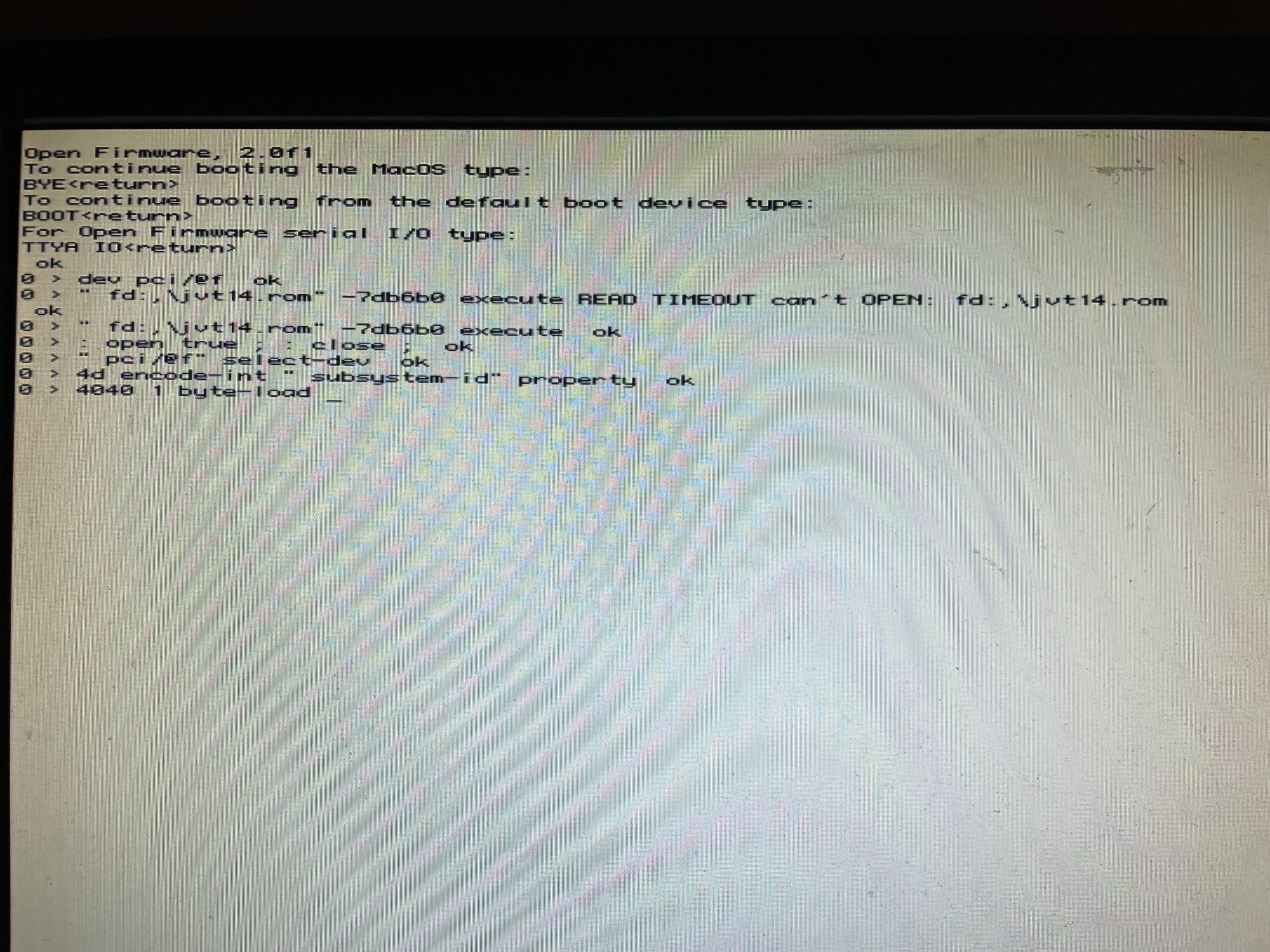

#15 contains no debug stuff. Just the four changes which you can see by doing
bbdiff --ignore-spaces Test2/2Forth/PNY_6200_PCI.4th Reverse/2Forth/PNY_6200_PCI.4th
It is 64K and suitable for flashing.
  • Default the subsystem-id property to 004d if it's missing, otherwise the 6200 fcode would abort. (New World Macs define subsystem-id but sometimes Old World Macs do not).
  • Work-around a bug in parsing of NVDA,BMP property. The fcode tries to read from address 0x23cd which causes an exception on Old World Macs. The exception causes execution of the fcode to end. This is also a bug for New World Macs because there's nothing at 0x23cd. Obviously the developers of the Nvidia code did not intend to read from 0x23cd (0x23cd is 1 plus 0x23cc which is the size of the NVDA,BMP property up to that point) but I don't know what they really intended to do. I don't know what the real fix is but New World Mac reads 0 from 0x23cd so always assuming 0 should work for Old World.
  • Define decode-unit in fcode context instead of evaluate context so it doesn't reuse an fcode number (on New World Macs, words defined in evaluate context are assigned fcode number 0xffff). I don't think this was a problem for the 6200 fcode rom for Old World, but it's weird. I don't think it's best practice to use evaluate to define a colon definition function on Old World Mac. For example, say fcode number 0x835 is defined in the fcode rom, and the same fcode number is assigned to decode-unit during evaluate. Then, if the fcode number is encountered in the fcode rom later, decode-unit may be executed instead of the word that was assigned 0x835 earlier.
  • Define colon definition functions for each display outside of conditional context. Old World Macs don't like that (I think OpenBIOS doesn't like it either). For example the following
    myflag if : myword ." hello" ; then
    would be changed to
    : myword myflag if ." hello" then ;
    In the 6200 rom, the colon definition functions are compiled into a display device like this
    displayexists if new-device " display-A" device-name : mydisplayfunction ." hello" ; finish-device then
    It's weird that : ... ; is used inside an if ... then and causes some Open Firmware implementations to fail (Old World Mac, OpenBIOS, )
    But you can move : ... ; outside the if ... then like this:
    new-device displayexists if " display-A" device-name then : mydisplayfunction ." hello" ; finish-device
    because finish-device actually removes the device if it was not assigned a device-name.
You can remove (install-console) stuff from nvramrc. I think XPostFacto will just overwrite nvramrc for you when you want to boot into Mac OS X.
Who wants to make this work for Open Firmware 1.0.5? I think we just need to fix them map-in stuff.

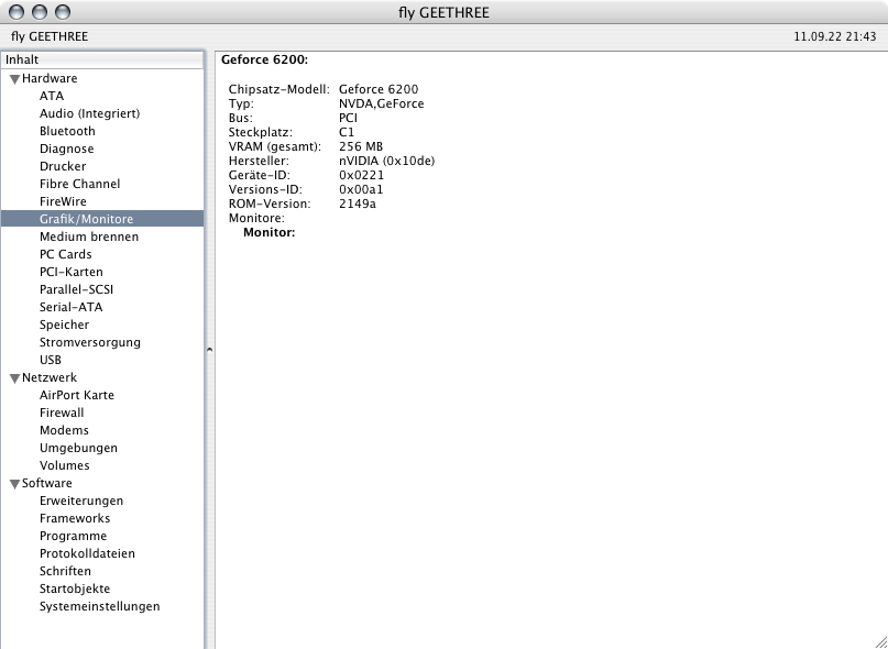

So i flashed the ROM to the card now. Sadly by now the result is the same as with the ROM loaded from CD: It doesn't fully boot to the OS but hangs with the logo and the spinning wheel. Strangely the Mac fully boots in the background, so i could access it with Screen Sharing, to look what is recognized. And this is how it shows up inSystem Info:
So the card itself is fully recognized, but not the display attached. The onboard video is hidden by nvramrc. While i was checking all this, the grey Apple-Logo-bootscreen kept showing with the wheel spinning.
Initially i did a pram-reset and booted in OS9. For that i did not get a signal of the card. So i attached the display to onboard (which was hidden later). OS9's System Profiler also showed the card with it's full info as for OS X. But switching the display cable to the card gave no success. Also XPF didn't show it in the output-menu.
In the Sawtooth the card with the ROM runs nice like before with all it's feautures. Hardware accelleration for CoreImage (ripple effect tested) and QuarzExtrem supported.
So seems to be very close, but not completely finished yet.

Yes, just rechecked: For the Radeon 9000pro it says "Display" also in the Beige. In Sawtooth it says "Display" for Type withe the 6200 PCI.
