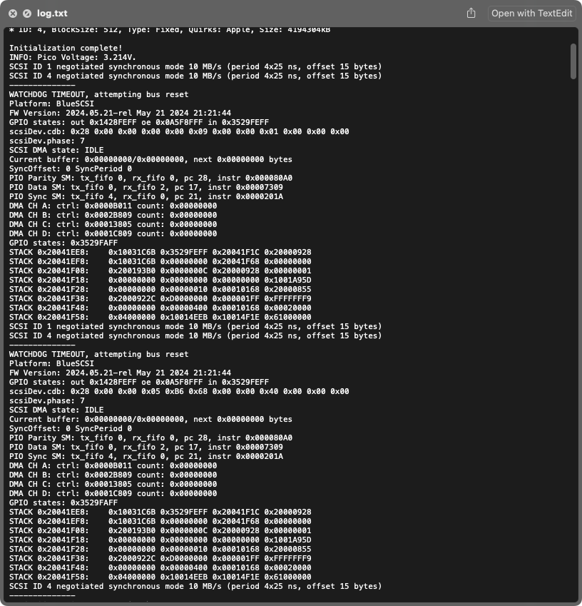

Scratch that idea for now, turns out that my SCSI emulator Device a BlueSCSI, seems to stop working in OpenFirmware when I install a G4 into my 9600, on either BlueSCSI firmware or ZuluSCSI firmware, no errors in the logfile either, still works fine under the classic Mac OS, but not under OpenFirmware
on the stock 604ev CPU I have been running the ZuluSCSI firmware since that has been better behaved with my 9600, again both firmwares work fine under Classic MacOS, but I found the BlueSCSI firmware would give me errors booting OS X Server 1.2v3 and in the log file it was clearly unhappy about things
so I switched to the ZuluSCSI firmware and that does seem to be much better behaved booting OS X, but again thats just on the stock 604ev, neither firmware work with a G4 under OpenFirmware sadly (so I cant even begin to boot OS X) the acess light comes on solid but then I just get a "can't LOAD from this device" after a while before it tried again etc
the fact that the device works with a 604ev but not the faster G4 7410 does smack of a timing issue to me, I wonder if this issue rearing its head again?

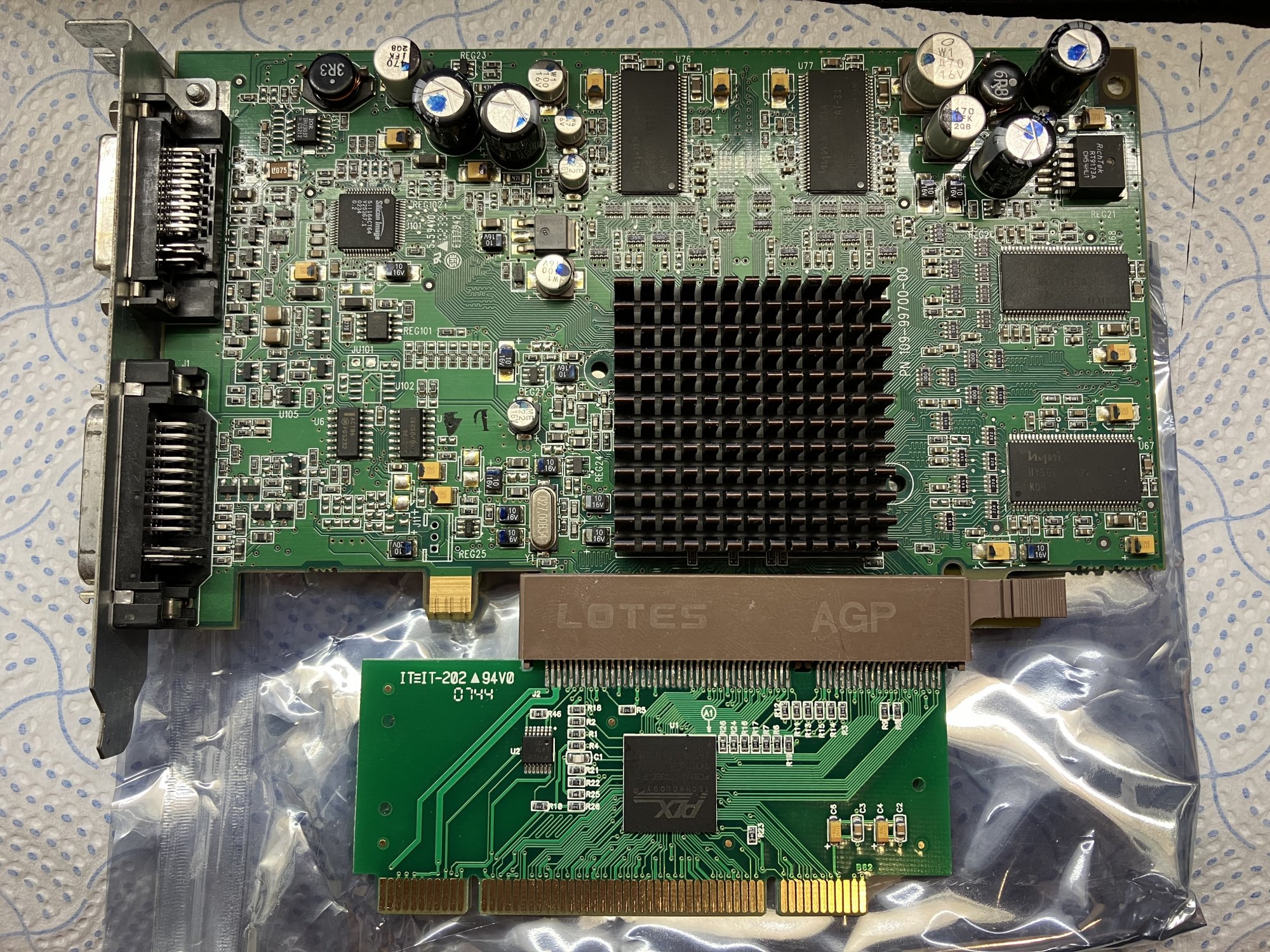

I did indeed :) its for 3.3V capable AGP cards only so no X850 XT im afraid, but it should still hopefully be good for a Radeon 9800 Pro, its funny I got the adapter from a good friend of mine who got it some years back from here https://www.cpu-world.com/forum/viewtopic.php?t=31173 and it was so stereotypical I was literally like "how long have you had that for?! I have been looking for one one of those for years and years now!" so he very kindly sold to me for just what he paid for it back then :)
I also have a passive PCI to AGP riser card I got from @Amethyst1 a few years ago with an EFIKA 5200 he very kindly sent me, but the problem I soon realised with that and beige macs, is that passive adapter is for 3.3V PCI slots *only* Im pretty sure even tho its universally keyed if I tried in a Beige Mac's 5V slot BadThings(TM) would happen, so thats why I was very excited to get this active adapter :) but I am still planning on trying out the passive adapter with my G3 Blue and white's 3.3V 66Mhz slot, I hope it works there at least because that would remove any overhead of having a PCI-PCI bridge in the middle
Nice one, you should try slapping in an AGP 6200-WANG, they are universally keyed and 3.3V afaik, the lid could even potentially close ;)
for that tho I have an actual PCI native, PNY GeForce 6200 :) most of this thread is about making PCI GeForce 6200's work in beige macs and finally giving them core image :)

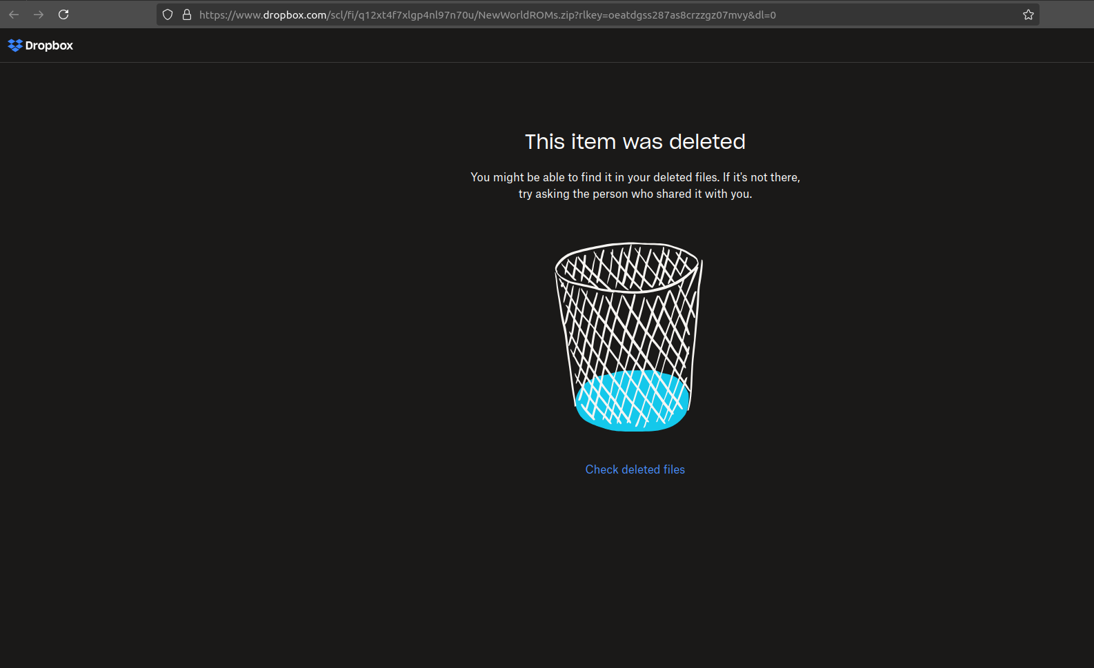

Hello everyone.
I been downloaded New World ROMs so long time ago.
and now, It got deleted for now.
Here I went to deleted file (NewWorldROMS.zip) from Dropbox:
Could you guys restore or backup from this file (NewWorldROMS.zip) for me? If not, That's okay.
Thanks.

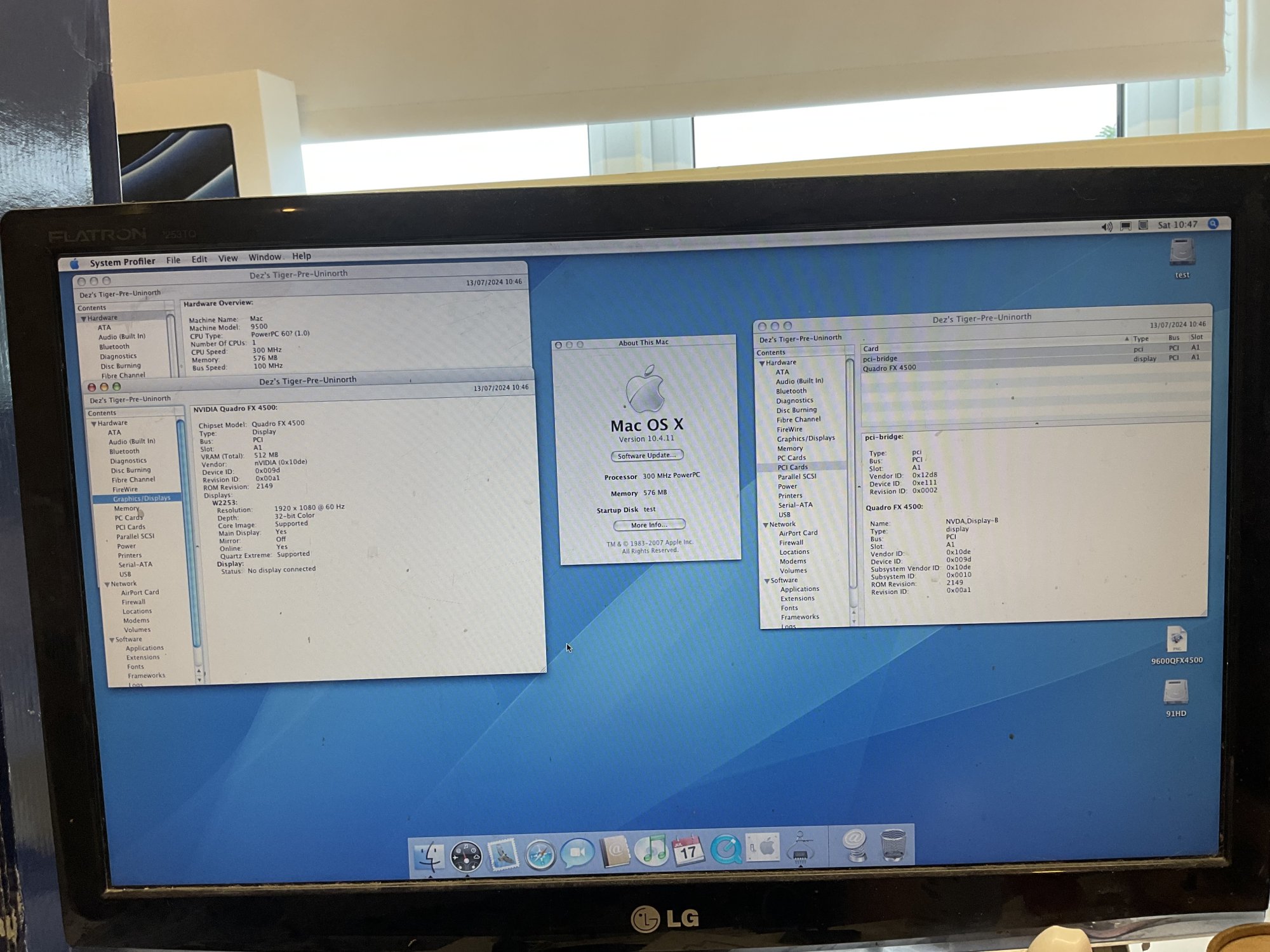

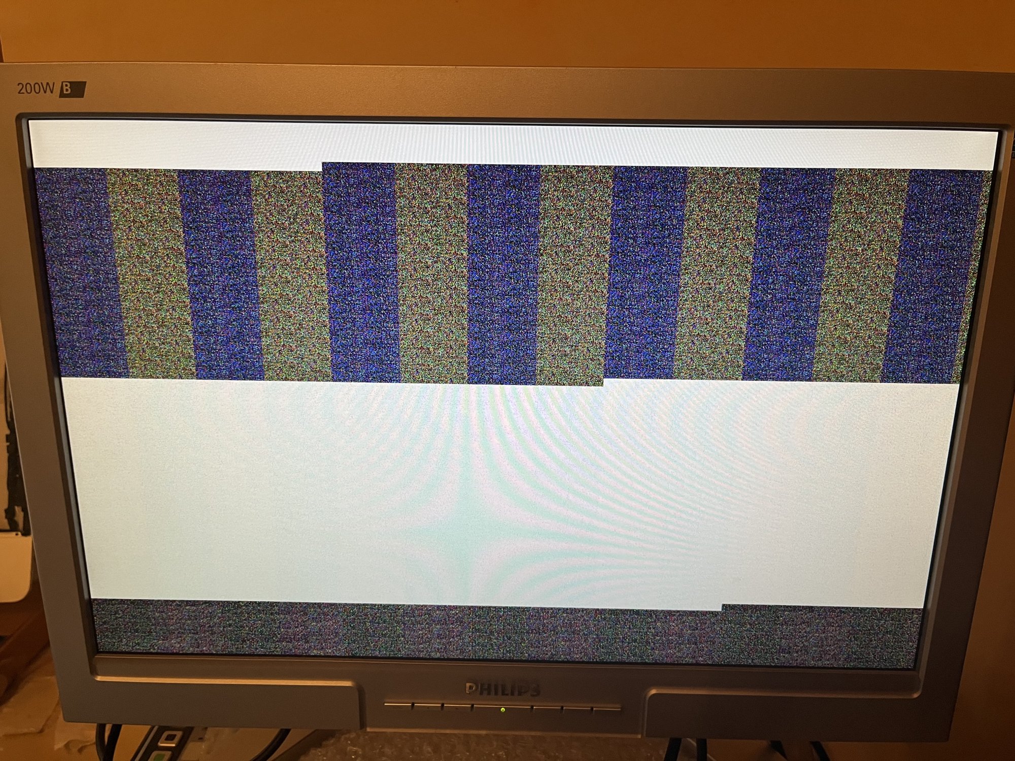

The 7800GT worked when connected to my B&W G4. I used a 64 bit 33MHz slot to connect the Netstor NA255A which had the 7800GT and some Thunderbolt add-in cards installed. I kept the 9200 in the 32 bit 66 MHz slot.
I booted into Mac OS X 10.4.11 and did some OpenMark benchmarks (see attached). A Quad G5 has score 9331 for 1920x1080 while the B&W G4 has a score of 7372 and the Radeon 9200 is 1179.
I tried the 7800GT in the 66 MHz slot of the B&W G4 (using the Netstor NA255A again). It didn't improve OpenMark benchmarks. I got 7189 at 1920x1080 and 7746 fro 2560x1440. I had 7746 last time with the 33 MHz slot for 2560x1440.
I think I'll give up on trying to get it to work in the Power Mac 8600. Unless someone else has success.

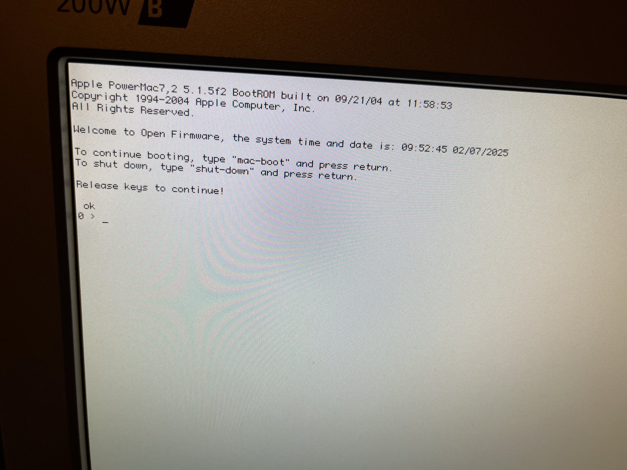

Good morning/ afternoon.
Confirmed, Open Firmware is the last version 5.1.5f2
Many thanks for your considerations.

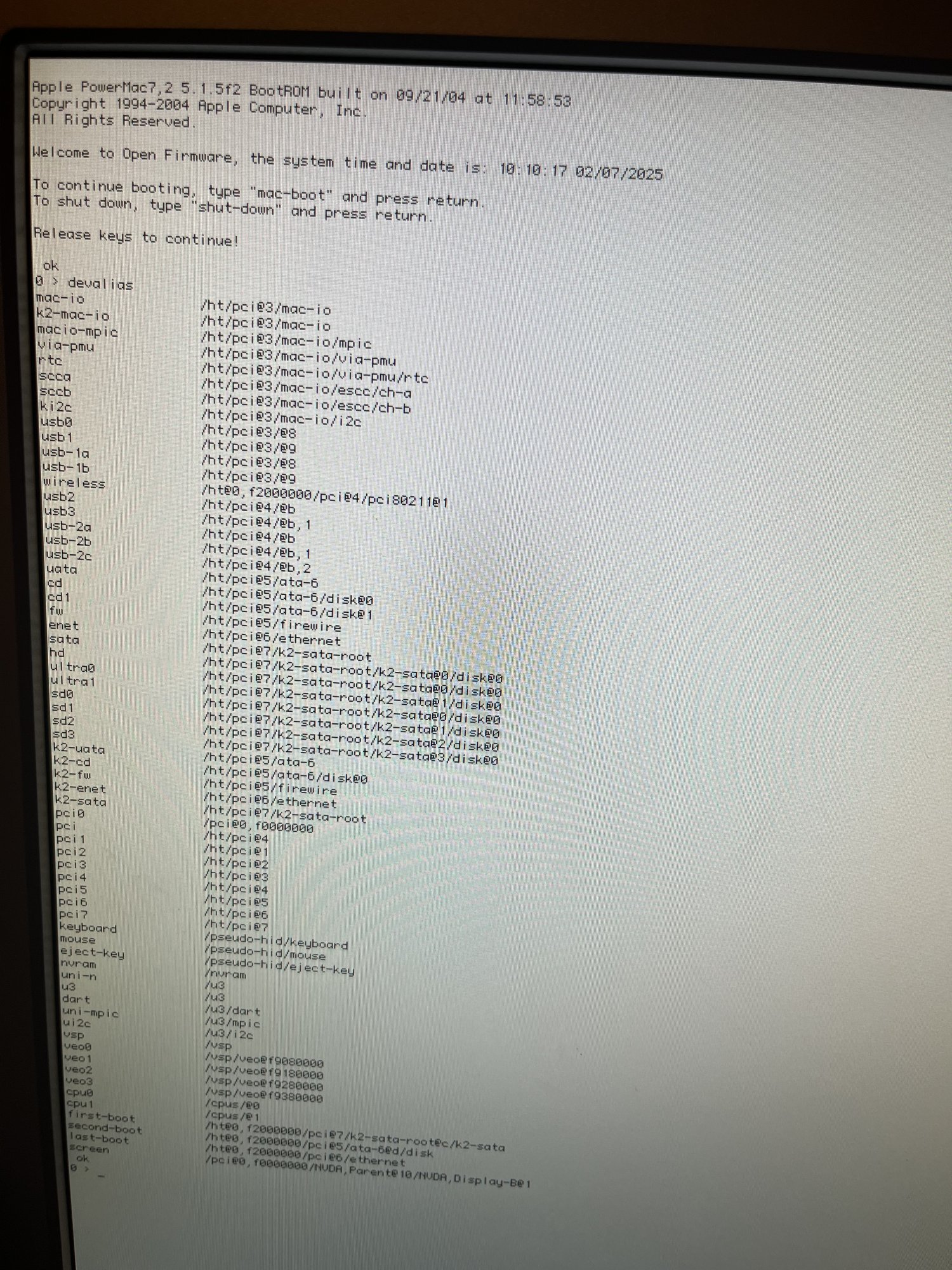

Looking at the 7800 GT's thread, we tried to replicate the Open Firmware steps to try to find if the 6200 PCI was listed at Open Firmware, no, there was nothing on devalias
---Steps
Boot into Open Firmware.
Type .line-help for a list of supported keys for the nvedit command.
Type nvedit to edit the nvramrc script.
Enter the following lines (include all the spaces):
Code:
.s cr
." [ probe-all" cr
probe-all
." ] probe-all" cr
.s cr
install-console
banner
Press Control-C to exit nvedit.
Type nvstore to save the edited nvramrc.
Type setenv use-nvramrc? true
Type system-restart to restart. Boot into Open Firmware, and describe what you see on the screen before the Open Firmware version information.
---End Steps
Only able to have display with the older FX 5200....
Tried different PCI slots, as far as I can see only the Nvidia FX 5200, used for display is listed.
When we plug the vga/dvi we only have kind of 'noise' static picture, and the computers seems to hang.
Many thanks for any pointing or considerations,
Kind regards.
Learn how to access Open Firmware using telnet.
Use dev / ls to list all the devices.
Use dump-device-tree to list all the devices and their properties.
In the first post of this thread is the nvramrc patch that is needed to work with cards that have 512MB BARs.
Reactions: chechugarriga
