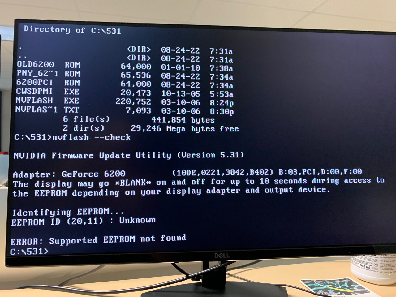

What version of NVFlash did you use?
Edit: Sorry for missguiding you. But from the datasheet the device i pointed too, doesn't seem to be an eeprom at all. Is there a similar looking (8-pin) part anywhere on the card? Maybe on the back.

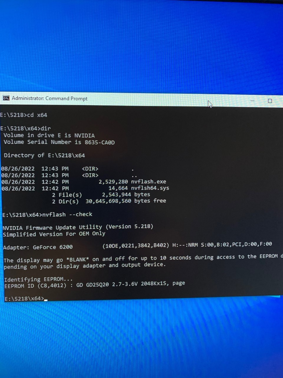

I used 5.31 (and I also tried 5.13, 5.15 and 5.40). All give same result. see below pic
Will check the card again for an eeprom. Might of missed something, was looking up each chip.
I assume its not some kind of deviant geforce using serial flash instead of an eeprom?
But how did you get the card flashed, if no supported eeprom was found?
Did you try different PCI-slots or reseating the card? This fixed this kind of error for me several times.

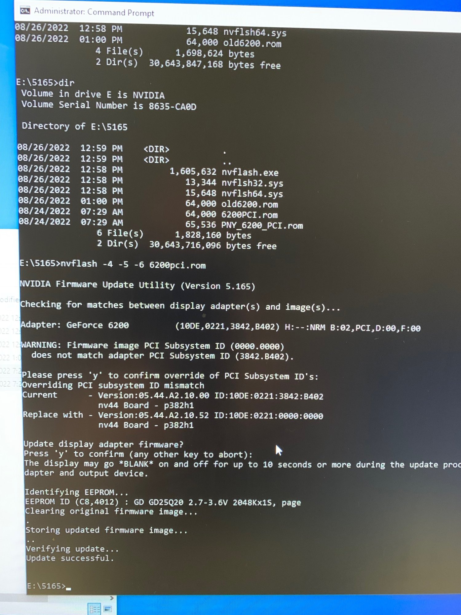

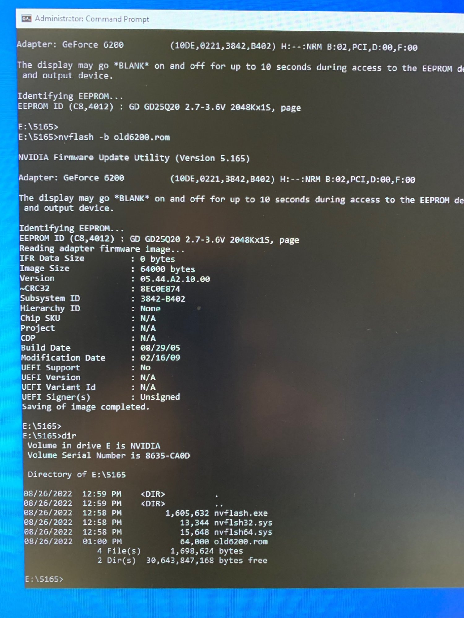

I haven't been able to flash the card at all yet. Only thing that appeared successful was doing a backup of the rom.
E.g. nvflash -b 6200backup.rom works without error.
I've flashed a 7800GS and a Quadro4 700 successfully with mac roms earlier. It only has 1 PCI slot and it does boot into Windows 7 using the 6200. Using freedos on a usb stick to boot and run nvflash. I'll try it in another PC and see.

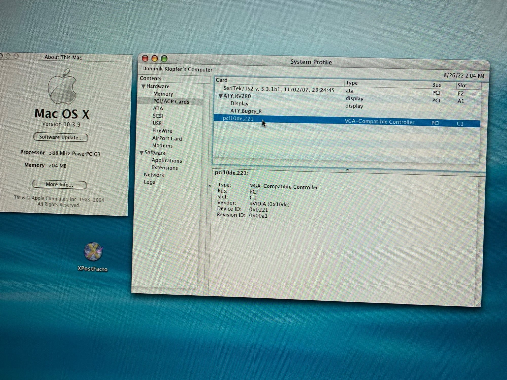

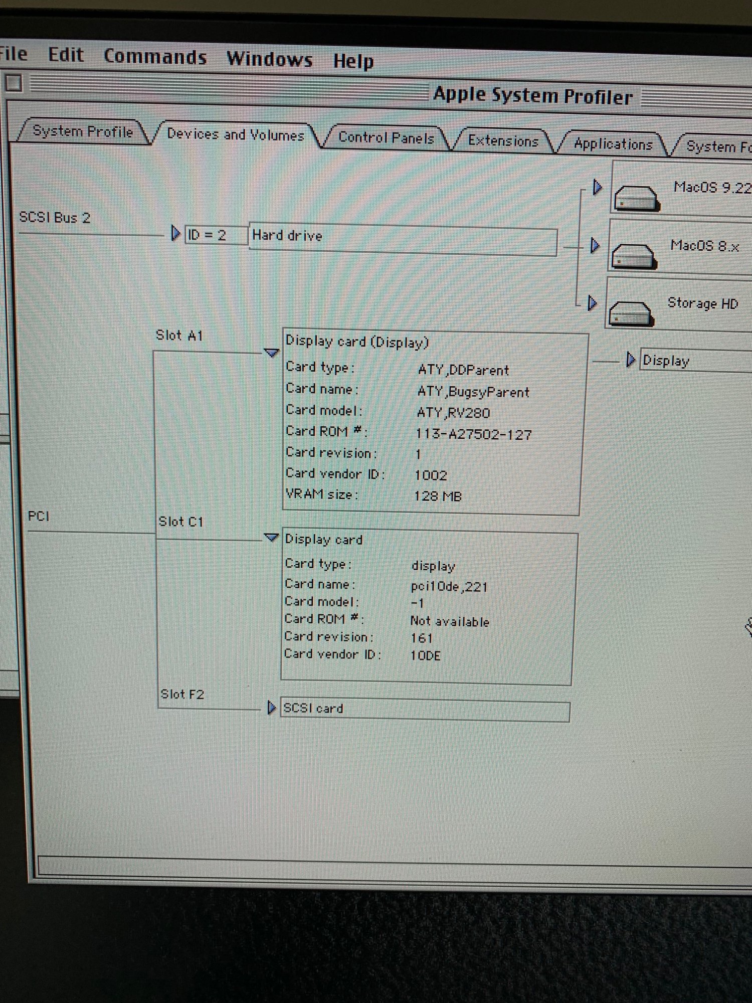

I don't know what "does not work" means.
Sorry for beeing this vague in this point. It only meant, that the card did not give any signal to the display and, booted to the OS, was not "seen" by System Profiler present as pci-card.
In fact, when installed, it startet to log read/write transactions to OF just like in the new World Mac.

the card did not give any signal to the display and was not "seen" by System Profiler present as pci-card.
I wonder if that EEPROM is the MX25L1005?
The RDID instruction is for reading the manufacturer ID of 1-byte and followed by Device ID of 2-byte. The MXIC Manufacturer ID is C2(hex), the memory type ID is 20(hex) as the first-byte device ID, and the individual device ID of second-byte ID is as followings: 11(hex) for MX25L1005.
Could be, I shall take a closer look in a bit if I can find it.
I was decoding the EVGA serial number, 1512620402009587, found a chart below.
From the decoding, product type 1, warranty 2, part# 402 all match known variables. Year shows as 2015?!
So I may possibly need to use a newer nvflash rather than one released in the 200x vintage. Hrmm.

Have looked at every chip on the board. Pretty sure its the GigaDevice 25Q21BT 2Mb (256K x 8) NOR Flash SOP8 150mil.. that I identified before. The main difference is that Flash can only be erased in blocks. EEPROM is byte erasable. As a result, Flash is available bigger (by up to 10x).
But I am assuming new versions of nvflash can deal with it? I'll experiment and see!
update:
bingo, nvflash 5.218 identifies it.
When I tried to do a backup of the rom, it bombed out and then got the "Unable to set up NVFLASH driver (0x00000005) Detailed :Access is denied
But trying 5.165 had some success.
Did a backup, now lets try flashing one of those mac roms.
So some success there. I can try it in my MDD on the weekend.
Of course I don't think I have been usefull for anything at this point other than distracting everyone.
So sorry about that!
(But at least I know I can flash this newer 6200 PCI card as well.)
I just used one of those roms you had, no idea if that would work.
Put it in my Powertower oldworld mac. I know it won't work in osx - but it does see the card at least in the slot, although doesn't identify it. I did think that I read somewhere that in OS 9 it works without any kind of accelleration with fixed or certain resolutions. Unless that was limited to new world ones? I'll go over making my own rom from themacelite guide so I can tinker with that to get to at least to a certain point.
