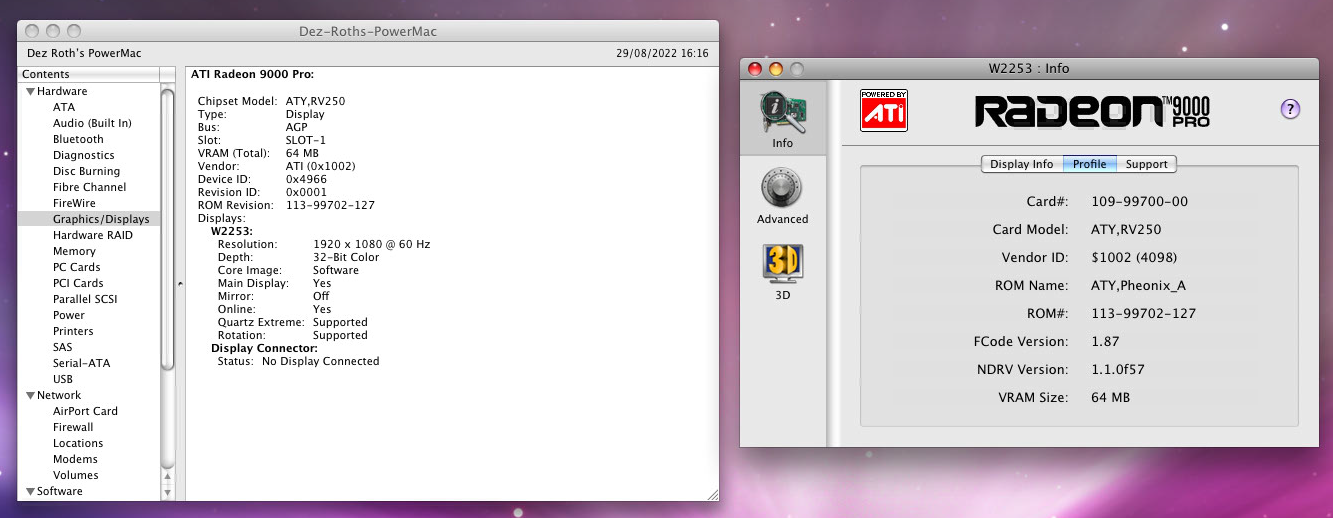

a bit off topic but an interesting thing I noticed about your ATI Radeon 9000 Pro
is its frame buffer Personality is not one I have seen before ATY,Radeon9000i
the one im used to for the Radeon 9000 Pro, is ATY,Pheonix which is what all the Radeon 9000 Pro's I have from my FW800 MDDs display
ill have to jab one back in and compare the ROM revision and board/card ID's
in the meantime I dont suppose you could post a screen shot from the "profile" tab in the ATI Displays control panel/app? :)
its interesting to note that my Radeon 9000 Pro is 99702 while yours is 99703
im pretty sure ATI did sell the Radeon 9000 Pro as a retail card so I wonder if they did actually use a different ROM for that card?
I have never seen a Retail 9000 Mac edition so I dont know if they where DVI ADC like an OEM card or DVI VGA like a PC card, if the later that would require a different ROM for the different port layout and a different port layout would mean a different frame buffer personality

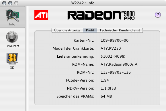

Even beeing a bit off-topic, sure i can! 😉

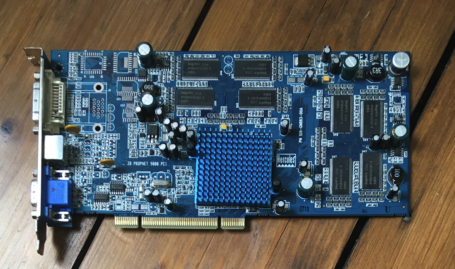

The card is some little exotic and today quite impossible to find breed from Hercules.
As you can see in the profile, it is flashed with the (unmodified) "reduced" 136 ROM of the 9000pro OEM.
Both ports work. But i don't know, if i ever tried them at once. Also would be interesting to see, how the card performs, compared to the 9200. At least on AGP in older OpenGL-versions the 9000pro is stronger than the 6200. So all that's done here might be a bit pointless anyway...
...if not to see true core image hardware accelleration on a Beige.
very interesting!
As you can see in the profile, it is flashed with the (unmodified) "reduced" ROM 136 ROM of the 9000pro OEM.
I dont think that ROM is actually an OEM ROM, I think its a Retail ROM, since all my OEM 9000 Pro's have been of the ATY,Pheonix personality
however I noticed that the card number is the same which would indicate the physical boards are the same
and indeed doing some googling brought up the User manual which shows this to be true, the Mac Edition is an DVI ADC identical to the apple OEM version
(one for @Amethyst1 note the special note talking about the IBM Big Bertha :) )
so its interesting how ATI still went out of their way to make separate retail and OEM ROMs for what was the same card hardware wise
but I guess they wanted to differentiate between the 2 for software reasons, so a retail update would not mess with an OEM card and vice versa, but its interesting how the retail version just predates named frame-buffer personalities
for reference heres the Radeon 9000 Pro from one of my FW800 MDD's
and a ROM dump, incase you want to try out the Pheonix ROM :)

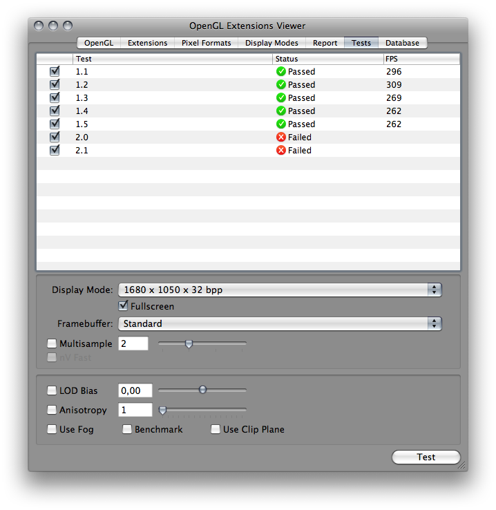

Also i did some benchmarks in the Sawtooth, where all the cards run fine. Used OpenGL Extensions Viewer 3.0. And here is the outcome:
6200 PCI (sure reflashed to the "normal use" ROM)
6200 AGP
Radeon 9000pro PCI
Radeon 9000pro AGP
...and, for reference to the high side, the 6800xt.
Sure, no shader 3 support for the Radeons and so no OpenGL 2.0 and 2.1. But for the rest they are significantly faster than the 6200s. So i begin to ask myself, if it is worth all the effort.
