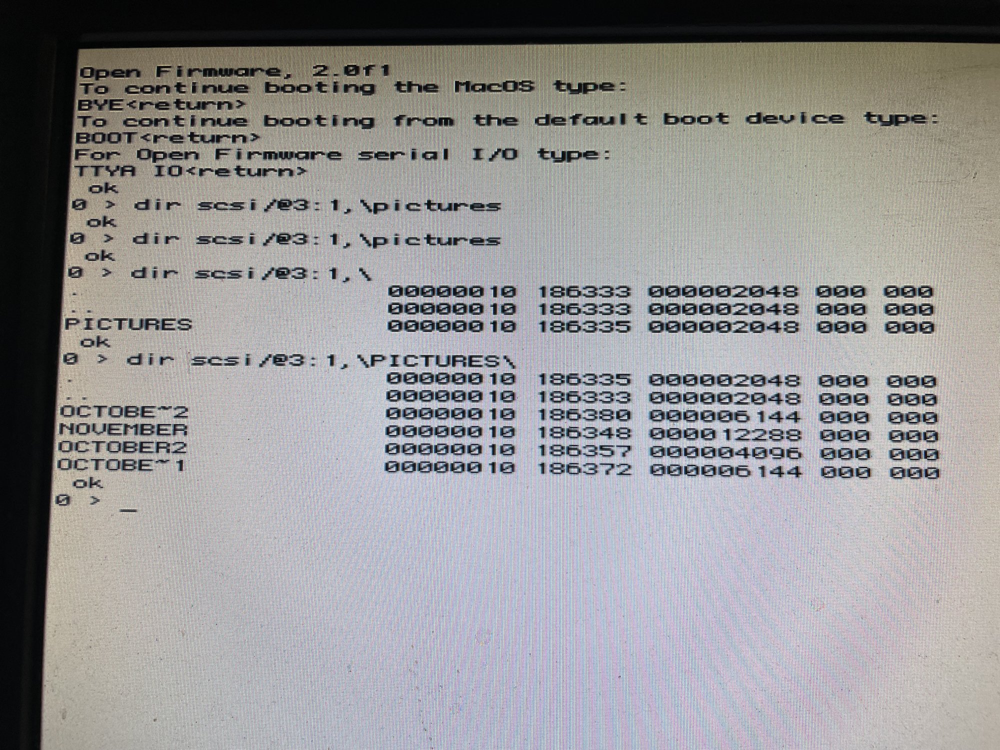

You have IDE CD or SCSI? I have both in mine, but it shipped with SCSI.
it's ide. But i have scsi available, if this works better.
Just need to check if it has the open word.
Code:
dev scsi-int/@3 \\ this assumes the SCSI ID of the CDROM is 3
words
dir scsi-int/@3:1,\
OR
dev scsi/@3
words
dir scsi/@3:1,\
OR OR
dir scsi/@3:,\
ISO9660 should have the files on the first partition @3:1 but OF will also check if it can find the file system if you leave our the partition number as above.
Also, I think IDE is ide1 if you have the CDROM as master on bus 1.
Diff:
dev ide1/@0
dir ide1/@0:1,\
dir ide1/@0:,\
SCSI works for me, I can get a DIR of an ISO9660 disk, ide1 does not.

I hope you have a few CD's, as I forgot to add that you will likely have to clip the PCI Header from the FCODE ROM, everything to 0x40, new ROM should start with F1.
Yes, it hs the open word. As well as load, write, read.

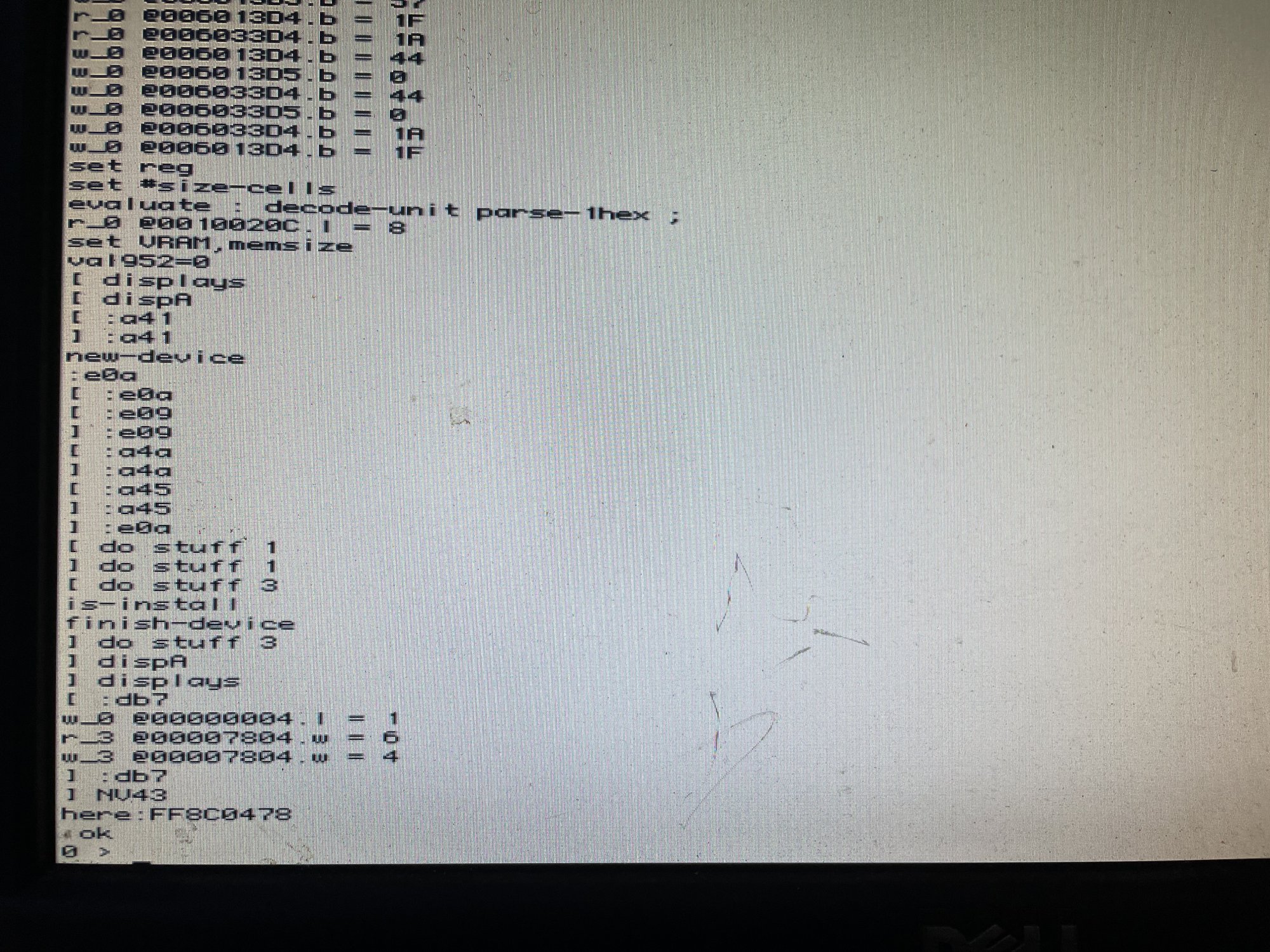

So here is, how far i got now:
Code:
0 > load ide0/@0:1,\TEST5.ROM
loader: evaluating FCode[ NV43
here:ff8588b0
ABORTvendor-id missing
 ok
0 > words
close           open
 ok
0 > " pci/@e" select-dev r_3 @00007010.l = 82000000
w_3 @00007010.l = ffffffff
r_3 @00007010.l = ff000000
w_3 @00007010.l = 82000000
r_3 @00007014.l = 90000008
w_3 @00007014.l = ffffffff
r_3 @00007014.l = f0000008
w_3 @00007014.l = 90000008
r_3 @00007018.l = 81000000
w_3 @00007018.l = ffffffff
r_3 @00007018.l = ff000000
w_3 @00007018.l = 81000000
r_3 @00007030.l = 80820000
w_3 @00007030.l = ffffffff
r_3 @00007030.l = fffe0001
w_3 @00007030.l = 80820000
r_3 @00007004.w = 4
w_3 @00007004.w = 6
w_0 @00000004.l = 1000000
 ok
0 > 4d encode-int " subsysem-id" property  ok
0 > load-base 1 byte load byte, unknown word
 ok
Code:
here:ff8588b0
 ok
0 > words
close           open
 ok
r_3 @00007004.w = 4
w_3 @00007004.w = 6
 ok
 ok

At least i got no errors anymore.
Is it normal that i just see the insertion mark blinking, but nothing happens on the screen?

Despite OF being very buggy in my Beige, and despite me not having a fully working ROM for my card, Joe's V5 debug rom did complete to the end after some great amount of time.
" pci/@d/@1" open-dev u.
That turned the display connected on, but things hung there in OF.

Currently I am working on finding where in the logging rom yours stops at by following the code on the emulation until it gets to the same spot.
or the lspci command needs to be modified to probe the addresses...

That's less far than you got before. It says vendor-id missing.
Yes, that's a trap. If i don't cut the PCI-header off up to the beginning of the fCode, it doesn't even start to load: "unrecognized client program format". And if i cut the header off (sure, where the vendor-ID is located) it aborts because "the vendor-ID is missing".
So if this "evaluation" cannot be bypassed, this is the next problem.
vendor-id is a property that Mac firmware inits before calling fcode. Check .properties like I asked, before you run the fcode. I don't think the fcode looks at the rom image.
