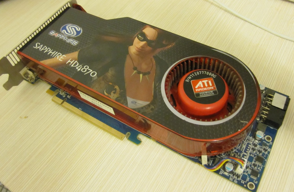

Hi all,
.......I'm having a Sapphaire 4870 512mb .....
I bought the same card. Made a ROM according to the instructions.
Hopefully it helps some of the other posters I've seen out there.
Mine works perfectly ^_^
Cheerio !
- BBX
  • 4870 EFI ROM.zip
