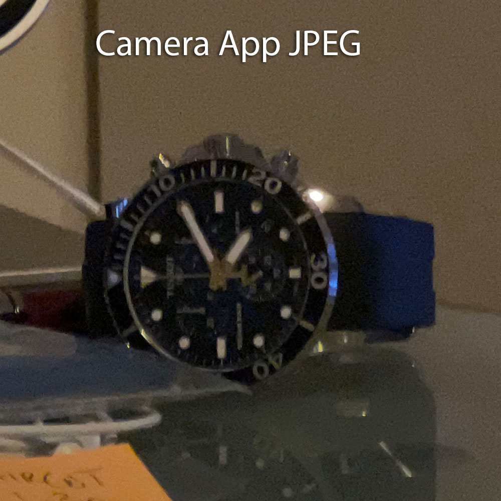

I suspect that you are correct. The problem seems to come back to this again and again. By forcing HDR on some shots, the camera module and processor inside the iPhone is layering images that capture various values withing the scene, sometimes resulting in poor calculations when combining media with detail with shots taken for illumination and lighting. There DOES seem to be an additional issue of the camera AF refusing to work properly...
Something else I noticed with using the ProCam App is that I could feel the OIS mechanism vibrating inside the camera when I shifted it with my hand. It's not something I could feel when using the native Camera App. I'm curious to figure out why that is happening as well.

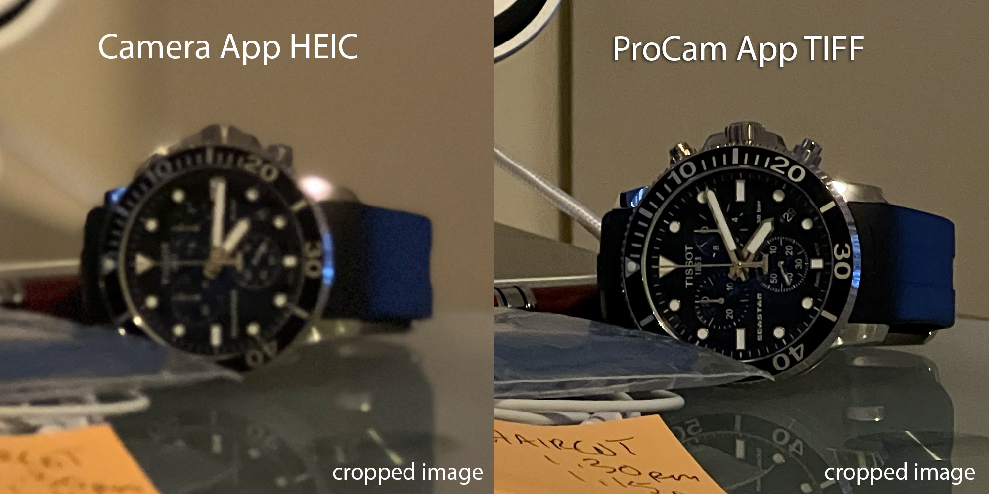

Last night I conducted a comparison from my desk. It wasn't particularly scientific but I think it applied well to the real world. Every single picture I took was from a seated position with both hands holding the phone very carefully. The AF reticule was allowed to rest and lock exposure and focus before I took each picture. The target zone was the face of this wristwatch. I was surprised to see that every single picture from the Camera App using the 3x Lens was smeared. Some were worse (far worse) than others. The same applied when JPEG was selected instead of Apple's preferred HEIC files. Here's an example of one of the cropped JPEG images...
Switching to the ProCam App instead, I took three pictures using the TIFF (TIF) format with the SMRT feature turned off and on. All of these shots were somewhat ideal. Certainly what I would expect from the iPhone 13's cameras. Especially the 3x (77mm) f/2.8 camera.
As far as I am concerned, the problem lies with Apple's algorithms and computational software. If I can get virtually perfect shots with the ProCam App, or at least shots that match the best images from the Apple Camera App, then I'm happy to keep using this smartphone... but Apple needs to SORT THIS OUT A.S.A.P. You can see the full scene below - but the method used to try to nail the AF on each shot was perhaps even more stable and careful that the methods used by the average shooter. I'm both disappointed that I can't trust the Apple software/app and happy that I can at least be assured of reasonably good results from the ProCam app that I bought years ago. But as for *Apple, I find this completely unacceptable. * (Apple is welcome to reach out to me on this.)

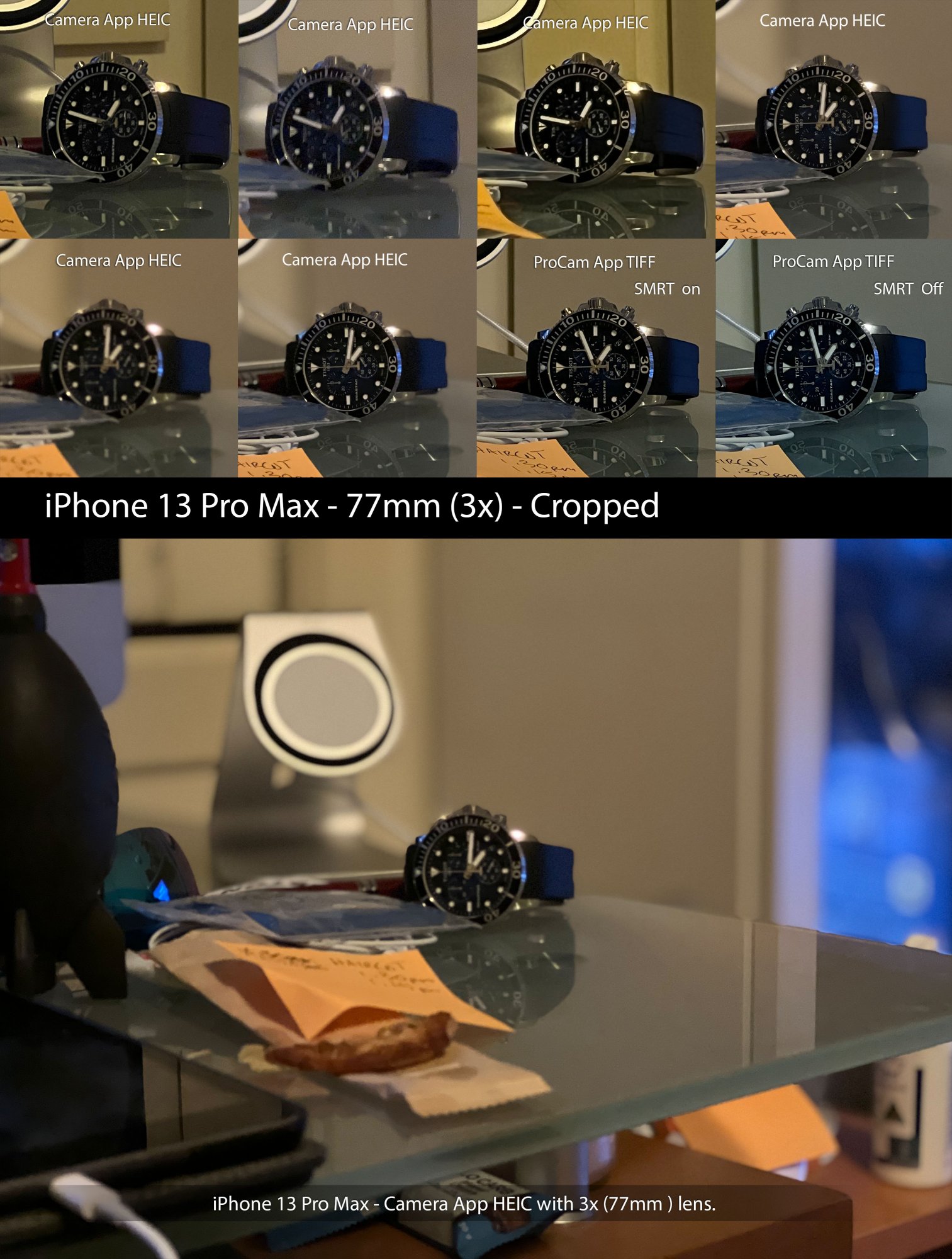

Nice Tissot!

Nice Tissot!

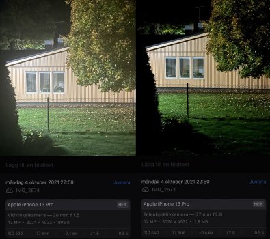

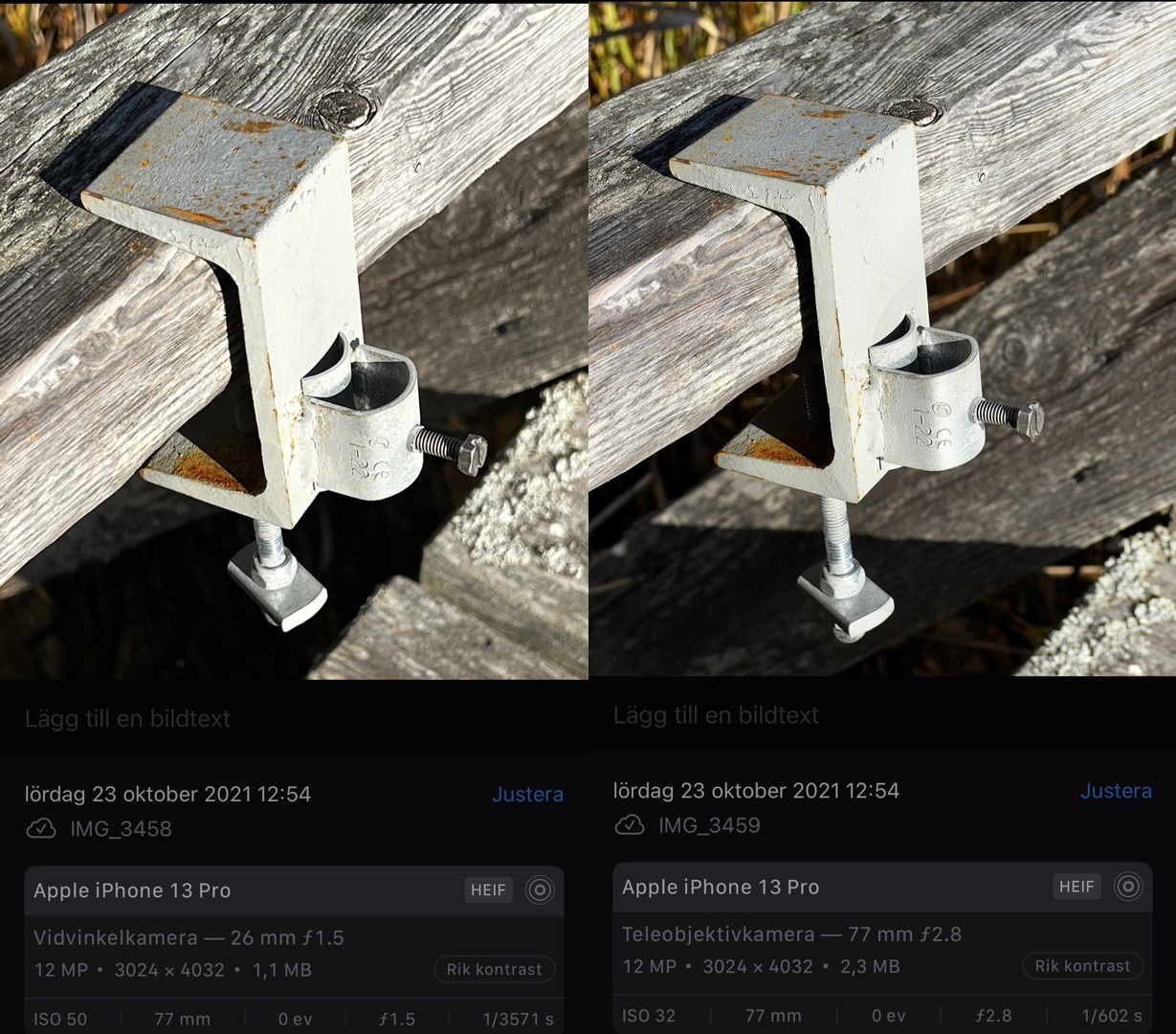

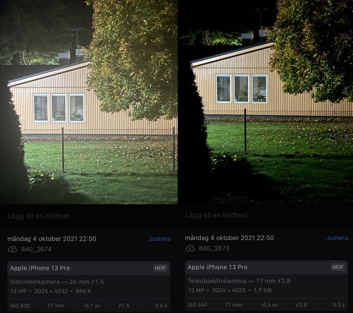

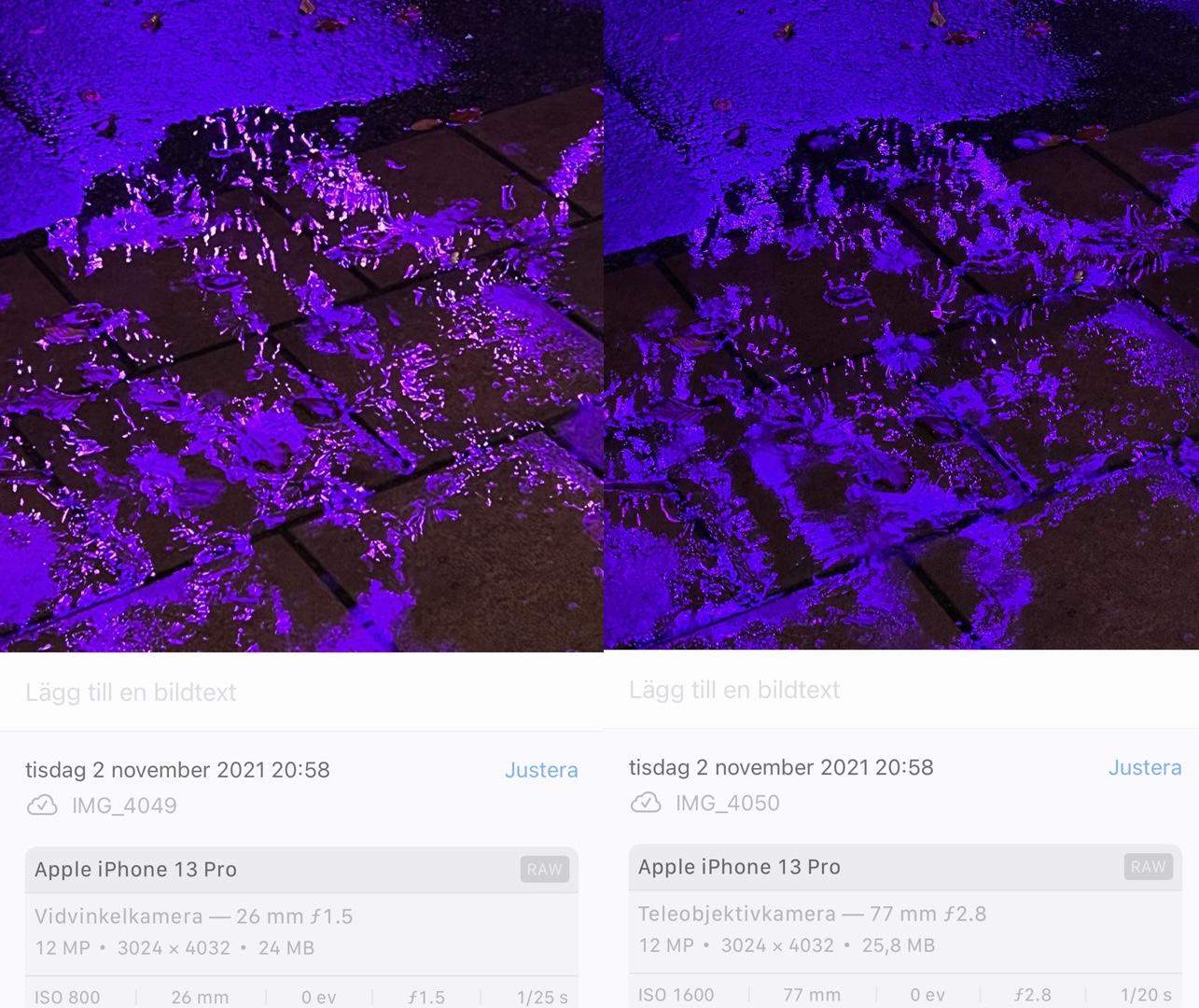

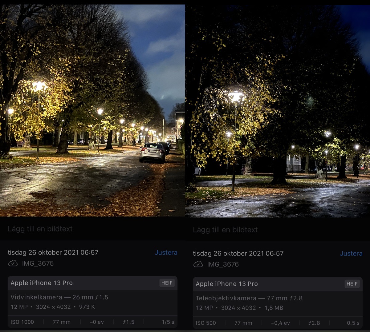

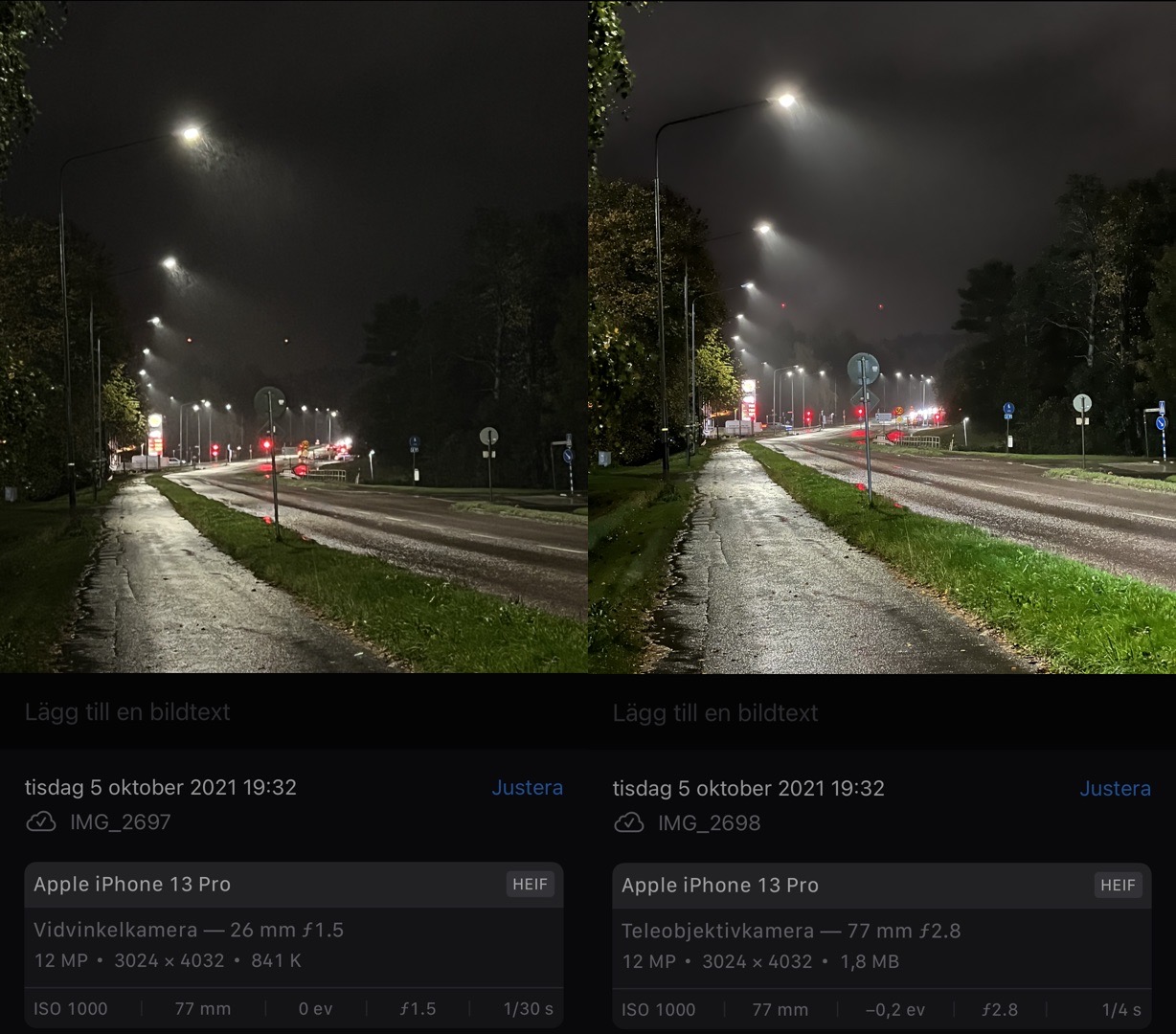

I posted example of the issue in another thread here where i zoomed in fully and still the main lens was used.
More examples below of the issue, with metadata. These are screenshots from the gallery.
To get the correct lens in use, I had to press a bright area.
Last example is weird, because the distance to subject is same as 77mm but it says 26mm, and ultra wide is producing a smeared effect even in raw.

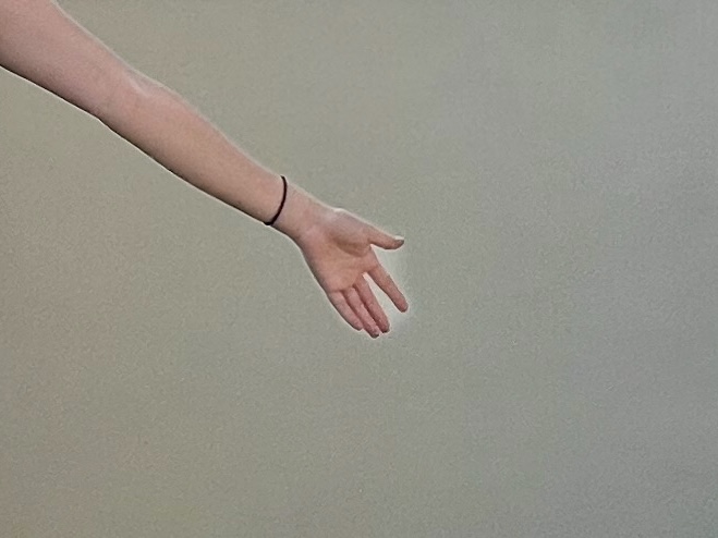

I noticed the same thing in my first sets of photos. I got a weird shading effect when I took a shot with the ultra wide camera.
In the attachment, you’ll see the weird shading thing around the subject’s hand. [I cropped the photo.]

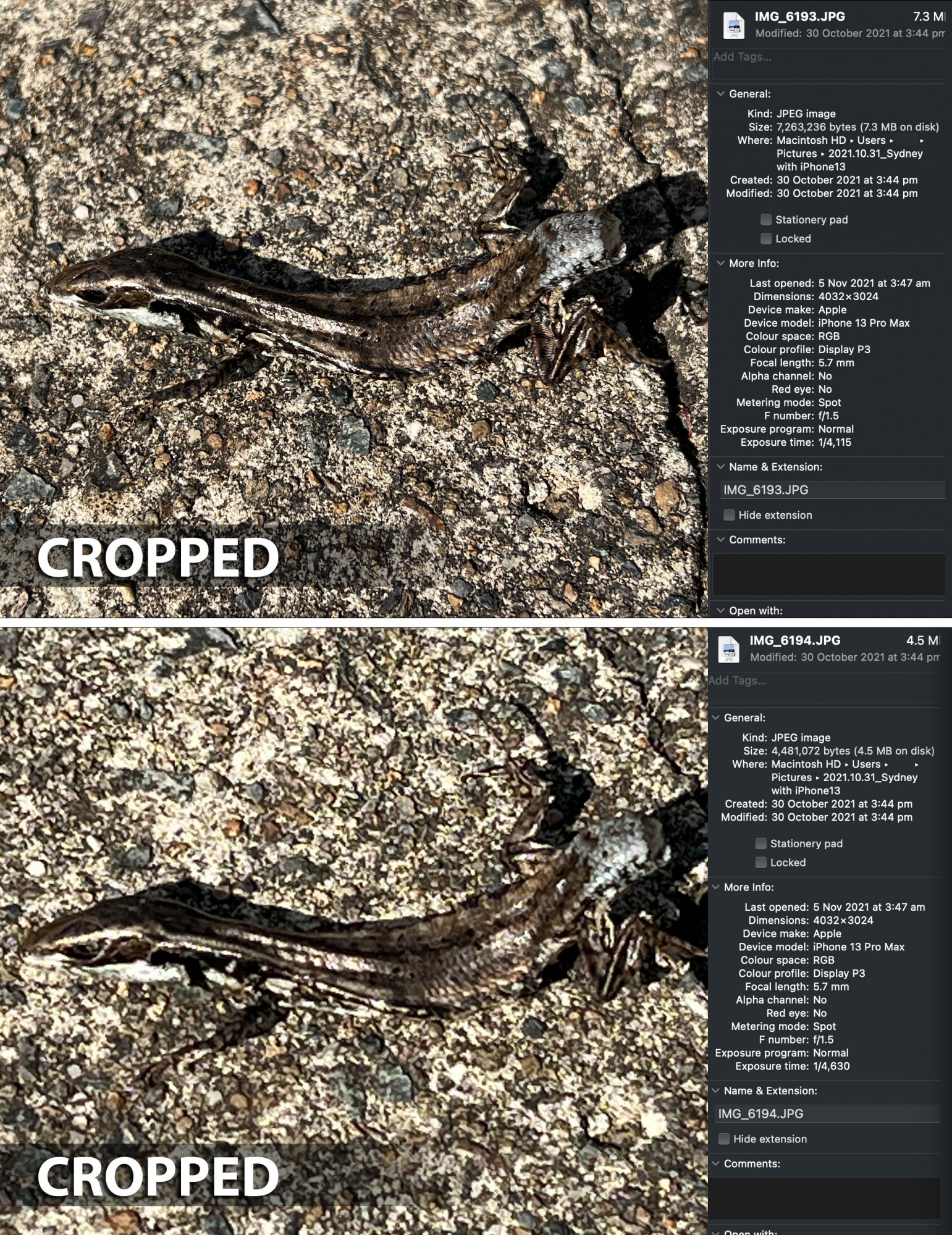

Another Issue surfaces with the iPhone 13 Cameras...
update: I took a picture of a small insect and DELIBERATELY used the 77mm (3x) to see what I would get. The results were smeary and horrid. The resulting image looked like a poor digital zoom. To my surprise the EXIF data showed that I had shot this with the 1x lens. The aperture used is what gave it away. I assumed that perhaps the camera had switched lenses but that was just a guess...
On a photographic forum I follow, a fellow iPhone 13 shooter has just mentioned to me the following: " don't really appreciate it, but have found that occasionally in really low light if I choose the 77mm camera especially at close distances, the camera will switch to the 26mm lens with the 1.5 aperture and digitally zoom to 77mm."
This reinforces my own experience. Although I was shooting in good lighting outdoors on a sunny day when I shot that bug. What the heck is going on with these iPhone 13 camera modules? It would seem that the iPhone will switch between the 3x and 1x lens when pushed... and then uses a digital zoom to make up the 77mm equivalent. I have another example of this when I photographed closeup of a dried out dead lizard on the footpath with the 77mm lens but it switched on me again and used the 1x lens with an applied digital zoom. (SEE attached image/s) The resulting image that was supposed to be from the 3x (77mm) lens was smeared and vevoid of detail. Just like the bug. It was annoying enough to try and get a Macro with the lenses constantly switching back and forth, and fortunately Apple sorted that out with a new setting that was added with the update.
