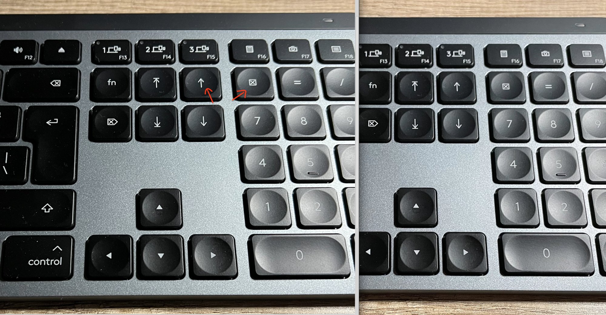

Yes. Same distance - only mini led lamp light in evening.
13 pro (left) vs 12 (right).
Little more ghosting on arrow and square signs for 13 pro - maybe less sharpness radius because of ƒ/1.5 ?
That's almost certainly because of ƒ/1.5 as it has less depth of field. The rest looks... almost identical?

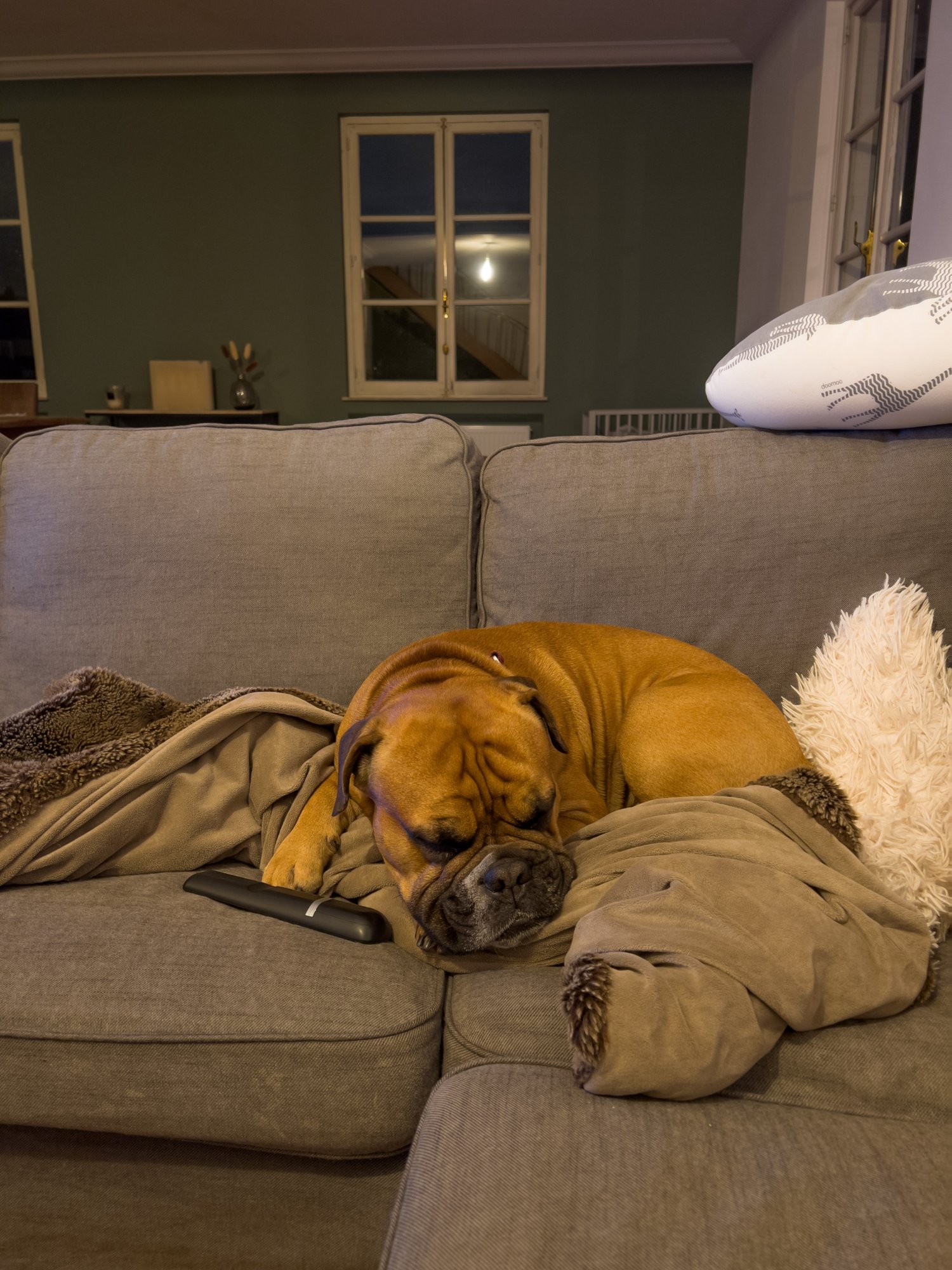

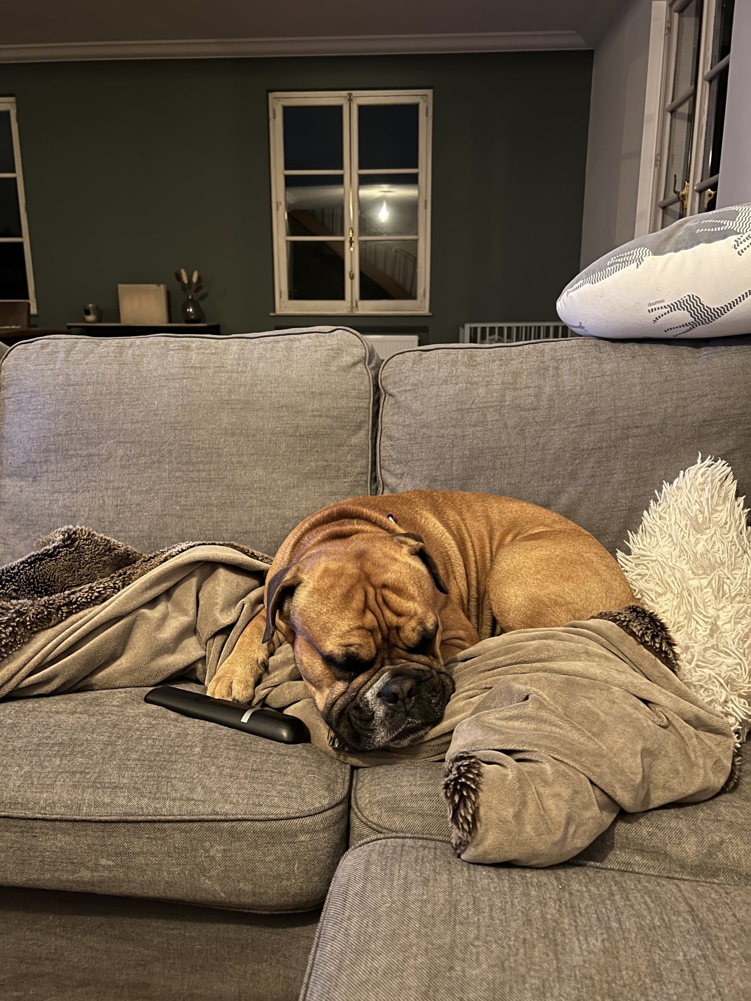

I might have found a workaround for this blurry/oversharpening issue.
I took one picture using the iPhone camera app with the wide lens, every settings set as standard, except raw enabled.
I look at the photo in iOS standard app, awful results, look a bad digitally zoomed picture taken from a 2010 smartphone…
Then I opened the exact same raw picture in Lightroom mobile app, the result is much more appealing, I mean there is quality in the picture, this is noticeable. No filter or setting modifications applied.
Pic in attachment is IOS photo app, pic above is Lightroom.
The issue is then more on the software side rather than hardware. Nonetheless, this cannot be ignored or denied! Please Apple engineers, take my humble investigation as hint of what’s going wrong with this post processing …
Your are welcome ;)
have a look below. First is IOS photo app, second is Lightroom.
Your are welcome ;)
That cushion on the right of your lovely dog looks terrible with the sharpening effect. It looks like spaghetti!

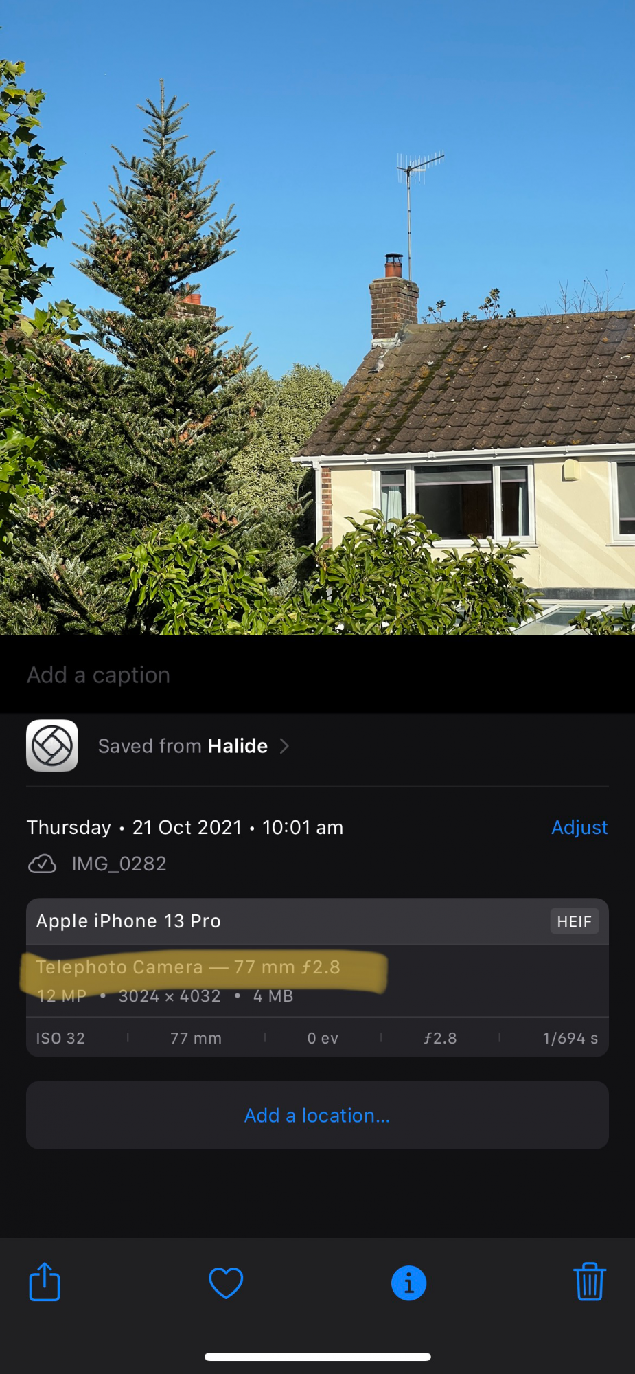

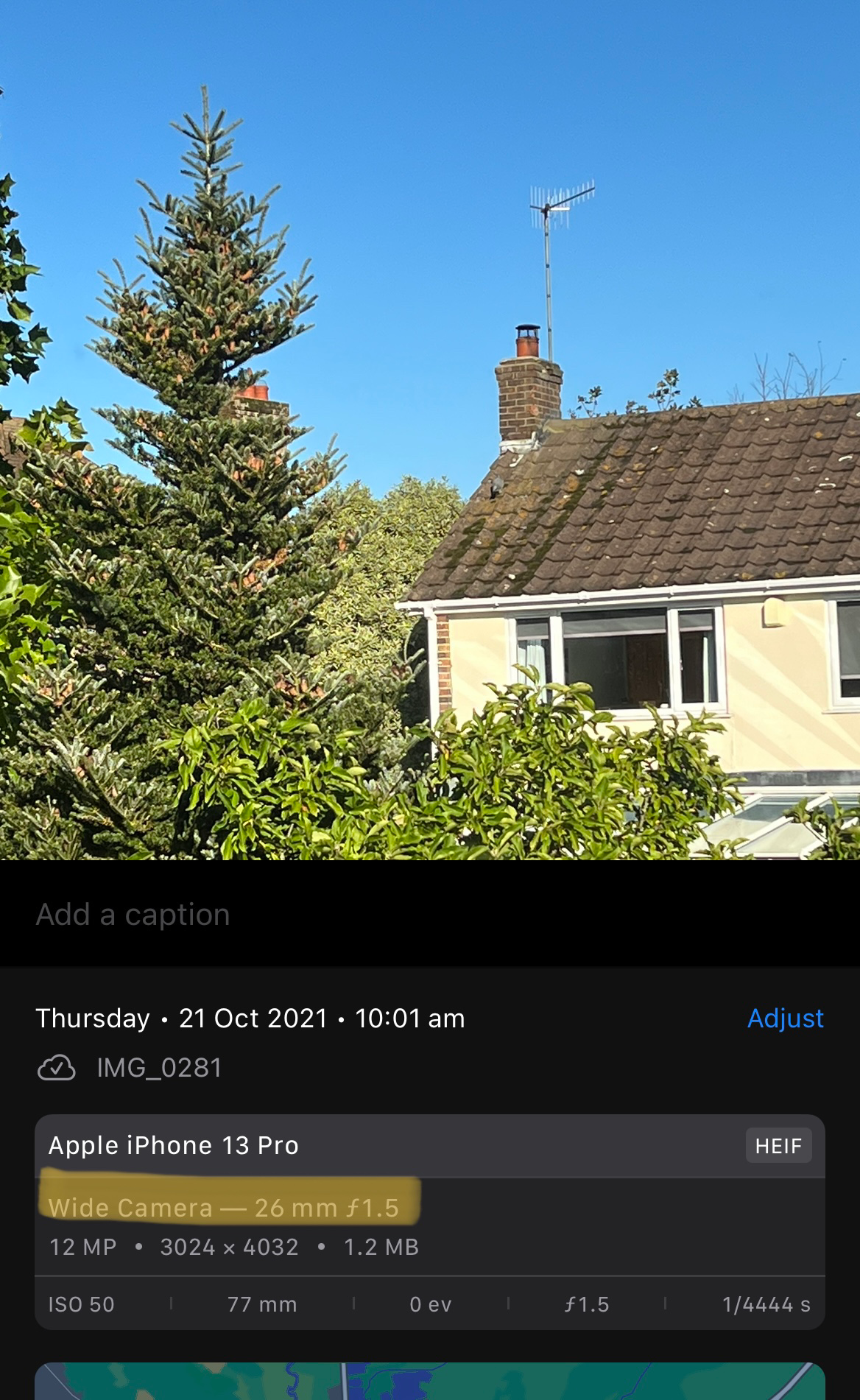

I'm fairly sure it's a software thing because I can use Halide to force the use of the telephoto lens and it looks fine.

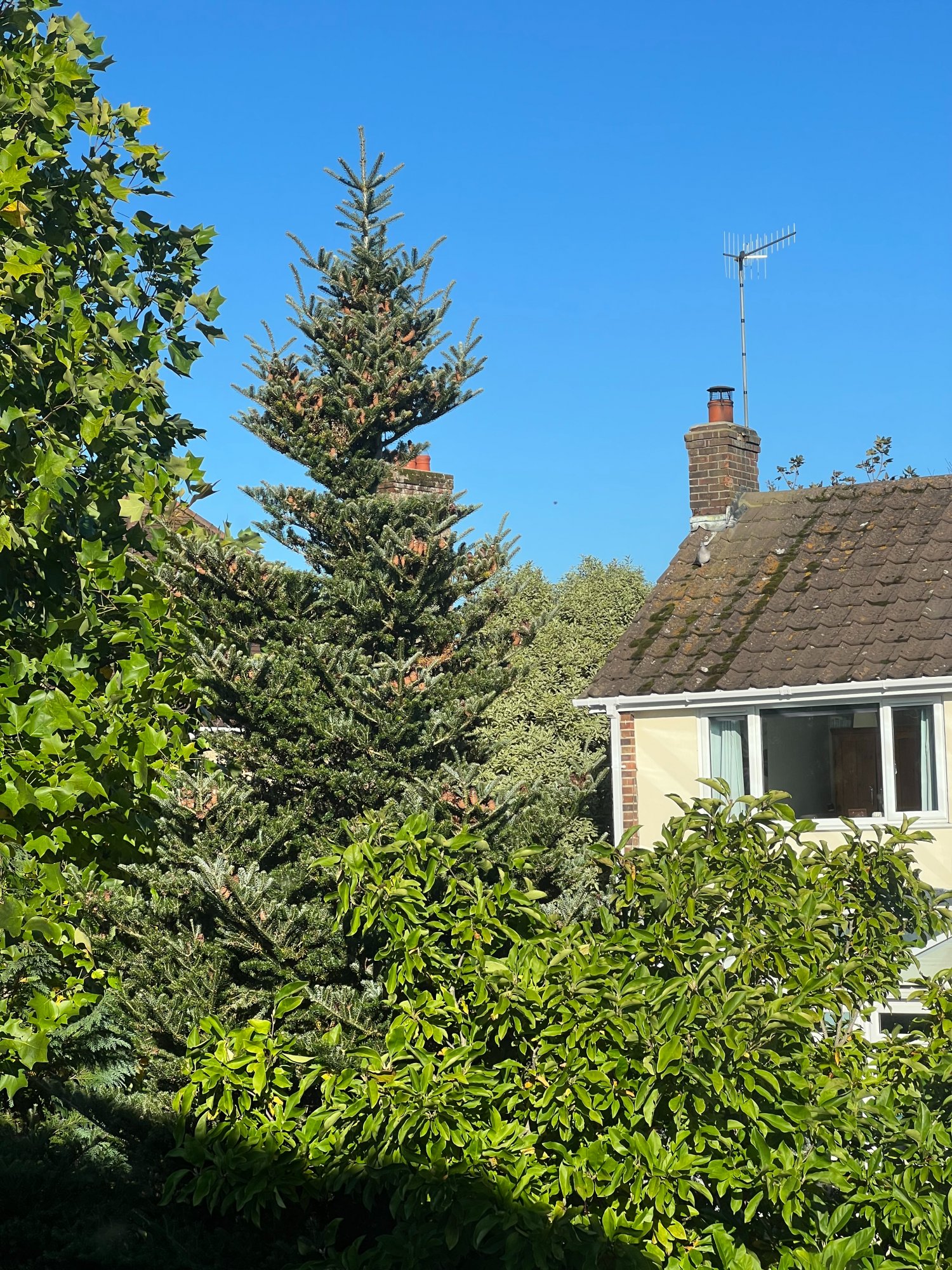

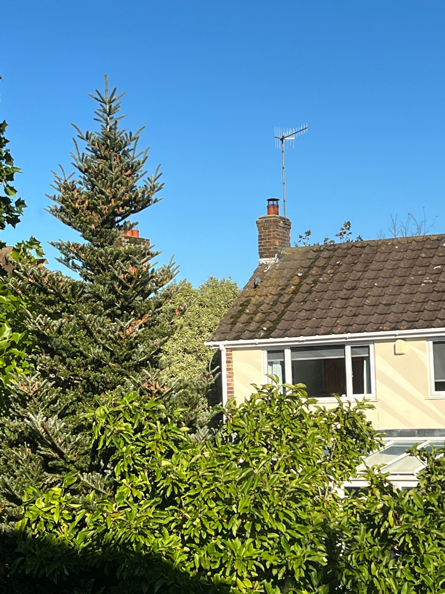

I just took these two photos out of my office window. No modifications beyond the Photos app's JPEG conversion. As you can see, brilliant sunlight so it's not like the smaller aperture of the zoom lens should be an issue.
Native camera app, 3x zoom
Halide, 3x zoom
Look at the details in the trees and on the roof. It's night and day.
And, sure enough, looking at the metadata in the Photos app, the native app took it with the wide lens and digitally cropped it.
So I think it's 100% a software issue, with the native camera app being far too aggressive in choosing the wide lens and digitally cropping. Personally I don't think it should be doing that at all, but if it's going to do that it should only be in really adverse lighting conditions, when the zoom physically can't pull in enough light.

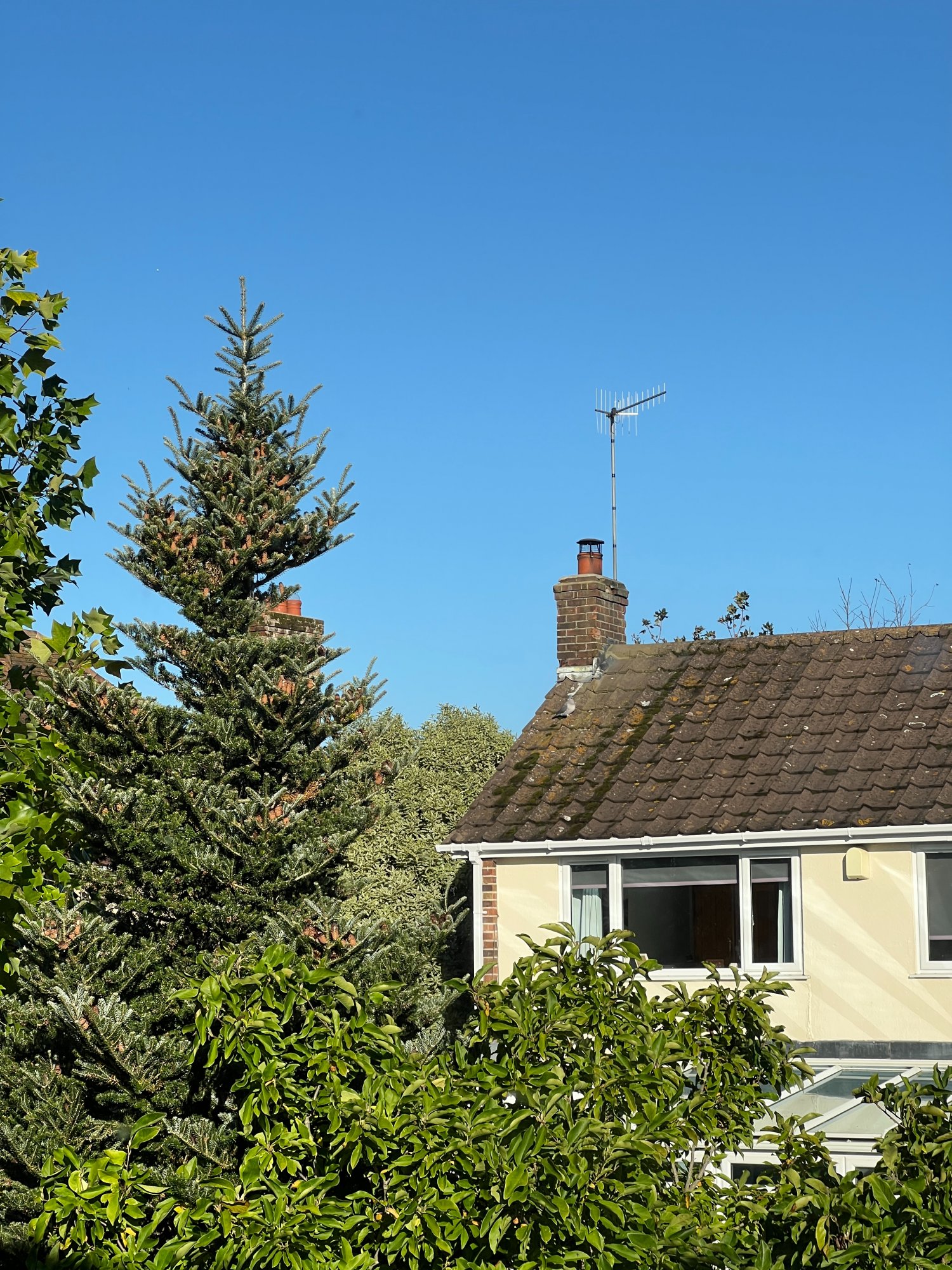

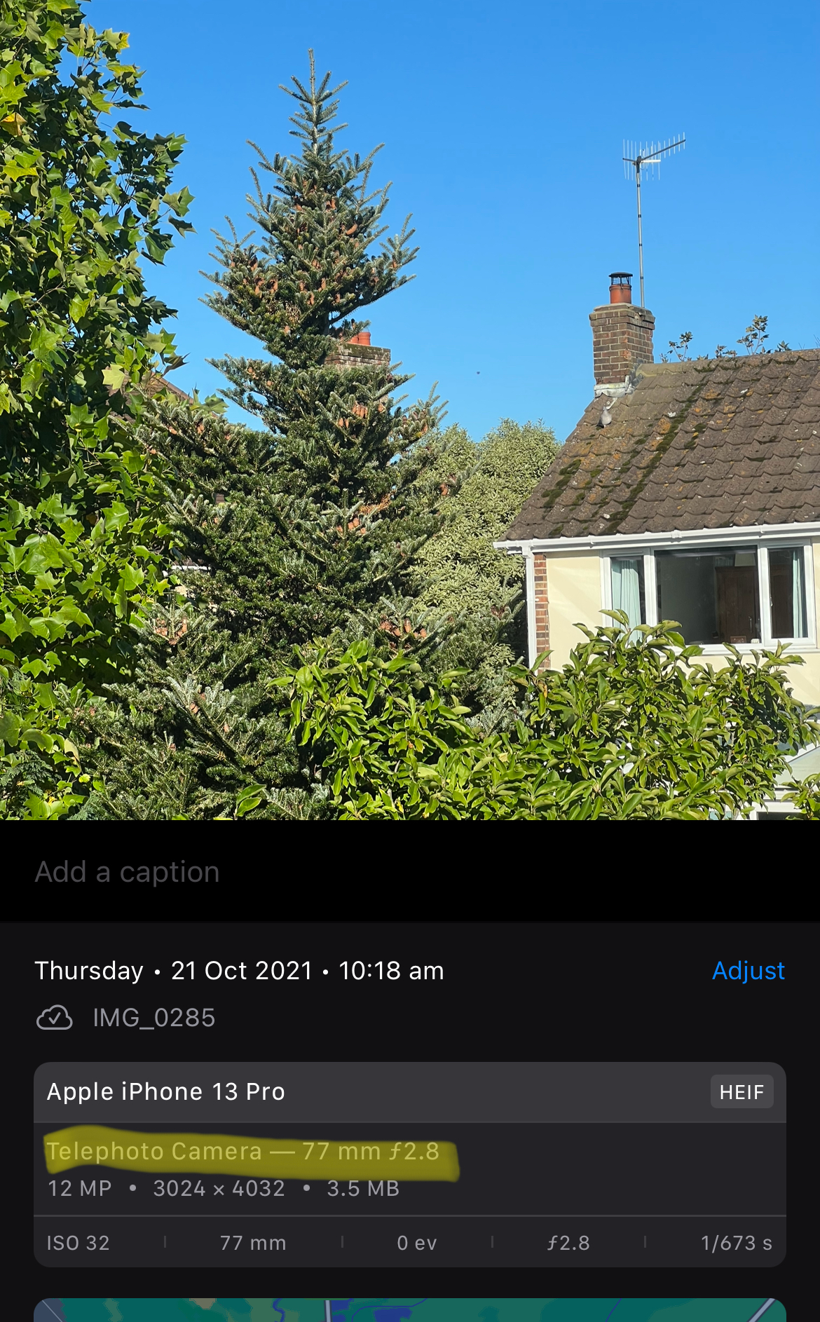

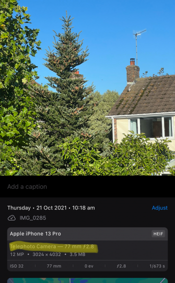

As a final experiment, I used the native app, 3x zoom, and put my finger over the wide lens so that it couldn't use it. The photo came out fine:
Edit: And here's the metadata for the final photo:

Halide, 3x zoom
View attachment 1873269View attachment 1873270

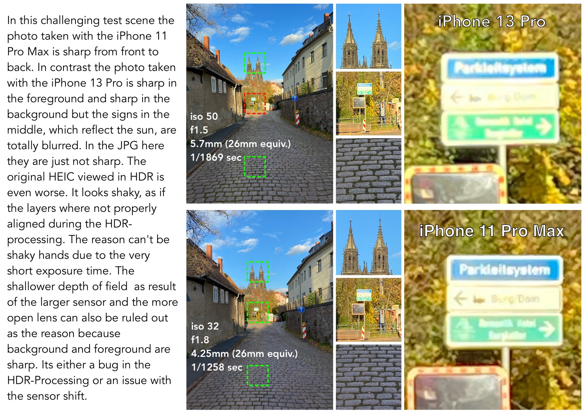

Hi there, while I agree that smart phones are not a perfect replacement for dedicated cameras they are the cameras we always have with us. And they are not exactly cheap. Given the marketing (best camera in an iPhone ever …) I think we can expect that the photos are not worse than those of older iPhones. But harsh contrasts are the situations where the 13 pro struggles compared to its predecessors. I get a lot of double contours around edges between dark and light areas. Here is a collage of a scene I shot with my old 11 Pro Max and the new 13 Pro to show this issue. It’s not a single incident but an example of a general flaw of this camera.
View attachment 1874704Hi there, while I agree that smart phones are not a perfect replacement for dedicated cameras they are the cameras we always have with us. And they are not exactly cheap. Given the marketing (best camera in an iPhone ever …) I think we can expect that the photos are not worse than those of older iPhones. But harsh contrasts are the situations where the 13 pro struggles compared to its predecessors. I get a lot of double contours around edges between dark and light areas. Here is a collage of a scene I shot with my old 11 Pro Max and the new 13 Pro to show this issue. It’s not a single incident but an example of a general flaw of this camera.
Given what someone else found that the image when taken in Halide looks MUCH better, it seems positive that this isn't a hardware issue, it is something Apple can patch with a software update in the near future.
