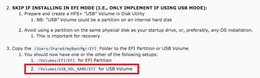

Code:
STEP 1: SKIP IF INSTALLING IN USB MODE (I.E., ONLY IMPLEMENT IF USING EFI MODE)
STEP 2: SKIP IF INSTALLING IN EFI MODE (I.E., ONLY IMPLEMENT IF USING USB MODE)
Continue with Step 3 onward
Seems you want EFI Mode. So implement the items under Step 1, skip Step 2 and continue with Step 3
Mount the EFI Partition of the disk you want to install to. Note that it doesn't say anything about it being your Mac OS disk. Actually, right at the start of the guide, it says:
You can implement anywhere you want in reality but best to avoid your main disk or any with an OS installed for the outlined reason.

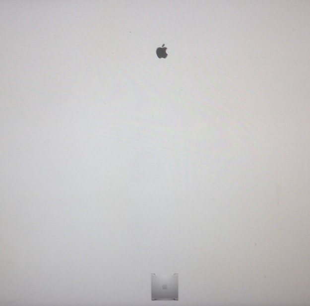

So I mounted the EFI partition and removed any folders but /EFI/Apple, and deleted /Users/Shared/myBootMgr, to have a plain vanilla installation.
I also removed any disks but the MacOS disk and the only graphics card installed in slot 1 is the Apple ATI HD 2600 XT. That's a pretty standard setup, apart from using a GPU from a Mac Pro 2008 in a Mac Pro 2009 with patched 5.1 firmware. On power on the system boots right into 10.12, which is the specified startup disk.
My HD, btw, contains 4 GUID/GPT partitions. MacOSX 10.9, MacOS 10.12, and 2 empty. I don't use FileFault. I have set MacOS 10.12 as the default in the Startup Disk control panel.
I followed step 1, 2, and 6 of your instructions.
I changed one of the empty disks to "VOLUME_LABEL" to match your script files.
I then mounted the EFI partition and dropped the BOOT and OC, OC_ALT into the EFI alongside the existing APPLE folder.
Then opened BootBlesser, choose EFI, refdind and soft bless. It did not show an overwrite button.
Reboot.
What I see is a grey screen, showing only the black apple logo on top and the Mac Pro case at the bottom.
Nothing to select. I also let it sit for a few minutes just to be sure.

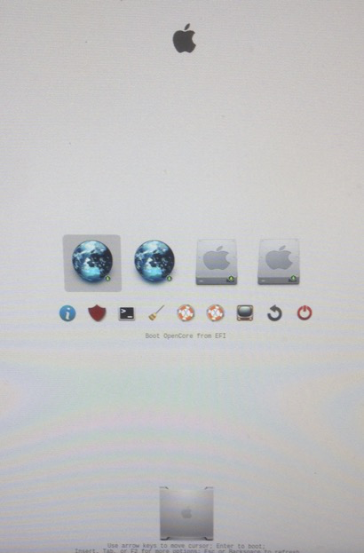

Then reset the computer, mounted the EFI partition and opened the BOOT folder.
I renamed BOOTx64.efi to BOOTx64.efi_nodebug, and
BOOTx64-DBG.efi to BOOTx64.efi.
Opened BootBlesser, selected EFI, refind and soft bless.
Reboot.
Now it works:
So why does the debug version work, but the non-debug doesn't?

I am a newbie about multi boot and I don’t succeed using myBootMgr.
I followed step by step tutorial up to “Installation item 4”.
To limit risk, I tried installing on a USB stick formatted HFS+, named REFIND_OC
I copied on it EFI folder from myBootMgr folder, then
With following choices
BootBlesser.app => USB => Refind => Soft Bless => Yes, I get error message “Could not find /Volumes/REFIND_OC/EFI/refind”
BootBlesser.app => USB => Refind => Soft Bless => Override=> /Volumes/REFIND_OC
I get error message “Could Not Soft Bless Refind Boot Manager Make sure all files are copied to correct locations or try again if running after a cold start”
Something is surely wrong in what I did, but I wonder where is Refind.app.
In discussion thread I read “Our patched Refind version “ or “The version of Refind bundled with MyBootMgr” but I didn’t find Refind.app within myBootMgr.
Is Refind.app to be installed before installing myBootMgr ? And where ?
A lot of questions from a newbie.
Thanks for your help.

@Amenophis,
Looks like your issue is here:
I will amend this bit to make it clearer.
Your folder structure should be:
Code:
| /Volumes
| /Volumes/REFIND_OC
| /Volumes/REFIND_OC/EFI/BOOT
| /Volumes/REFIND_OC/EFI/OC
| /Volumes/REFIND_OC/EFI/OC_ALT
I.E., you have /Users/Shared/myBootMgr/EFI/Various folders
To deploy on your REFIND_OC USB Volume, it becomes /Volumes/REFIND_OC/EFI/Various folders
That “refind” should not be present
Other queries addressed below for general info only:
The package is a self contained package. Do not consider anything not explicitly mentioned in the guide. If anything of such needs to be done, it would have been stated.
As for the "Refind App", See here (for background info only):
