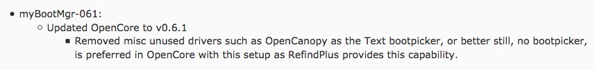

I tried to use your updated 0.6.1 package and It broke openCanopy. (Added to drivers/config.plist) I only get a vertical text bootpicker in OC now. OpenCanopy worked fine with your .0.5.9 package? Any suggestions?
Although the driver was distributed, OpenCanopy was never supported with this as the preference is for the OpenCore text bootpicker (with a short timeout) or better still, no bootpicker in OpenCore at all since RefindPlus already provides a graphical bootpicker.
Change with v061 is that the OpenCanopy driver is now no longer distributed to focus on actually supported items.
Users that want to use OpenCanopy will need to get the required components and configure it.
This is recorded in the Change Log:
