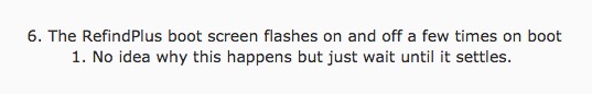

There is a trick to make it create one in USB Mode but I don't remember this right now and IIRC, it is not compatible with the BootBlesser App so not supported at this time in any case.

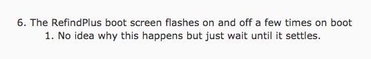

I have gotten the flickering screen thing before and not sure what causes it.
In my case, it settled each time after a few seconds and never gotten it for 10 mins.
I have not had it for quite a while now and not sure what the answer is to be honest but maybe try a few things to try to see what might be the issue:

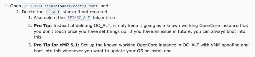

The only caveat is Item 3 of STAGE 3 - POST INSTALLATION:
Also see this recent modification of Item 1 of STAGE 3 - POST INSTALLATION:

I did get caught up by the "Skip if installing in EFI mode…" a couple of times – my brain isn't so good with the positive-negative statements.
Not your brain ... It was worded wrongly.
Fixed ... Thanks.
Reactions: JedNZ
So you can configure each as in any other case and that's why Post 1 refers config issues to the respective threads. It's not relevant that they are linked. Each one actually works independently as if installed alone.
So I could configure EFI/OC_ALT with the VMM mod on which would allow for upgrades to Catalina, then after applying a system update boot back into EFI/OC on the next boot instead of having to go back in and turn VMM off after applying updates like I have to do on my other (non-RefindPlus) cMP. That’s awesome.
Fixed ... Thanks.
That works much better for my logic. Really appreciate that.

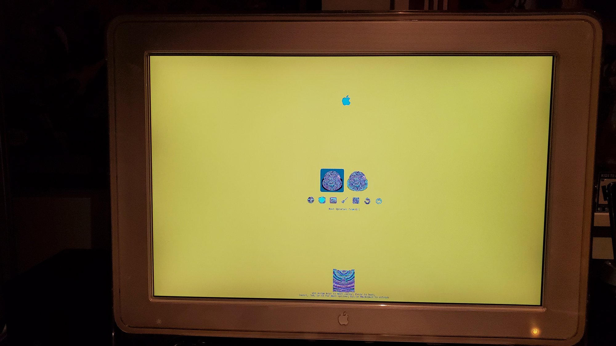

Hi
I followed the instructions and got rEFInd to work (though i am only seeing the 2 OC entries...) and i can chainload OpenCore from there and it boots my Catalina patched install (cMP 3,1) just fine.
But, the colors are all messed up in rEFInd and OpenCore.
My GPU is a AMD Radeon RX 550. It is working in Catalina with full acceleration.
Set WriteFlash to false in the OpenCore config files, restore the default chainloader/config.conf and BOOT/refind.conf files, shut down and reset NVRAM when rebooting.

I did what you said, i set the flag in opencore.plist to false, i copied the original config.conf and refind.conf files from original package from first post. I still get this 70's psychedelic color scheme!
I also tried another monitor through the hdmi connector, same thing.
Will pick up on this later.

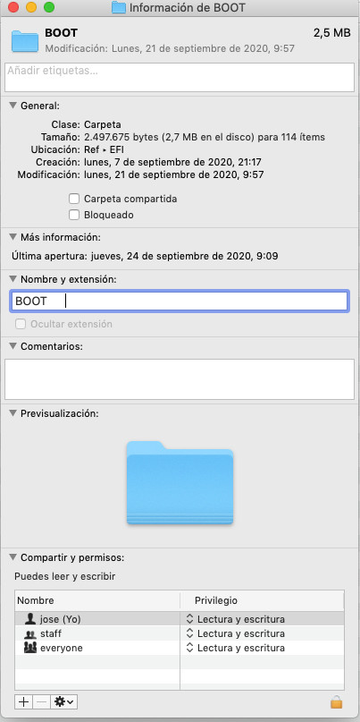

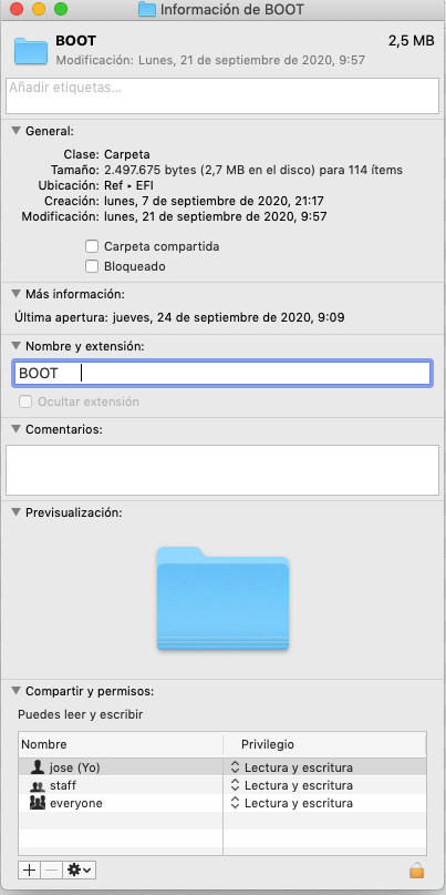

@sirrdg
Can you right click on your "/EFI/BOOT" folder, select "Get Info" and share a screenshot of the window that is generated? Actually, please do the same for the "/EFI/BOOT/vars" folder if you have one.
Thanks for the feedback ... will investigate for the next version.

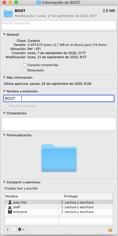

@sirrdg
Wich "/EFI/BOOT" folder you refer, the one from the usb? In that case here you have:
