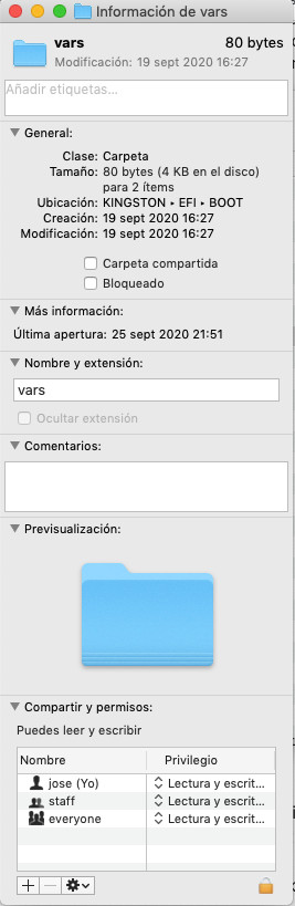

Thanks. Can you add the same for the BOOT/var folder or don't you have this folder?
Here you have.

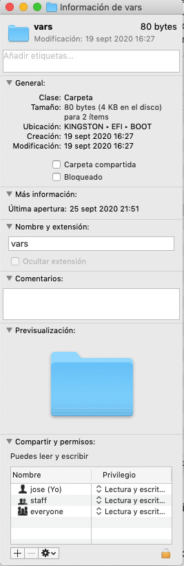

Finally, i'm having trouble with the message "Error: Write Protected in ReadhiddenTags()" just after press a key in refind menu, all freezing random.
I can't reproduce this on my end and you seem to have read/write permissions so not sure what is behind the error.
The next version due in a bit over a week's time will disregard this error but this would not solve the root cause and the freezing afterwards that you have reported will likely still happen.
I think this is linked to something with the USB and I am half inclined to delete the USB Mode stuff from the guide as it seems despite the assurances that the setup is benign, most people disregard the recommendation to go for EFI Mode and select USB Mode instead as most think it is "safer" but the fact is that it is on the flaky side.

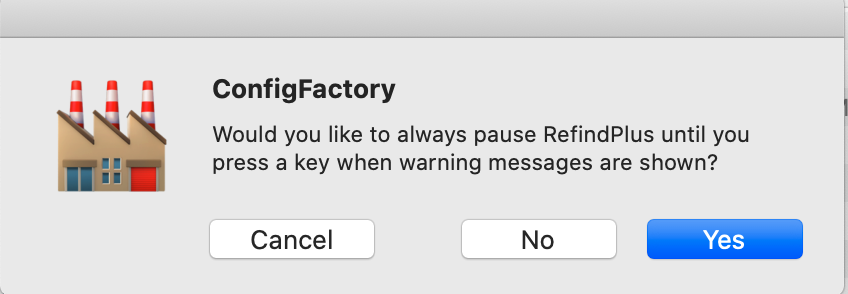

I have tried multiple times setting up the ConfigFactory and I can't seem to get past this one problem. I never get to the rEFIndPlus GUI, the monitor has no signal until I click any key on the keyboard usually choose ESC key and it immediately launches the rEFInd GUI screen.
I tried setting up both times once answering default Yes and then No to would you like to pause RefindPlus until you press a key when warning messages are shown doesn't seem to fix this problem.
Log attached, Thanks!
Edited a couple of hours later:
Ok I figured out the issue, even when I choose "No" to the above screenshot it is not updating the refind.conf.
I manually removed the # and it now boots into the GUI without any keypress. See below.
# Proceed automatically when notices are shown on screen (1, true, or on)
# instead of having to press a key to continue (0, false, or off).
# When this token is set to true, rEFInd will pause for three seconds and
# then proceed as if a key had been pressed.
# Default is false
continue_on_warning true
Also the pause time is set correctly for OpenCore but the pause time for refindplus just defaults to 20 seconds no matter what time setting I choose in ConfigFactory.

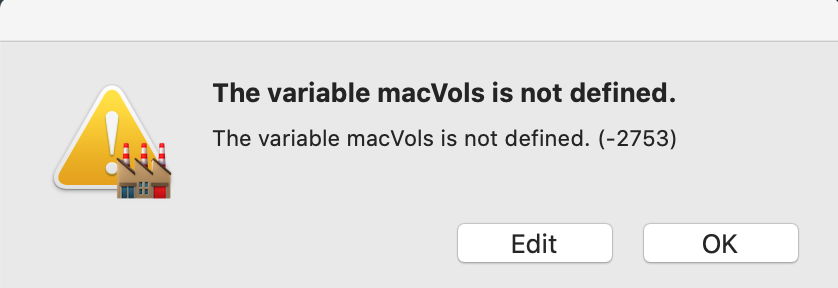

I do get this message after the EFI is built so not sure why, I know I am setting my volume correctly.
You should use the helper tools that come with a release package.
