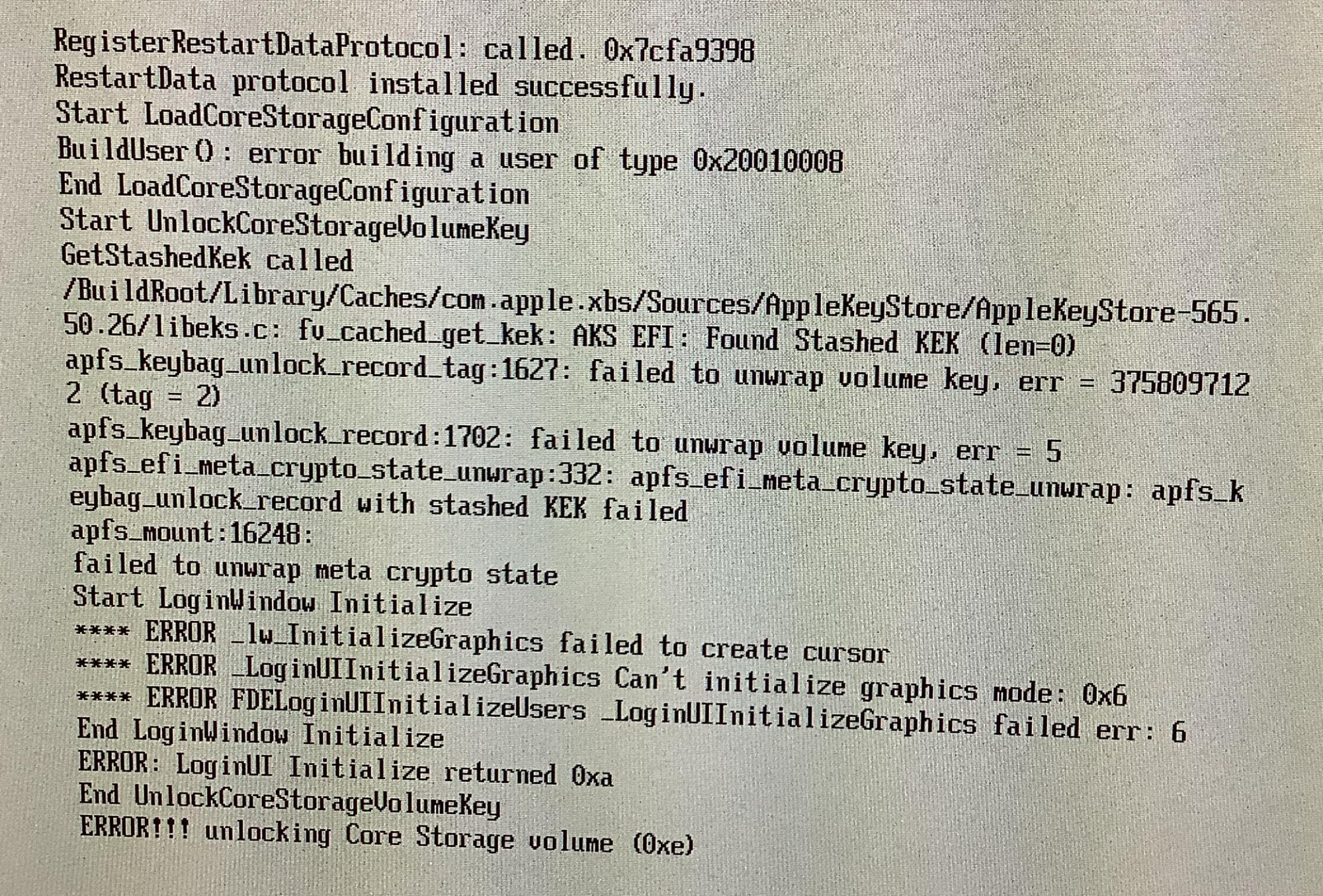

>no, the same instance gives the errors shown in the photo shown in #377

If I boot via chainloaded openCore into 10.14.6 Recovery it works. Maybe something with FileVault.
but native OpenCore boots into my FileVault Mojave Disk (Sata SSD in bay 1)
Ok, if I bless this openCore Installation what Dayo‘s Tool made OpenCore is not rebooting. In Efi mode.
FileVault Mojave boots like it should.
nvram shows correct OpenCore Version dbg-062
so something with chainloading opencore from ReFind.

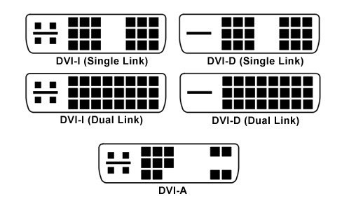

Which Kepler GPU model is it? Has it been flashed? What port is your monitor connected to? If DVI, which of the types below is it?
Also, which Mac Pro model are you running? Note you posted cMP 3,1 earlier

Regarding the DVI post. I'm running the RX 5800 "XFX" 1 DVI-D x 1 HDML x 4 DVI ports. The HDMI port now works on boot up with graphics after finding out the GPU has a "DUAL-BIOS" switch. Position 1 (Legacy Mode) and Position 2 (UEIF Mode) **I think that is correct** Either way its up and running. I have been having random shutdowns which I traced back to the dual 6 pin to 8 pin connecter I should be getting today as the RX 5800 is connected on with a single 6pin to 8pin.

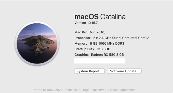

Hardware Overview:
Model Name: Mac Pro
Model Identifier: MacPro5,1
Processor Name: "Eight Core" 2 x Dual Core 2.4 (2010/Westmere) -> Quad-Core Intel Core i3

Interestingly, you actually should NOT be getting a bootscreen from what the RefindPlus log is showing and that is something I will like to understand.
Please share the requested OpenCore config files and information about your GPU.
> Nividia Quadro K2000d with 2 DVI and one Mini Display Port,
a Kepler Card flashed with UGA Bootscreen Rom. Does not work perfectly but good enough for this Mac Pro and my needs.
Connected to an Apple 23" Display directly connected to DVI-I Single Link

I see Preboot in Refindplus, can't boot into it but much more interesting:
no more reboot in OpenCore when selecting Mojave Disk but Error Messages:
after that I am back in OpenCore.
If I select the Apple Boot Picker in OpenCore I get the loud chime and reboot.
  • logs and configs.zip
This is just the same error happening in a different way but sheds a bit of light.
This is suggested as "No" in ConfigFactory for a reason. If you check the OpenCore docs, you will see that it says this feature doesn't work on some Macs.
