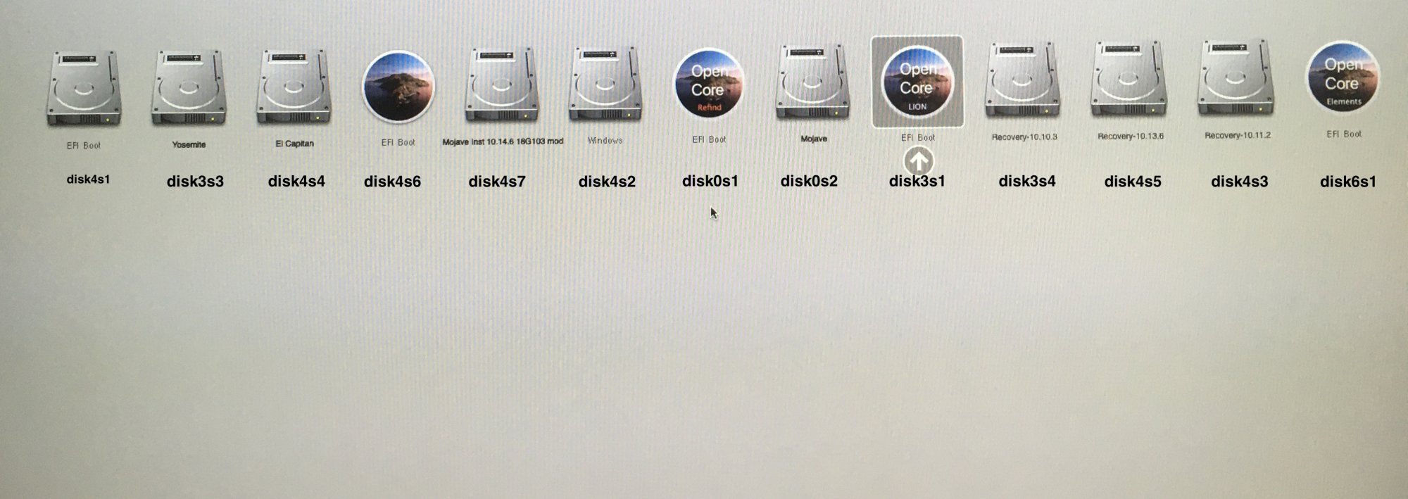

it just resets hard the Mac if chainloaded via RefindPlus.
Out of interest, when you run OpenCore directly, do you use the BootBlesser to bless or do you bless directly and if directly, which file do you bless?
I copied the standard config.plist from the opencore thread. No big difference.
also I tried to boot my usb backup clone what is also filevault formatted With standard settings. Almost same Reset.
{almost} explained: with Dayo Setting the boot chime is 100% Audio Volume
the boot chime audio volume stored in my nvram is about 20% Audio Volume
so theres an audible difference in restarting thru standard and thru Dayo settings.
still thinking about an issue with FileVault. Dont have a regular Mojave installation here, its my home machine and I am limited. Much more stuff in the workshop to test but that will happen next week.
a Partition with the DosDude Mojave Installer and a Partition with El Capitan both boot just fine with chainloaded OpenCore and standard settings.

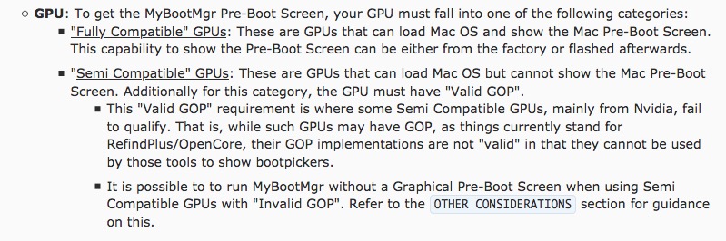

I have a 3,1 Mac Pro, with a new (to me) Kepler GTX780Ti. Mojave on a HFS+ partition on a AHCI PCIe SSD, El Capitan and Snow Leopard on a separate HDD, and legacy Windows 10 on another HDD.
I ran through the installation steps as indicated on the first page, and installation seemed to work well (I chose to install on the EFI partition of the El Cap/Snow Leopard HDD). I softblessed RefindPlus, but I just reboot into a black screen. Same thing happens when I softbless Opencore. If I just press enter at the black screen, system reboots and I go straight back into Mojave as expected (since it was a softbless).
Can anyone point out where I've gone wrong here? I suspect somewhere in the Config settings?
Thanks a lot!

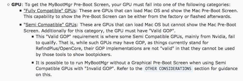

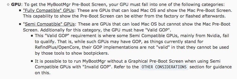

See the requirements in the guide: (OUTDATED ... REFER TO CURRENT VERSION IN POST 1)
But I was under the impression that the whole point of using this method is to enable a boot screen for cards that can't natively show it?
It is a work in progress for Kepler GPU's. We need testers. If you want to contribute let @Dayo know.

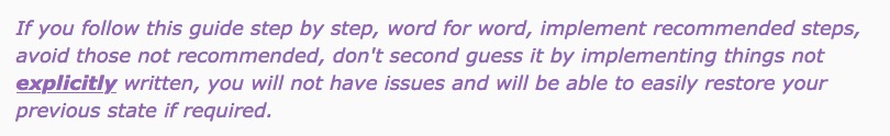

Before dealing with top level issues, you need to sort out some basic ones resulting in issues with the Helper Tools.
Wipe things out and start over while adhering to this:
if you do have issues after strictly following this, then such can be resolved.
