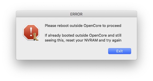

Back in the loop. Bootblesser says I need to reset NVRAM and DeployEFI gives an error.

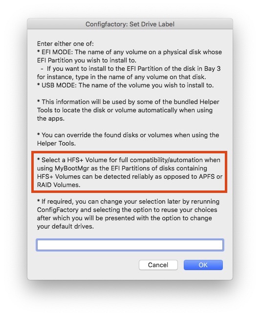

Your selected volume is a Mojave Volume which implies APFS. In ConfigFactory, the dialogue box for setting this says to avoid APFS or RAID volumes and the other tools (TweakEFI, BootBlesser etc) exclude them as an option as they are "virtual" with potential issues if selected. How are you actually selecting this when using these tools?

One question. Your selected volume is a Mojave Volume which implies APFS. In ConfigFactory, the dialogue box for this says to avoid APFS or RAID volumes and the other tools (TweakEFI, BootBlesser etc) exclude them as an option (they are virtual and potential issues if selected). How are you actually selecting this when using these tools?
You need to take a bit of a step back and read the messages you are getting. That message has nothing to do with SIP.
It comes up when you try to use BootBlesser when booted in via OpenCore (you can't bless in such situations). Specifically, it says you should reboot outside OpenCore to use the tool. It then says to reset NVRAM IF you are sure you are booted outside OpenCore and still seeing the message.

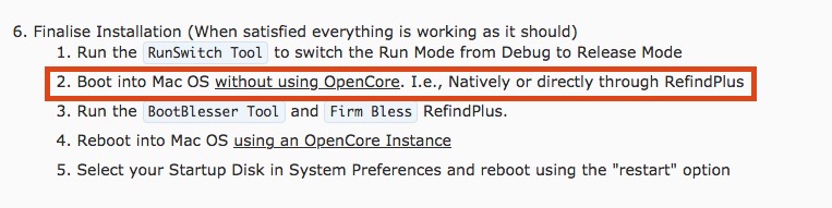

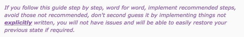

You got that message in BootBlesser because of this bit in the guide (Only spelt out for Firm Bless - Will rectify):
I suggest you go back to the guide, restart from the top (delete the previous downloads you have and download the package again) and redo things without rushing it ... Tick off the steps in the guide one by one.
Don't skip anything and don't take any shortcuts even if you had done it earlier. Don't reuse settings in ConfigFactory for instance. Do it again and ensure you read and understand the messages.
Just work your way through the guide literally. Also stick to the tools from one download and don't try to mix and match.

Since ALL my volumes I've been testing are APFS, this may have been another source of my issues as I was unaware it was an issue to avoid in the first place. By the way, I just double checked the guide and didn't see anything there about not using APFS. My previous refindplus install had no issues with Mojave on NVME an APFS or when I tested Catalina so I never imagined that might be impacting things.

There is absolutely nothing wrong with using APFS and it does not result in any issues by itself. You missed it but ConfigFactory will suggest that you do not select an APFS volume when naming a volume to ID your physical disk:
This is purely a procedural issue and you can select an APFS volume. The only implication is that while using the tools, it will not be fully automated (it cannot detect the EFI Partition of the physical disk the volumes sits in at this point) and you will need to tell it the EFI partition yourself each time. That's all in normal situations.

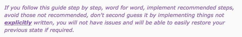

If you follow this guide step by step, word for word, implement recommended steps, avoid those not recommended, don't second guess it by implementing things not explicitly written, you will not have issues and will be able to easily restore your previous state if required.

    1. Download and mount the MyBootMgr dmg file and run MyBootMgrSetup
      1. Due to significant automation introduced as from v062, it appears the package is now too large to attach to this post ... You can download it HERE
    2. This will create a /Users/Shared/MyBootMgr folder for you
      1. If this folder is already present, it will be backed up as MyBootMgr_BAK
        1. If a MyBootMgr_BAK folder is already present in such cases, it will be overwritten
    3. Within this folder will be a MyTools folder containing the Helper Tools that make up MyBootMgr
  2. Run the ConfigFactory Tool and provide the required responses
    1. This will build and configure both RefindPlus and OpenCore to your specifications
    2. The configured files will be saved in /Users/Shared/MyBootMgr/EFI
    3. You will need to specify where you want to implement MyBootMgr
      1. Remember to avoid using a partition on the same physical disk as your startup drive, or, preferably, any OS installation. This is important if you ever need to reset things.

    1. Run the BootBlesser Tool, select RefindPlus and then, Soft Bless
      1. You must be booted into Mac OS without using OpenCore to Soft Bless. That is, natively or directly through RefindPlus
      2. Remember to select EFI Mode or USB Mode to match your implementation mode. If you make a mistake and bless the wrong target or type, run the StartDiskReset Tool

  6. Finalise Installation (When satisfied everything is working as it should)
    1. Run the RunSwitch Tool to switch the Run Mode from Debug to Release Mode
    2. Run the BootBlesser Tool and Firm Bless RefindPlus.
      1. You must be booted into Mac OS without using OpenCore to Firm Bless. That is, natively or directly through RefindPlus​
    3. Reboot into Mac OS using an OpenCore Instance
    4. Select your Startup Disk in System Preferences and reboot using the "restart" option

If you follow the guide under upgrading, the logging will switched off when you are done.
HINT: If you can't be bothered to read this or it's too much trouble, just look at the provided tools.

Try to ensure you know the meanings of terms you use as neither OpenCore nor RefindPlus have anything to do with BootROMs.

Dayo this is an excellent project! I have a couple questions before I try to deploy it.
In any case, my main questions are related to how I should organize my various volumes the best way and some questions about the resulting config.plist that ConfigFactory generated just now.
So first about which volume to install this on. I gather that I will be using EFI mode. I have two SSD's installed on the computer, both were setup as APFS drives, one to install Mojave the old fashioned Apple way, and the second I setup with Catalina using CDF's guide on that other thread. Now I am going to bring rEFInd into it..
Questions
  1. So first question, should I do the initial setup, including the bless, while booted natively into my original Mojave, in other words not by using OC Boot Picker to get there. I should disable OC, following cdf's guide disabling it...and make sure I'm cleanly booted into Mojave without OC...and then proceed with the instructions here to install rEFInd. Yes?
  2. Where do you feel is the ideal place to install rEFInd in EFI mode, on which disk, such that I will easily be able to pull a drive and get back to reality if I have to, or whatever? I think probably it will be the same as cdf's guide in that I should install it onto the EFI partition of the drive where Catalina is currently installed, and leave the Mojave drive pristine pure Apple boot. That would become my fallback drive, so worst case I can pull the Catalina drive out and boot up the Mojave drive and get back in business, wipe off the OC, reinstall rEFInd or whatever. Am I understanding that correctly? Is there any reason or benefit to needing an entirely separate drive with no OS at all on it for the rEFInd stuff? There was some mention about that in your guide, but I didn't understand exactly why that would be the case or what exactly you meant.
  3. Related to ConfigFactory, it created a number of additional kext injections that I have not been using so far with CDF's guide from that other thread, so I was hoping you could elaborate on what they are and why I would want them. Namely: AHCI_3rdParty_SATA.kext, Innie.kext, NVMeFix.kext, RadeonBoost.kext.
    I already know what the RadeonBoost is, but when I tried that a few days ago I really didn't see any significant improvement with my RX580, so I pulled it back out. But any comments about that would be appreciated, and which question in the ConfigFactory do I need to answer appropriately to keep Boost out? I thought I answered "no" to a question about that, but maybe not, will try again later. I can always hack the EFI package after running ConfigFactory, but I would really like to try to use ConfigFactory as designed without straying if possible.
    NVMeFix.kext I'm assume is only needed if I have NVMe drives, which I don't. How can I keep that out?
    Not sure what Innie.kext is?
    I think AHCI_3rdParty_SATA.kext must be related to older legacy drives or something? I'm thinking I don't need, but please advise.
  4. If there are any other differences between this OC setup and the simple setup that CDF documented on that other thread, perhaps related to hardware acceleration or id spoofing, etc.. that I need to be aware of just to know the difference between that setup and this setup in OC..

The last installation step in Dayo's guide is to go to System Preferences Startup Disk and select the "startup disk" then reboot. It wasn't clear to me which disk he meant by that..or why we need to do this step? I actually only have the option to select my Catalina Disk (the Mojave one doesn't appear), or another backup partition I have out there is also showing. But anyway, I just want to understand the purpose and ramifications of this last step.
The previous step was to Firm Bless RefindPlus.
This step uses Startup Disk preferences panel to Firm Bless the macOS partition that you want to boot - but the trick here (I am totally guessing!) is that OpenCore intercepts the Firm Bless so that Refind Plus remains as the Firm Blessed boot option and the macOS that Startup Disk attempted to Firm Bless becomes a setting in OpenCore (probably some non standard EFI NVRAM variable? - I'm too lazy to check) which Open Core will boot automatically for you or at least select as the default boot option (I could be wrong - I haven't used this stuff).
