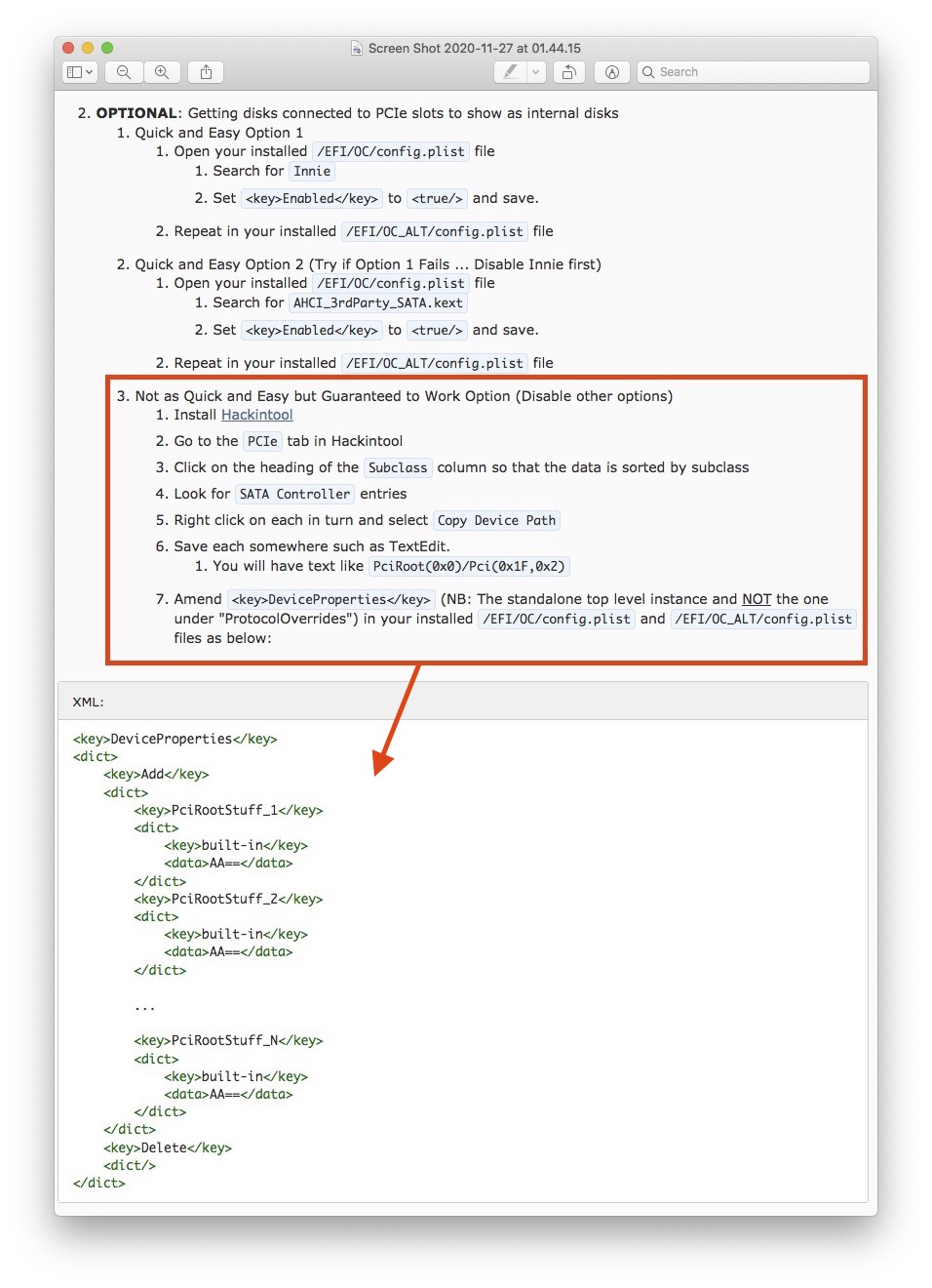

What I am struggling with is why/how you have formed an opinion that the guide exclusively says to use kexts when this is not the case.
BTW, the response by @JedNZ applies in general but does not in this case since the three methods in the guide, Innie.kext, 3rd_party_SATA.kext and setting the device properties, are all stuff to be done manually and not programmatically done.
Anyway, still a mystery as to why/how you feel the guide says to use kexts as opposed to device properties.
ps - I have read the guide in its entirety multiple times FWIW.
Fair enough. Just means you missed this Device Properties based option each time:
So, this guide is not kext exclusive which then makes your question not MyBootMgr specific but a general one of the pros/cons of kext v Device properties. Those sorts of questions are kindly requested to be directed to other points.
