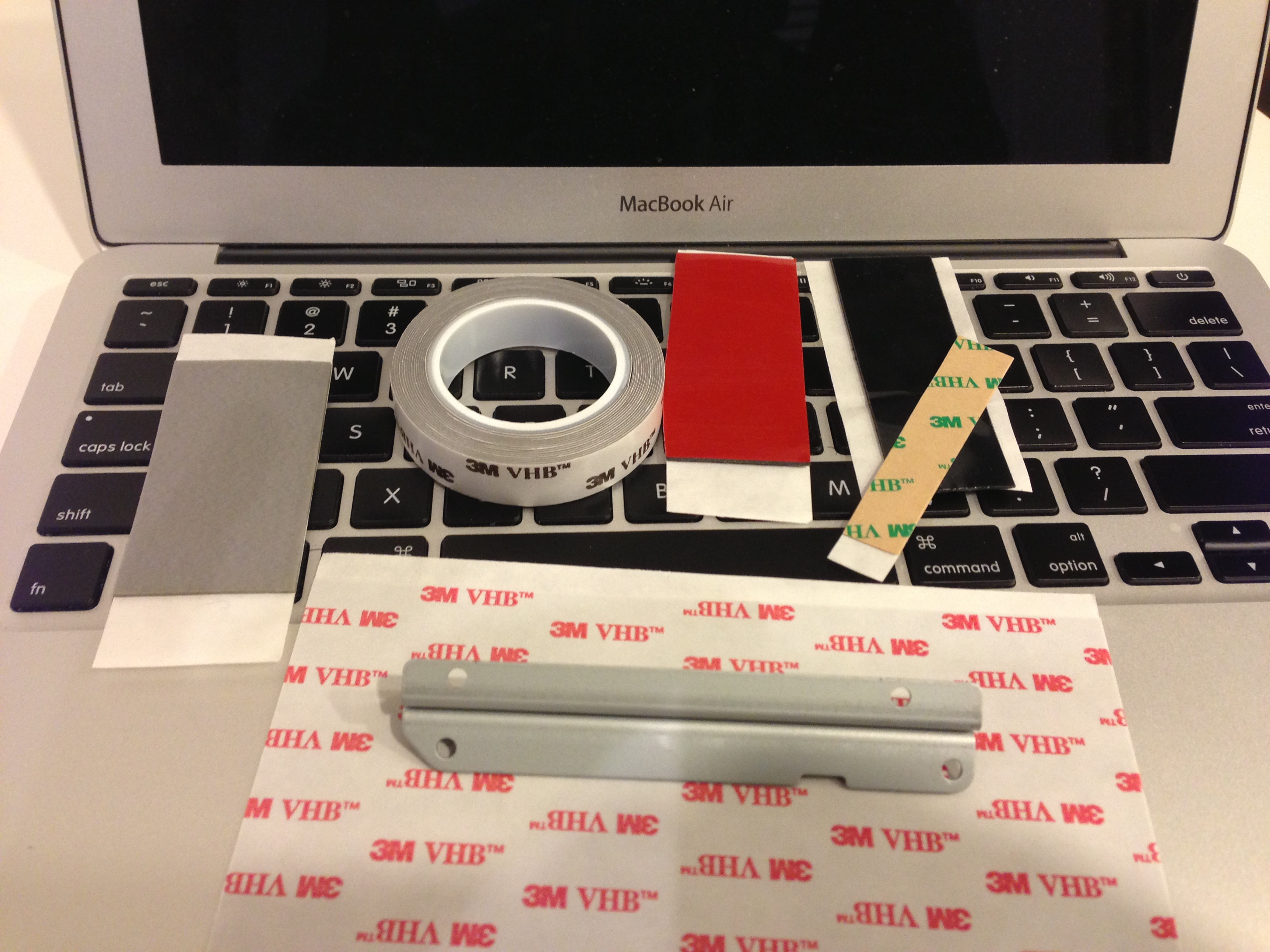

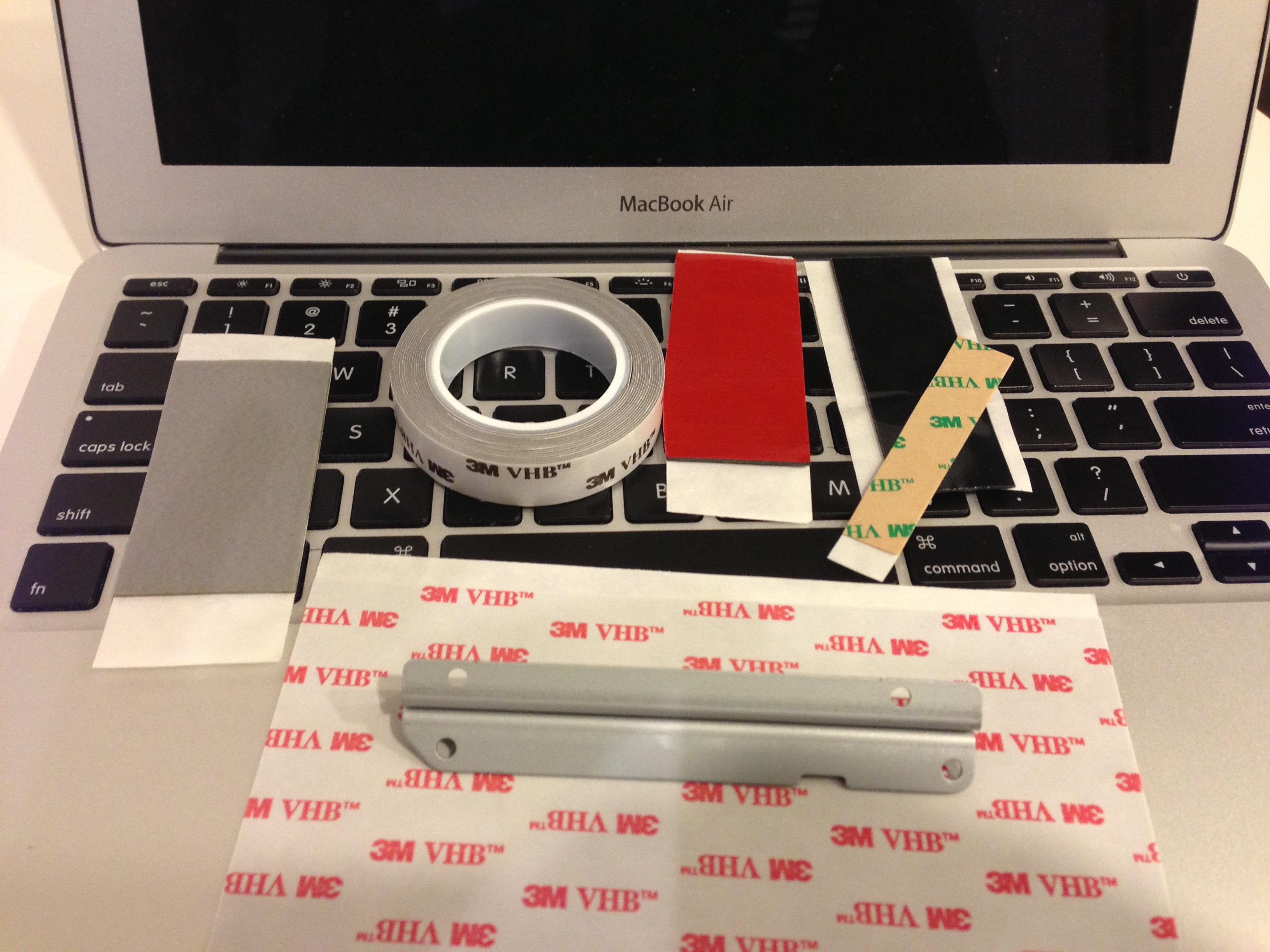

The maximum thickness I would use is 15mil to 16mil (0.381mm-0.4mm) since the area where the adhesive tape should be applied is slightly recessed. As long as you use a tape that is thinner that the recess (15-16mil) you will not have a gap. The width does not matter since you will have to trim it to fit
How about 3M RP16 VHB Tape? 3M double-sided pressure sensitive adhesive gray foam tape for bonding a variety of substrates including many metal, plastic and painted materials. Thickness: 16 mil (0.016 in. / 0.4 mm). 3M website
I purchased that tape form my local Grainger but decided to go with the 4926 due to its flexibility. I have several samples of VHB tape and so for the 4926 is the best so far.
Is this that tape from SEARS?
3M Preferred Converter 1/2-18-rp16 Vhb Tape,16 Mil,1/2 In X 18yds 15c835 15C835
http://www.sears.com/3m-preferred-c...399S6564455204?prdNo=1&blockNo=1&blockType=G1
Thats the same tape, i purchased it from a local Grainger. They have several VHB tape's on sale and offer local pickup

I can't find my digital caliper so i ordered a new one. Once it comes in i'll take some measurements.
Has anyone found a decent priced roll of this tape? The cheapest I have found it online was a 5 yard roll for $35.
I purchased my 4926 tape from ebay

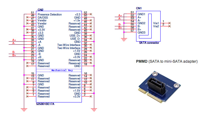

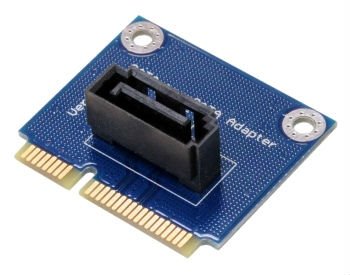

Hi R.OG
I'm just wondering, from your memory, is there any room near the SSD to fit something like this (plus cable)?..
If such a thing existed to fit apple's custom connector.
Hi R.OG
I'm sure a board that size will fit with the right cable. If i get some free time i will try to design a board that converts the blade ssd port to standard SATA.
You're awesome R.OG. I was thinking the same thing, it's a pretty simple project, but I wouldn't know where to find a pinout diagram (have toshiba published this?) or would it be easy enough to trace? Either way, better someone with confidence in this stuff does it, such as yourself.
This would definitely be the best way to go. A standard SSD could be placed in the HDD mount using the power meant for SATA1, but be connected to SATA0, where the firmware expects to find an SSD. This way, the diagnostic tools wouldn't throw up any errors due to no temperature sensor being detected on SATA01.
Also, I'm sure quite a few people would be interested. It would be cheap enough to make a run of 50-100.
