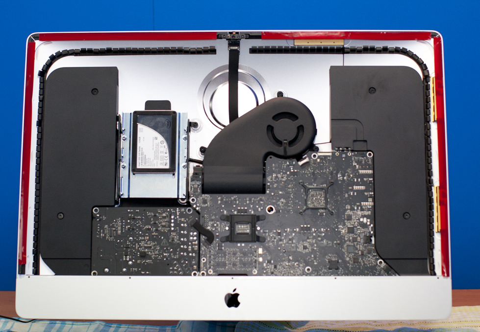

Well over the last two days we have now pulled apart 3 imac 27 inch machines and installed SSD drives.
even pulled one apart twice.
no problems all went well
got photos i will post tonight

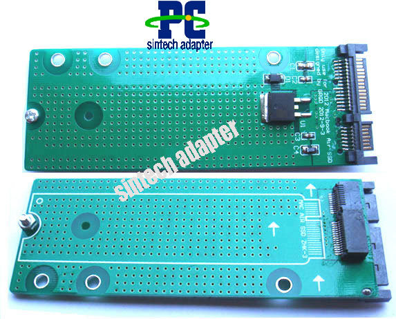

This would definitely be the best way to go. A standard SSD could be placed in the HDD mount using the power meant for SATA1, but be connected to SATA0, where the firmware expects to find an SSD. This way, the diagnostic tools wouldn't throw up any errors due to no temperature sensor being detected on SATA01.
Also, I'm sure quite a few people would be interested. It would be cheap enough to make a run of 50-100.
I plan to get the pinout from this board. It's a simple design but i probably won't get a chance to work on it till mid january.

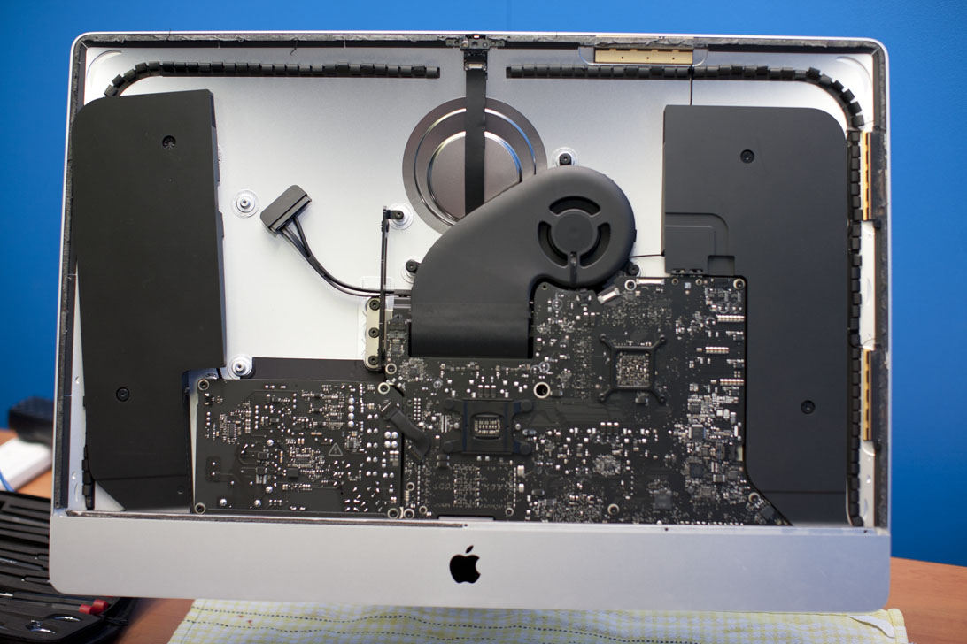

Well I didn't get as many photos as i thought i would. when it came time to open them we were more worried about trying to do it carefully and correct.
but i got some anyway, probably the same as you have already seen but anyway .
Nice pics. Looks like you used the replacement tape around the whole perimeter of the machine. Don't suppose you've tried re-opening it to see if it's more difficult?
Also, what was your technique to avoid the camera and Wi-Fi antennas? Is it something you need to be particularly careful about, or just aware of what you're doing?
we actually did have to open it again, And it was slightly harder but was still fine. I rather that at least i know screen is on safe.
as for wifi antenna, they are flush with screen so you can't damage them.
the camera you just stop short of of it .
we used a guitar pick .

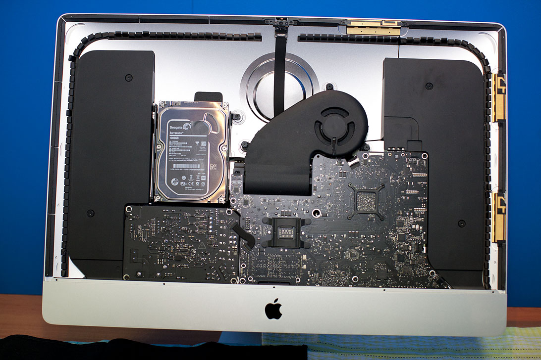

Was your model a fusion or just 1TB? You got a Seagate drive, which is nice.
Just got mine today, it's amazing - didn't have time to install anything but the extra ram, but will try to open it up tomorrow and install my 840 Pro.
Will post some pictures and speed tests when it's done

Hi mate we didn't do anything. Just cloned original drive and put new one inside works perfectly. We did a hardware test on boot up and it came up perfect no errors at all. fans are all normal. been running for couple days now :)
