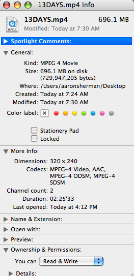

um i ripped via handbrake 0.6 as the 0.7 beta3 won't work on my ibook g3; can anybody check if the below settings are right?
EDIT look under 'more info' on the attached pic

OK, I reripped Blade Runner using H.264, and once again, the iPod would not accept the resulting movie. Therefore, I conclude that the H.264 option in Handbrake should NOT be used.

out of the six compression versions I did of the same spongebob episode only 3 were accepted. all six of the compressions were exported from handbrake.
none of the H.264 versions were accepted including versions true to apples specs. yes clayj you were correct (perhaps this is a handbrake issue?) all three of the versions that were accepted were mp4 compressions and were set as followed;
A-320x240 at 1000kbps, audio 160kbps 48 khz (22min at 187.5mb)
B-same as above but at 2500kbps (22min at 233.2mb)
C-480x368 at 1000kbps, audio 160kbps 48 khz (22min at 187.5mb)
they all looked fantastic on the ipod screen.
didnt take;
D-mp4 480x360 at 2500kbps, audio 160kbps 48 khz (22min at 429.4mb) this is apples stated max for an mp4.
the other two were h.264 versions. both whithin apples specs.
