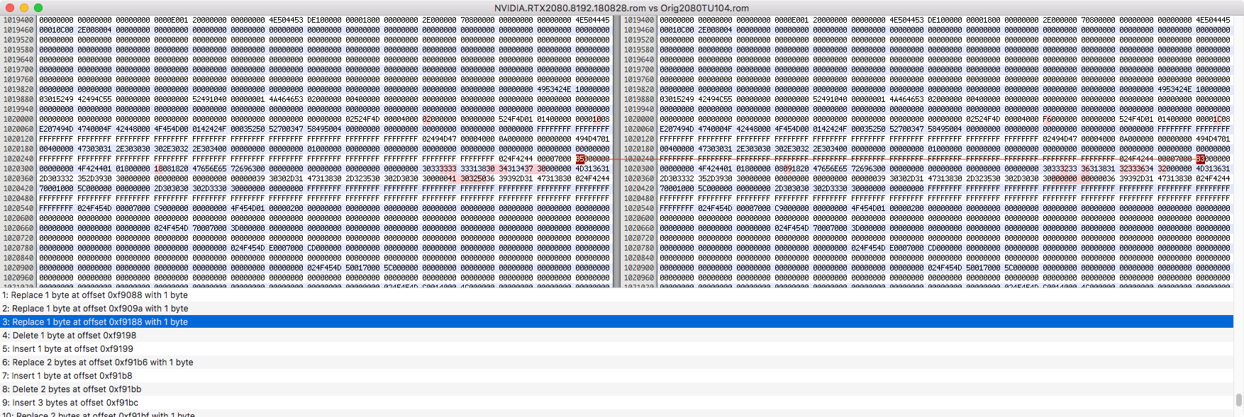

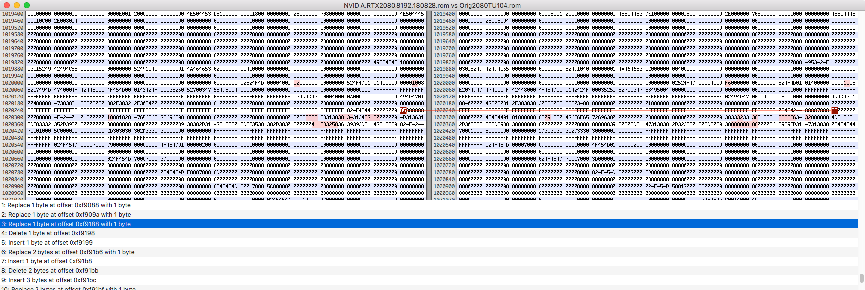

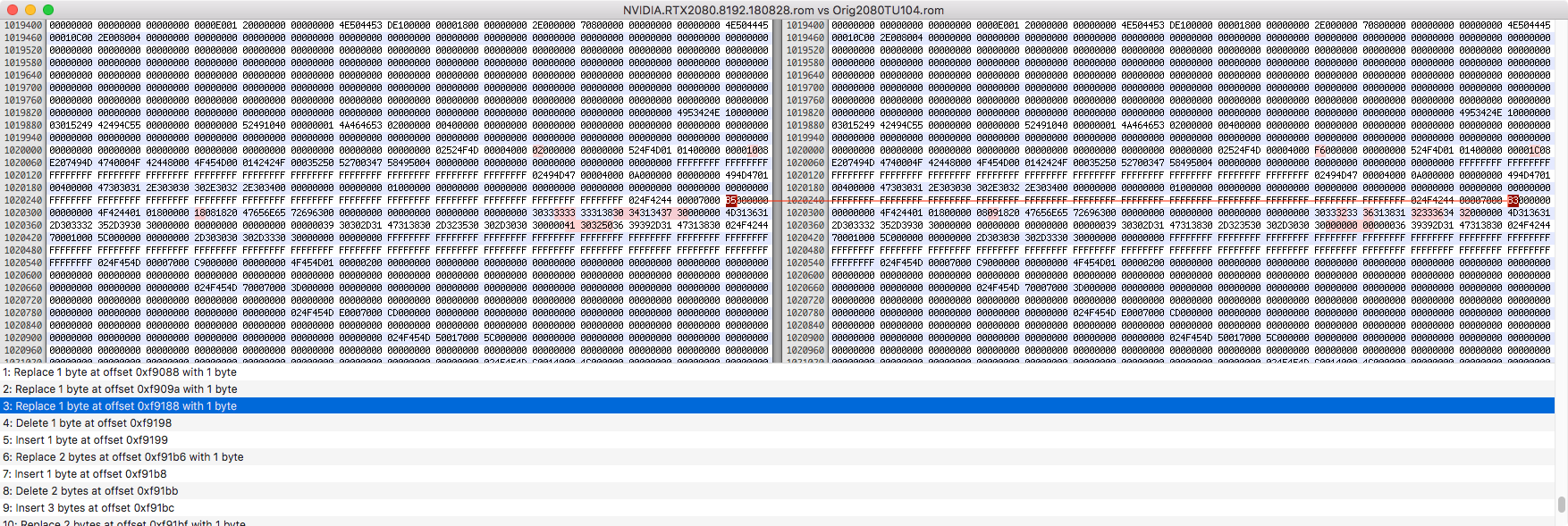

[doublepost=1540252586][/doublepost]It's 99.99999999% identical as the TechPowerUp RTX2080, just some bytes differ.
What app are you using to compare the binary files? Love how it even takes into consideration offsets/inserts.
Hexfiend 2.9, I love it.

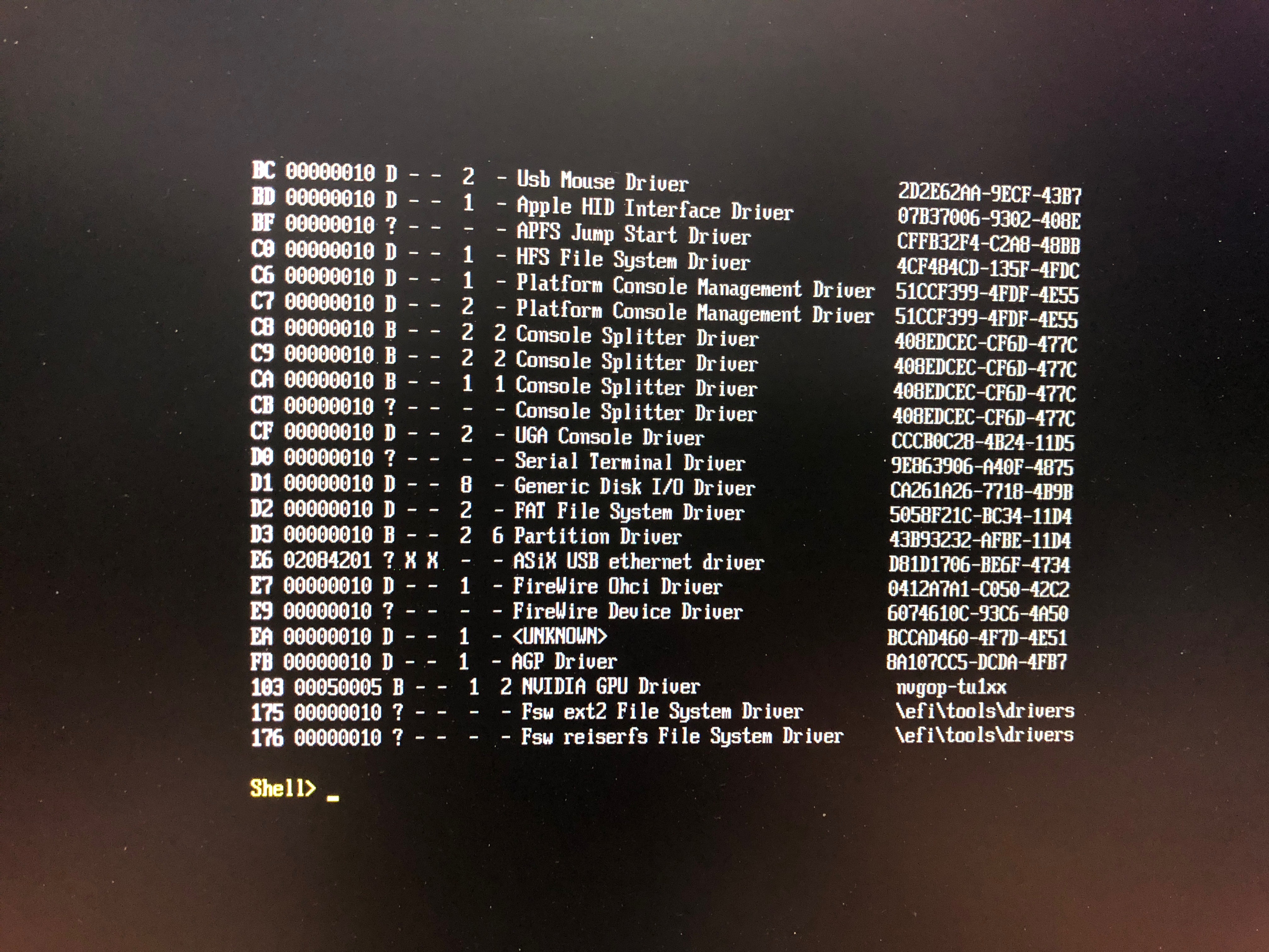

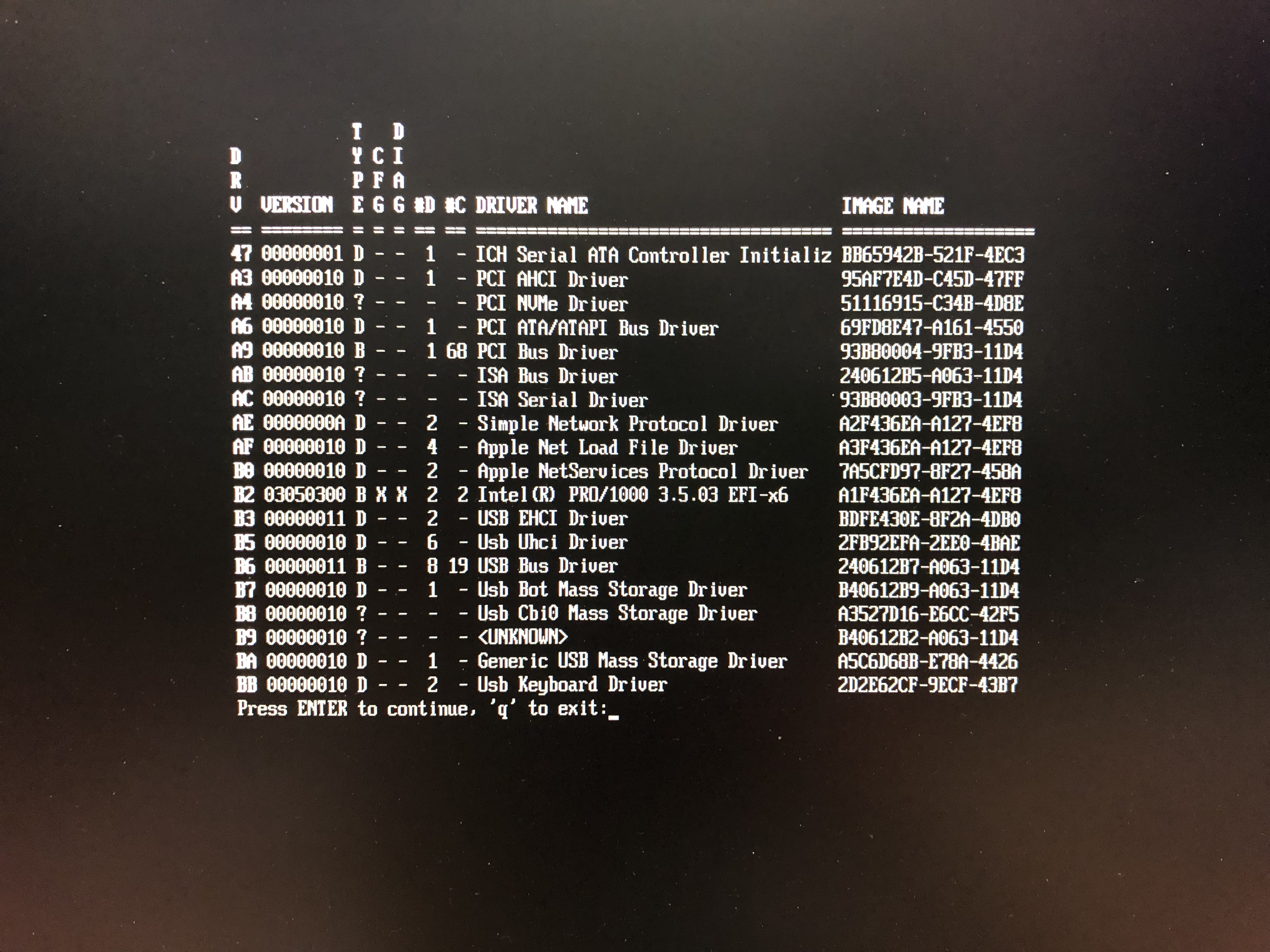

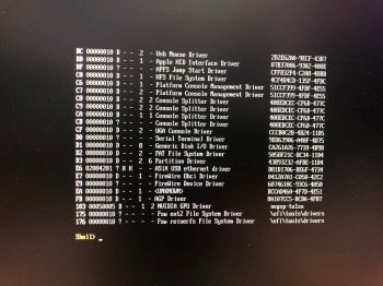

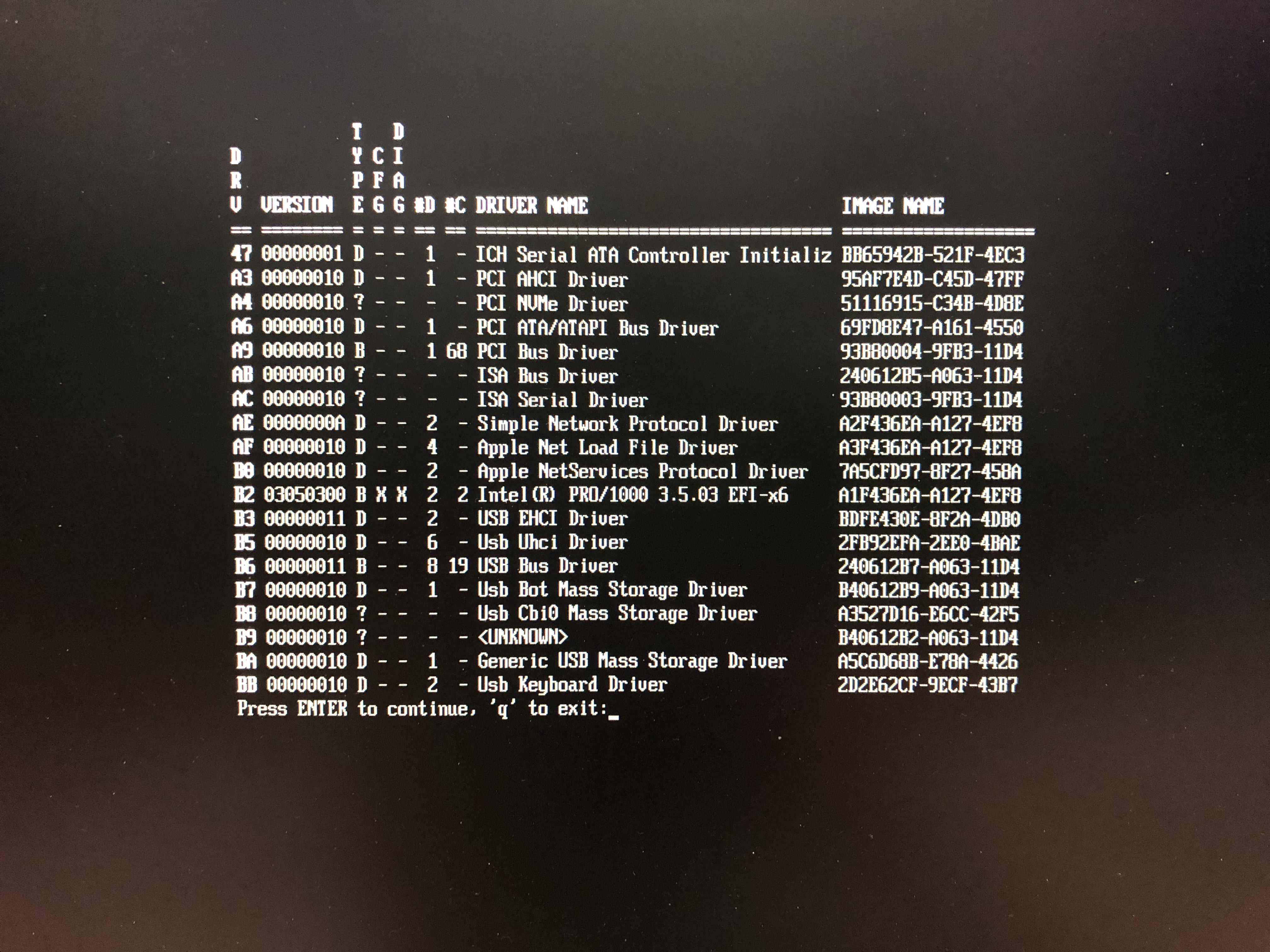

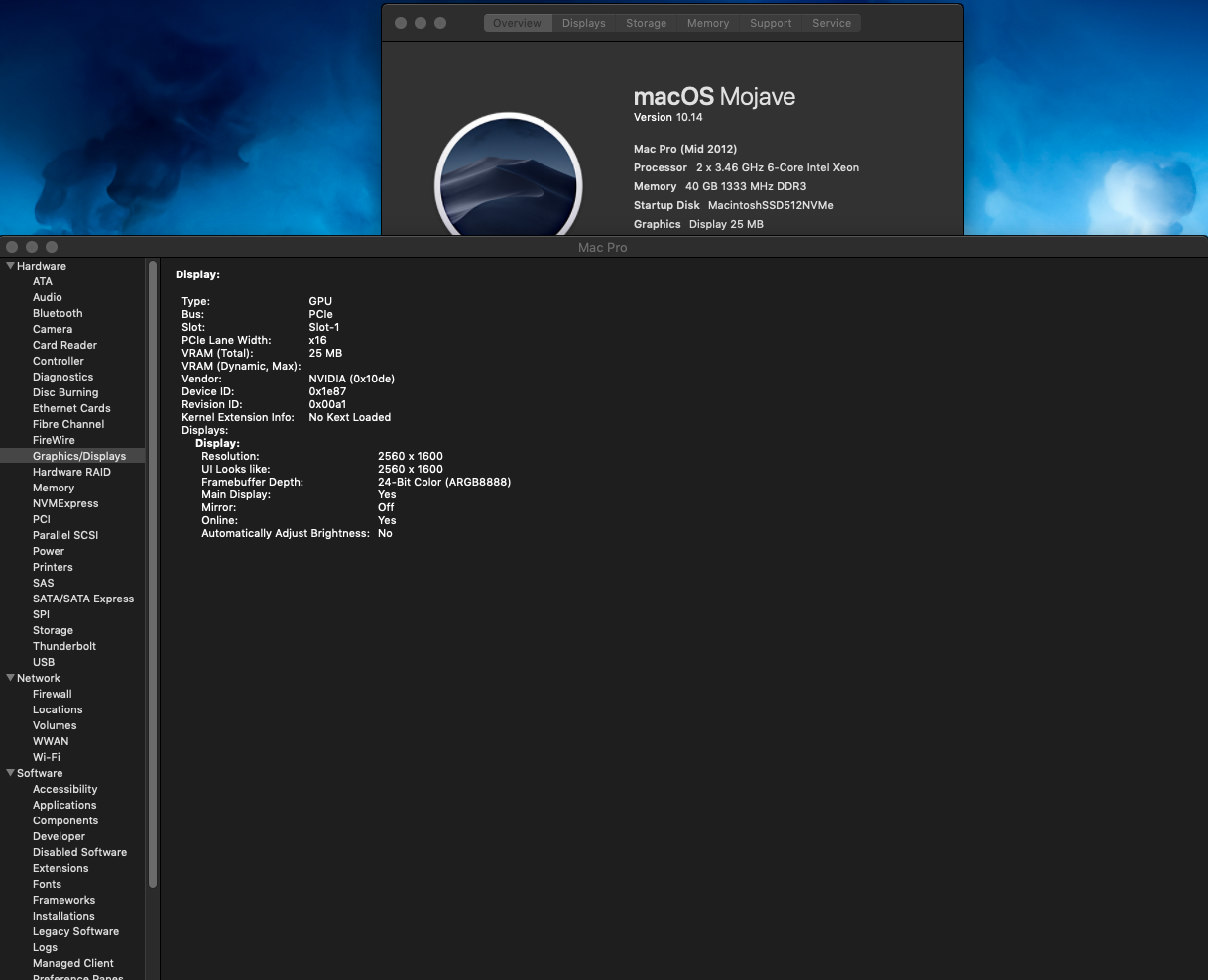

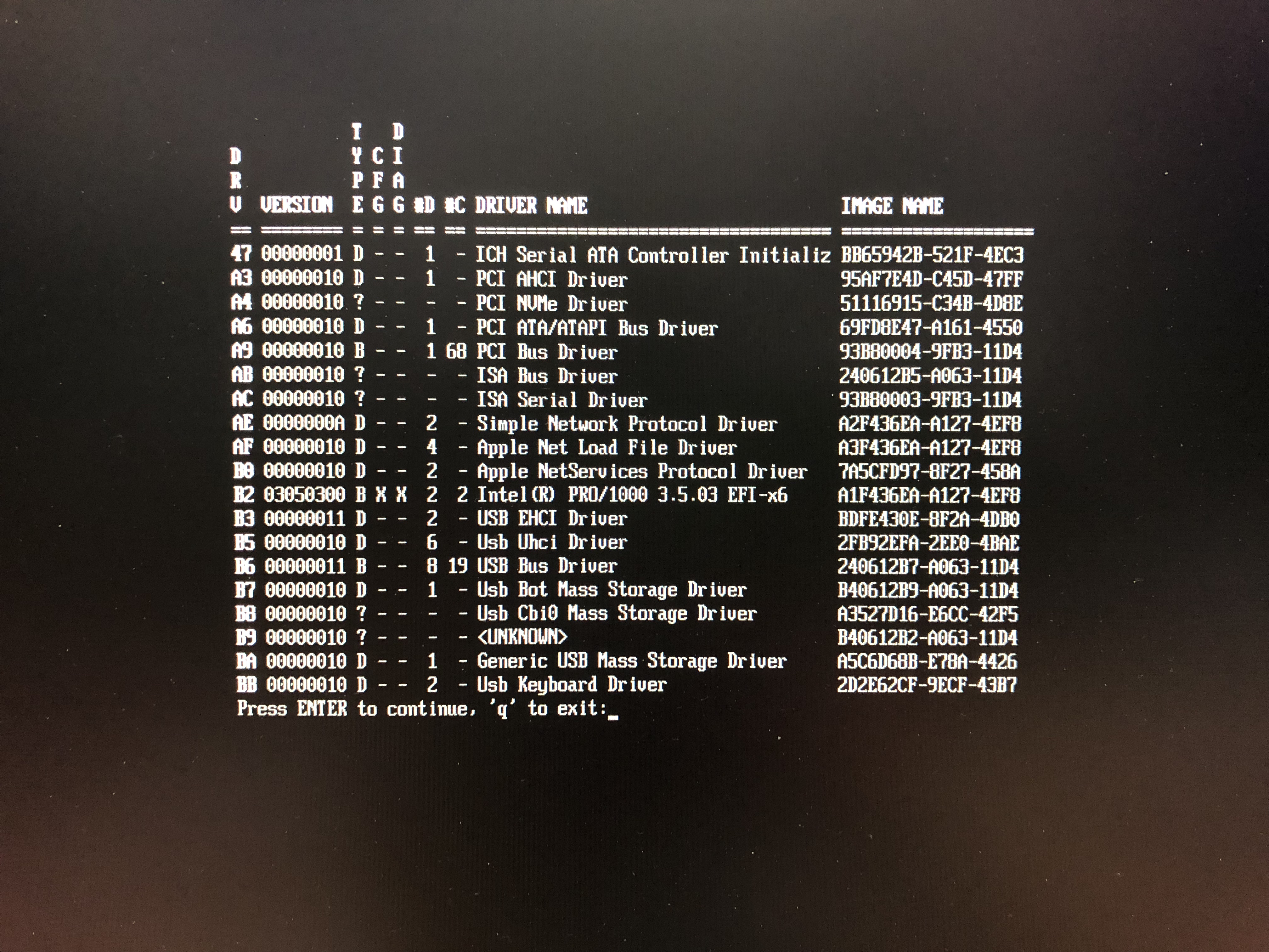

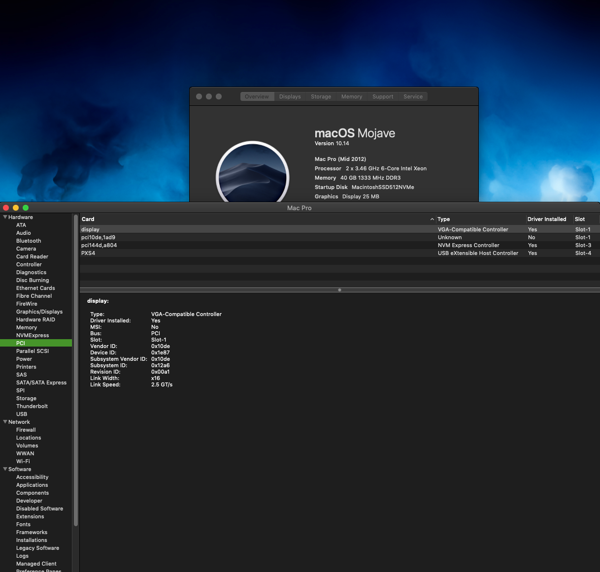

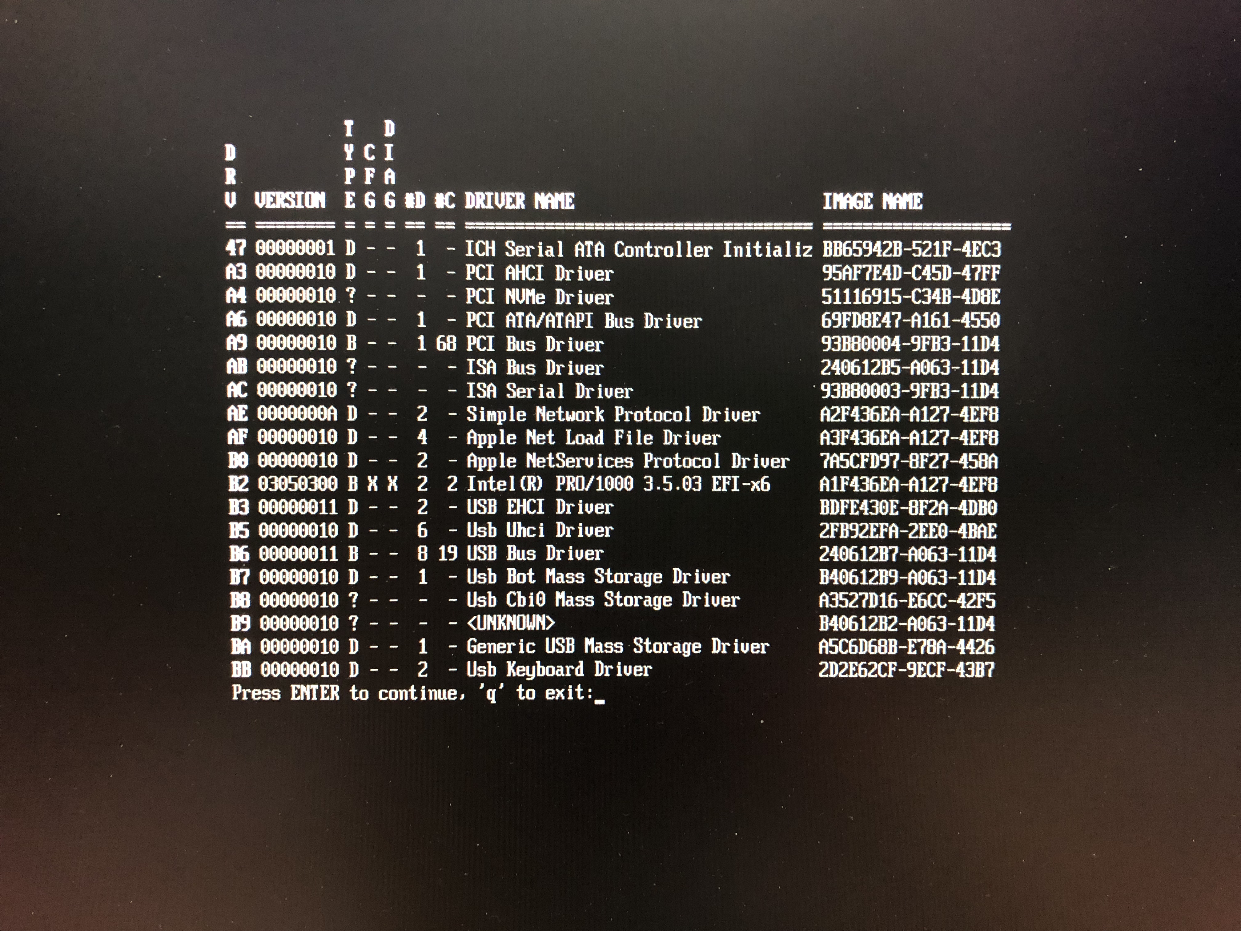

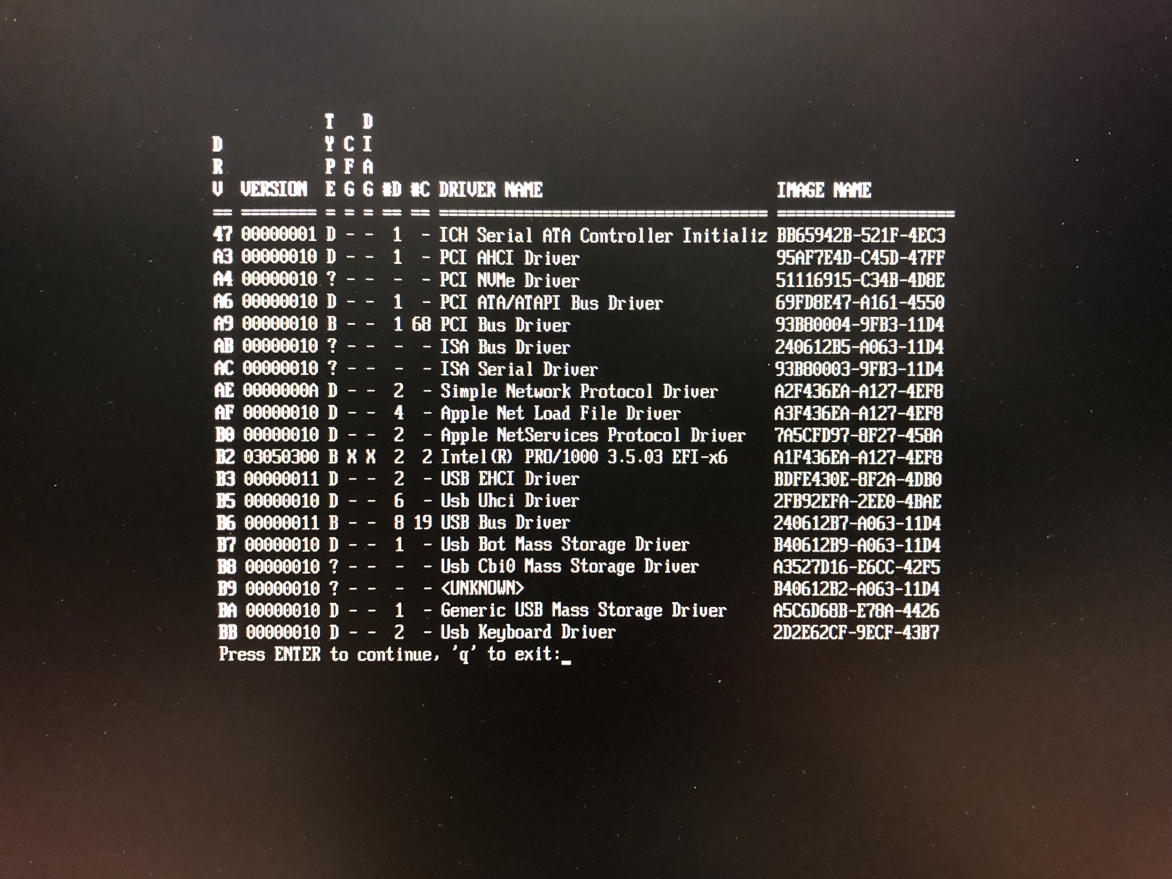

He is doing the drivers -b and the full System Profiler. He did the first page of the drivers -b, but it's not there.

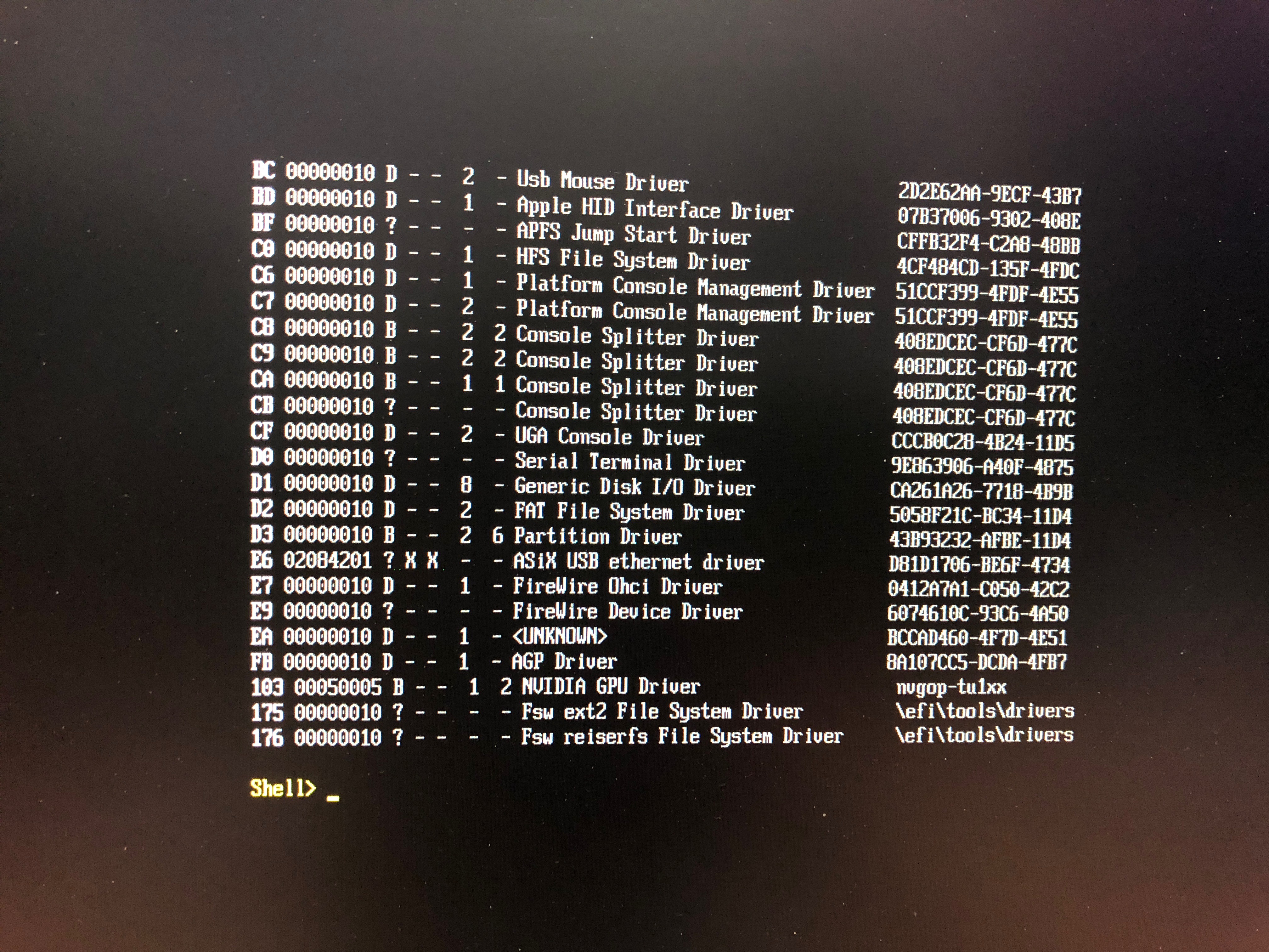

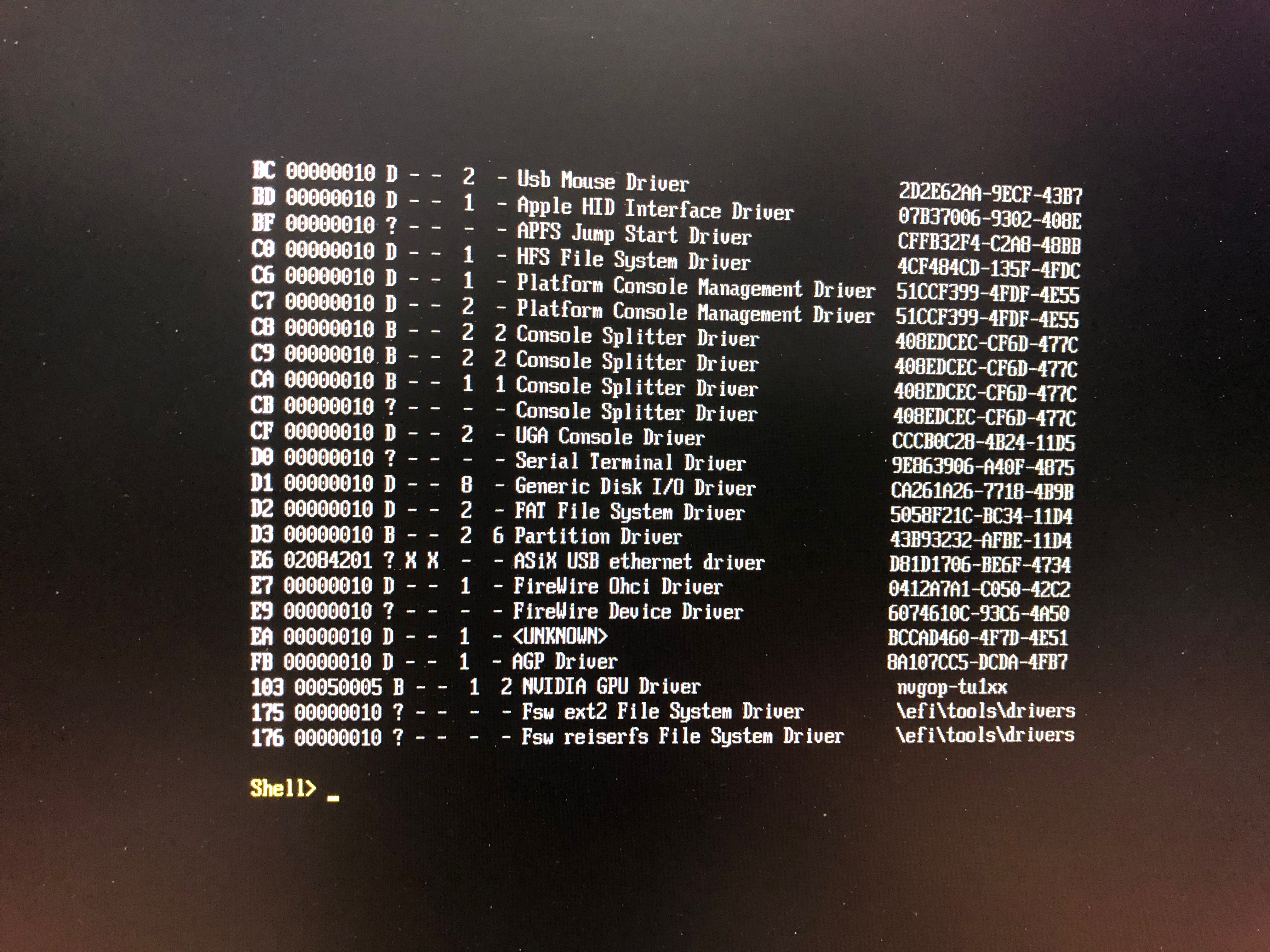

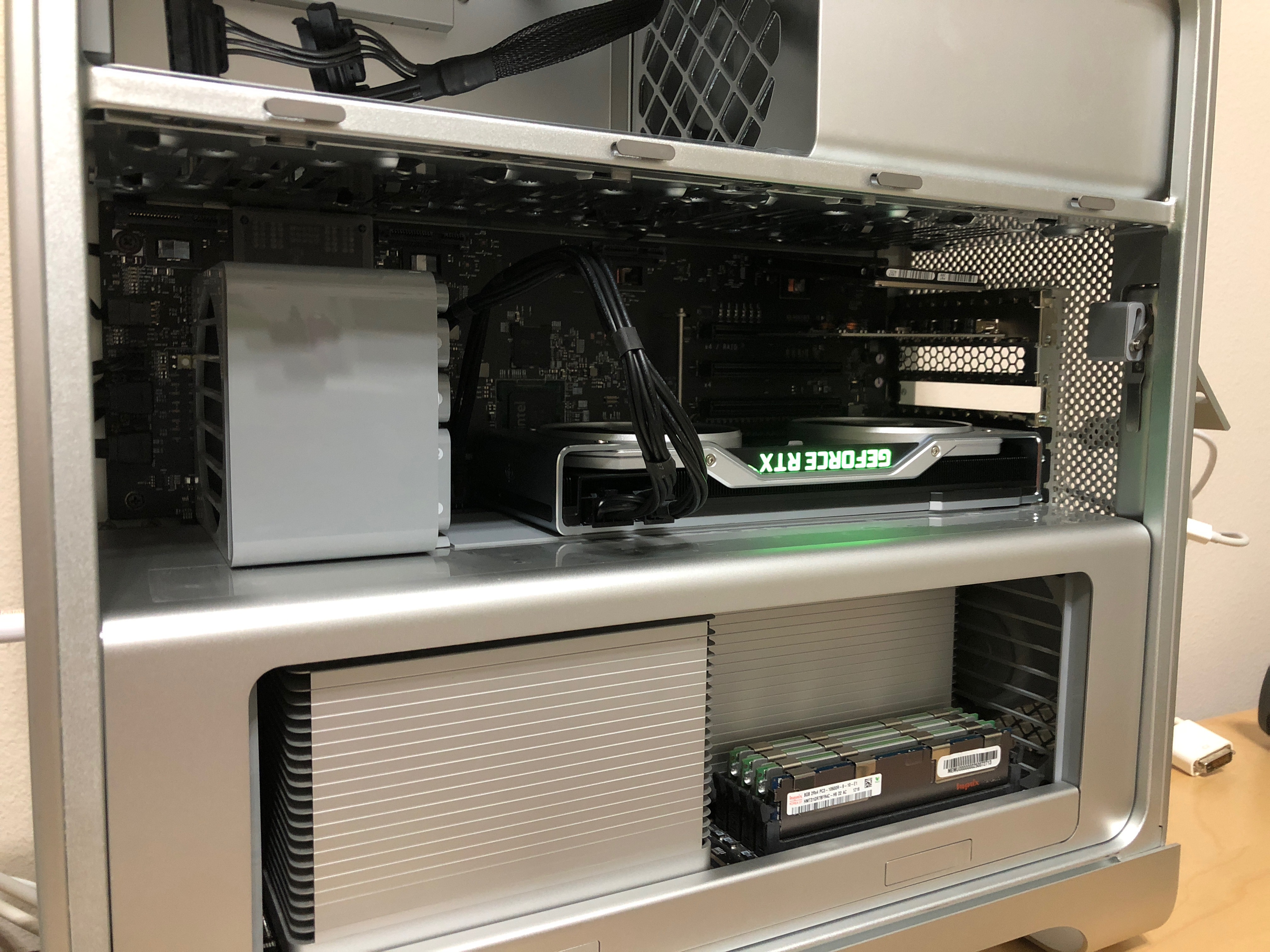

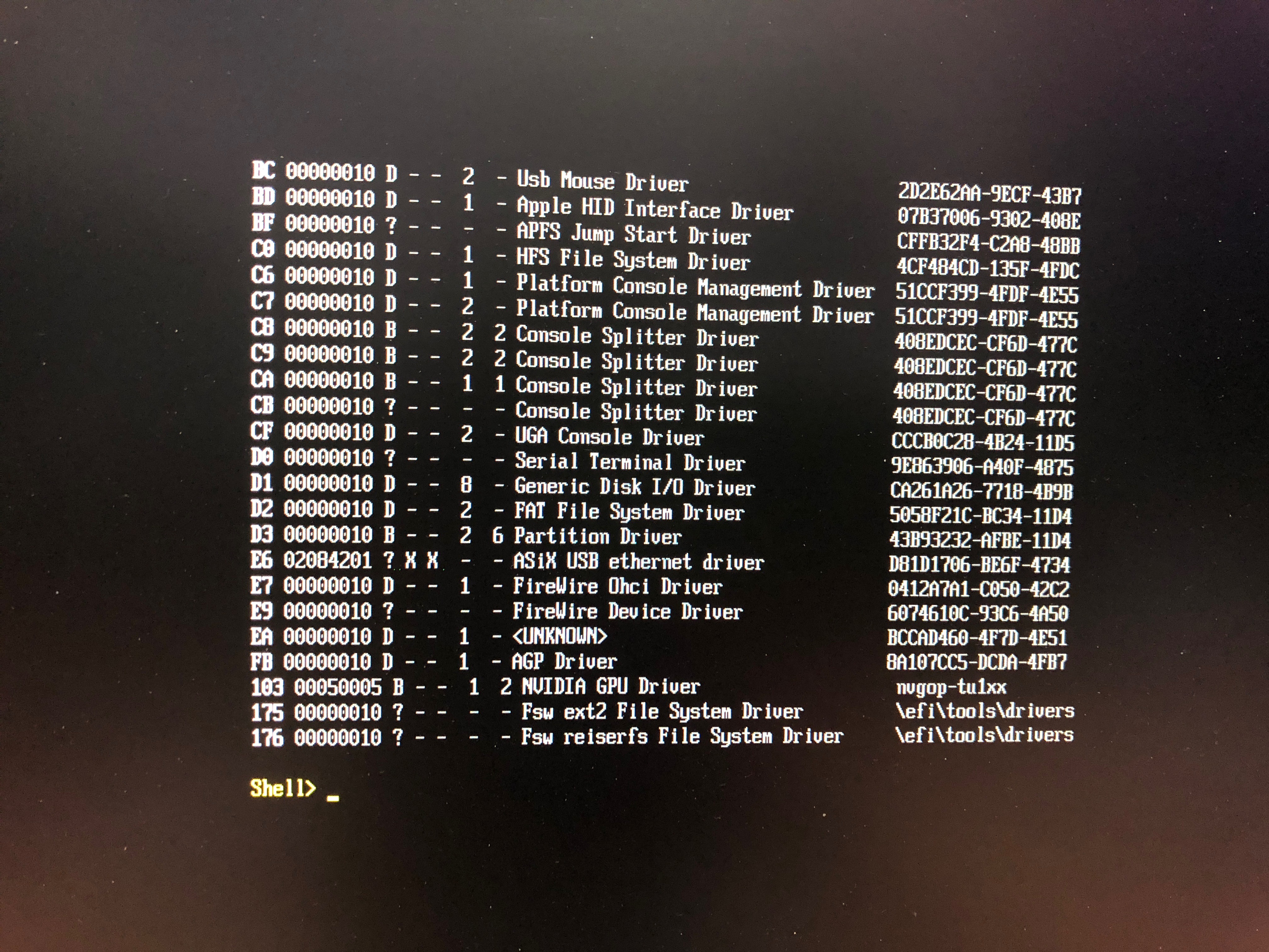

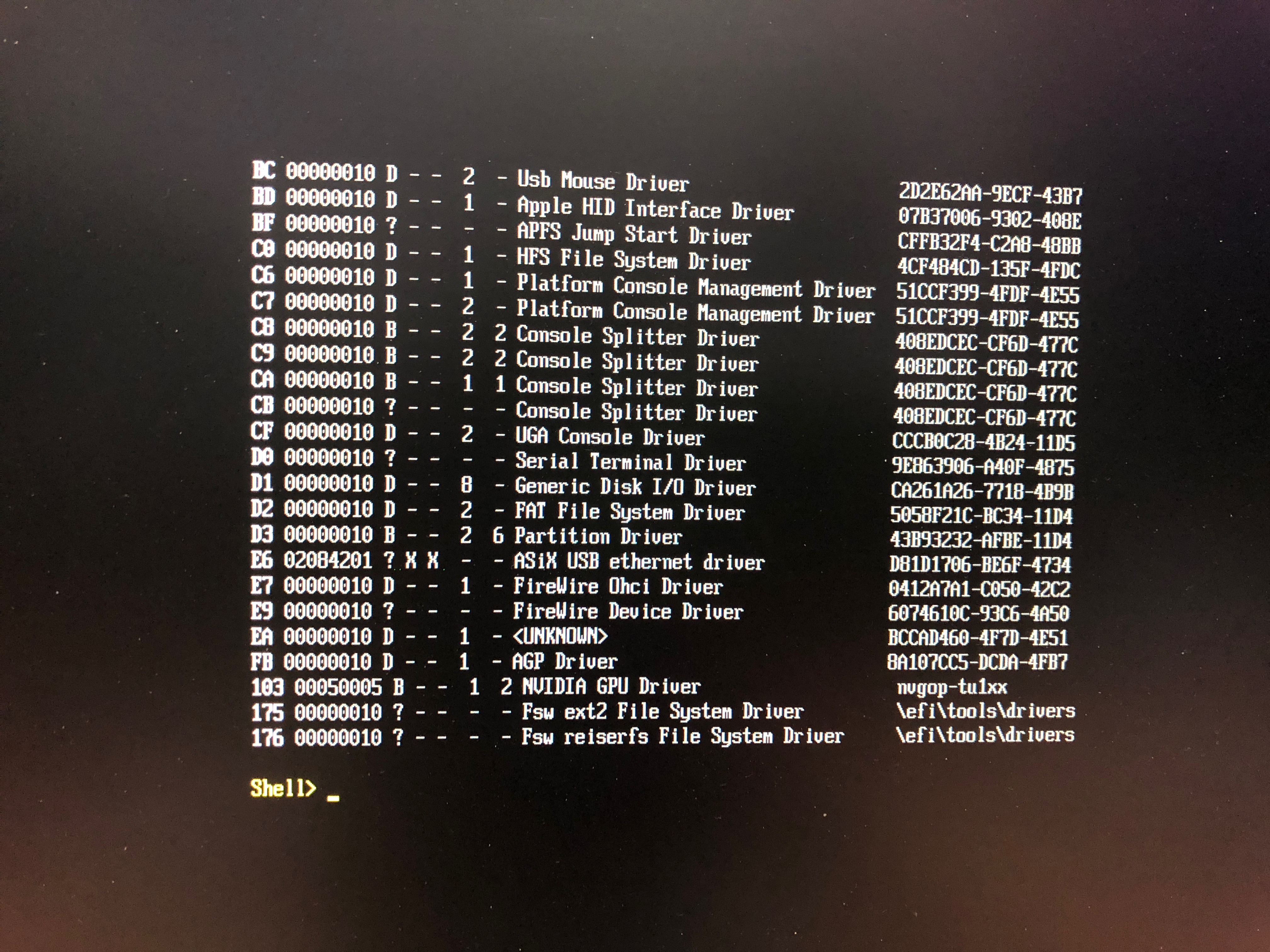

I understand correctly, in the report there is a UGA Console Driver, does this mean that we have BootScreen?
UGA Console Driver is from the Mac BootROM. The Nvidia EFI driver is shown in the second image. The card have boot selector/picker, now we need to see if has support for single mode/verbose.
In that is about to come in a few...
with this it will be the end of the sewing chapter if you see what I mean....lol

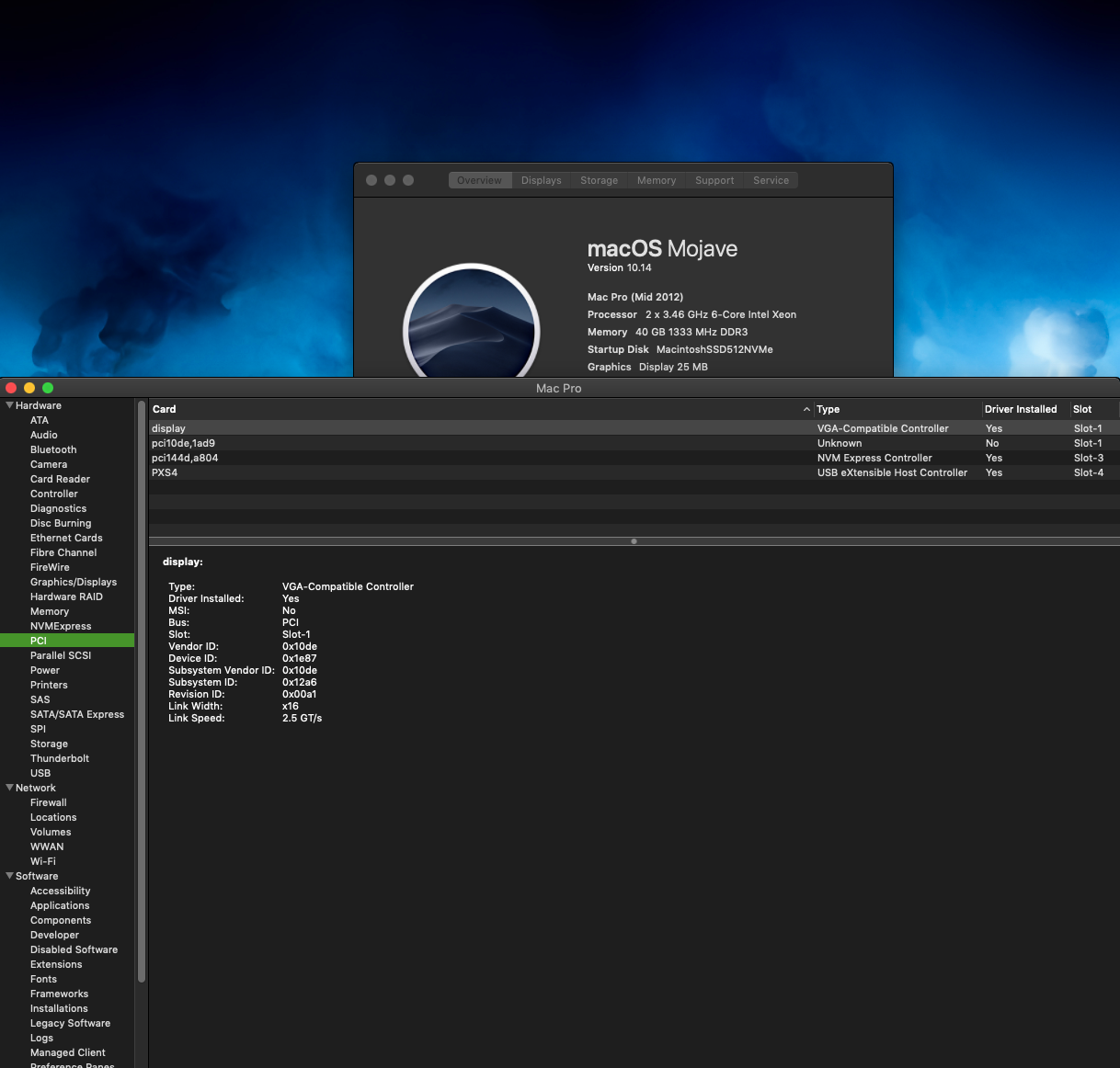

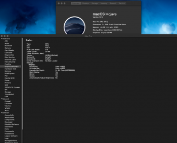

thanks @tsialex and @Bion1nc for the screen shots :)
its very interesting
especially as the Loaded driver is "nvgop-tu1xx" TU being Turing, 1xx being the GPU series, but GOP is Graphics Output protocol, being a MP5,1 I would of expected to have seen UGA not GOP, so I wonder whats going on there
its all very interesting and intriguing :) (I wonder if we will be able to extract bits from the RTXs ROM image and apply/load it against other cards?)
