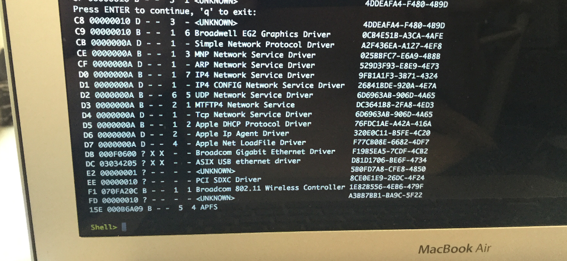

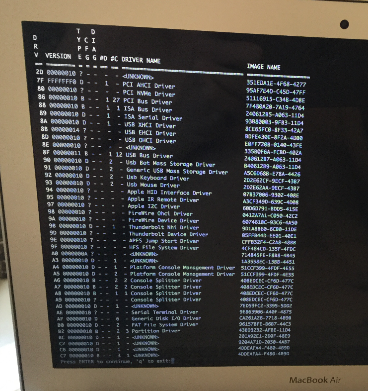

I did some more testing and broke out a 2015 MBA7,2 which is a GOP Mac rather then UGA and did a drivers listing
its interesting to note, that while UGA macs have a "UGA Console driver" thing in the driver list, this GOP mac does not have anything like "GOP Console driver" so I wonder what this UGA Console driver thing is exactly (also worth noting is the Generic XHCI driver I might try extracting that and loading it on my MP5,1 and see if that does anything with the USB 3.0 card I know the MP6,1 XHCI driver would cause the boot picker to lock up on a MP5,1)
Thanks for the dump, we don't know what the "unknown" drivers are. One of them maybe the console driver and the others maybe AGP driver.
2D, 8E, A0, and FD are not linked to anything, the others are. You could try to unload them one at a time and see if your screen goes dark.
BTW, no need to make screen shots, just pipe the output to a file, and put it in a code box.
Much easier to read.

yeah I too wonder what the Unknown ones are...
I noticed the UUIDs are constant across machines (ie despite the fact the PCI NVMe driver is different between Mac models they all have the same UUID of 51116915-C34B-4D8E) so maybe we could cross reference all the UUIDs and see if any of the Unknowns have names in other systems
and yeah I know you can feed the output to a .txt file but the above was very much just touch n go grab the shots and GTFO :)
Not UUID but GUID.
